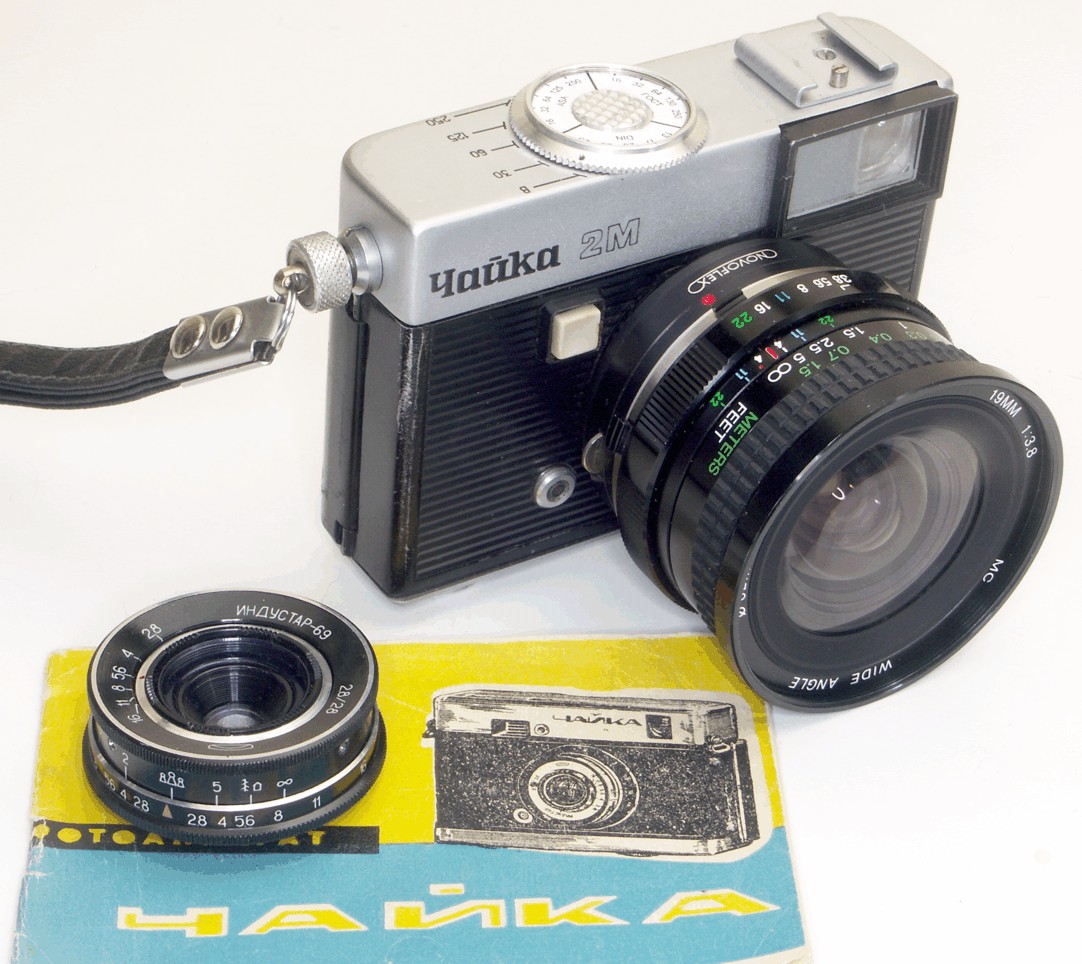

I just received a basically mint Chaika 2M -- which is a Chaika 3 without the meter.
The flange focal length of the Leica 39mm screw mount cameras is 28.8mm. In my somewhat crude measurement of the flange focal length of the Chaika 2m (and I assume other Chaikas), it is somewhere around 28mm. I'll do some more accurate tests/measurements -- but it is easy to assume that it is 28.8mm, as well -- which means I would be all set.
I can sell the Industar lens -- which is also in mint condition -- and recoup half the cost of the camera!
Even if the flange to film distance is the same, which I have read it is not, it looks like the next problem is the shallow lens mount. As you focus a LTM lens, the focus cam moves back past the mount. The Chaika looks like it would interfere with focusing.
Russian sources indicate flange focal distance to be 27.5 mm on Chaika 2 and Chaika 3. It's really strange that the lens is removable at all, because there was never made any other lens for Chaika series, except the one that came with it as a kit.

I don't think I'll have a problem with the spacing. The Chaika 28mm lens has about 3mm of thread on the rear. My Novoflex Leica adapter has about 4mm of thread. When I put the Novoflex Leica adapter on the Chaika, it leaves about 1mm of extra space -- which is almost exactly what I need. I'll have to try to do some more exact measurements and some film exposure test to figure it out, but I think I will just need to add or subtract a tiny amount to the Novoflex Leica adapter.
Here is the Chaika 2M with the Novoflex Leica adapter and a relatively small, Vivitar (Cosina) 19mm f3.8 -- equivalent to about a 28mm on a full-frame 35mm camera -- along with the diminutive Industar 28mm lens.
The Chaika has a viewfinder for composition/aiming, and focusing is pretty irrelevant due to the DOF. The flash shoe is a plus, of course. I also have smallish (but heavier than the camera!) Tamron 17mm f3.5 -- which is more like a full-frame 24mm on a Chaika.
This is pretty much what I was aiming for -- a small, light, inexpensive camera with wide-angle lenses -- basically impossible with half-frame. The Pen goes to 20mm, but the Pen F is large and heavy. The only alternative is wide-angle converters -- which give crappy results.
Looks like I can put off getting that Kodak Ektar H35. I got this Chaika for the same price -- I should say 1/2 the price. I'll sell the Industar lens.
Looking at my Chaika II, which looks a bit different from yours, it looks like the lens mount can be removed and possibly be shimmed out - although 1.3 mm is a bit far.
If the flange distance on the Chaika is 27.5mm, and on the Leica 28.8mm, there needs to be 1.3mm added to the Chaika -- not removed. My Novoflex Leica adapter adds about 1mm or so because it will not screw in all the way. That almost (?) solves the problem.

That's what I said: shim out the mounting flange the correct amount, if possible.
I had a Leica III without a mounting flange. When I finally got one and put it on, I ended up shimming it out with two layers of paper to get correct focus. Two layers of paper is quite a bit less than .3 mm.

Sorry. My mistake. Anyway, you can probably solve the spacing difference IF your lens or lens adapter has enough thread depth. As I mentioned, the Industar 28mm lens has about 4mm of thread, while my Novoflex adapter has about 5mm. In order to add a shim/gasket/washer of 1.3mm, your lens or lens adapter has to have enough depth in the thread to reach through the extra 1.3mm shim/gasket/washer. That is going to vary from camera to camera, and lens to lens, and lens adapter to lens adapter.
I think the bigger problem is measuring the flange distance down to tenths of a millimeter.
