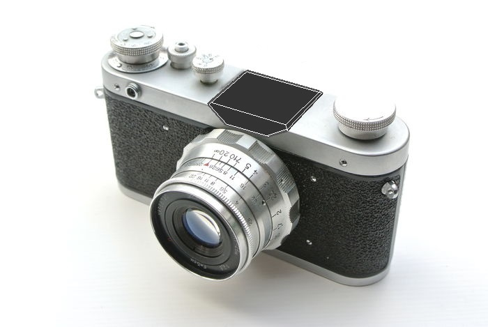

I'm imagining a FED Zarya with the viewfinder removed. The protruding part of the top cover would be sawed off and plugged up with a little 3D-printed cover, cemented in place, with the cold-shoe for the 35mm VF on top of it.
That's your poor man's Leica I:
Sometimes trying to save money costs more than just buying a good camera from a reputable source.
The ZARYA/ZARIA/ZARJA/ZAPA seems like the best bet. Despite not being mass-produced, there are over two dozen on EBAY right now -- starting at $50. The small viewfinder is not much of a problem -- I see it as a plus.
