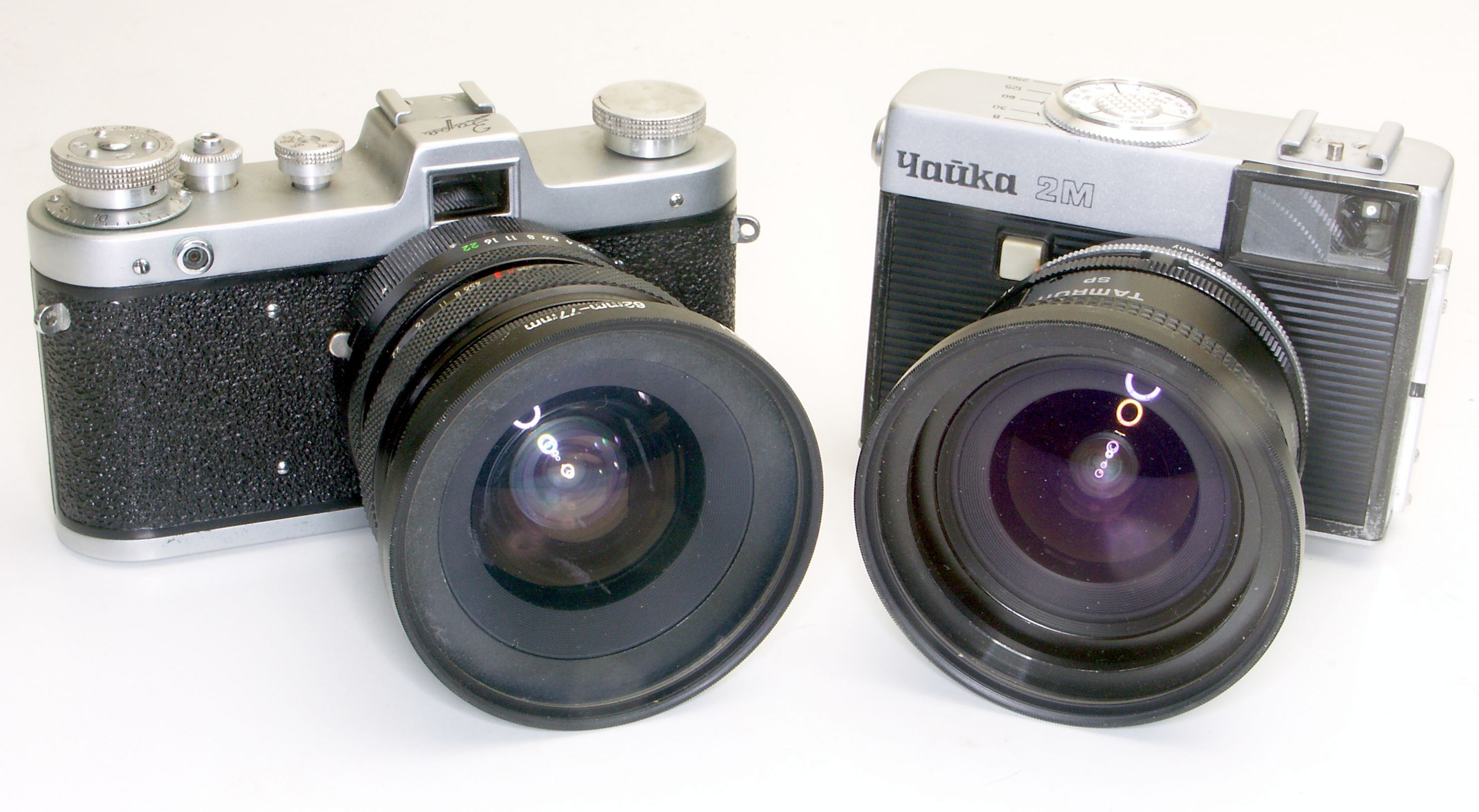

I'm all set now -- thanks to TWO Ukrainian photo shops. Both of these are easy-to-get, inexpensive LTM 35mm cameras. On the left if a full-frame ZAPA with an 18mm f2.8 Sigma, next to a half-frame Chaika 2M with a Tamron 17mm f3.5.
If you are interested in supporting the photo industry in Ukraine, checkout TERPHOTOSTORE and SOVDEPIA on EBAY. I was surprised at how quickly these two cameras arrived.

Don_ih
Jan 24, 2021
8,539
Ontario
If you have some photos from the Chaika with that lens, I'm sure plenty of people would be interested to see.
