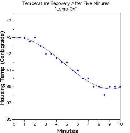

I was getting odd results with my 14" Aristo head when doing split grade printing. Turns out it was from interchanging blue first with green first. Turns out the lamp gets dimmer as it heats up during the exposure. So which ever exposure is second (green or blue), needed to stay second.

Aristo head ... the lamp gets dimmer as it heats up during the exposure.
That's really rather strange. A 1/2 stop drop in light is rather significant, equal to around 1 zone. Flourescent tubes usually get brighter as they warm. The Aristo I had - albeit dating from the 60's-'70s - had a heater to keep the lamp warmed up (kinda) between exposures. Does your Aristo have a second power lead for the heater?
To measure the lamp temperature you need to have the thermocouple or RTD bonded to the glass of the tube. I'm sure the temperature of the tube is swinging more than 4C. 1/2 stop over 4C, why you have yourself a thermometer, with a DA meter you can tell your darkroom temperature to 0.1C.
The graph represents the temperature of the housing. The heater thermostat is set around 40C, but the lamp heats the housing more than that when it is on. Test limited to 5 min, the maximum on-time recommended by Aristo. It takes about ten minutes to recover to the temperature set point when the lamp extinguishes.
