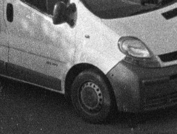

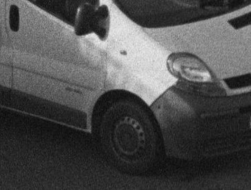

In (there was a url link here which no longer exists))[/URL], Alan Johnson tested one of my developers-in-progress, called D316, and posted scans from his Epson V700 flatbed scanner. He kindly posted (mailed) the negatives to me, which arrived yesterday. Royal Mail is fast.
Here are two scans of the same negative developed in XTOL 1+1 at EI 400. The second scan was done with a slight reduction in analog gain to attempt to match contrast with the D316 scans that follow. The XTOL scans:
And here are scans from my test-developer D316. The left is EI320, and the right was the thinnest neg on the strip (unknown EI):
The scanner's settings were identical in all these scans, except as noted for the 2nd XTOL scan. The scanner was manually focused on the car's wheel.
Alan, do you recall the EI of the thinnest neg? It looks like you were bracketing in 1/3-stop increments, which would make it about EI 500.
Anway, it appears to me that D316 has finer grain than XTOL in all cases. But this was XTOL diluted 1+1; it would be interesting to compare with XTOL undiluted. In Alan's scans, XTOL had finer grain. I think that's because the focus of a flatbed scanner varies across the glass. Under extreme enlargement, the scan-lines for Alan's XTOL-image were blurred compared to D316, revealing uneven focus.
