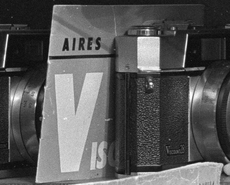

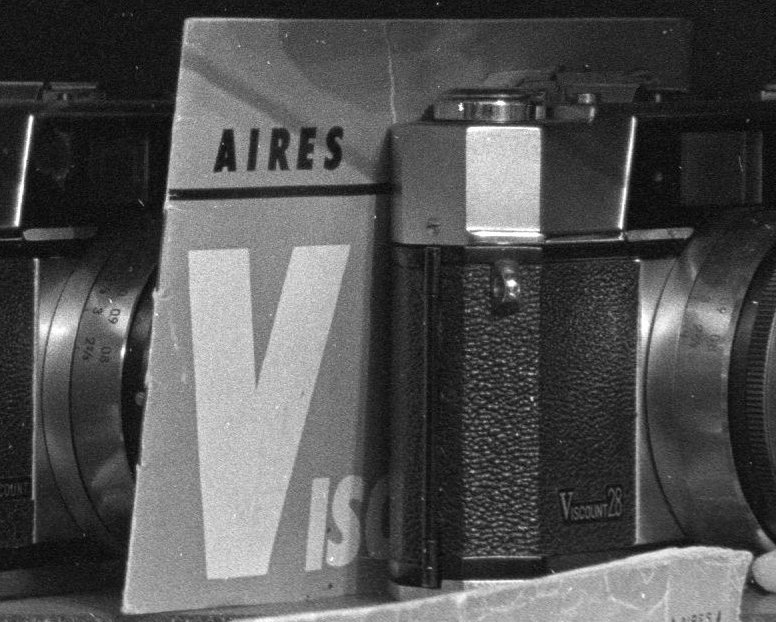

I finally got finer grain than XTOL! By a small margin, but finer when carefully compared in a pair of 22X loupes. I only tested it with TMY-2, and this one-liter formula is merely a baseline for further work:
Potassium Sulfite, 45% solution ... 80 ml
Ascorbic acid ........................... 4.5 g
TEA ....................................... 2.7 g (yes, grams; = 2.4 ml)
Dimezone S ............................. 0.067 g
Target pH=8.0. Starting dev-time is twice undiluted-XTOL's time.
On TMY-2, the grain is slightly less clumpy and less stringy than XTOL's, and thus appears more like fine sand in my 22X loupes. Grain also appears slightly finer than XTOL in monotone areas. As mentioned earlier, the toe is slightly lower than XTOL, but the difference is small enough that most people probably wouldn't notice. I'll use this formula as a baseline for more experiments, including (1) using sodium sulfite instead because that's what most people have, (2) reducing sulfite and boosting TEA to reduce chemistry, (3) making a PG-based concentrate out of it, (4) general fine tuning and testing, and (5) other films.
Here are full-resolution crops of neg-scans of TMY-2 in XTOL (left) and this test-developer (right):
In both cases, the scanner was manually focused on the "V". Although the scanner can't pick up individual grains, you can see there's less noise in the second scan due to finer grain. Also, I want to take some grain-photos through a microscope and post them, but it'll take some time to get a microscope-setup working.
Mark Overton
Nice work.
How are you using Xtol? Stock? 1:1, or even more dilute? Replenished?
Do you print these to see what they do when projected?
45005-improved-version-ds-10-ryuji-suzuki-5-00-xtol-focusvcrop.jpg.att
45006-improved-version-ds-10-ryuji-suzuki-5-26-dimezonefocusvcrop.jpg.att
Mark Overton
Very nice work.
My comments about Potassium in the fixer come from comments in Haist and in Mees. I have not personally tested this myself.
The work comes from their comparisons of different salts such as K, Na, NH3 and Ca in fixers and the presumption in some of the literature was that the larger cations made the Silver / Hypo complex more difficult to diffuse.
In fact, there are recent patents that claim that small amounts of Potassium salts actually speed fixing but there is no explanation. My own patent on film Blixes notes an increase of Blix speed with KI present which is counter intuitive.
PE
Nice work.
Thomas,
I'm using Xtol stock (1+0) one-shot, so that's 6.5 minutes at 20C. I wanted XTOL to show off the finest grain it could. Everything is done at 20C with identically exposed strips.
No printing yet. I have a list of changes to that formula I want to try -- substituting chemicals, changing quantities, dropping pH more, etc. I'd like to see if I can do better, or perhaps do just as well and use less chemistry. In addition, the experiments provide a "feel for the environment" -- an intuition of what effects changes will have. But it takes patience: Once cycle of mix developer/temper bath/dev strip/fix/clean up takes me about an hour. I'm careful and accurate, which is good for repeatability, but such care eats time.
I want to get a densitometer. I'm tired of matching densities by eye, and a densitometer will let me create absolute and relative density-curves, which will clearly reveal loss/gain of speed, contrast/CI, highlight-compression, and anything else relating to tone-levels.
As an aside, I notice that the test-developer image (2nd image) is a bit darker than XTOL's image. Dense areas of the neg's had matching densities, judging by eye through two pieces of paper with a hole punched in each. The difference might be due to auto-exposure in the scanner, which I can't control.

Michael: Those were 1-second exposures, and the tripod was on carpet, so there's a chance there's a bit of motion-blur in there. I'll have to dev a couple more strips and keep an eye out for sharpness.
