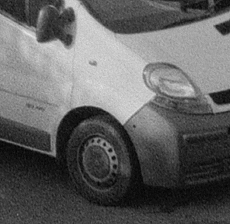

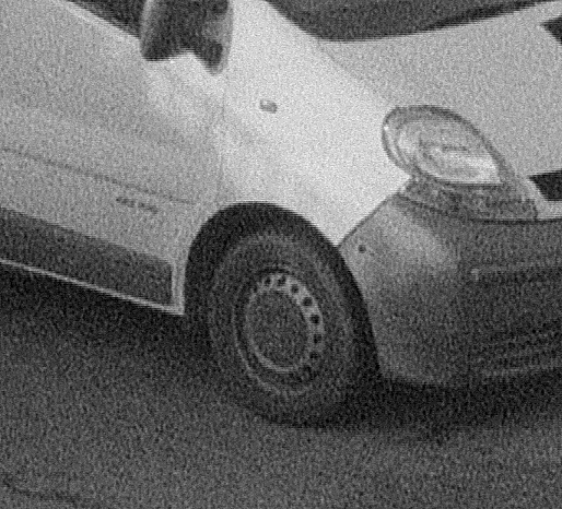

Mark Overton
I made up the developer above, call it D316 after the post number.It could be made by heating to 70C in a water bath.The 45g/L sulfite I weighed out is about 4 heaped teaspoons.The measured pH was 8.1.
HP5+ was developed in D316 for 2x the Xtol 1+0 time.
HP5+ for comparison was developed Xtol 1+1.
The EI I would use for sun/shade conditions, average metering, was D316=EI 320, Xtol 1+1 = EI 400.
Attached scans are of 0.1 inch square sections of negative scanned on an Epson V700 at nominal 4800dpi, sharpened equally.
Conclusions:
Xtol 1+1 gives finer grain and slightly higher speed.
D316 wrt its concentrate composition and dilution is practical and economical, probably near optimal.
Concentrate is a good developer but cannot be made so as to give as fine grain as Xtol,though close.
Conclusions:
I appreciate your doing this, as it's always good to have reviewers check one's work. Some questions:
* How do the densities of the two negatives compare? My goal was twice XTOL's dev-time, and I'm wondering how close I got for a conventional grain film.
* Could you compare grain by viewing the neg's directly with a loupe? I've found that even a dedicated film-scanner as good as my Nikon Coolscan IV ED does not reliably show grain due to focus-variation, so I trust direct viewing in a loupe or microscope more. Hmm, I guess a couple of carefully-focused extreme enlargements (projecting onto the floor?) would also clearly show the grain-difference.
* I notice that the area under the bumper is darker in the Xtol-scan, indicating a difference in black-point and/or gamma in the scans. How did you set these in your scanning software?
My goal is to get XTOL's grain in a concentrate, and I'll keep hammering at it. Feedback like this is good.
