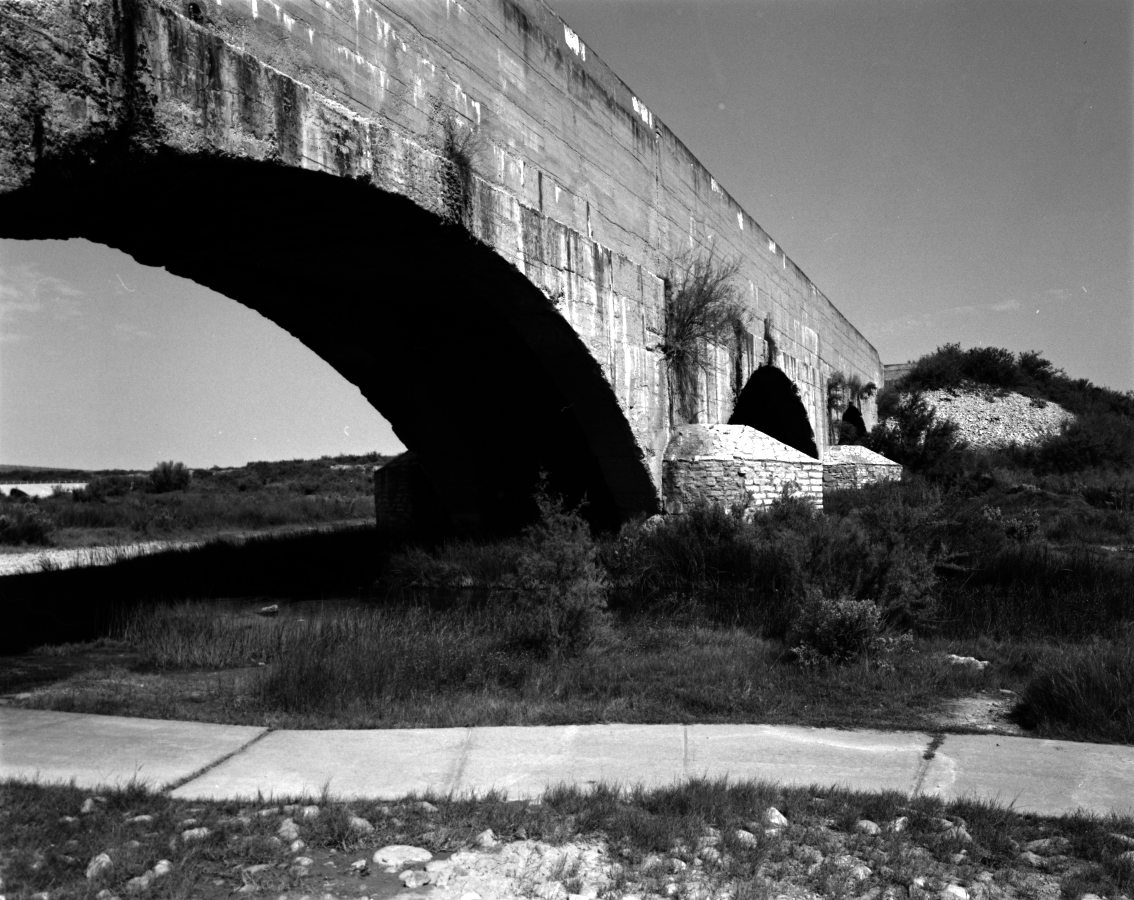

Okay here is my first try. EI 400 DK-50 1:1 9.5 min at 20/68 degrees. Looks like the EI should have been 200-250.
Might want to shoot a speed test series, but that seems about right. Which, to me, suggests that DK-50 isn't one of the better choices for XP2 Super, since other developers (HC-110, for instance) can get good shadow detail at EI 400. Now I'm curious what FX-55 could do with it -- John Finch showed with testing in video that it gains 2/3 stop with Ilford FP4+ (= EI 200), as opposed to the 2/3 stop loss in D-23 (= EI 80).
