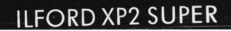

Well, Rudeofus has put his finger on something: there is a difference in sharpness of the annotations on the film edge.
C-41:
Rodinal:
HC-110:
There is one difficulty with these scans, and that's because they were made on a Hasselblad X1, and if you know what the holders are like you will appreciate that to scan the edge that edge of the film strip was unsupported. The 'Virtual drum' ought to nullify any variation in height from the CCD, but it might not be perfect, but that probably explains the weird 'O' in the Rodinal version of the word 'Ilford". All scanned at 3000dpi and no adjustments made.
I don't feel this is an issue in practice. There's enough sharpness on here to keep me happy as I'm not trying to recreate the output of a digital camera:
