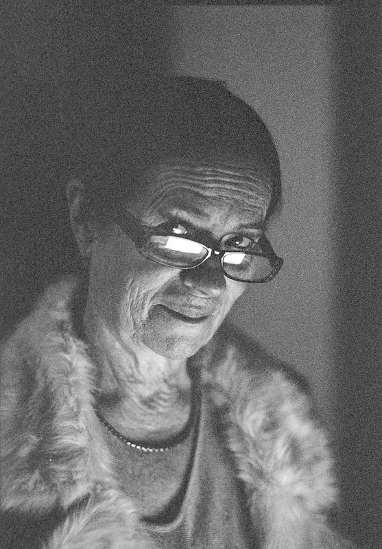

Good question. I don't have the option of commercial development, save for driving a 100km roundtrip to deliver the film and again to pick it up a week later. So I develop myself, and only landed on XP2 when I saw that it could produce little or no grain. I stocked up my film freezer, not knowing at the time that a surprise was in store for me that now means I can use a film a day. After I finished chemo I started experimenting and now I'm confident of my results. It's only in the last few weeks I decided to try pulling and pushing it after being told on an unnamed forum (no, not APUG), yet again, that it wasn't possible to develop XP2 in anything other than C-41. So rather than just bumbling along doing it at ISO 400, I thought it might be worthwhile to try to pull and push the developing just as one does with silver halide films - I assumed those who didn't believe it possible at box speed might be inspired to look more closely if really good results were easily obtained at unusual speeds. It turns out that it is possible, and the noteworthy thing is that I can push it 3 stops and still have no grain. So my only interest here is to inform people that this is an option - easy, cheap home developing, and the option of pulling and pushing, and no grain. I'm no darkroom wizard, and I can't do the last bit with Tri-X or HP5, though perhaps others can.
I've started a 35mm XP2 at 3200, and I'll do my best to burn through it tomorrow and show some results.
The other big outstanding task is for an experienced wet printer to see if these negatives can usefully sit under enlargers (I assume Ilford feels they can do so quite nicely after C-41 processing, as they bothered to make a chromogenic film that could be printed on B&W paper, unlike Kodak's BW400CN, which requires colour paper and RA-4). I'm doing stuff here that is rather out of my depth - for example, I'm using the histogram that I see in the scanning software of my X1 to adjust the developing time - I've not heard anyone talk about that but it seems reasonable. But as long as I'm getting somewhere it seems worth the bother. Believe me, I wouldn't venture into this dragon's den unless I felt it was worthwhile.

I've just hung up the 35mm XP2 to dry, and I see a problem. The same thing happened with the 120 film - some of the frames are very thin and are probably unusable. When it happened with the 120 film, I assumed that since some were fine, and some were thin, that perhaps the shutter in my ancient Sonnar 150/4 wasn't working at some speeds (they were taken on a tripod at speeds like 1/8 and 1/4 which I probably hadn't used before). But this 35mm film has just come out of an F6 which hasn't had any problems at all and it's showing the same thing. Is it possible that the film has a threshold below which it won't register much of anything? Perhaps PE can enlighten us? There were no problems with the films going on the Hewes reels and no indication that the film had been in contact with itself or anything of that sort.
So if it's going to be hit or miss I can't recommend 3200. When it's dry, I'll scan and show any decent ones simply to assess any graininess in the smaller format, but in future I'll limit myself to 1600 which didn't have that problem at all.

The two scans in post #36 are typical of what you get when you develop ANY chromogenic film in conventional developers, lack of contrast and density.
pentaxuser
May 9, 2005
20,159
Daventry, No
I hadn't noticed any lack of contrast and density in the earlier scans the OP showed despite some being at two stops under. If he had shown his scans in the gallery other than the 3200 ones in post #36, I wonder how many of us would have said they lacked contrast and density?
My conclusion is that 3200 in B&W is a stop too far but 3200 in C41 may be a stop too far as well but if you are a hybrid user then XP2+ in B&W chemicals appears to work and in the OP's circumstances appears to make sense.
Those are tests at EI 3200. The examples when using XP2 at 400 and 200 look good, they don't seem to show any "lack of contrast and density"
I'm perfectly happy with the results up to the last two, where I have taken it too far. Perhaps you would show us some of your chromogenic films developed in B&W developers so we may see why you hold your opinion?:whistling:
Uh... Did you read the first page and see the results? The scans you are referring to are shot at 3200 so your statement doesn't really pass muster.
