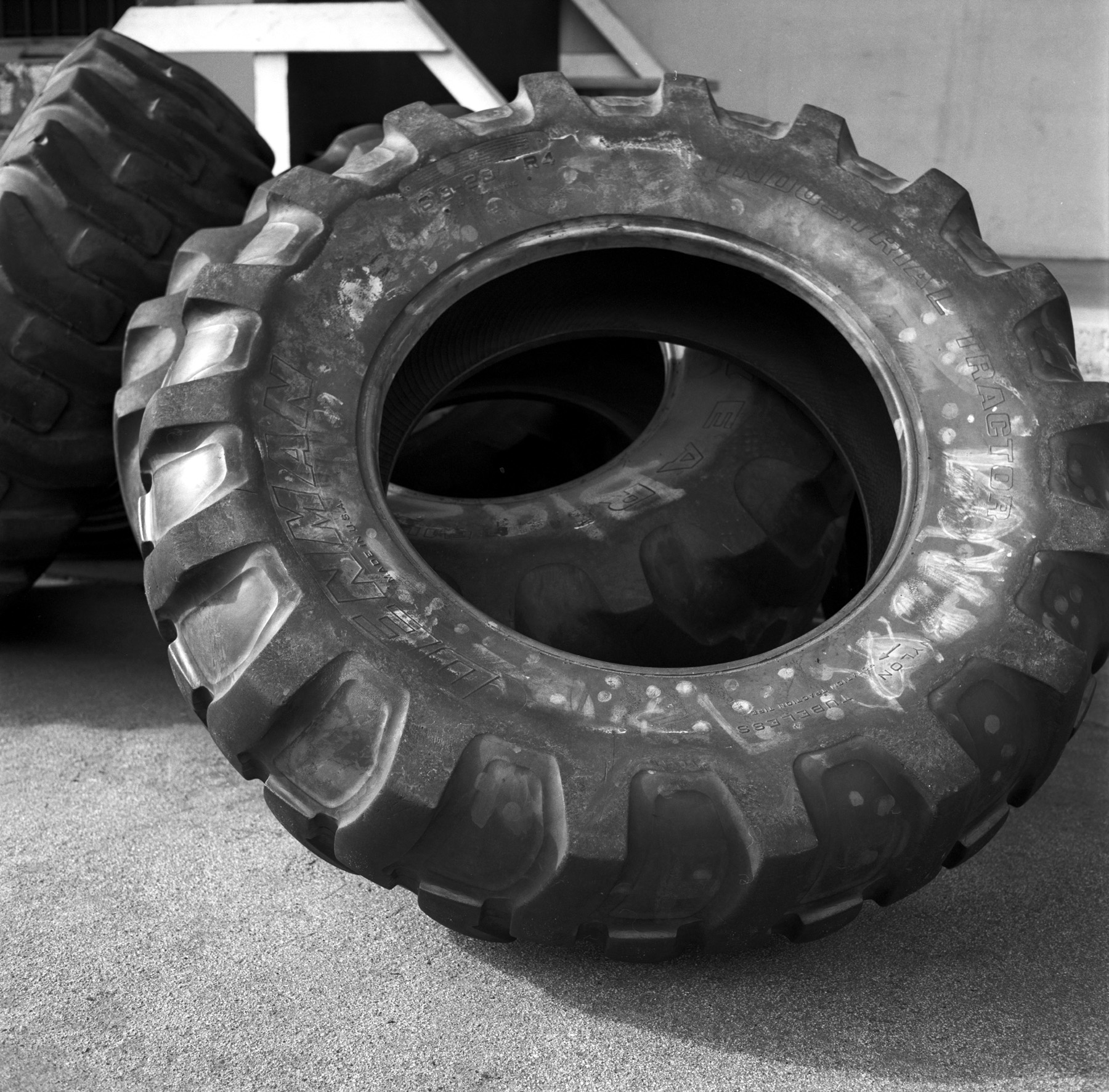

I ran some XP2 through my freshly serviced Minolta Autocord that I received back from Karl Byran.
I shot it a 400 and developed in HC110 for 10 minutes agitation 1 minute and then 10 seconds each minute water stop and fix in TF4 for 7 mins.
Chris
I read your page on developing XP-2 in B/W chems and wanted to know if you got similar results with normal agitation as I don't have a rodinax or a way to do constant agitation.
Did you finalize on 7 mins for EI200? or stay at 6:30 mins.
Here are a couple from the recent roll, as you stated these are easy to scan, I am using a V800 for mine and minor adjustments in my PS Elements2
Tire
Pipe
growth
Like the earlier shots I commented on, these look fine as well in B&W chemicals. I suppose the pertinent questions are: Do you still get the lack of grain that you would get with C41 chemicals and do actual prints from chromogenic B&W C41 negs processed in trad B&W chemicals look better/as good/ worse than those prints from chromogenic negs processed in C41?
How do the prints from either process with a chromogenic film compare to a trad film in trad B&W chemicals?
pentaxuser
Don,
Those look very fine! It seems to work OK with intermittent agitation, and sometimes I think I need a bit less time with the continuous agitation of the Rondinax, but mostly I just forget and use my standard times. And, yes, I give ISO 200 seven minutes instead of six and a half - by coincidence I did exactly that yesterday, also using a TLR like you.
pentaxuser,
The grain is very fine indeed, just as you would expect, and the negatives look very much like they do after C-41 processing, always with some degree of purple hue (more noticeable in 35mm than 120). They print fine, but you do have to allow for rather longer exposures than you might guess at, again because of the purple base.
