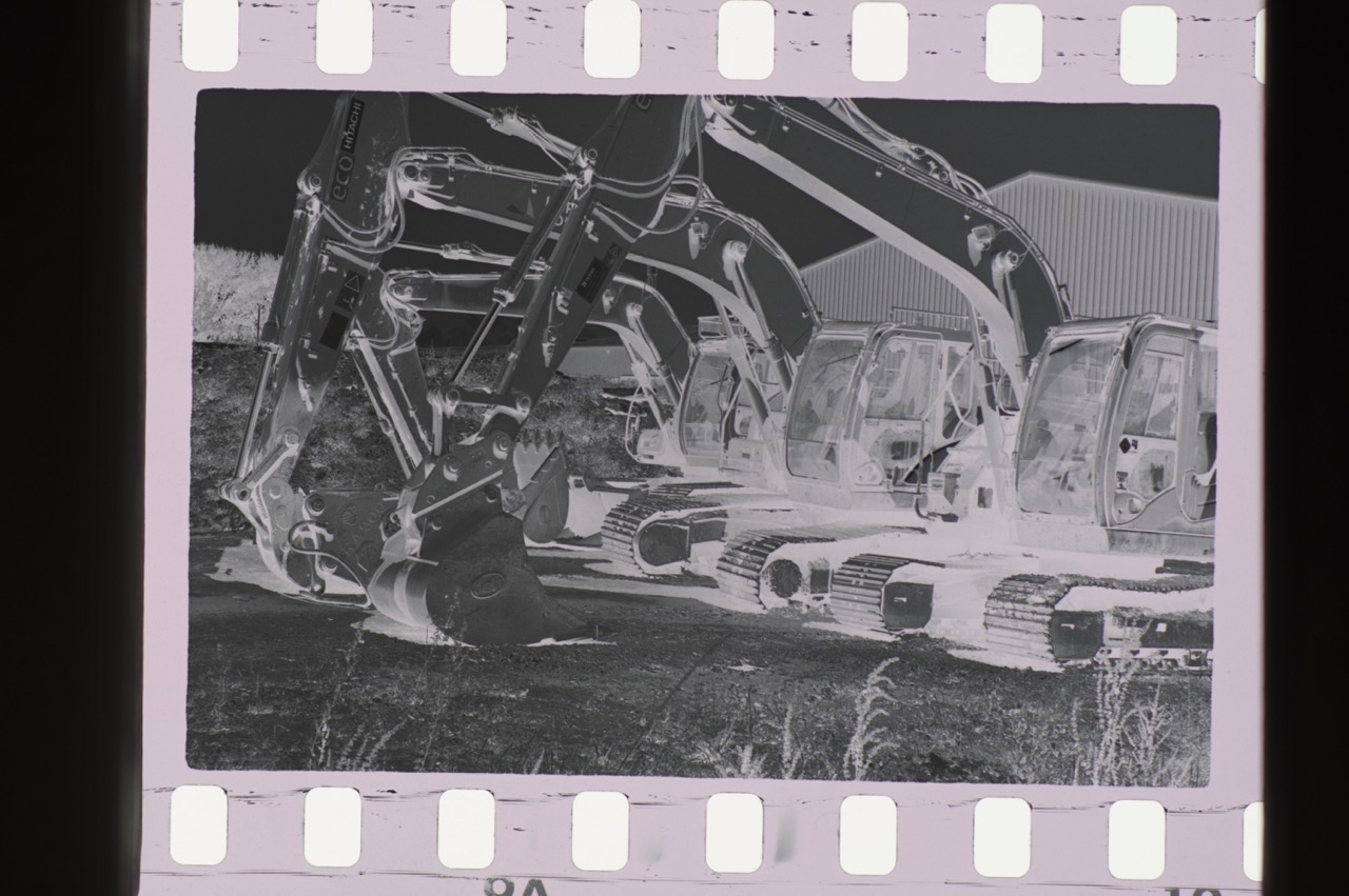

yesterday i went a bit crazy and developed the XP2 along with a roll of very expired Orwo NP27 in Caffenol. I semi stand developed it in the C-L recipe for 65 minutes at 20c. i gave it 3 agitations at 2,4,8,16 & 32 minutes. the results were fairly good but not a patch on C41. Stand isn't my favourite method. whilst it allows you to go off and do other stuff you are still tied and the results don't blow me away. i need to do another roll in Rodinal but i suspect the rest will be in HC110. i dont think buying this film was a big mistake, it was cheap, but Rollei Retro 400s has just come in stock for less than this "cheap" roll and that is both beautiful and predictable in the chemicals i use. The XP2 in B&W chem experiment will be fun but i dont think i will be repeating it.
This is another shot from the roll. coming from digital i was always messing up exposure. comments in this thread have helped me immensely and encouraged me to work on it. it is still a work in progress

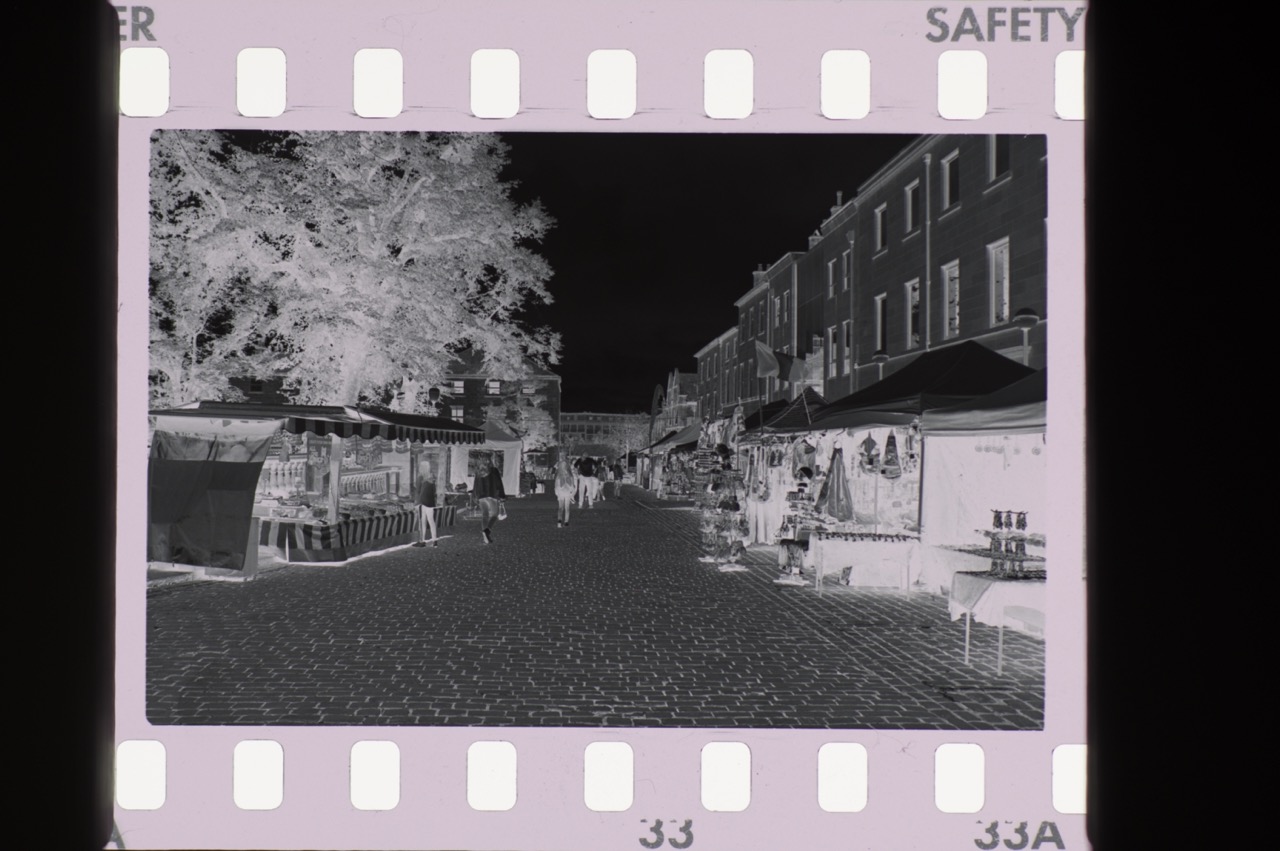

just for comparison, this was the 30 year expired Orwo NP27 that shared a tank full of caffenol with the XP2

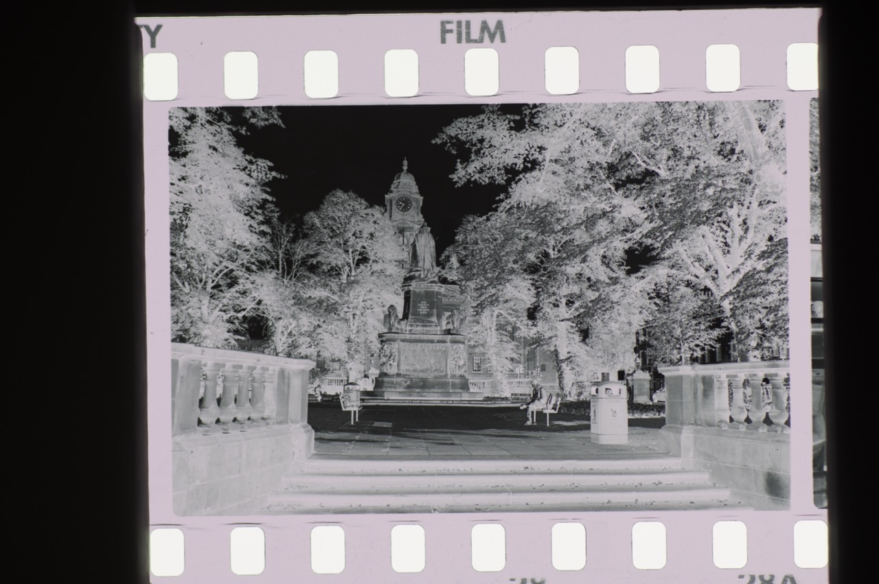

Thanks :smile: I am going to shoot another roll at 400 but I may be sticking with 100 after that because whoever suggested shooting XP2 at 100 is a genius. I have never been happier with a set of negatives.this image has not been enhanced at all.
Below is Ilford xp2 shot at 100 & developed at 20° in stock ID-11 as per massive dev. I reduced the time by 20% + 20% to allow for pulling then added 40% because this is film 5 in this solution.

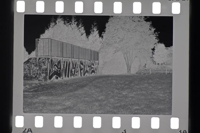

I did another roll in ID-11 but i reduced the base time by 30 seconds. the results were nice but i think it is still over developed so i will reduce it further. its lovely film though
ok, this time i developed the XP2 in stock id_11 with a base time of 10 minutes (I am adding 10% for each additional use). i am happier with these than i was with those developed for 13 minutes. this will do for the ID-11 experiments. i am going to do the next roll in HC110, following Chris's development time
