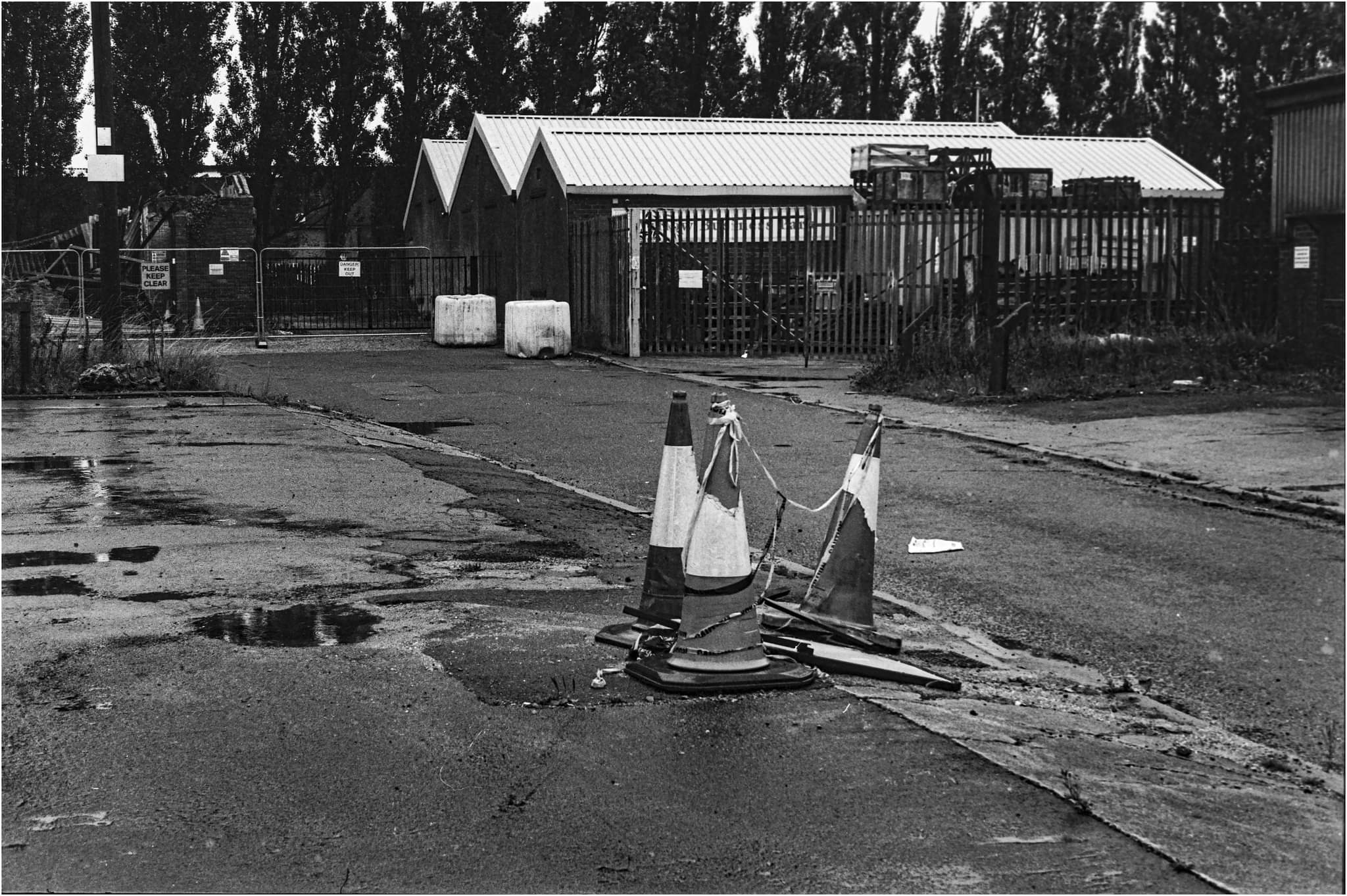

I bought a bulk roll of XP2, it was very cheap :smile: i dont do C41 and was encouraged by images online that it was worth a go in HC110. I hoped I was getting a 400 film to compliment my other bulk rolls but it looks like it may be best at 100. Anyway, so far I have done one roll in HC110 1:49 for 10mins as per Chris's suggestion here. It was OK. I have a couple more test rolls ready to go in, one will be done in HC110 1:31 and the other in rodinal 1:25. In most cases of developing 400iso film there are only a couple of minutes between these dilutions but the wisdom here and on massive dev and dev-it is that rodders needs 18mins whilst HC110 is done in 5:30. I did wonder if 18 was a typo and it should really be 8. I know this isn't an exact science because I am not developing as intended so in the spirit of winging it, what rodders time would you guys go for first? Having a bulk roll means I can experiment to my hearts content so any suggestions will be great fully received. BTW, I am a relative beginner but do love a good experiment. Below is a test shot cooked in HC110 1:49 shot on a very dull day @400

@Cerebum: My suggestion is to not use an entire roll for testing. A small strip of 5-6 frames should be good enough to get the development times right.
XTol will give you better shadows and overall better results for this film. Pyrocat HD also works fine.
For EI:100 or 125, use 75% of FP4+ times (at same EI) as the starting point for testing any developer.
There's substantial loss in shadow details at EI:400. At EI:100 the film really shines giving very good overall results.

Thanks :smile: I am making up very short rolls for testing, no more than ten frames, the joys of bulk loading :smile:

Now, to answer your question on Rodinal, 18 minutes might be a little too long. Here is what MDC says about FP4+ @EI:125 in Rodinal 1+25:
Ilford FP4+ Rodinal 1+25 125 9 9 9 20C
Based on my rule of thumb, as a starting point, I would do a test with 0.75*9 = 6 minutes 45 seconds as the developing time for XP2 Super @EI:100/125. This film builds contrast quickly and hence I would be a bit conservative and try 11-12 minutes for EI:400. YMMV.

Utterly brilliant. My gut feeling, based on zero science and even less experience was 10 minutes, 18 mins felt extreme for 1:25, especially as I have seen recipes for 1:50 at 20mins. I have two test films shot, both at 400, one on my MX, the other on a vitomatic who's light meter was fairly reliable. The MX roll is earmarked for hc110 dilution b, 5:30 @20° the vitomatic will be rodders at 11:30. Fingers crossed :smile: thank you so much :smile:

The Rodders negs were a bit dense and the leader was completely opaque so I think I will try 9mins in rodders next time. I haven't scanned them yet so we will see about the loss of shadow detail. The hc110 ones look lovely :smile:
Sounds good and you seem to be on the right track. You may want to use 1:50 dilution the next time.
Do share your results when you've scanned the negatives.

I tried a 1:50 dilution in RODINAL with the first roll and found it somewhat grainy. I am just working round the possibilities :smile: thank you so much for your kind guidance. If I am still subscribed I will post some of the shots I got from both the Rodinal & the Euro 110 (Bellini's take on HC110)
