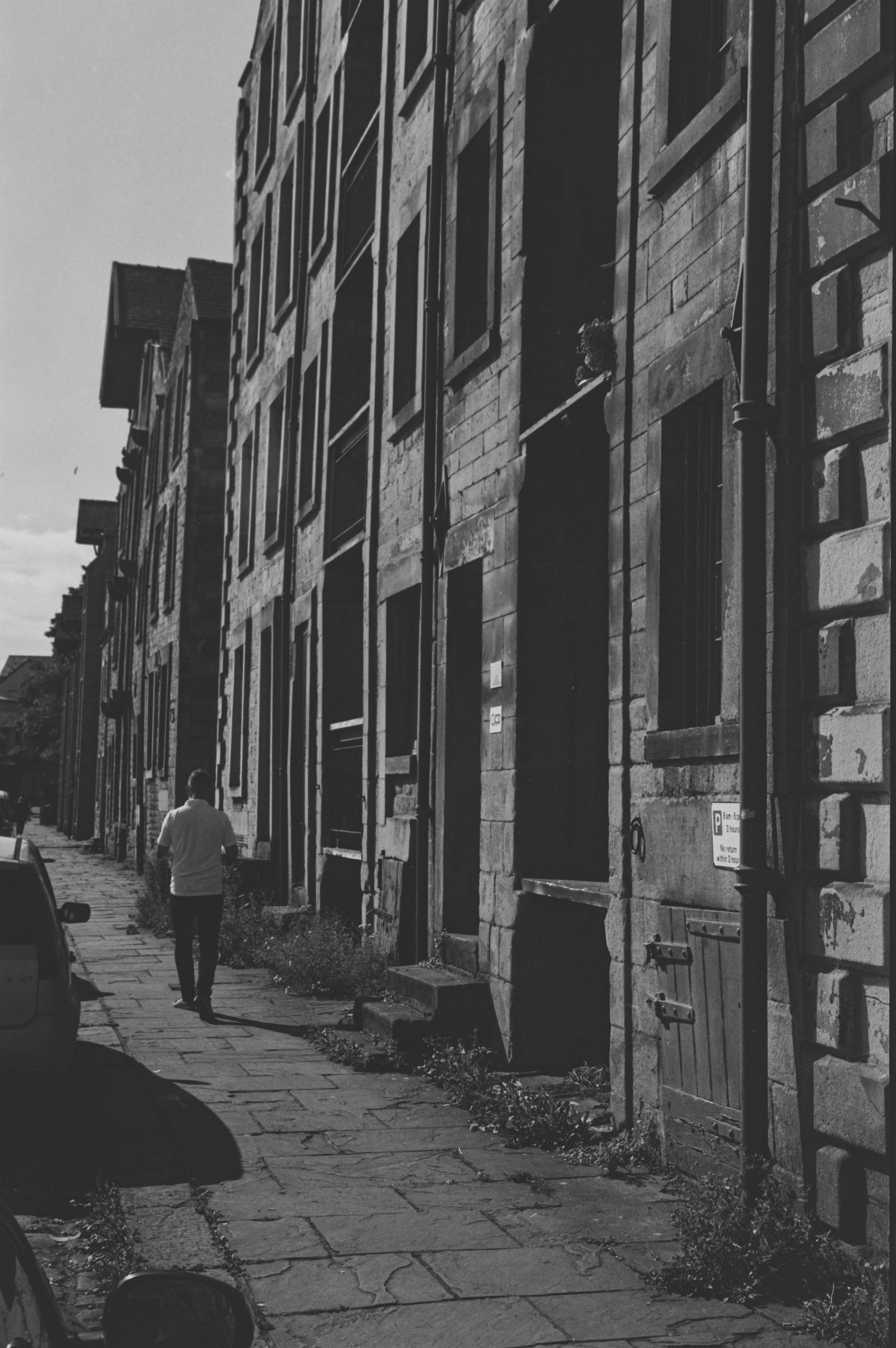

XP2 in Rodinal 1:25. Exposure wise it is actually not bad but the image quality isnt what i hoped for

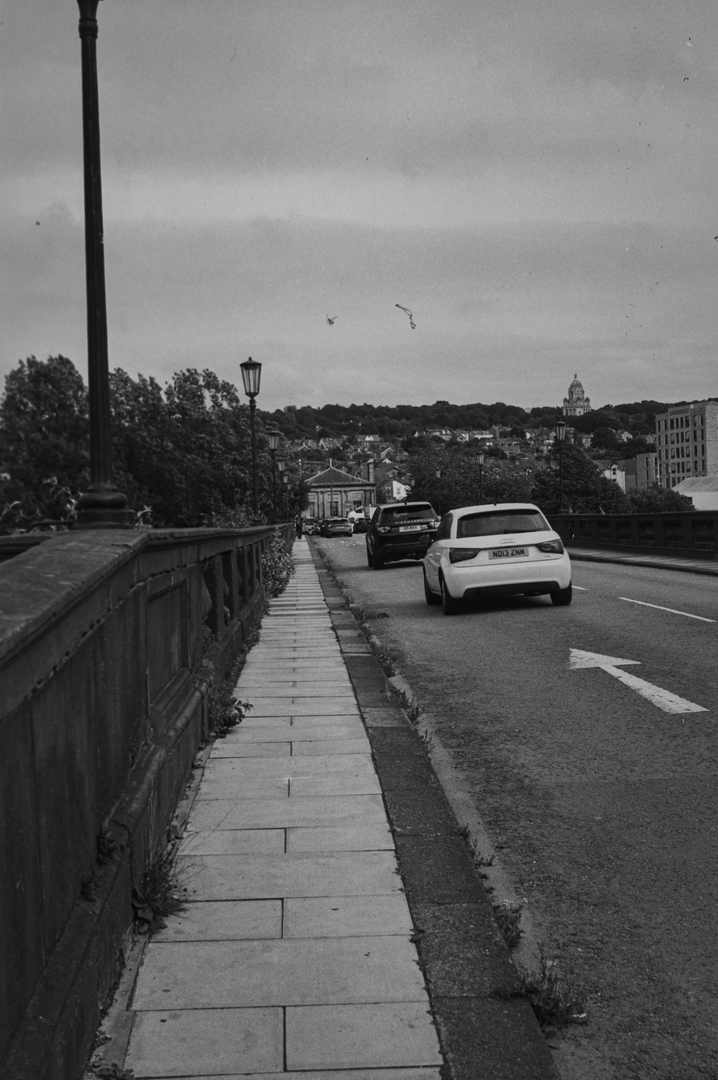

XP2 in HC110 dilution B
Looks like a camera limitation rather than a film/developer issue. What lens was that?
Thank you, thats encouraging. the roll of rodinal was in a Voigtlander Vitomatic ii rangefinder. I will try again but this time in my MX. i wanted to bash out a few frames and it was the first camera to hand. the HC110 image was from the MX but that was sporting an A series zoom, so that can be improved upon as well :smile:

PS: your strip on the right (HC110, right?) looks significantly under-developed, and probably also underexposed. The one on the left looks properly exposed, and perhaps developed a tad long, which would not bother me much; it's usually better to have a little too much density than not enough.

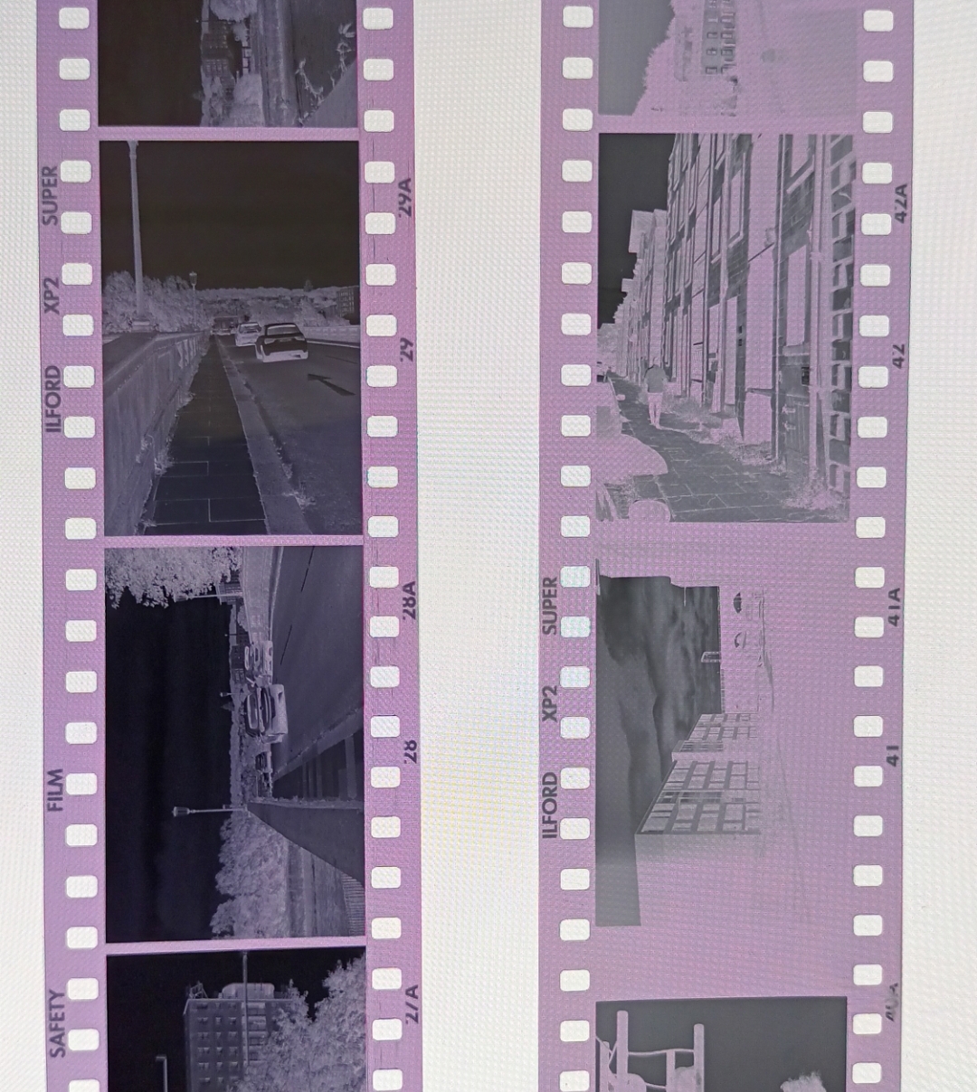

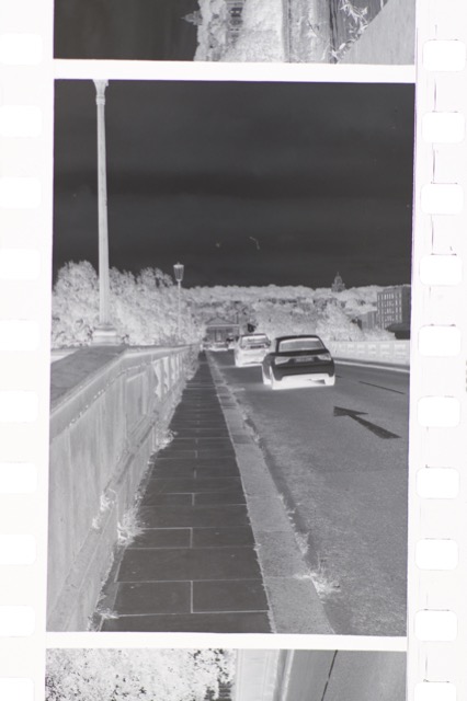

Can you take a pic of the two negatives using your phone's camera and share the same?
One thing that just occurred to me, I used the vitomatic on board meter. It is quite possibly a bit out, although the Rodinal leader is wholly black whereas the hc110 is slightly opaque
Well, I'm sorry if I hurt your feelings, but I had to re-read your initial post in which you spoke of 'Rodders' a couple of time to figure out what you meant. That you use the term colloquially doesn't mean everyone just 'gets' it. Furthermore, this being an international forum, unnecessarily oblique language doesn't help participants who are non-native speakers (or even, 'barely speakers') to grasp what is going on. Perhaps my reply was unnecessarily sarcastic, in which case I apologize, but the undertone was serious: I personally would indeed prefer it if people would stick with official names, for clarity's sake. This in no means has to stand in the way of a pleasant exchange; quite the contrary.

Right side strip is underexposed as expected as your EI is 400. It is also underdeveloped. You can increase developing time but it won't compensate for the underexposure.
Left side strip looks adequately exposed (as if your EI was 100) but overdeveloped. You can reduce developing time by 20-25%.
BTW could it be that your Vito camera is overexposing by a stop or two? :smile:
Its actually the other way round, the under exposed shots came from the MX. I strongly suspect its my fault and i need to be more careful.

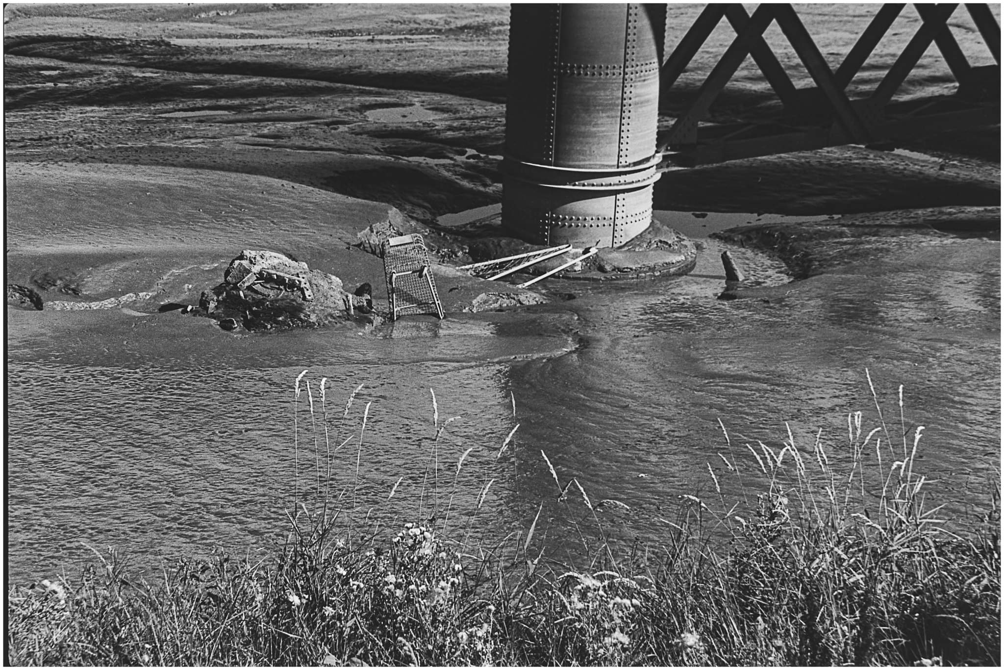

Rodinal and its various clones are well known as speed losing developers -- anywhere from 1/3 to 2/3 stop off what you'd get with D-76 in the same process, depending on the film. So this isn't unexpected, though XP2 Super has enough latitude you'll probably do fine with it unless you're one of those who digs into their shadows with a loupe.
What I did with Parodinal when I used it a lot was to used high dilution (1:50) and reduce agitation to every third minute, and then extend development (worked out to about 2x MDC time) to restore normal contrast. This recovered all of that speed (maybe even a bit more) through compensating effect combined with giving the dilute developer plenty of time to work on the shadow regions, and ought to work as well with XP2 Super as it did with Foma 400. Doesn't do any favors on grain, but I didn't find it objectionable from Foma 400 (even 35 mm), and XP2 Super should be finer in the same developer.

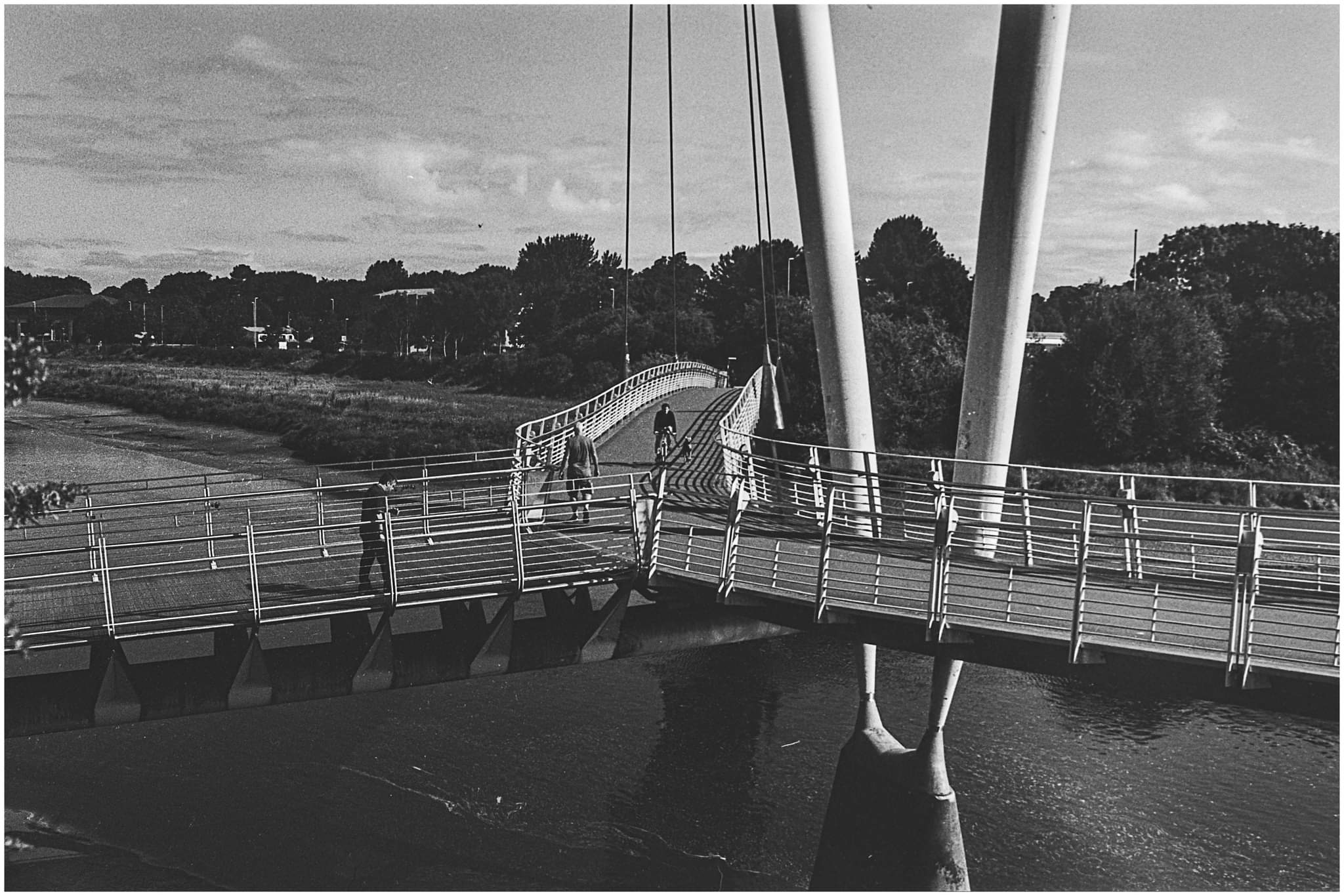

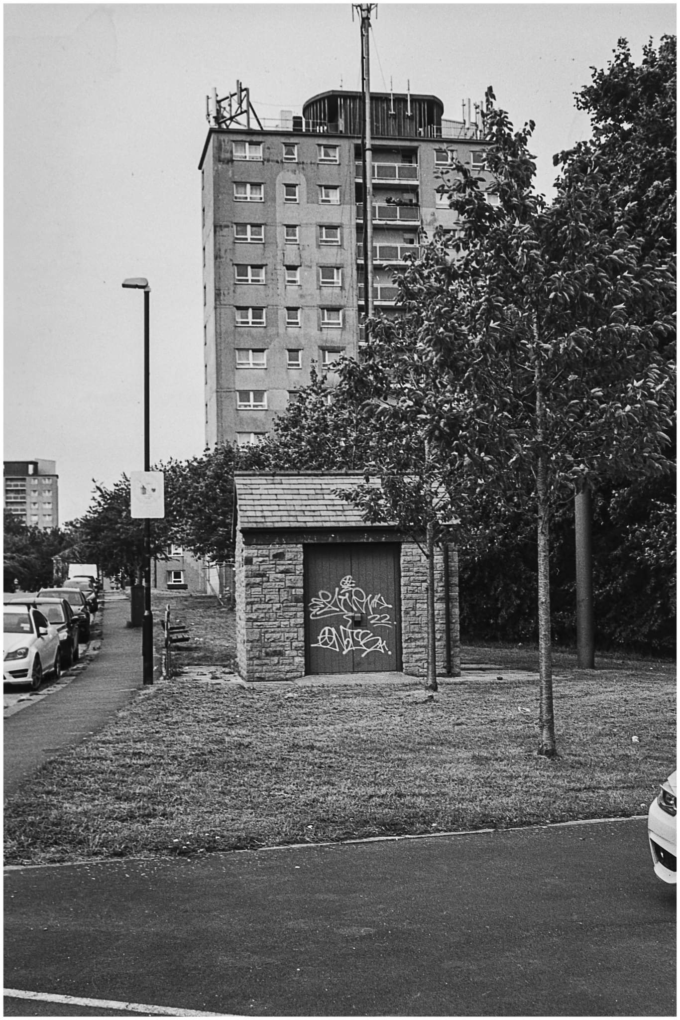

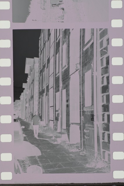

Isn't if funny how some people swear by it. When I was processing the scans I could see that everything you said about the exposure was bang on the trolley in the mud was bang on but the whole scene is a grey card lol. The bridge was close but I soon get nasties in the sky when I try to bring out the detail (both HC110), the tower was rodinal and needed little work because the ambient light meter on the vitomatic gave me a decent exposure.
