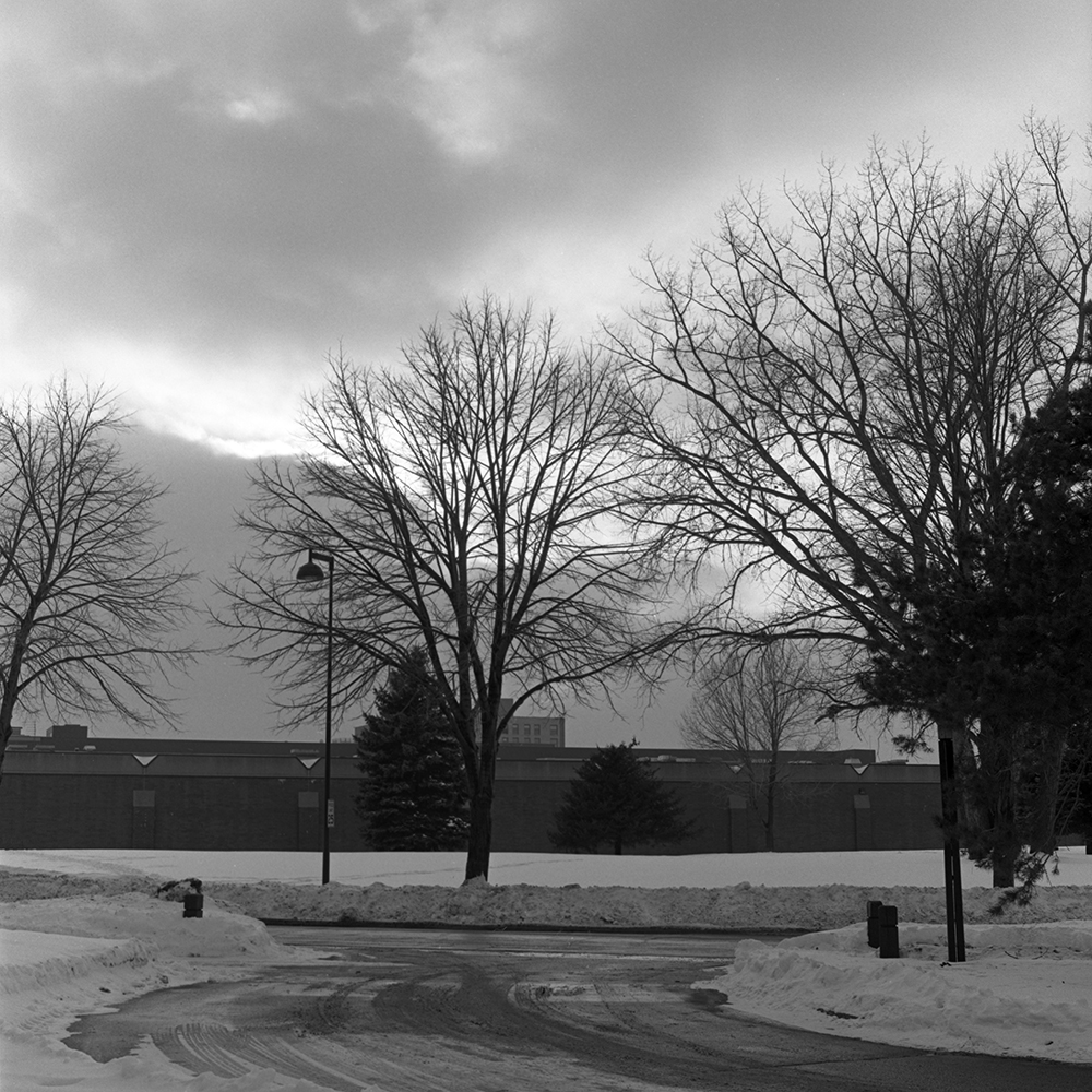

Just for the record, here is a quick scan of one of the frames from my test roll.
As explained earlier, I used exactly the same work flow as with the 'old' brick of film, because I only want to change one thing at a time when I troubleshoot. The light was not ideal, and there's a lot more texture in the sky, but I see no uneven density from side to side in the frame.
I will try using the film without presoaking too, as it isn't suggested anywhere in Ilford's literature. But I believe 100% that my problem is solved. If Ilford wants to see the film for their records, then I'll happily send it. But I'm satisfied with the solution, even though it provides no definitive answers.
Thanks all for chiming in and helping out.

The thing that bothers me the most, Bob, after thinking about it, is:
I bought ten rolls of HP5+ in a brick. Every roll I have used from it has exhibited uneven densities. That is from using three different developers, replenished Edwal 12, replenished Xtol, and D76 1+1, some shot and processed last summer, and some this winter.
