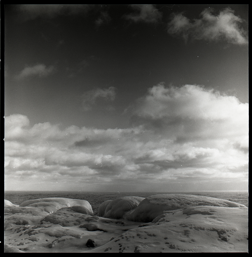

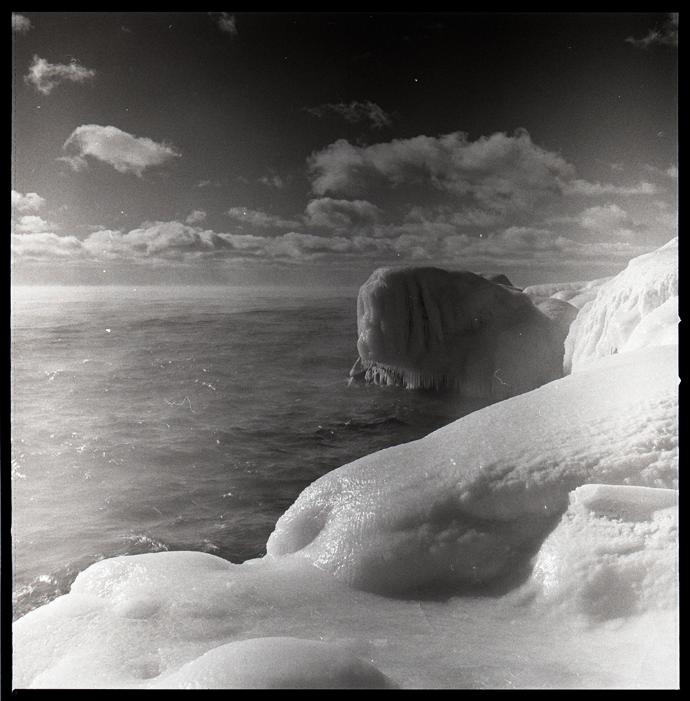

Could you post a picture of the problem?
Here you go.
This is after I processed TMax 400 successfully, and then after I processed TMax 400 successfully - shot in the same camera, at the same time, at the same location, under the same circumstances.
Pardon dust and sloppy scans, I didn't prep the negs or do anything to them after they were scanned on 'everything auto'. Just wanted to see what was there.

Both examples look uneven to my eye, so it's not the film.
How do you conclude that? It's blatantly obvious that the densities are uneven, but look at the picture I posted using TMax 400 film earlier in the thread. Everything the same way.
I just can't fathom that ten rolls out of ten with the same brick of HP5+ 120 has uneven densities, and every other roll of film since five years have been perfect. What am I missing here?

Sorry I edited my post. Yes, I stated that they are uneven. I didn't say they weren't.
I was confused with this. Are they side-by-side comparisions of TMY and HP5?? Clarify.

Here you go.
Thomas, I was testing a new(well to me anyway) Hasselblad 553ELX I just got to make sure it was up to snuff in the TTL flash area. I took a roll of the cheapest film I had on hand, which was Arista EDU 200/Foma 200, and ran it through the camera. I had just the day before mixed up a liter of Beutler A-B developer. I used a presoak for 3 1/2 minutes and then ran it through the Beutler 1:1:10 with 30sec initial agitation and then 2 slow inversions every minute thereafter. There was a center strip where the density looked fine but the outer edges looked just like yours only not quite as wide. It was a test roll and I new the camera was fine and laid blame on the agitation scheme or lack there of. Never in a million years would I guess the presoak might have something to do with it, but I an't no rocket scientist so who knows. The only reason I used a presoak is so I could penetrate that anti-halation backing on the Foma films. The only other times I presoak are with Pyro/WD2D+ and Pyrocat-MC where it is recommended and there was no problem there.
As for cold temps? You could move! Seriously, you could load your tank and take it upstairs and let it set on the kitchen counter while you have a beer/coffee or two. Then just use the kitchen sink with a shallow bowl of tempered water. I did that for years before I got serious and built a real darkroom. I'm sure millions still do, will maybe thousands now that digital is here. If your better half say, "Outta here" then just do the same routine, bring your take upstairs, coffee/beer and in an hour or so back down to the dungeon and in to a tempers shallow bowl and develop it. I have a very nice darkroom, but I still use a Tupperware 8x12? storage container that allows just enough water to come up to the seam on my tank. Works great and I don't see changing it, but I will look into this "presoak thing" a little closer. Oh, and if you do use a Tupperware container just make sure it isn't one of your honey's favorites. Ask me what happens if you do. JohnW
