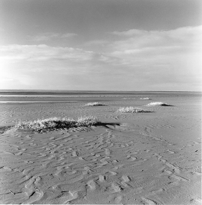

Hi Thomas,
Here you go.
This is after I processed TMax 400 successfully, and then after I processed TMax 400 successfully - shot in the same camera, at the same time, at the same location, under the same circumstances.
Pardon dust and sloppy scans, I didn't prep the negs or do anything to them after they were scanned on 'everything auto'. Just wanted to see what was there.
as it seems you are not the only one having this kind of problems. I am suffering from it too occasionally. Look through my gallery pics closely and you will find them. Most of the time I have it only on one side of the frame but sometimes on both as with this one:
I scan my prints where the edges are burnt in quite a bit so that it's not as obvious as with your negative scans. But you can clearly see it. I do not presoak. So this can not be the source of the problem. I always thought that this may be caused by over developing the edges by additional whirls during agitation ore something like that. It never came to my mind that it would have caused by the film itself. May be I should try some Tri-X in 120 occasionally.
Thomas Bertilsson
Jan 21, 2003
15,715
Switzerland
Ulrich,
I'm not knowledgeable enough about film developing to tell whether you are having the same problem as I am.
Do you use inversion agitation? Do you agitate fairly vigorously for at least the first 30 seconds? How often do you agitate?
Those are the kinds of questions you want to ask yourself.
My guess is that you don't agitate enough, since your film is developed mostly around the edges, and less in the center. That tells me that you're not getting enough fresh developer to the center of the film developing reel.

Very strange, Thomas...
I presoak, too. Never had a problem with HP5+ in either 35mm or 120...D76, Rodinal, Xtol, you name it, inversion or rotary processing.
Granted if that one example of "uneven development" you posted is an example of a "worst case scenario" I would say just forget about it and print them anyway. It's a beautiful photograph.

Another good example of minus development in the middle area, on a very mid tone (grey) scene.
