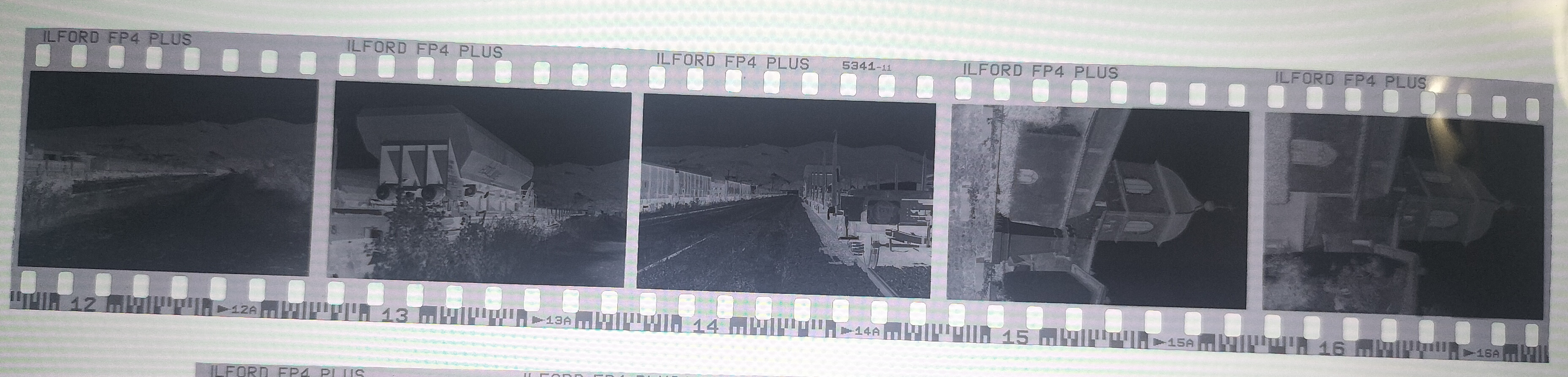

I did shoot FP4+ a few week before OP's threads and coincidentally used HC-110 (b) with Ilford time and agitation. To my eyes the negatives were denser than expected, and I also got bigger grain than anticipated, like HP5+ grain. Turned out the added contrast and grain kind of fitted the mood of some shots captured on a misty morning, so I'm not unhappy.
I'll try tonight but posting "realistic" pictures of negatives that are similar to what our eyes see is a tricky thing really, and it can lead to biased impressions and conclusions. I'll see what I can do. No darkroom prints yet.

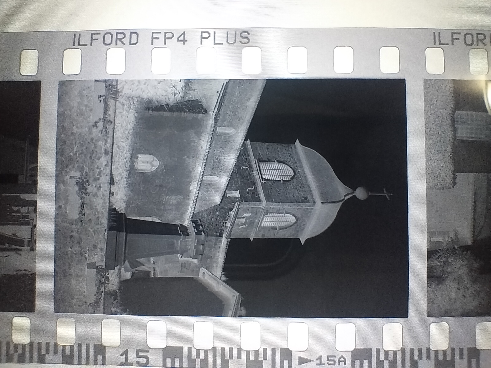

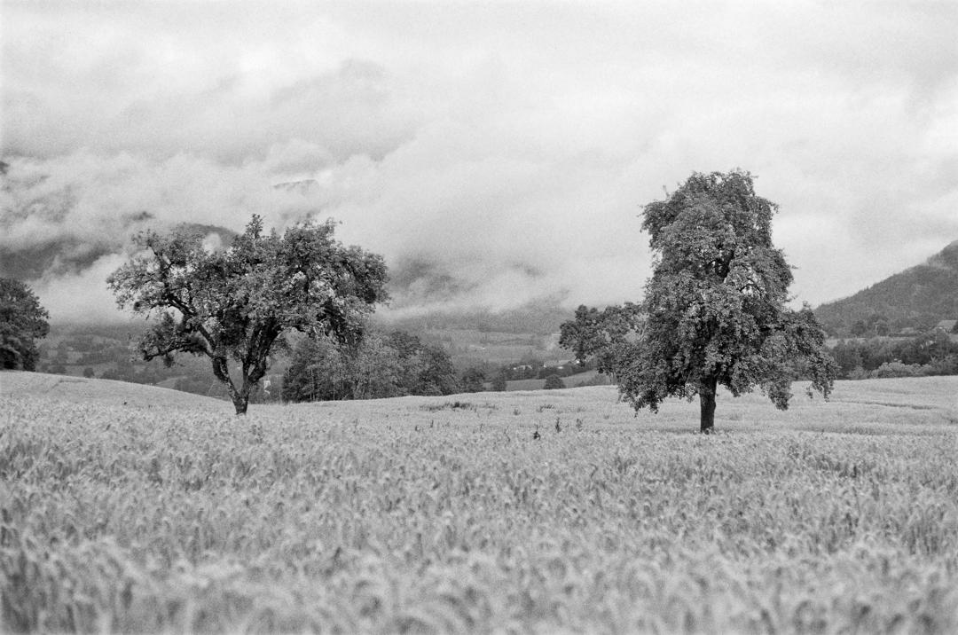

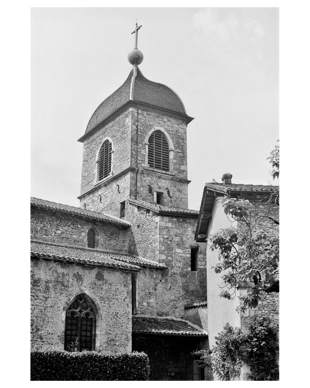

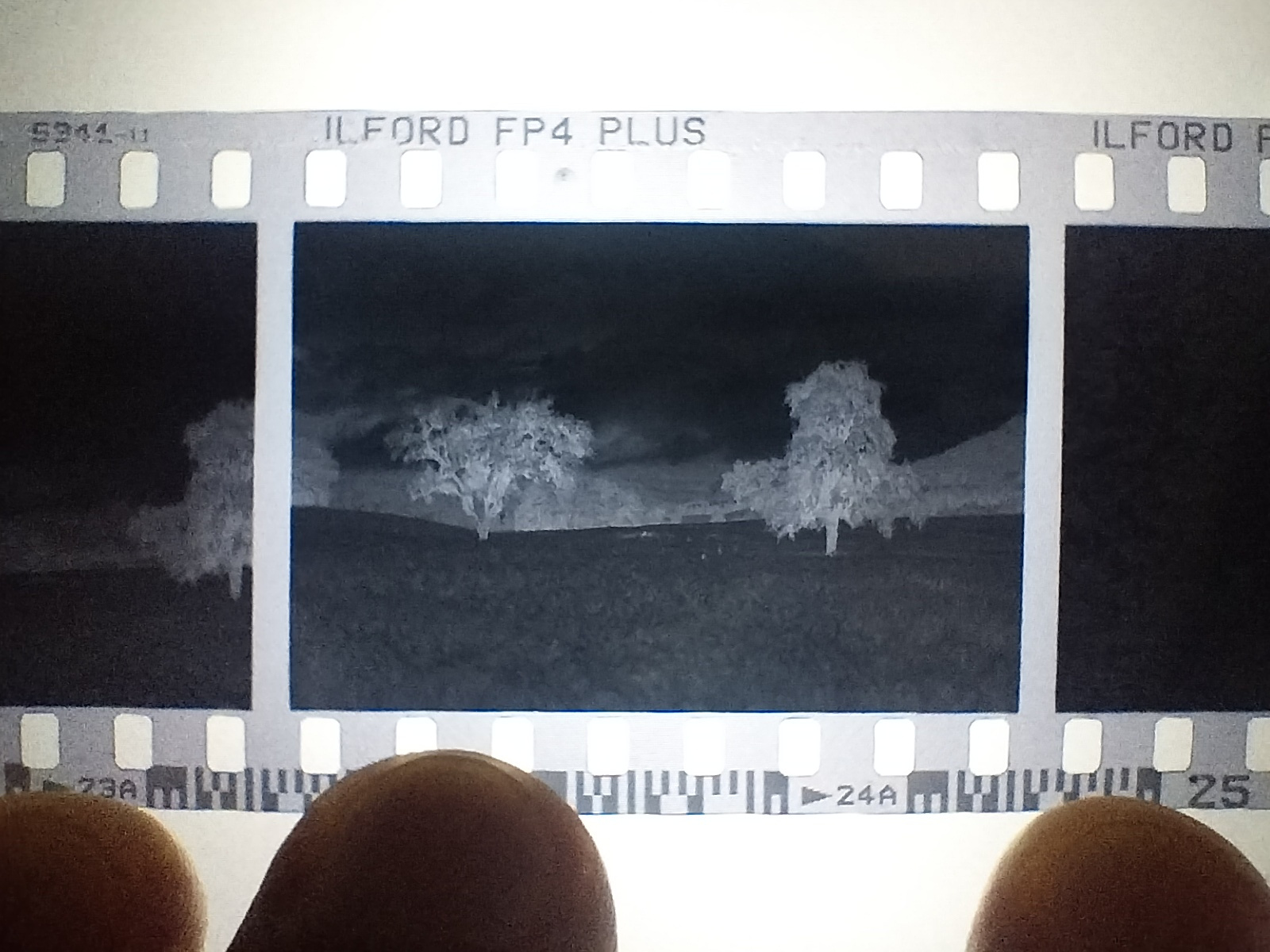

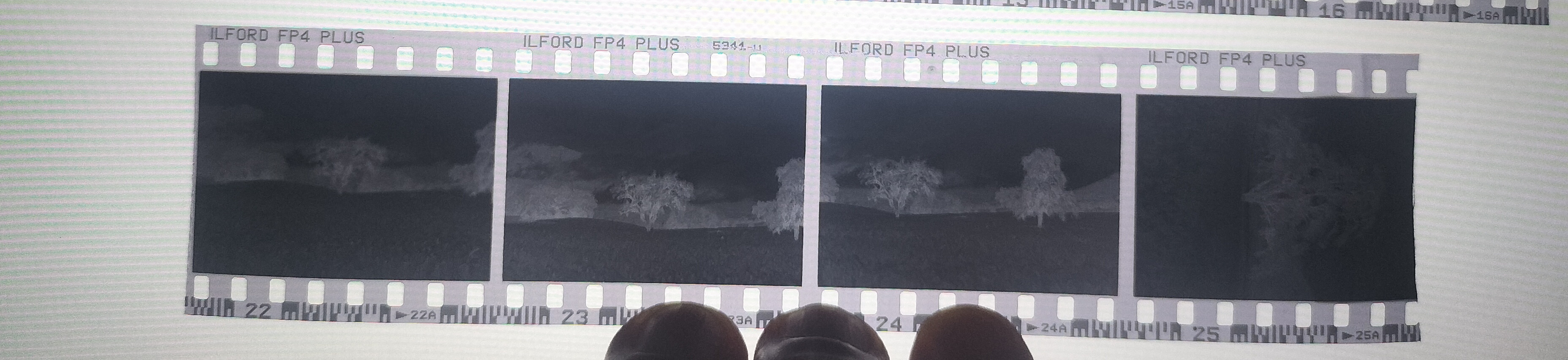

Here are the negatives against the white screen of a tablet computer with full brightness. Look good but as expected the phone photos sucks. Anyway, it should give an idea of the density.
The church was shot on a sunny afternoon, the tree on an overcast morning.
9min in HC-110 (b) at 20°c, Ilford agitation as described in the datasheet ("[...] invert the tank four times during the first 10 seconds, then invert the tank four times again during the first 10 seconds of each further minute.")
Scans in small size just to give an idea of what the positives could look like. Mirroless camera with an old Helios lens and an extension tube. Inversion and post-processing in snapseed.

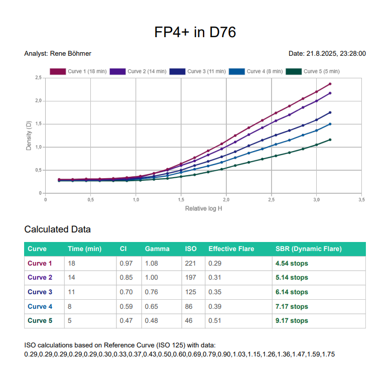

Well, this is Fp4 in D76 1+1. These results provide good Ci values at the recommended 11-min dev time at 125.
All this leads me to the conclusion that HC110 is just not good for Fp4 and the Ilford datasheet is not good advice. The Fp4 in Hc110 is better with 4x5 but not really usable with 135 film, as the contrast is very hard to control with reasonable dilutions without the expense of mayor testing.

the temp in and out was documented properly with a calibrated lab grade thermometer. +/- 0.3 C. I even measured fluid density to ensure proper dilution of the developer. I also documented PH.
As mentioned before my Ci or Gamma values are slightly to high (about 0.05) because of me using a green light and the gamma lambda effect coming into effect.
