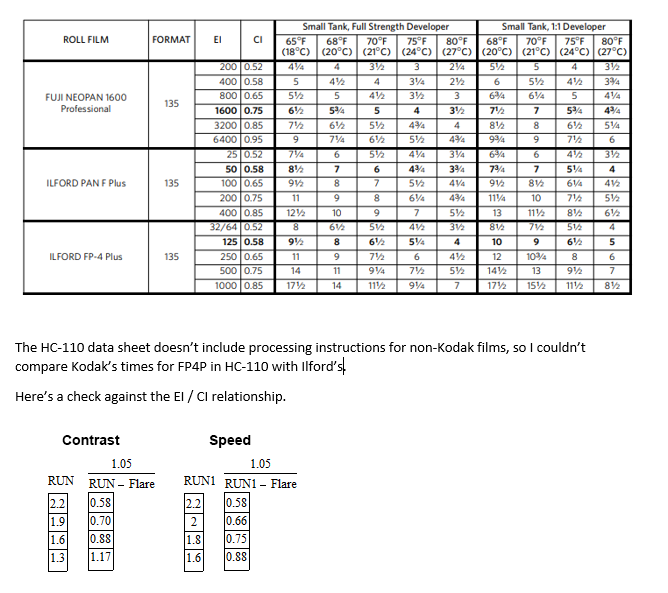

Don't worry. I am a native speaker and I had and still have as much difficulty interpreting what the OP quoted from Ilford originally as you have with it
Once the full reply was shown it appears that contrast may be of minor concern to Ilford or no concern at all in all cases of developer times except those given for ID11.
Ilford says: "We supply the information on our tables to give speeds using different developers but these are more accurately described as EI values (Exposure Index). The contrast at the particular speeds with particular developers will be variable and not something we have ever quoted."
I still wonder how Ilford works outs the times it does give as EI values Is there a formula for it or what
It does give a time for Ilfotec HC of 8 mins for an EI of 125 which is 1 min less than for HC110 Whether this produces a negative that looks more like the OP's neg at 5 mins I have no idea
Hopefully for those who use Ilford film and Ilford developers other than ID11, the resulting contrast of the negative is close to "normal" or close enough that MG papers can cope with the differences

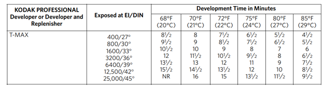

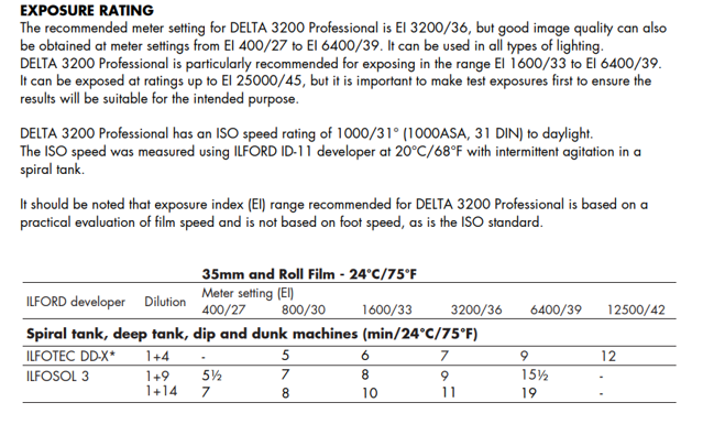

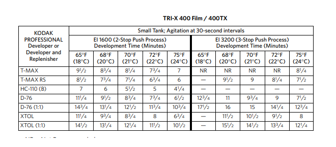

Ilford is just talking about pushing for speed. This is no different than how Kodak’s P3200 or Ilford’s Delta 3200 is approached. Neither has an actual ISO because it can’t with the extended processing and having an ISO just for normal would probably confuse people. Just remember EI is the setting on the meter and not film speed.
From Kodak’s P3200 Data Sheet, “The nominal speed is EI 1000 when the film is processed in KODAK PROFESSIONAL T-MAX Developer or KODAK PROFESSIONAL T-MAX RS Developer and Replenisher, or EI 800 when it is processed in other KODAK black-and-white developers. It was determined in a manner published in ISO standards. For ease in calculating exposure and for consistency with the commonly used scale of film-speed numbers, the nominal speed has been rounded to EI 800.”
From Ilford’s Delta 3200 data sheet,
The ISO prefix can only be used if the conditions of the standard are adhered to. This means testing a large number of rolls over a period of time using multiple batches. It's a laborious and expensive process. The manufacturers are going to limit this level of testing to one or two developers per film. All the other film / developer combinations can be tested using the parameters of the standard minus the large sampling and consequently can't use the ISO prefix. They obviously would also want to do a family of curves for as many combinations as possible. They want to know what their film can do and for the consumer to get the best possible results. The standard only has one set of contrast parameters, so ISO can't be applied to anything processed outside those parameters. But the manufacturer can adhere to how the standard on how the film is exposed, hold times, and such and the film can be assigned an effective film speed. Even with P3200 and Delta3200 data sheets are for each manufacturers’ film, it’s not certain they did the complete ISO protocol.
The data sheets are a balancing act as they need to convey the technical information of the film, but in a way the majority of the general public can understand. Because of this, those with more technical expertise can sometimes get tripped up by the lack of precise language. Ilford uses ISO and it is clearly displayed in the data sheet and on the film box, but the data sheet talk about processing. Here's where the sheets are geared more to the general user. Rather than speed being a product of the characteristics of the film in a given developer at a given gradient, most people use speed as pliable and base the development on the EI rating. Which is technically wrong. When the manufacturer offers a development time based on the EI rating higher than the the film's ISO rating, they know the extended development won't increase the effective film speed to the new EI rating, but will restore density range which is most likely lost because of underexposure. Kodak’s P3200 data sheet, “When you need a higher speed, you can expose this film at EI 3200 or 6400. At these speeds, there will be a slight increase in contrast and graininess with additional loss of shadow detail.” In other words pushing for speed.
As far as I can tell, the main difference between the two manufacturers is that Kodak appears to use the rule of 2/3 stop contrast for every stop underexposure, where Ilford appears to use field testing to confirm acceptable results (although there is no way they don't know the sensitometric values or haven't run family of curves on all the different films).
Kodak actually includes their CI values in their Xtol data sheet:
And from Kodak’s Tri-X data sheet:
How is it any different than Ilford’s? Kodak didn’t list the ISO processed in other developers and this is their own film and developers. What most likely happened with the OP’s FP4P experience is experimental error, but it’s not unheard that the data sheets contain errors. It’s hard to compare recommended development between Kodak and I Ilford for a given film because Kodak rarely acknowledge other films and developers existed, but the Xtol data sheet is different. Kodak has FP4P as 8 min. Ilford has it as 8.5 min. Their respective average gradients for normal development are 0.58 and 0.62, so that lines up.

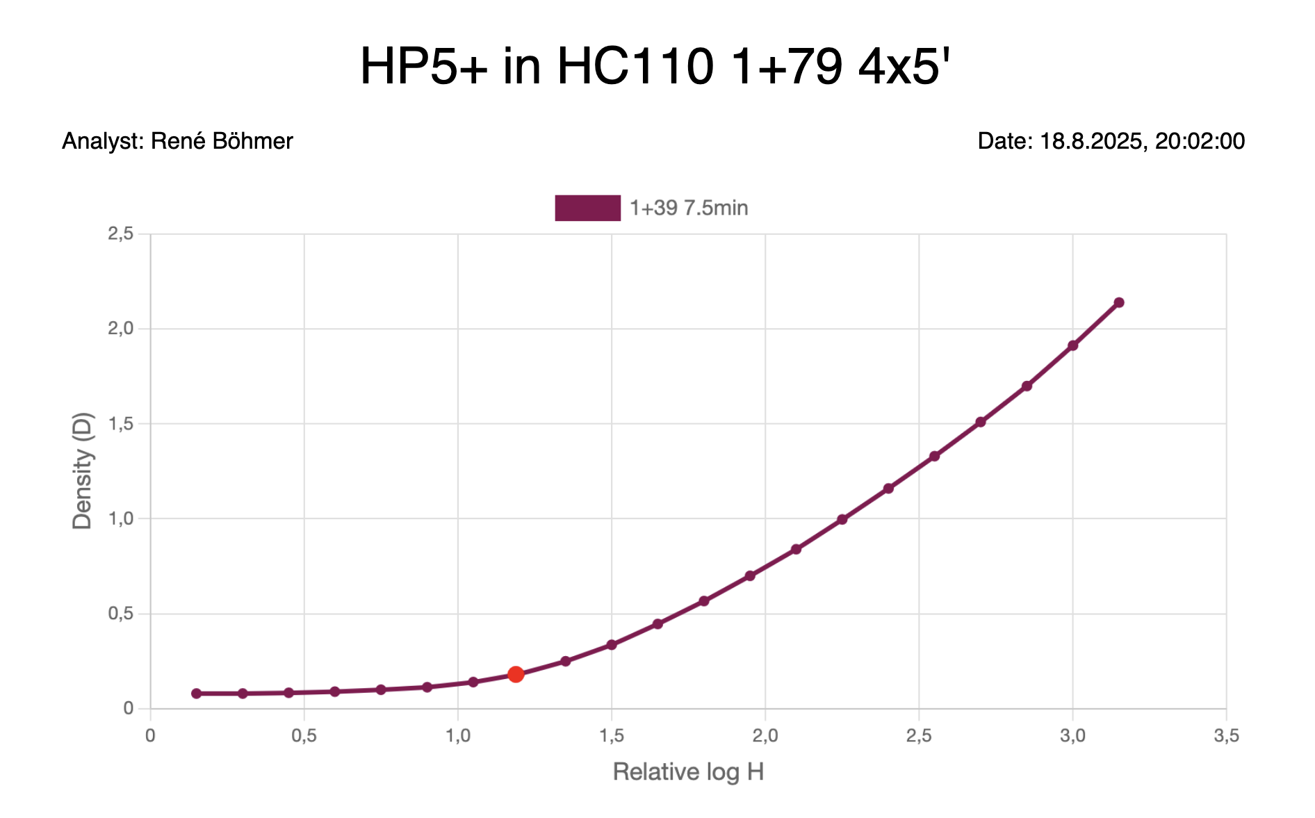

I have retested FP4 in 31+1 9min (around 7.5 for continuous agitation) 20C for 4x5 Film and this is the result. Ci of approx. 0.85. This is good in my opinion. My other results might very well be my error, I have no clue what caused it though.
dokko
Oct 4, 2023
381
Berlin
thanks for double checking the result, always a good idea when something is wildly off.
my guess is that in the first test, something went with the dilution of the concentrate and you ended up with a higher concentration than you thought you had.
might be a good idea to add a disclaimer in the original post about the re-testing so people don't get confused when they discover this thread later on.
The graph is marked as being for HP5+? Wrong graph, wrong lettering or am I missing something?

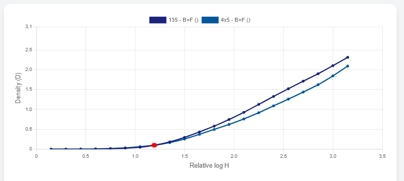

This isn't over. The test with Ci of 0.80 was 4x5 Film in Hc110 1+31 20C, the Ci of 1.1 remains for the 35mm film. Both Ci values are too high for the average scene. I have re-tested these times in fresh chemicals with new films and always reach the same results. My statement of too high contrast, for roll film especially, remains true.
@koraks can you remove this message of mine? I labeled the curve wrong and it might be confusing. I reposted the data.
