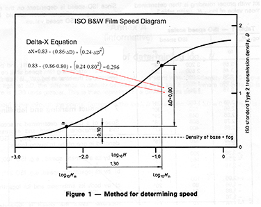

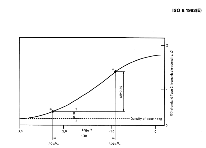

This is a screenshot from the ISO:6 for the determination of film speed. My understanding is that not only the speed point must be met, but also the general curve steepness. My assumption would be that Ilford, in their data sheet , does not care about curve form, but only about point m (speed point). This is only an assumption though and might very well be a misunderstanding of the matter on my side.
I'm going to be pedantic. The speed point doesn't need to be met, but is determined. You're not aiming for a speed but determining speed under the stated conditions.

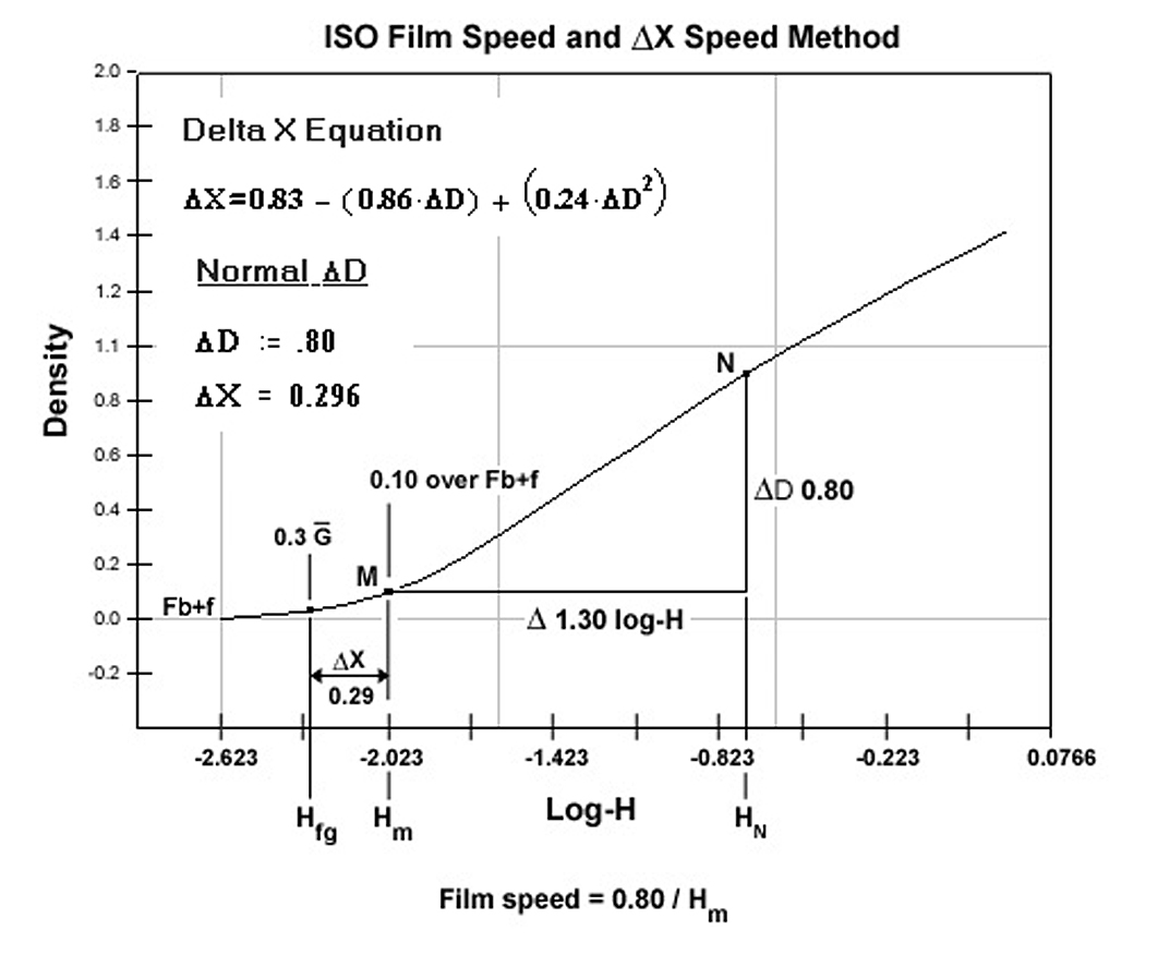

The ISO standard is about determining film speed. It's not a standard for development. The ISO contrast parameters are defined so that there is a consistent relationship between the fixed density speed point of 0.10 over film base plus fog and the fractional gradient speed point. When ΔD is 0.80 at Δ1.30 log-H, ΔX always equals 0.296 log-H. This brings into agreement the fixed density method with the fractional gradient method. It's called The Delta-X Criterion. Delta-X Criterion paper
The average gradient of the tested film under the Δ1.30 log-H, ΔD 0.80 conditions is only 0.62 when the curve has a short toe. Long toed films have a higher average gradient. Using CI, it can be around 0.67. What they both have is a gradient of 0.3x the average gradient at Δ0.296 log-X below the fixed density speed point.
View attachment 405320 View attachment 405321
Dear Stephen, I think I understand that Delta X testing is a more accurate way of determining speed and is preferred over the simple .10 over base fog method, because it takes the curve toe length into account. As far as I can tell from the paper, it was discovered that Delta X was a more consistent factor to obtain proper exposure for good prints. (Please correct me if my understanding is wrong).
It's not a standard for development, but a developer has to be used. In this case, it's ID-11 stock that produces a curve corresponding to a logH value that produces ISO 125. To me, it seems as though, it makes only ittle difference what speed determination they use.
This should not disprove my original argument that Ilford's data sheets lead to too contrasty, hard to use negatives. My assumption is that they measure one curve (ID11 stock) totally. Meaning plotting luxs to density, then calculating speed based on Delta X, and for each other developer only reference to this original curve. Only stating effective film speed, contrast not taken into account. To me this seems weird since the goal should be, at least, to compress an average scene to a normal density range. At least more than to hit the box speed. I wouldn't mind shooting at El 50 if I knew I could rely on the datasheet to give me a normal Density range for a normal exposure.
But maybe I am misunderstanding your point! I'd be happy to hear your side to clear up my brain fog. ;D
