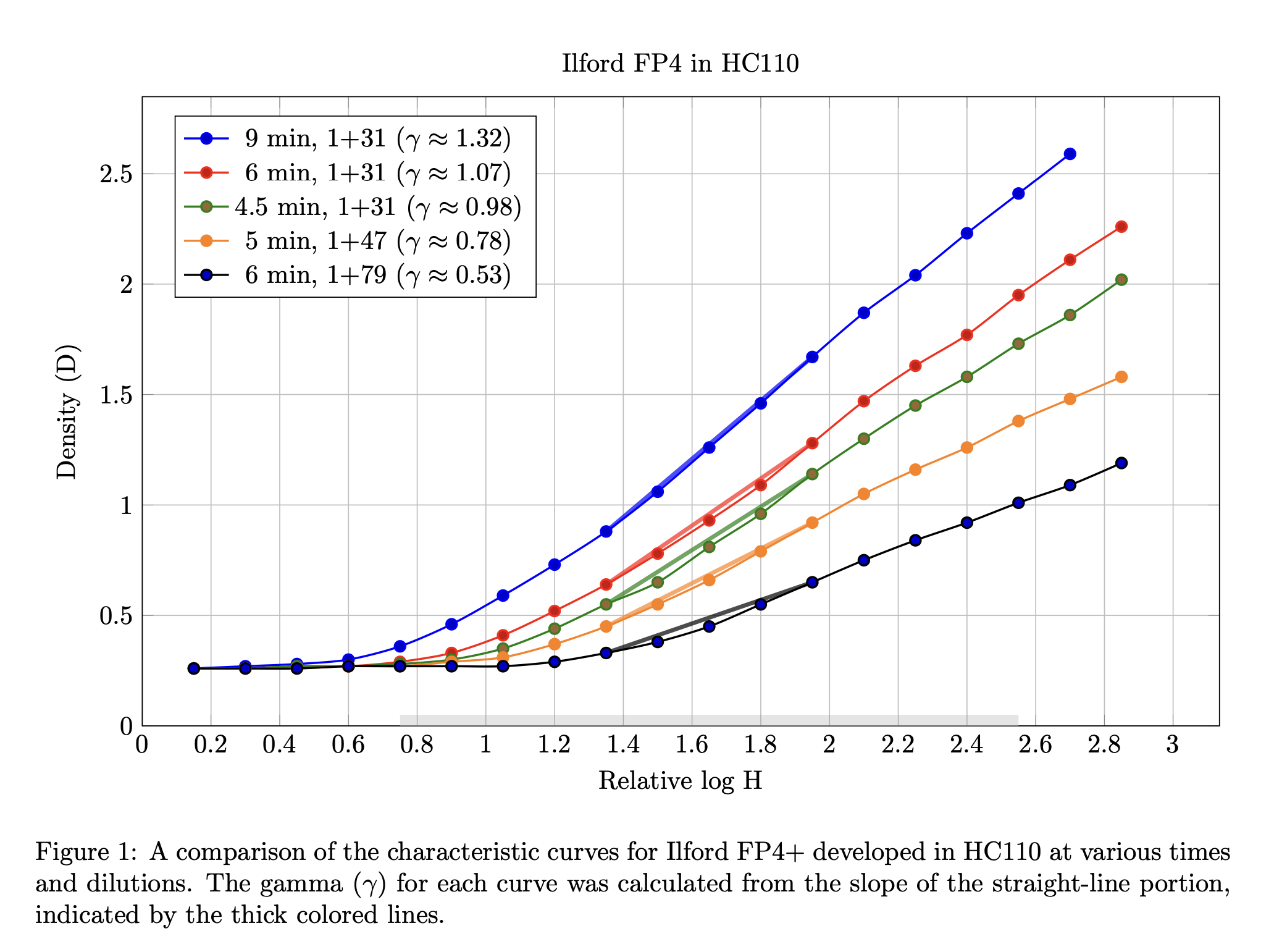

So by chance, when testing my new sensitometer, I discovered that the datasheet dev. times of Ilford Fp4+ in Hc110 result in crazy contrasty negatives. This is most likely because Ilford doesn't really care about contrast and only wants to hit the Box speed. Well if anyone wants to develop FP4 in HC110 with decent results, here are my findings: Goolge Drive Link
The time Ilford recommends is 9 min, ISO 125 in 1+31, this creates a curve with a steepness of about 1.3, which is too steep for me :D. Following my tests, a good development and sensitivity are about 5 min in 1+47 and approx. ISO 50. This will compress a ~1.5 SBR (Subject luminance range) to ~1.1 DR. (Density range). The Data in my PDF will provide SBR to DR tables for each curve.
I hope this might help some who are struggling with too contrasty FP4 in HC110.

5 minutes is a little too short for comfort.
It's probably worthwhile switching to a less energetic developer. D-76 or ID11 diluted 1+1 works very well with FP4 Plus.

Interesting. I use to use HC110, but I am aiming for a DR of 2.5 to 3.0. FP4+ seems to do a great job at that (I'm using Ilford Universal PQ Developer.)
For the records, what was your development regime (tank/reels, constant or intermittent agitation?)
Short development times? That would be nice! 😎
Edit to add: I agree with Keith that keeping the dev. time to 5+ minutes, is a good idea. Depending on one's working conditions and practices, shorter times can lead to some issues. Fill and drain times become more significant, and so on.
This is a nice set of curves -- fun to examine.
Are you using it for alternative printmaking? I use normal Ilford warm tone paper and a DR of 1.1 seems to be good. The development is described very precisely in the Google Drive link I provided in the text, but it's a two reel jobo tank, 4 vertical and horizontal, medium strength agitations over 10s and then every minute thereafter. Yes, I also agree that 5 min feels low, but I didn't want to make more tests on different dilutions at the time.

Hmmhmm, quite so. Now, with apologies for my part in this diversion, let's go back to @reneboehmer's nice set of charts and the interesting discrepancy between Ilford's recommended development times and his findings.
Yes that has puzzled me, as well. Either Ilford has got its times appreciably wrong for HC110 and this dilution of it or the OP requires a negative that is under-developed by what Ilford regards as an OK neg and yet if the negative that is attached is an example of the much shorter time then to my untrained eye it looks OK for producing a good print

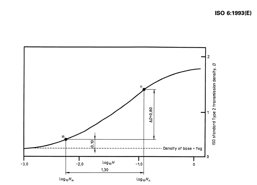

This is a screenshot from the ISO:6 for the determination of film speed. My understanding is that not only the speed point must be met, but also the general curve steepness. My assumption would be that Ilford, in their data sheet , does not care about curve form, but only about point m (speed point). This is only an assumption though and might very well be a misunderstanding of the matter on my side.

Just dilute the HC-110 a little more if you want longer dev times. It's remarkably flexible in that respect. But I strongly prefer PMK pyro for FP4 anyway.
Ilford's spec sheet curves are truncated, and printed awfully small. They give a clue; but it's better to plot your own.

That's slight curve sag or upsweep is relative to Tmax normally developed in HC110, not FP4. I can confirm that.

Well it certainly looks as if the Ilford time for HC110 1+31 and FP4 is way out - in fact close to 100% out. I don't know how long ago Ilford tested FP4+ in HC110 at 1+31, assuming it did such a test and not used some other way to produce a time. However if it did a test then given what the OP has shown us of his neg it is difficult to believe that Ilford would not have seen a negative that brought into question its own time

Small update on this topic.
So I wrote Ilford technical support an email, and my suspicion that they do not care about contrast is true. They do not use ISO values but EI values. Only the speed is designed to be met with their data sheets. Users can then, by ways of testing, find their own process speed and contrast. (Just like I did in the document). The only curves that are ISO conform in the data sheet is the ID-11 curve they specifically specify as measured under ISO conditions. It is separate from the "normal" development list. So if you encounter too little or too much contrast, this is totally normal. The only requirement is the speedpoint.
Ilford says that their development times are published for, quoting: "The times in bold will produce negatives of normal contrast (G0.62)". Elsewhere they say: "0.62 is suitable for printing on grade 2 or 3 photographic paper under typical darkroom conditions."
I do not know why you're getting the results you're getting, but it seems to me that Ilford clearly cares about contrast.
Could this be due to HC-110 itself going through several reformulations in recent years?
