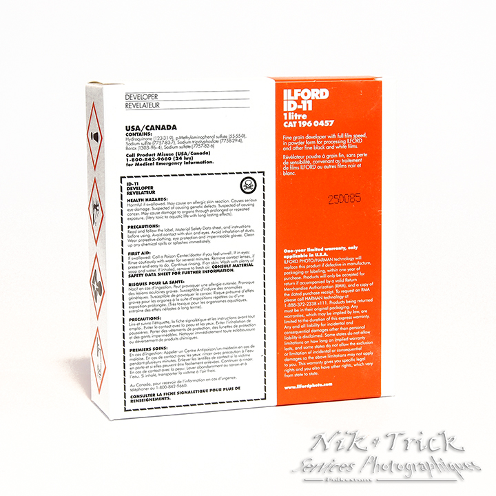

Just received the newly designed ID11. Looks nice, except for the spelling error in Spanish 😑 I wonder if that's the reason a picture of the old packaging is still on the websites I order from... Link to picture because I can't attach it...
Are any instructions for use printed on the back, or does it just say to go online to get them?
