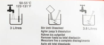

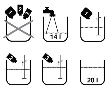

Could be a simple picture, something like this:
or this
