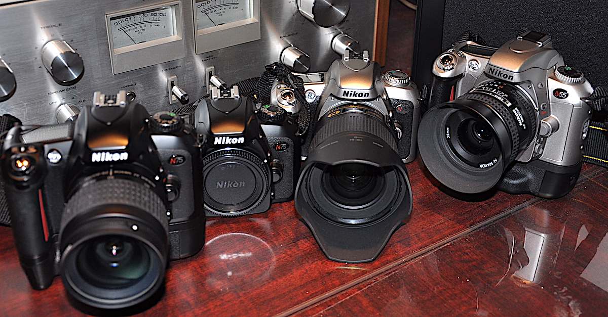

If you can find a MB-18 battery holder on ebay, you might want to pick it up. It allows the camera to run off 4 rechargable AA batteries, instead of the expensive lithium batteries. I wound up getting two n75s that had the MB-18 already attached that is why I have two of them. In fact one even came with a second spare battery insert.
The battery pack would also let one use an n75 with a broken or missing battery door.

If you can find a MB-18 battery holder on ebay, you might want to pick it up. It allows the camera to run off 4 rechargable AA batteries, instead of the expensive lithium batteries. I wound up getting two n75s that had the MB-18 already attached that is why I have two of them. In fact on even came with a second spare battery insert.
Wow. Thanks for that bit of intel. I hadn't even thought to look for one.
