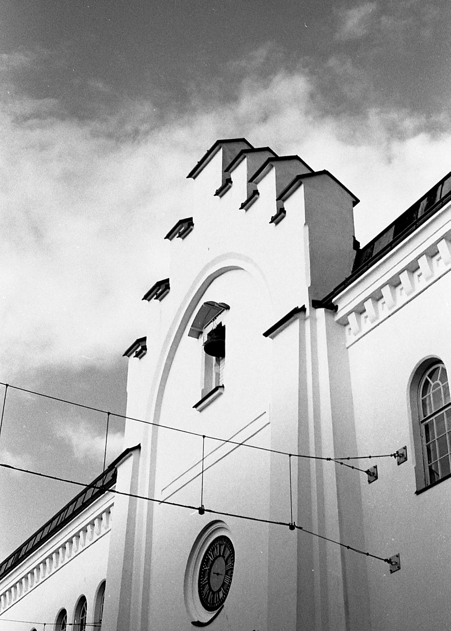

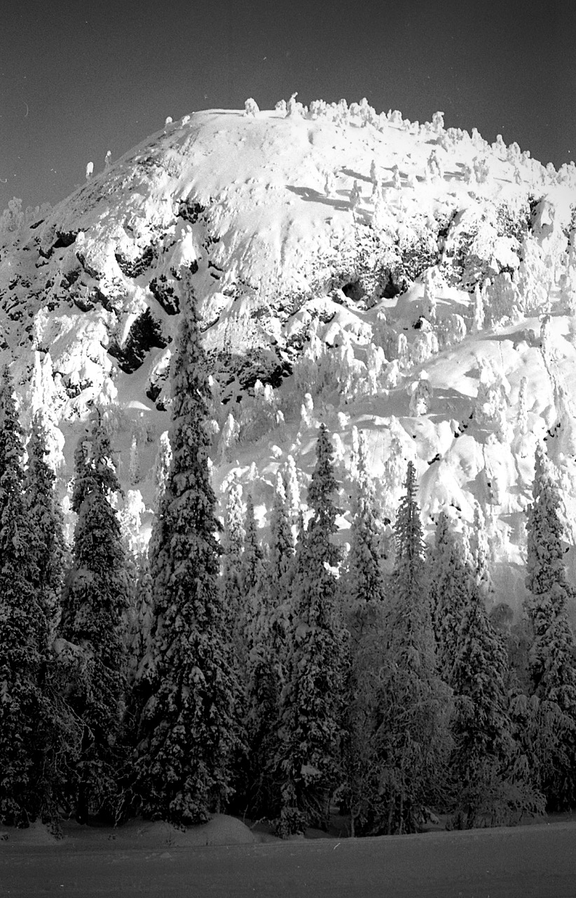

Some scans, sorry no prints yet. But hey, these are developed with XT-III :D
(basically my "digital workprints" which look I try to hunt in darkroom)
