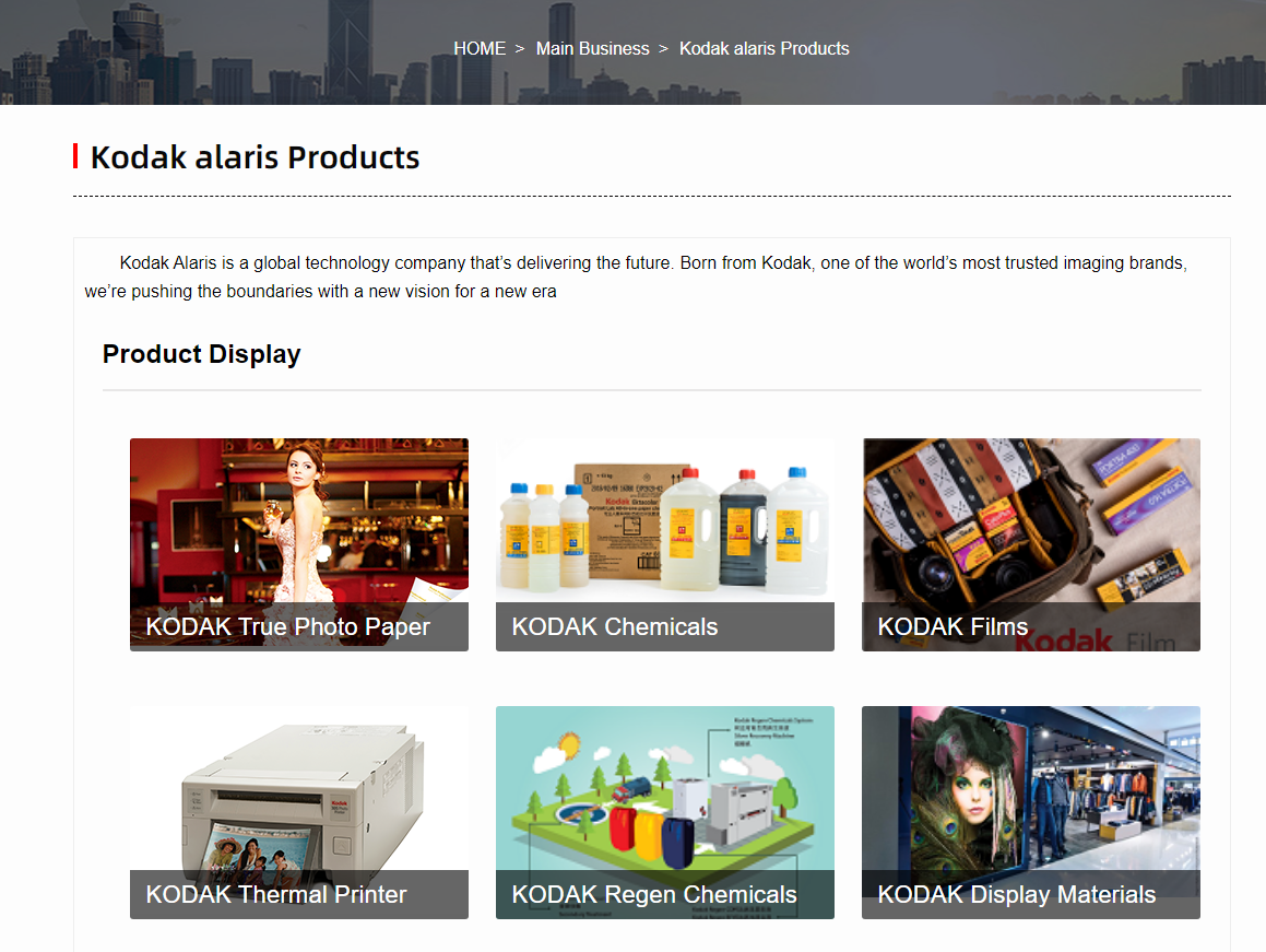

On the Sino Promise website, they have a products tab which lists each product line they distribute. If you click on the Kodak Alaris link in that list, you get this graphic and wording, which has clearly been either created by Kodak Alaris or developed with them:
1991 called, they want their graphics back.
More like 2005. The web wasn't even really a thing in 1991. And personally, I prefer it to endless scrolling HTML5 "pages" that have 15 words each and a massive background image.

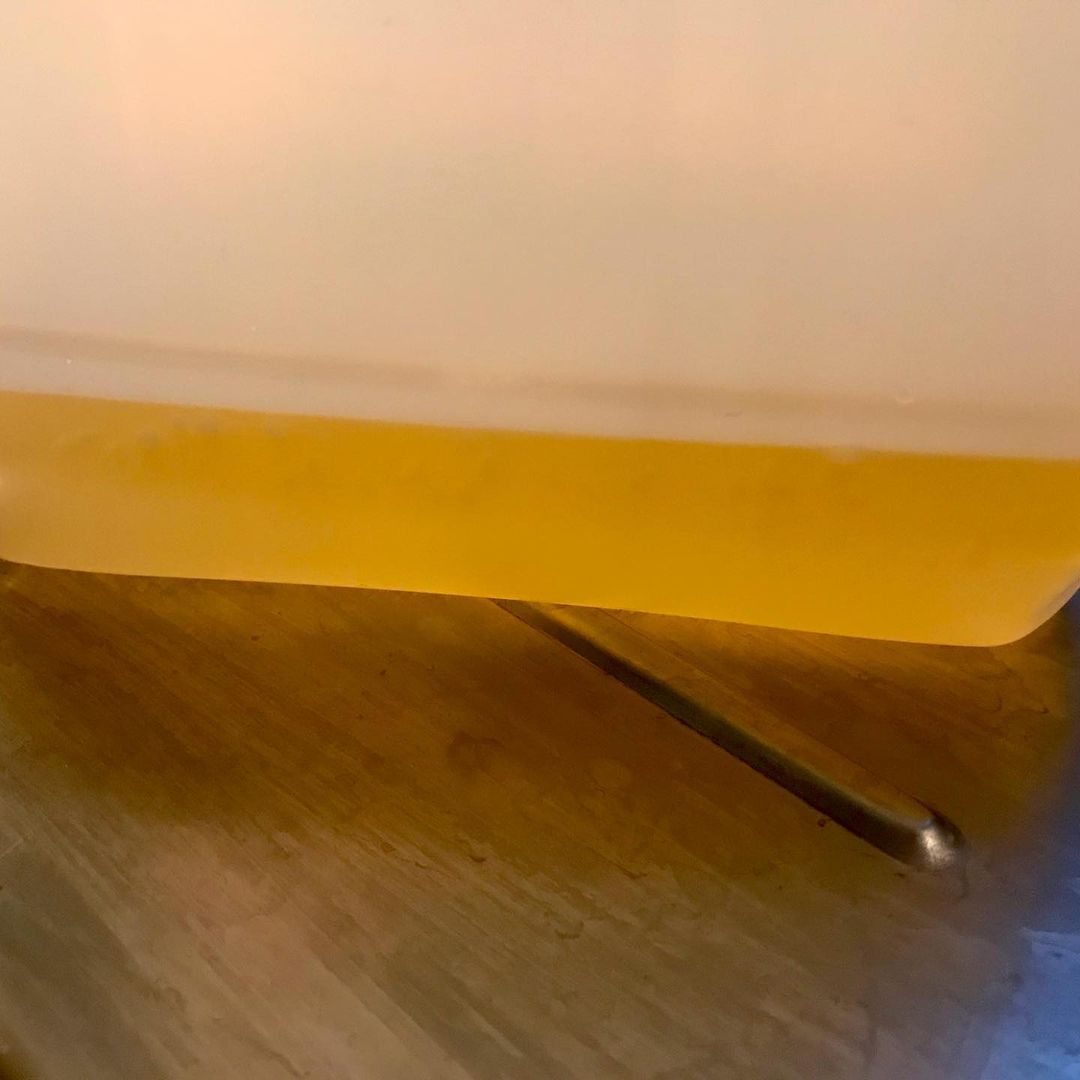

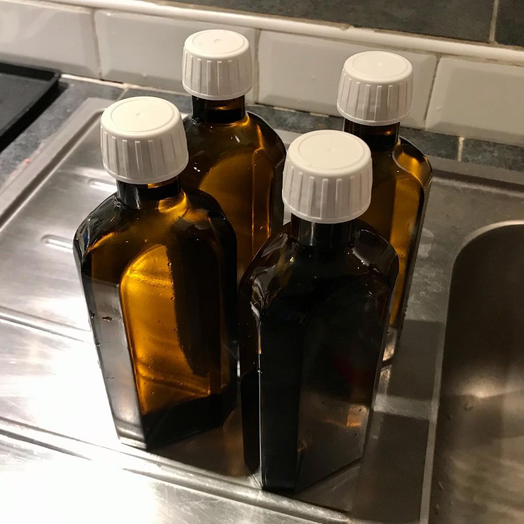

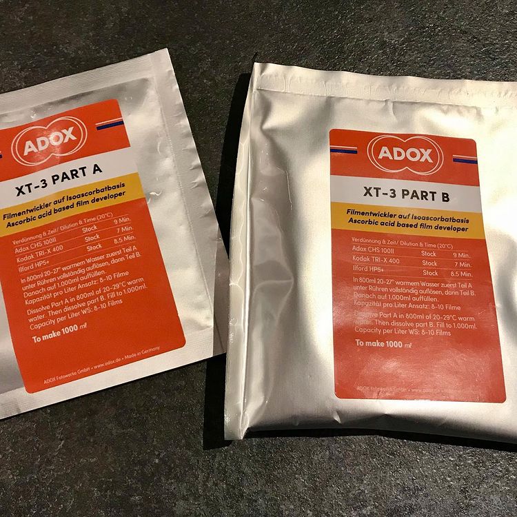

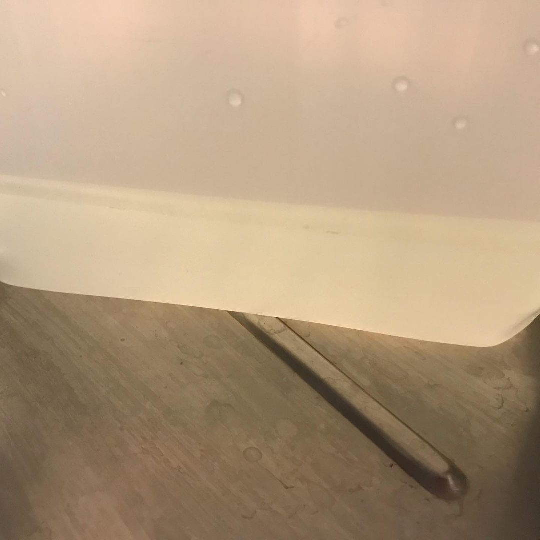

I just received and used XT-3 yesterday.
Part A dissolve like charm @20 degrees Celsius, giving a yellow tint to the solution.
Part B was longer to dissolve because of some bigger crystals. The solution turn clear after it.
No powder in the air, totally odorless.
4 stock solutions shots are now ready in bottles to test #development the same as I do with #Kodak #XTOL.
I’ll start trying #120film with #TriX, #Fomapan 400, #Tmax 400 and #fujifilm #Acros soon.
2 films went well right now, I need to scan them for detailed review.

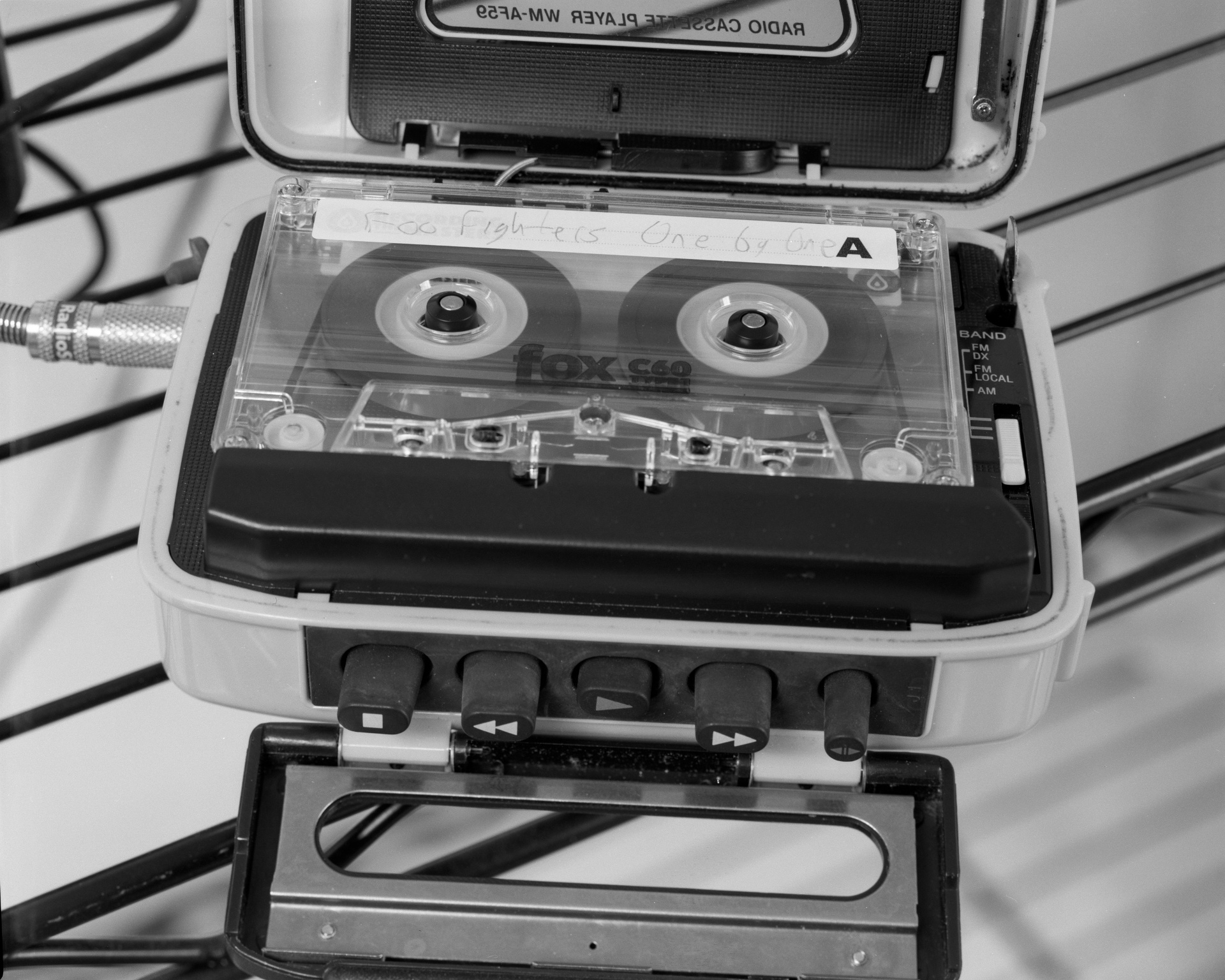

My first time using XT-3 worked rather well! I souped some Fomapan 200 sheets in it with a 1:1 dilution and a time of 7:30 at 20C. I used Massive Dev as a quick reference then took 15% off as I use a rotary process. This gave me basically the same times I was using with Xtol-R so that all seemed right. The results are drying now but inspecting by eye shows pretty good highlight density and shadow detail.
I really wanted to do some H&D curves and once Freestyle gets some XT-3 in I might grab a few more bags so I can justify doing that, though the benefits of replenishment become immediately clear for that if I'm only doing small strips or 1 sheet of film. My idea there, at least for 35mm, is to dev 1 roll but then make a quick test strip using the same film to develop with it. That way I'm not needlessly wasting XT-3.
I have high hopes it can be replenished but I think I should perhaps continue using it as is until I'm a bit more comfortable with it, though so far it does feel very similar to Xtol itself.

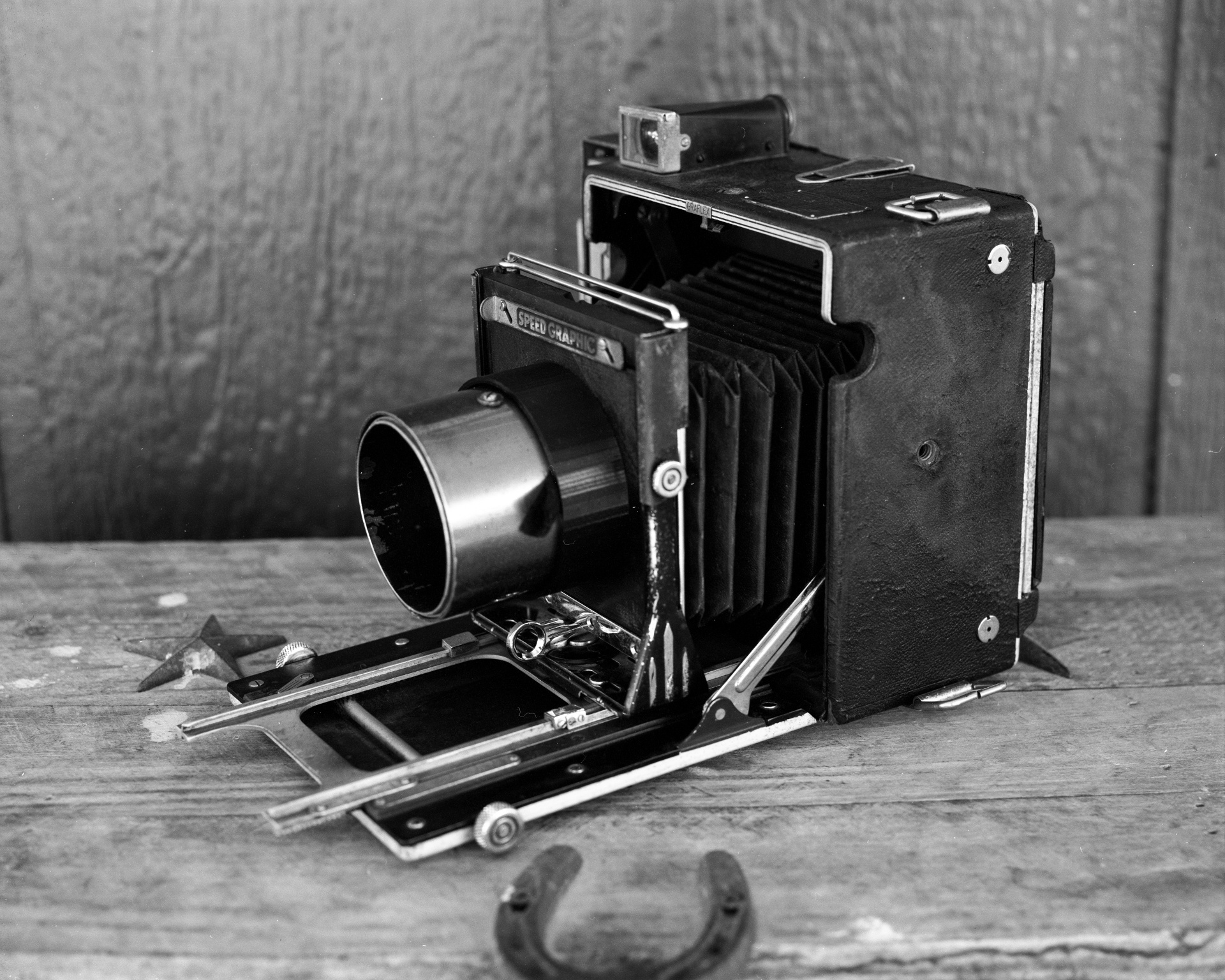

Getting back to it, here's a couple images (from negative scans) I got back from my first go of XT-3 using the times I mentioned up above. This is Fomapan 200 in 4x5, a film I chose for my "one shot per week" challenge. Because of the Xtol issue, while I had planned to use the same developer for the challenge, I ended up just embracing change and tried several. The first few sheets were dev'd in Xtol-R, then I tried Microphen, ID-11, and now XT-3 for the latest ones. In comparing to the Xtol ones, the XT-3 ones aren't quite as dense, but I suspect I was probably over-developing the Xtol. I might add maybe 30 seconds to my times for the next go 'round though. I've also adjusted my metering a bit since Jan so not exactly apples to apples. I rate all my Fomapan 200 at 100 also.
Anyways, with that in mind, the results are quite lovely! Grain is very tame and in fact I'm curious to try XT-3 with T-Max P3200 as I've found it souped very well in Xtol. Tonal range is also beautiful good, though these are film scans and not darkroom prints and that will be the real test for me.
Overall I'm very impressed! I'm trying to avoid jumping into replenishment too soon but I really REALLY miss it. Everytime I think about doing an exposure test and making H&D curves I think about how much that will cost, not so much in price but time to wait on more XT-3. 150ml would be the min about of stick I'd feel comfortable using (300ml in 1:1) and that can go pretty quick if just developing a small 35mm test strip or 1 4x5 sheet.
