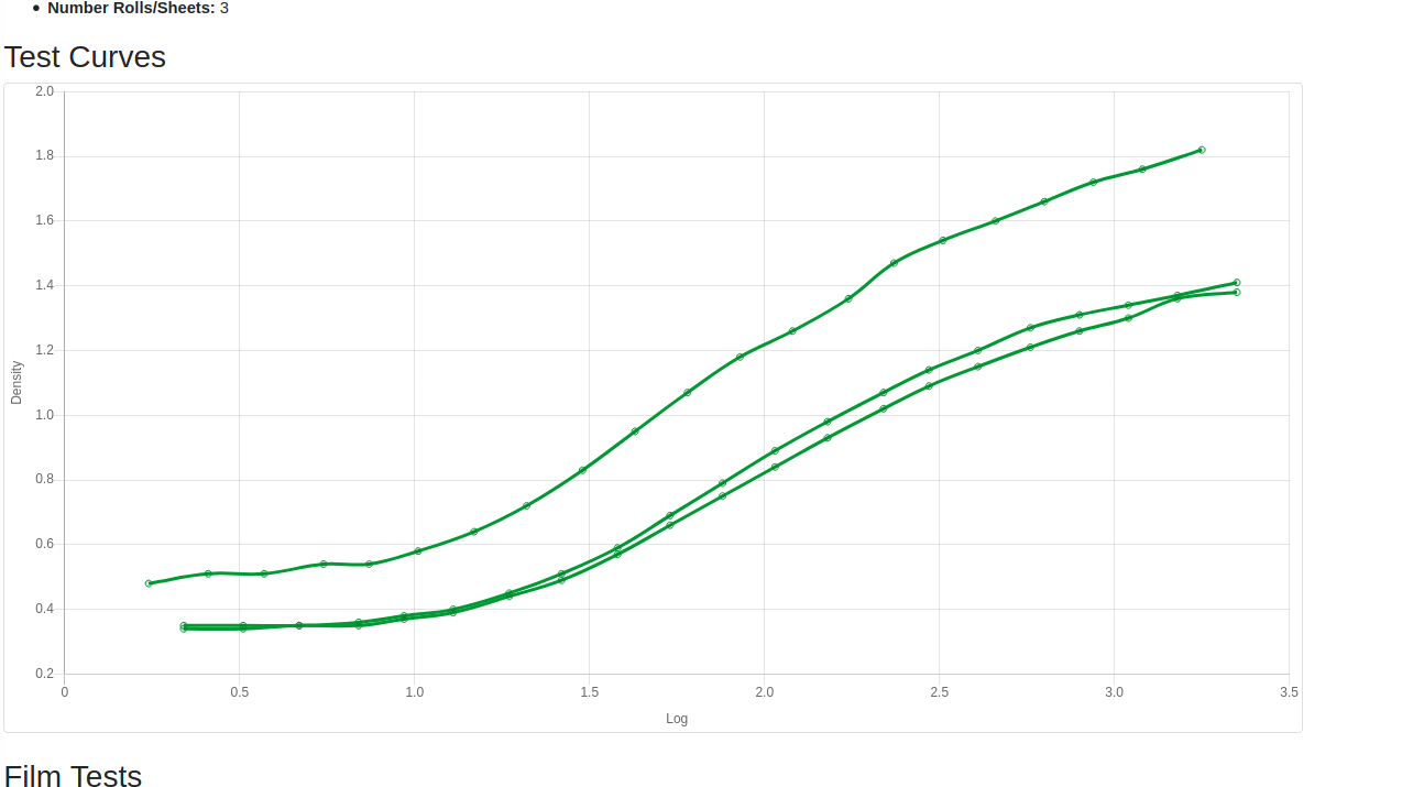

I still need to find the gamma and CI (I do that on pen and paper still) but here's a film curve of Ultrafine Finesse 400 using XT-3. Looks like my times are a bit too long (making me think my old Xtol-R was weaker so maybe the suspect bags had something to do with it). XT-3 is the top line. The other two are Xtol-R. My XT-3 is still seasoning also and still appears to be at close to stock strength (only processed 4 rolls of film and I'm using 2L worth).
That kink towards the top of the shoulder is interesting since I didn't see that in my other tests, but that could have been a measurement error on my part.

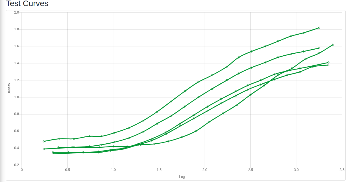

Update on my seasoning process!
It's a bit busy - I need to work on my film log web app a bit more to be able to toggle which tests I want to see. The smooth top line is XT-3 when I first started using it. The middle one is XT-3 as of today and the bottom ones are from my old Xtol. The one that crosses and is seemingly steep is testing out an X-Rite 334 sensitometer so those can be ignored for now as I'm still trying to figure that one out (reading the steps of the 334 is touch because it has a diffuser attached, but that's another story).
I still need to compute gamma and contrast index for these newer tests but I think I'm getting close. I also don't really trust the data I was getting from Xtol-R knowing I had at least 2 suspect batches go through it. My dev times are certainly still different (7:00 vs 9:30) which suggests my current XT-3 is more active than my batch of Xtol-R was. Does make me think that means it's not seasoned yet but I'm also wary to push it too far without starting some sort of replenishment. The color of the replenished solution is starting to look similar to Xtol-R though.
Not sure if these are useful or not but I guess the takeaway is XT-3 is doing good work so far!

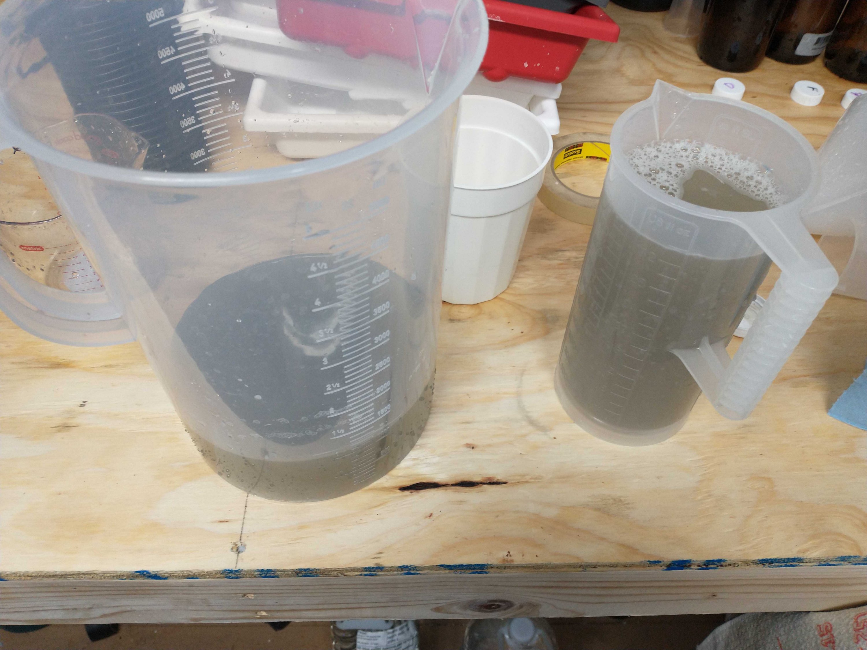

Update on my replenishment - things have been going rather well so far! I'm up to 22 sheets of 4x5, 5 rolls of 120, and 8 rolls of 35mm (our ~ 19 rolls of film). I started replenishing for the last six dev cycles (whereas previously I was just reusing without replenishment to help speed along the seasoning). It seems like things are settling down but I'm still playing around with the X-Rite 334 to see if it'll replace my old method of using my enlarger. It looks like for process control it'll work but need to dial in the exposure a bit better.
The one issue I did run into this evening was this:
So that's kinda uhm, gross :smile: This happened with my Xtol-R before too, although it wasn't quite as sewage brown I did have a similar experience if I stirred up the jug of replenished solution too much. I discovered this while doing my replenishment step. I add the 80ml first, then fill the 2L glass jug until it just overflows. This time I noticed some particulates in it, held it up to the light and saw quite a lot. So I opted to pour the whole thing out and filter it with my wire mesh funnel.
I tested the developer using a clip test and it still works (I had no issues developing the Fomapan 200 this evening either). So I suspect it's just sediment of some sort (which as noted I did get with Xtol-R too) but it did give me a mild freak out. So the next round of developing I'll see if it pours out clear and if stuff has settled down to the bottom. I also probably won't develop anything important for the next run just to be sure all seems well.
I have been developing quite a bit of Fomapan 200 (4x5) and while I do a pre-wash, not all of that blue/green tint seems to come out and some ends up in the developer, so that could perhaps be playing a roll for the color maybe, but that's just a guess.
Apart from that, my dev times by eye seem to be pretty spot on and are getting to be pretty stable so far.
