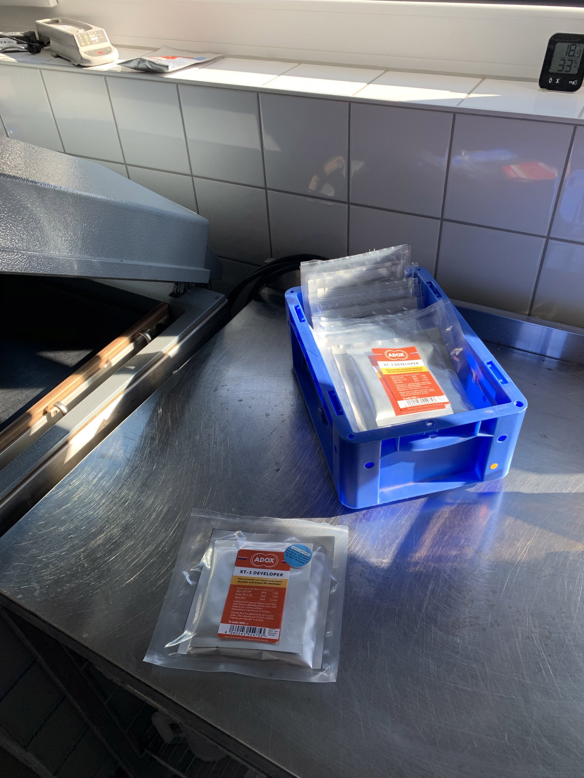

We have started shipping the first batch of XT-3 developer today. Sorry for the one week delay but our QC chemist had a dental surgery at the end of last week.

View attachment 269970 We have started shipping the first batch of XT-3 developer today. Sorry for the one week delay but our QC chemist had a dental surgery at the end of last week.
I do hope that the XT - 3 will be available from the Fotoimpex web-shop soon and that your QC chemist is recovering OK. What would the world be without chemists !? :smile:

View attachment 269970 We have started shipping the first batch of XT-3 developer today. .
