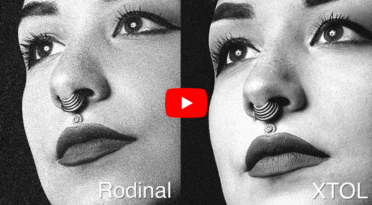

Well Ian your love for Rodinal I will respect, to me it is a sharp developer wich is able to
make avaible more speed but I can not live with that grain :sad:! Others like you, find the grain
aceptable also others want to have it :
No Video - just a picture = don't click in it!:whistling:.....
From my point that difference is overdriven - but there is a difference of course!
I used AP100/APX100 and Tmax 100 & 400 plus some AP25/APX25 for a number of years and the only developers I used were Rodinal and Xtol replenished. In terms of grain, contrast/tonality, sharpness etc it would be near impossible to spot a difference.
It was the late Peter Goldfield, who had assisted Paul Caponigro in New Mexico, who introduced me to Rodinal, after all it was Agfa's recommended developer for AP100/APAX100 and AP25/APX25, and Peter had been the UK importer of Agfa B&W films, paper, & chemistry for a few years when they'd pulled out of the market. When I went on my first workshop with Peter I'd guess early 1987 he only recommended using Rodinal with AP100 and AP25, however Tmax 100 had just been introduced in the UK and he felt early results ere quite similar giving excellent fine grain.
It's not a case of liking grain (usually I don't but there can be creative uses), in practice it's finding the best film/developer combination that works for you and using craft to fine tune to maximise quality in terms of fine grain, tonal range, sharpness, and also ease of printing (or scanning). This involves finding the optimal EI and development times going beyond using manufacturers published recommendations.
There are other factors, craft also means knowing how to get the best from your equipment, it's all well having a good film/developer combination and loosing sharpness through poor camera handling. An example which I found first hand was images made with my Mamiya 645 1000S on a tripod weren't quite as sharp as many hand-held shots with the same camera, even though I was using a good solid tripod the mirror action was enough to take the edge of sharpness. The issue was eliminated by using the mirror lock function. On my first Goldfield workshop the co-leader was Peter Cattrell, he spotted a couple of prints lacked critical sharpness, he mentioned it privately on a field trip and said he'd had similar problems with a Bronica on a tripod.
Ian
I have to state that Rodinal (from my point Ian - because each photographer make own experience) can give much sharpness from egde effects! You probably would agree!
So if the prefference is on sharpness (for example shots of technical stuff machines a.s.o. or for
example architecture) Rodinal from dillution1:100/1:200 and stand development is working very fine. But sharpness via edge effects is no profit for resolution :sad:....it would be nice if it could higher resolution!
The profit from Rodinal is (just for me) in direction of economy, long life, speed increasement
yes and it is much easy to use (stand development I did 1:400:tongue: but I guess the last hour of development Rodinal was allready dead! But it was a try - not more! (max. 1:200 is recomanded)!

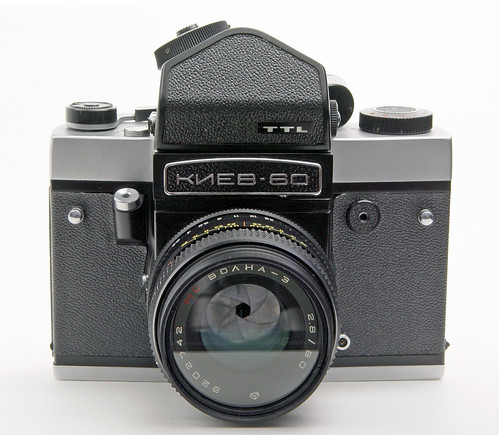

At last "mirror lock" yes of course this is not obsessionable overdriven - also with 35mm cameras!
There is a reson for that some also small cameras have it!
Kiev 66 have it not - there no tripod can help:whistling:! But perhaps concrete?
Ian to me it is quite clear how to proceed from workflow with camera! So if exposure is OK,
lens is OK (modern Zeiss for example), sweetspot is best, tripod is stabile, mirrow look is done,
cable release is used, there is no dust in the air (also a factor), E.I. is the right one concerning to the used film - there has to be a thought : Is the picturial motif worthfull enough?

Sorry "Kiev 88" but Kiev 60 is right :
(C) by Martin Taylor
A good coleague from the eastern Europe has this camera (possible the 88 model)
A camera without mirror lock - and this "Soviet" made camera would need it more than any other
camera....:whistling:!

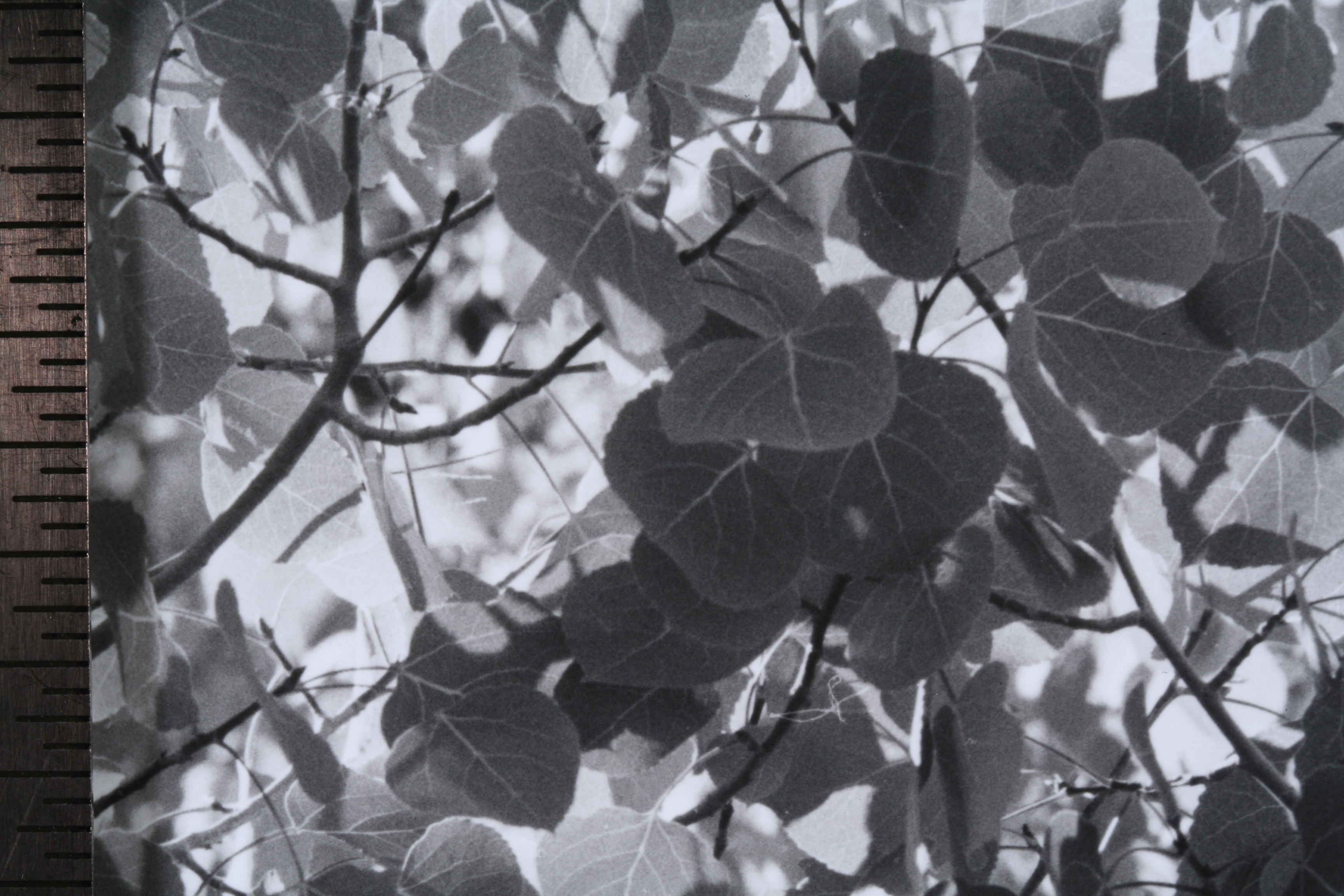

Perhaps the first decision we make when planning to print large is choice of format and then film and that's governed by choice of subject matter and how we wish to work. As an LF and MF shooter formats I've used since the mid 1970's as well as shooting 35mm up to 12 years ago I made the decision to use 35mm and MF hand held, and LF on a tripod for my personal work in about 1986/7.
I tried the micro film options while at university (early 70's), I found the better route was actually to use EFKE Kb14 (later renamed Kb 25) which despite it's DIN name was 40 ASA in Daylight and exceptionally fine grained but with a ridiculously soft emulsion, it was capable of exceptional fine grain, sharp "high resolution" results with good tonality but that was lost if there was over-exposure.
The options you have given in Perceptol will give finer grain but not better sharpness compared to Xtol which gives you better film speed, but like EFKE KB14 you can't work hand held with these low EI's. I value practicality so would use a bigger film format where I can use a faster film if wanted.
Ian
Ian

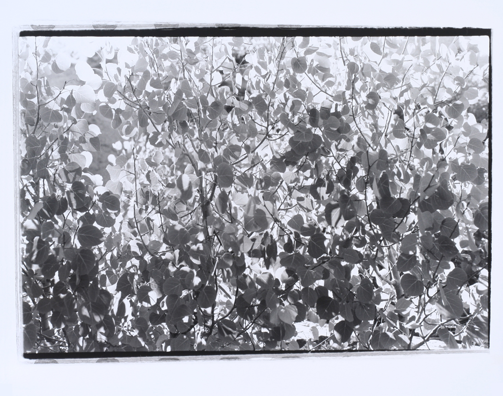

Ian

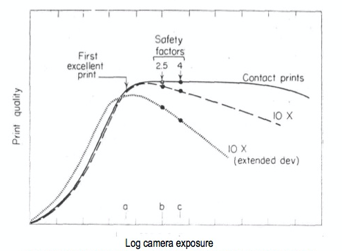

I'd use caution over exposing rollfilms if one is interested in maximum sharpness. The exposure latitude is small for excellent prints. (See the line for "10X" on the graph).
OK - thanks ic-racer - not sure about to unterstand the graph correct....:redface:?
So let me ASK first : what is the log. A B C camera exposure here by values?
