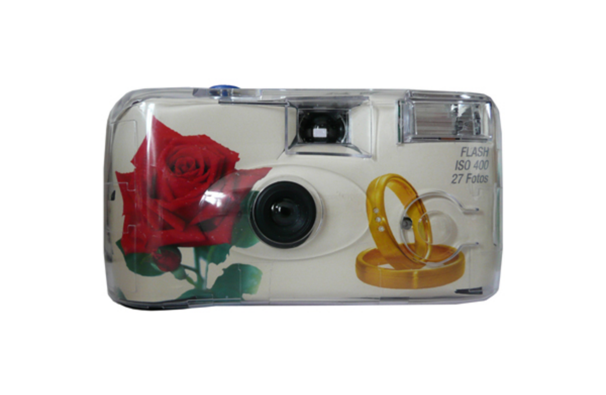

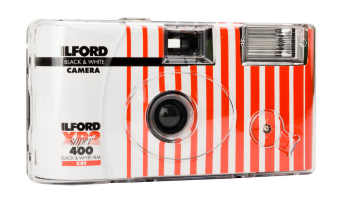

I have the impression (since years) that for postcard size (OK perhaps a smaler sized postcard)
these fine tools are absolute sufficiant with plastic lens :
......ähhh - you want shot in color? Why :sad:......Aha you have to shot wedding:angel:
No problem at all :
.......a wedding camera:D:unsure::D:laugh:!

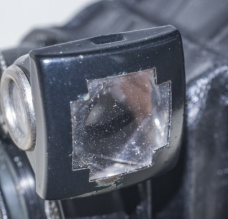

PS : Main problem (to me) = its viewfinder
......in sunlight it is hart to identify the horizon! But here in the picture it looks real big - the original size of it is a quarter size of a stamp from old format:
:cry::cry::cry:

PS : In general a viewfinder from old type without rangefinder is a nice tool for landscape!
The 6x9 format has a huge space in comparison to 35mm ! So normal films in bw will give
fine quality!
But in the lower distance it is a hart job - belive me! To come to nearly sharp shots is easy
(AS you stated : fine in contact printing) to come to sharpness for smal poster prints it may
be OK (the little incorectness from failed focussing is first seen in smaler poster print then)
But with max. printing it is just unsharp:sad:! Postcard is absolute sharp/ 20x30 is looking quite
OK (without glasses:whistling:) 30x40 isn't looking good/ 1m x 140cm is telling you quite clear
(are you able to focus? ......seams not so boy...:sad:)

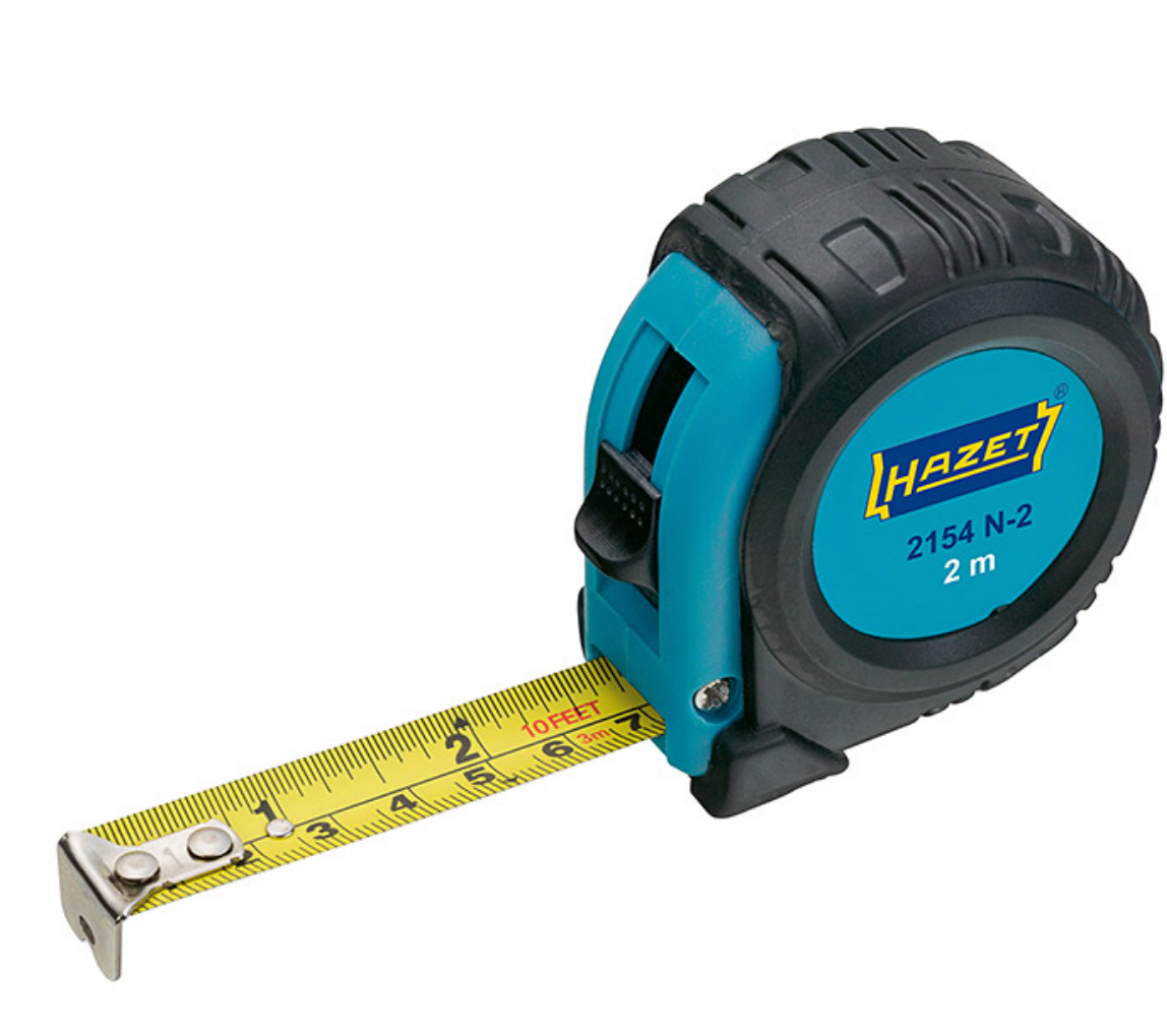

That all is in regard of small distance because the deep of field scales at 1,2 m - 3m can serve
you profit from f/16 and f22 but then you need correct 1,35m and not 2,10 Meter!:laugh:!
It is not the big task to messure manuell:
But the scales onto the lens are not very precise = to estimate 2,75 m distance on a Voigtländer lens scale out of the year 1928 between 2m next is 5m is one thing but in reality 2m onto the scale can be 1,85m and 5 m onto the lens scale can be 7m in reality:sad:???
But this shot is sharp! (scan is just lousy)!

Well - then you will neet this
....but where should be the problem? Because one would not print in that size 8times a week!
And if one is printing big one of course would print best negative one own! So some hint in concern of better workflow using camera, light meter a.s.o. is just nice....:D!
with regards
PS: Sad if all best shots then are from Fomapan 400 - pushed up with Rodinal to higher ISO..:sad:!
