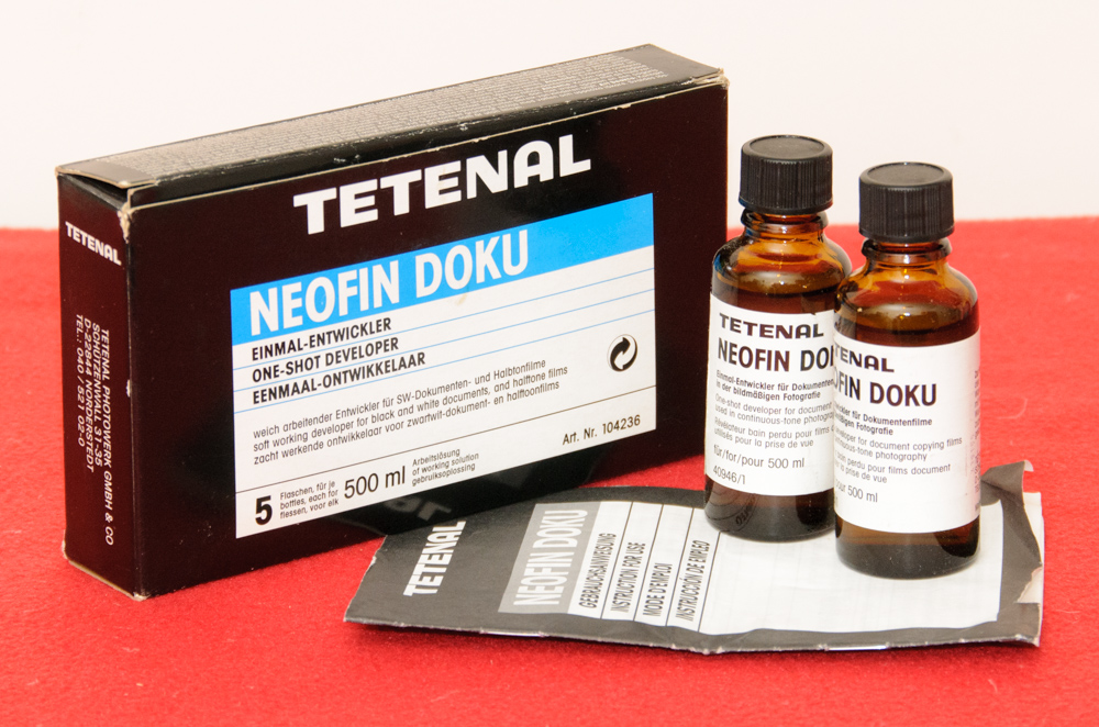

So normal bw films can be tuned a bit (from general workflow during shooting - a tripod is a most) but the use of perceptol is recomanded beside other developers!
You have the need of high contrast before pull development!
That is one of other reasons for using microfilms if it is going about :
High resolution photographs - today !:wink:!!!!!!!!!!!
Any "secret hints " with normal low speed bw film and most "secret" developer combinations you perhaps will tell here :cool:?

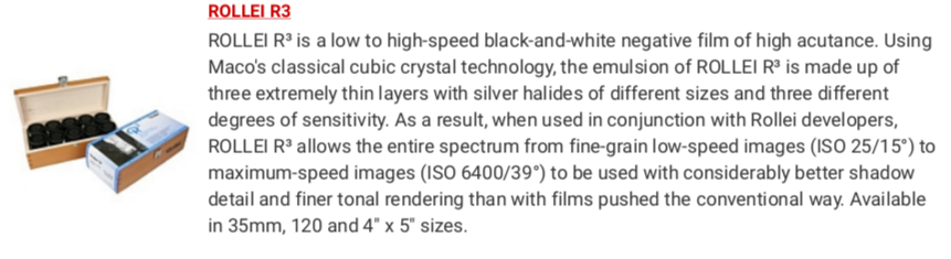

PS : One film I tested was the Rollei R 3 the recomanded ISO was ISO 25 - ISO 6400....:surprised:!
This film showed first good results at E.I. ISO 800 and best characteristics at E.I. ISO400!
Also good characteristics with ISO 25 and best results at ISO 100 ????
BEFORE YOU WONDER ABOUT - THE FILM WAS "ORTO-PAN CROMATIC FROM MULTI LAYER DESIGN!
BEFORE YOU WONDER ABOUT - THE FILM WAS "ORTO-PAN CROMATIC FROM MULTI LAYER DESIGN!View attachment 221931
