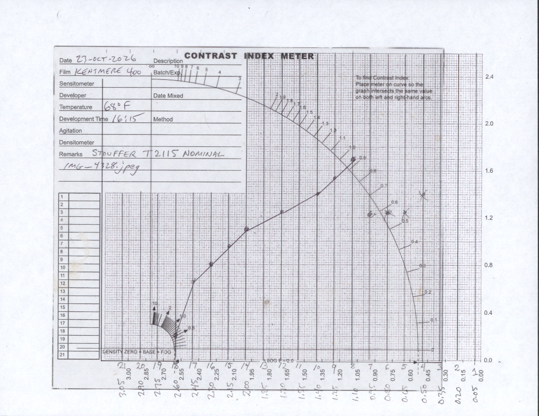

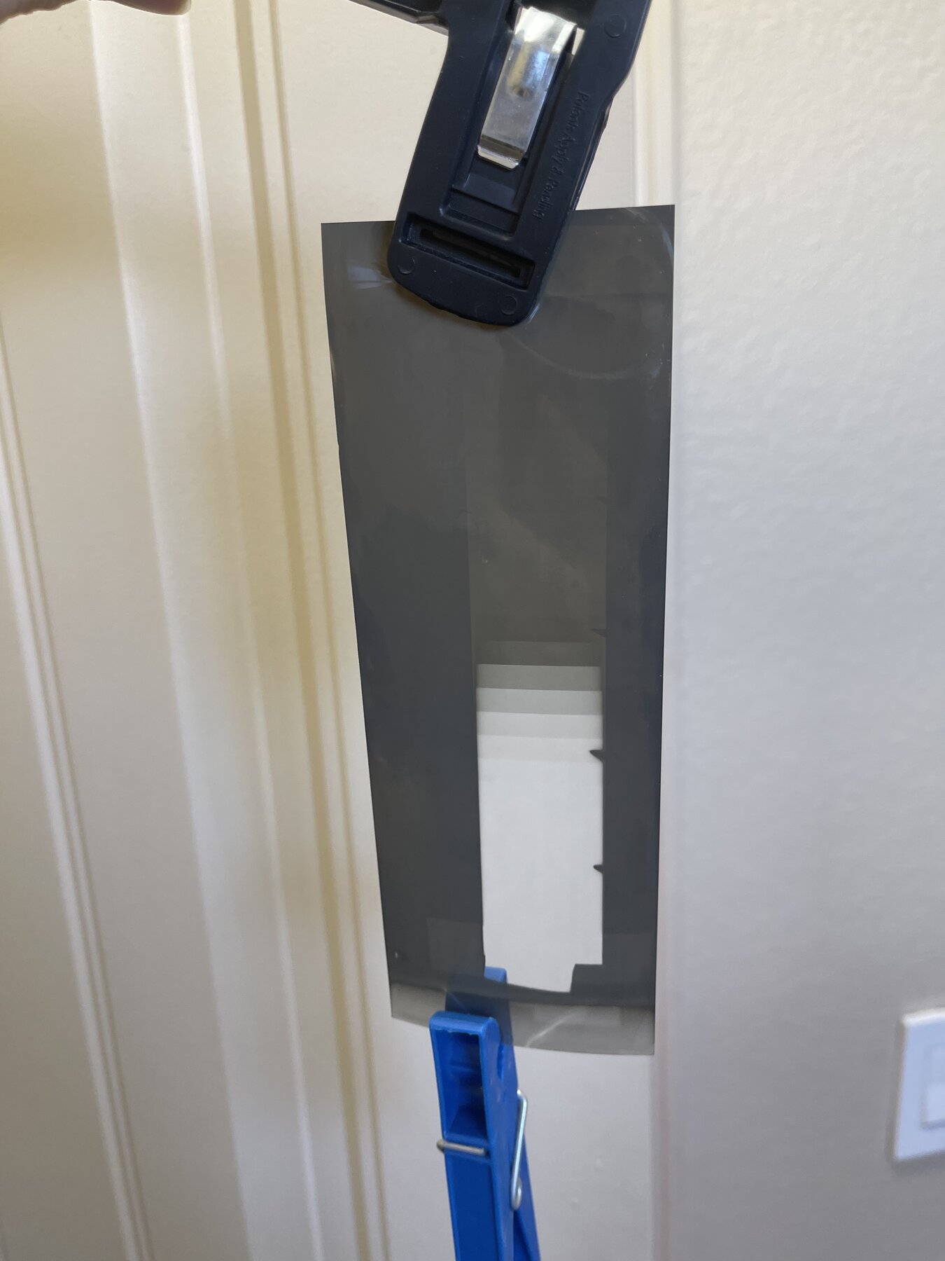

Using just eyedropper tool with the photo you uploaded, this is what the graph looks like to me.
You might get better estimates looking at the negative and original scale by eye.
If you have an enlarging meter such as Ilford EM-10 or Omega CS-10 you could read a null on the scales for better comparison.
But it looks like very contrasty, you might cut down development time next time.
That's what I'd also do, BUT make sure to make a photo or scan that doesn't suffer from strong flare and reflections, like the photo posted earlier in the thread.

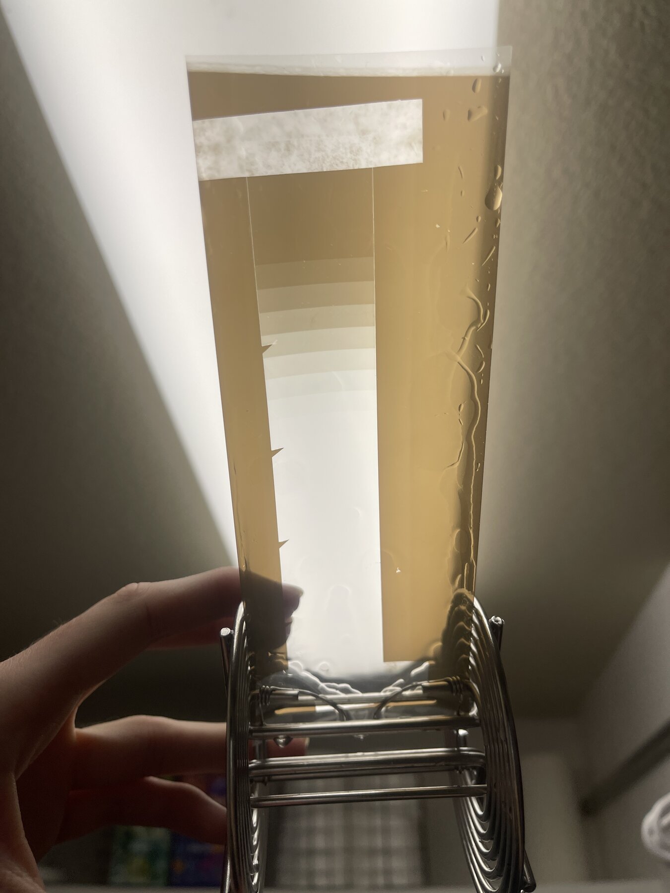

I intend to do the test again when I am organized for my next film development, and do it more carefully.

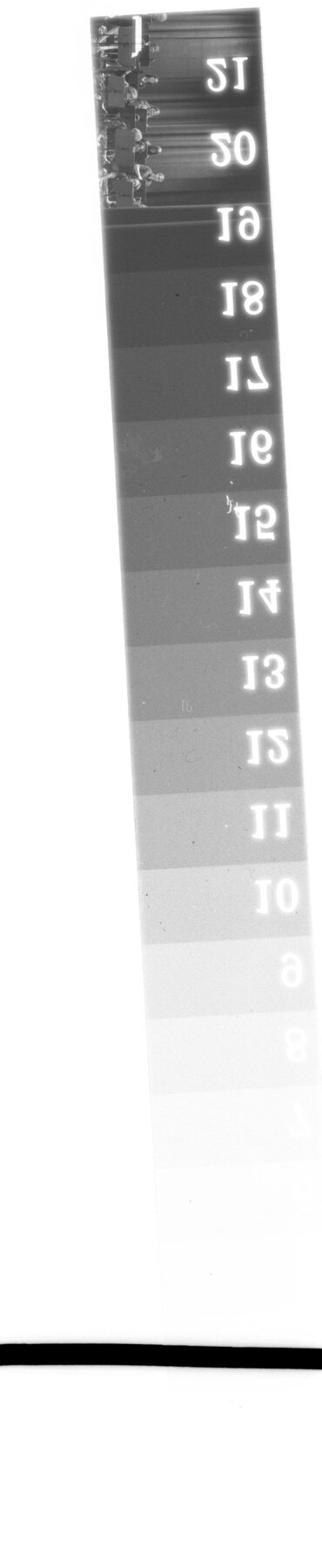

I scanned this on the Epson V500. I was tempted to adjust settings to make the whole strip more visible. I am afraid that the Epson software may have made the adjustments anyway, given the image that was included.
I do have an X-rite 331 densitometer that produces somewhat erratic and inconsistent readings, but if I make a series of readings on I can eliminate some of the errata and inconsistent readings from.
I don't have photoshop, but the Epson-scan software does have a preview eyedropper ("densitometer") tool.
Here are some of the uncorrupted and readable ("before") values from use of that tool: (Are these reliable densitometer readings?)
19: 129
18: 138
17: 149
16: 161
15: 173
14: 182
13: 192
12: 200
11: 207
10: 213
9: 220
8: 223
7: 226
6: 229
5: 231
4: 232
The film base has a reading of 236
