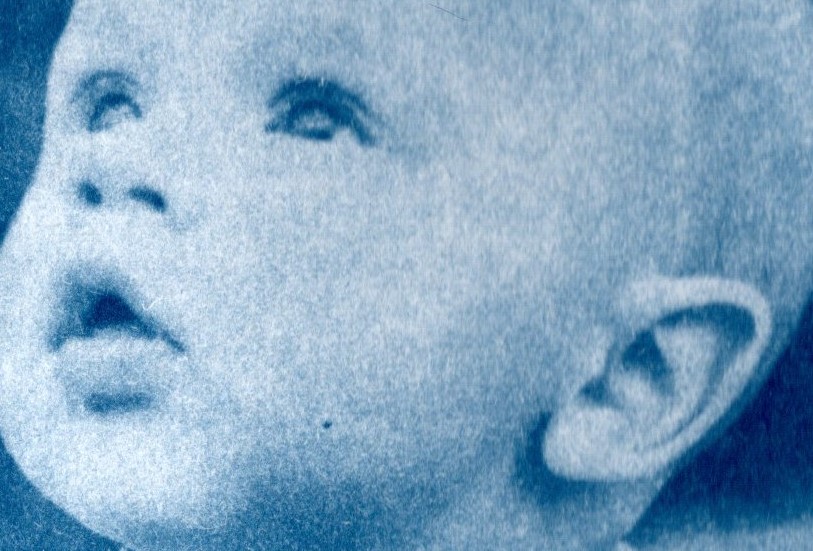

I like the Cyanotype process, but my biggest complaint at this point is the density of the image. It's kind of there, but not really - not quite sure how to explain my thoughts. It's kind of like looking at a newspaper image up close to me.
Would coating, drying, and re-coating improve the "resolution" if you will?
