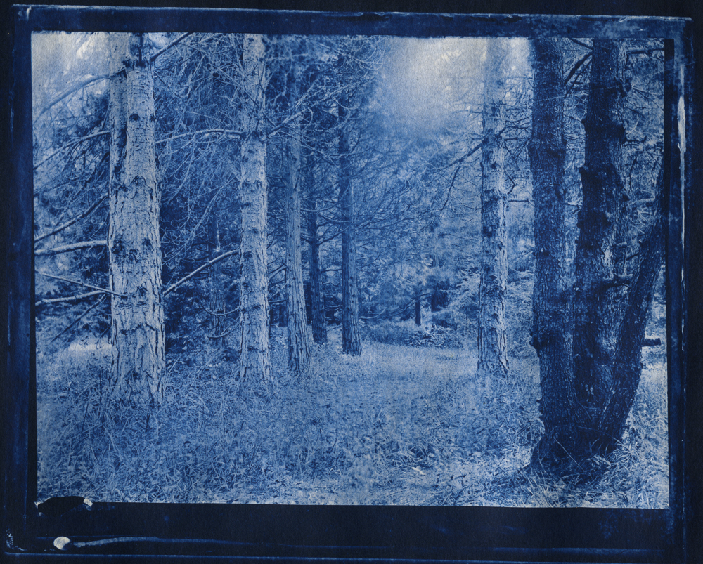

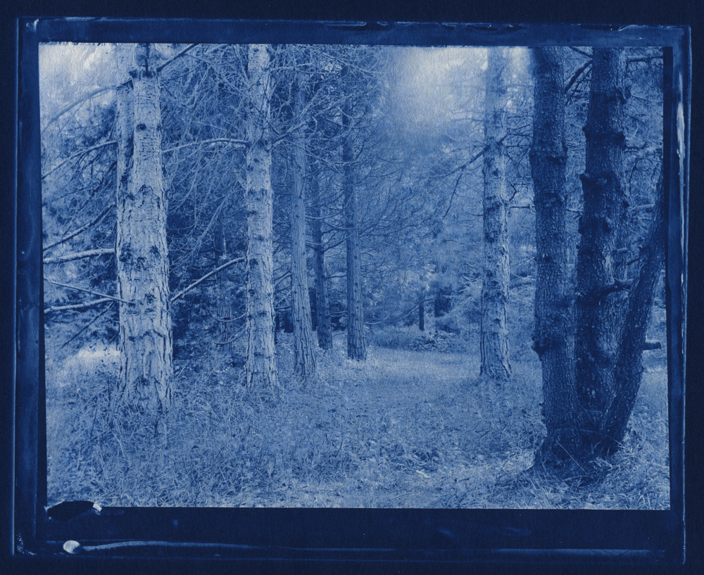

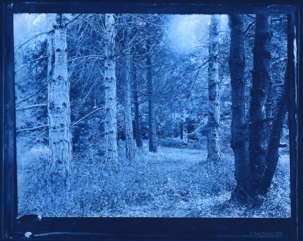

Today I received a new paper that was recommended for Albumen print making, so I thought I'd test it out as a Cyanotype paper as well: Canson Universal Sketch Pad (Freestyle carries it as an alt process paper. Its cheap as heck, and you get 100 sheets of 11X14 paper for $11.00, which is outrageously cheap compared to Hahnemuhle Platinum Rag (which makes stunning Van Dyke Brown prints).
Anyway, I made two tests on this new Universal Sketch: one without sizing, and one with arrowroot sizing. Both were decent, both had a nice color (less cyan and more indigo), and the coating was very uniform (applied by sponge brush). However, the print that used the Arrowroot sizing was significantly more contrasty, and the D-max blues were a deep indigo that approached black. I am impressed.
Note: the difference between the two prints made on Universal Sketch Pad is much more obvious than it appears in these scans: the blue-black of the second one is much deeper than that of the un-sized print (the first).
The negative used was a wet plate collodion negative made in a Kodak Brownie 3B.
This is the print made on Universal Sketch Pad, without any sizing of the paper:
This is the print made on Universal Sketch Pad, with Arrowroot sizing applied to the paper before applying the sensitizer:
And for comparison, this is the "control" print made on Canson Marker Pro, without any treatment other than applying the sensitizer:
I find any of these approaches to printmaking acceptable, but they are very different in contrast and depth of color.
