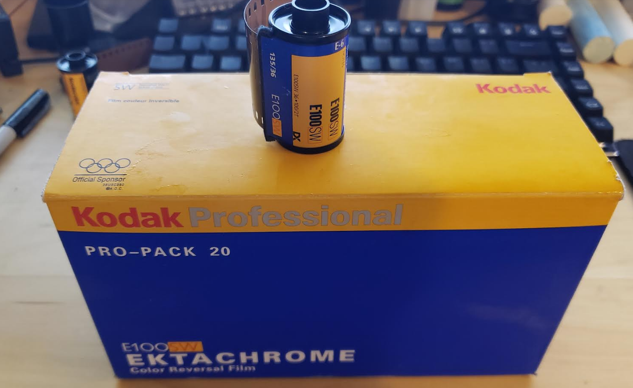

it is 35mm, from 2003, stored at room temp. I have 18 rolls. Also a few rolls from 1980's and 1970s. I want to develop them as a normal color positive film, for projection on the wall or scanning.

18 rolls of these, from 2000, says develop before 2003. All stored at room temp.

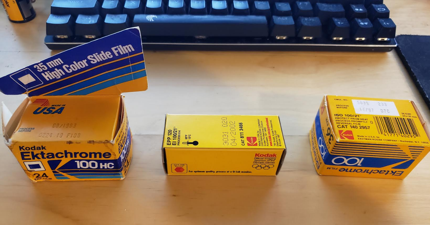

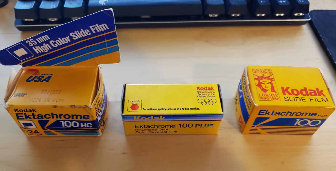

and about 5 of each from 1993, 2002, and 1987 in the respective order.
