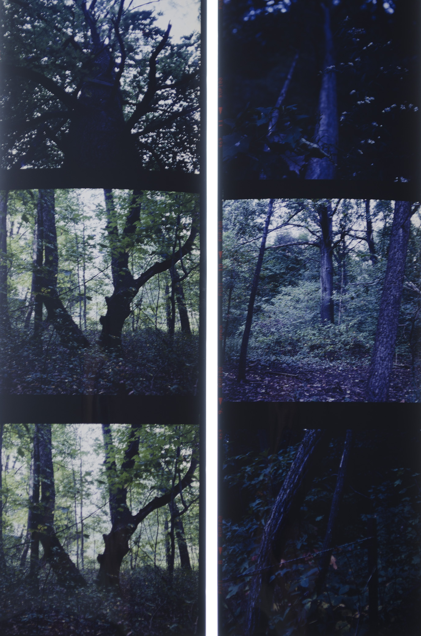

My first observation is that your picture order does not match the ISOs listed. The ISO 200 should be darker and the ISO 25 should be lighter.
My second observation is that I'm not sure Iron Out is a good reversal bath. It might do something to Iron, but I'm not sure it will properly fog the AgX in the emulsion.
PE
The ISOs are in the right order, but I scanned for "best light" rather than a consistent exposure in scanning. Basically want to demonstrate the best image you can get out of it, since projection is pretty much out the window either way.
Iron Out does work for standard B/W film. I use it with Ortho Litho film as a substitute for pre/post flashing for better contrast and to eek out a tiny bit more shadow detail from the very slow film. I'm confident it can fog silver, though I can't find much info on how much is needed nor the amount of time/temperature needed, especially for the dense color emulsions. Now, that being said, I of course have no idea if damage and color problems can come from using this on color emulsions
edit: No, you're right. The ISOs are in the opposite order. 200, 100, 50, 25

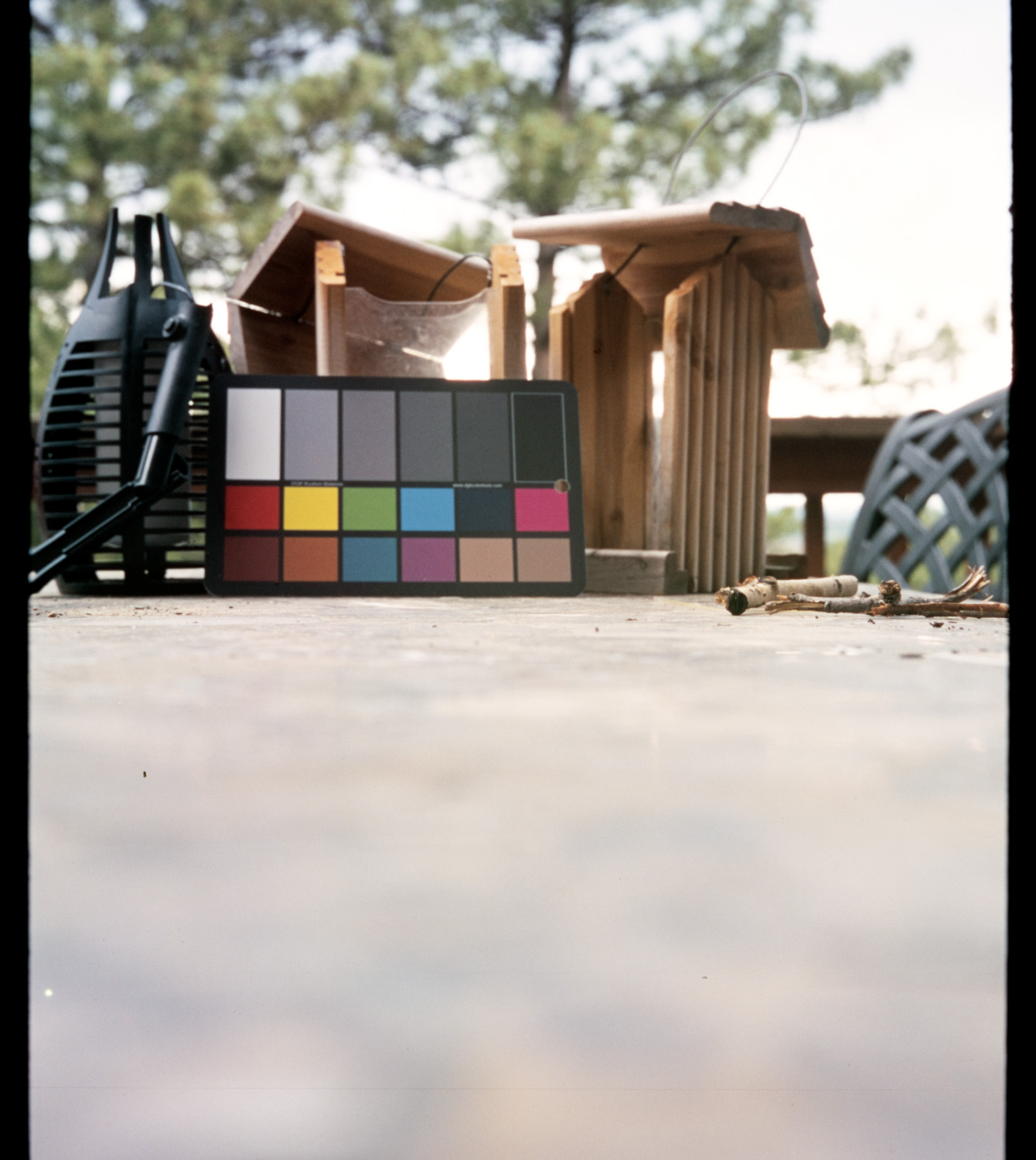

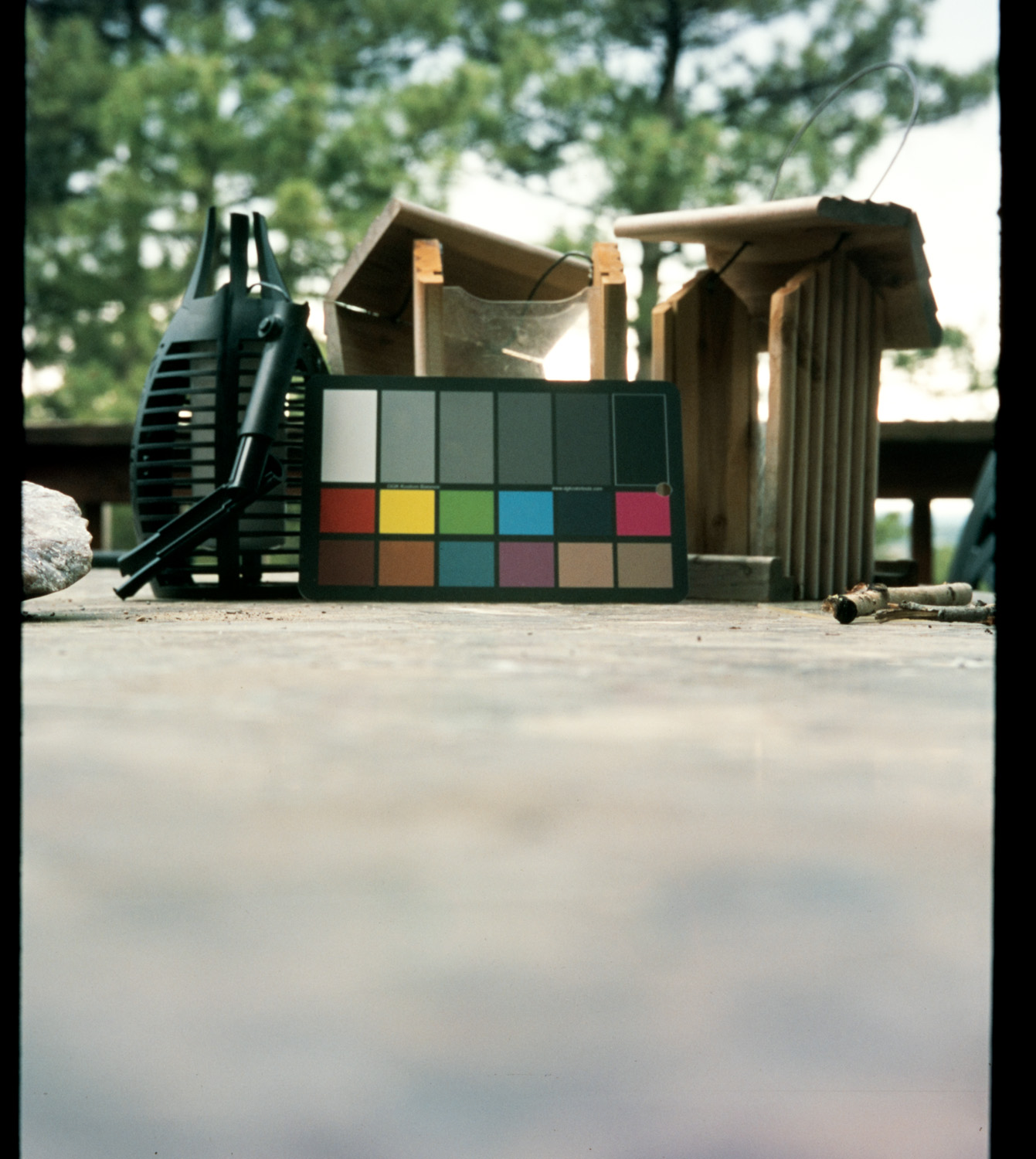

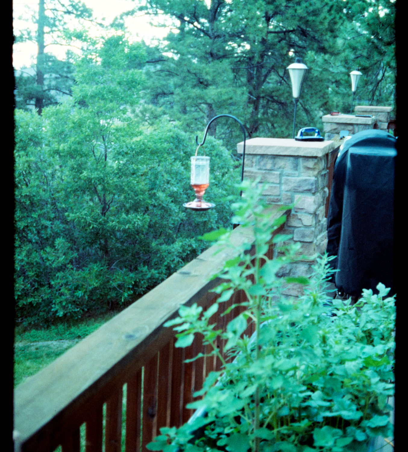

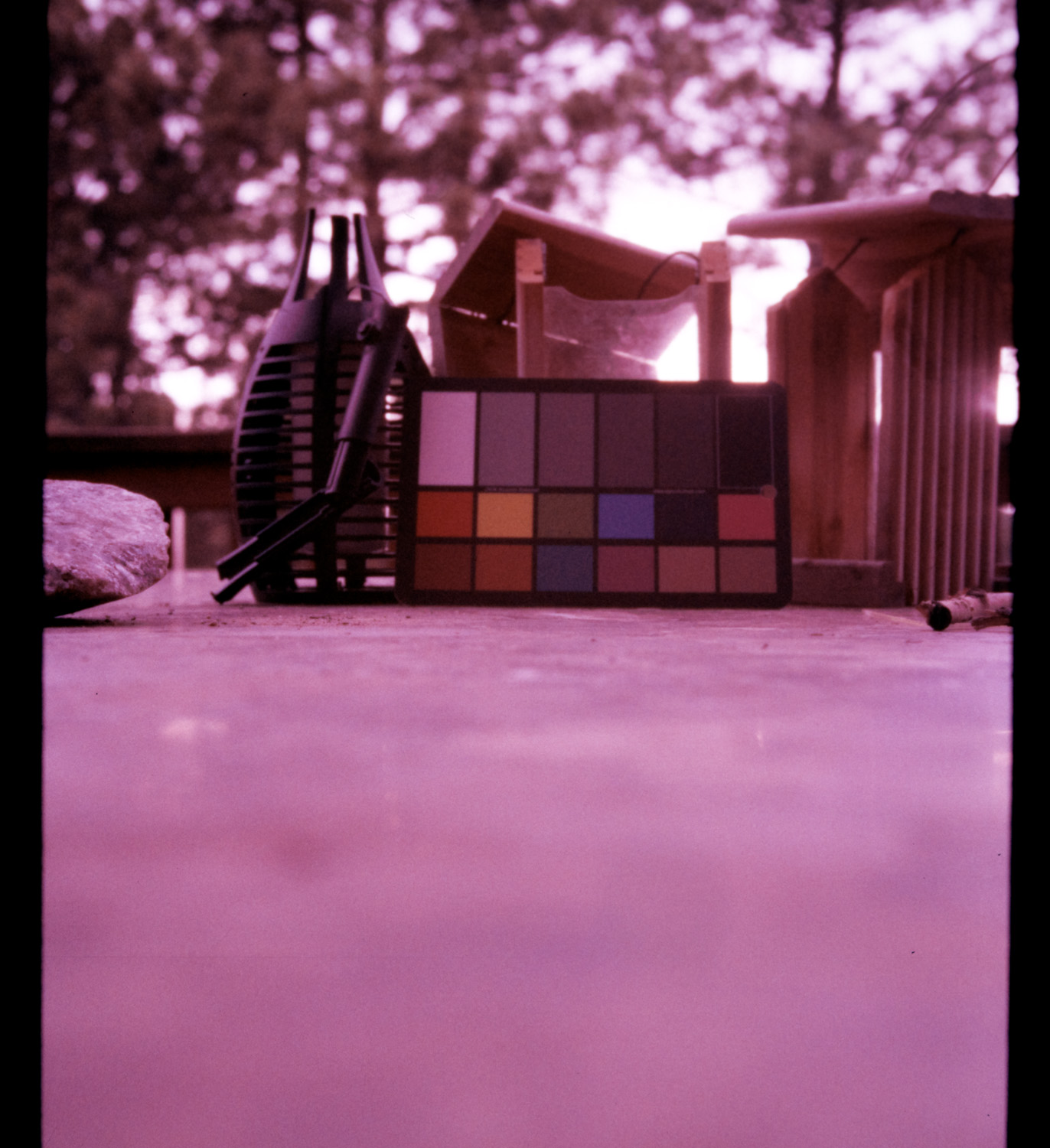

I tested 4 films in this. Velvia 50, Provia 100F, Lomo Color Negative 100, and Fuji Pro 400h. Results were overall pretty interesting. Dektol 1+1 seems to be closer to "correct" than Dektol 1+3 and HC-110 dil A. All tests conducted on a boring cloudy day (just before raining) with a Pen D3 camera. All ISO examples for E-6 are processed at 7650K/+23 tint. For C-41 films, the ISO tests are processed using 2750K/-4 tint. All lit by daylight backlight for scanning. Examples are "corrected" by opening levels and setting the white/black point of each R/G/B channel until they are just beginning to clip in the image area. Non-ISO examples are processed for "best image"
Provia 100F:
As always, this is the best looking one. Results look very natural, with a bit of blue cast. With this process, it looks pretty close to box speed, but has a surprising amount of over exposure latitude for slide film. Even +2 stops was still pretty reasonable. This would probably look better at 7m30s or 8m in the first developer, as ISO 50 actually looks a bit better despite some blown highlights.

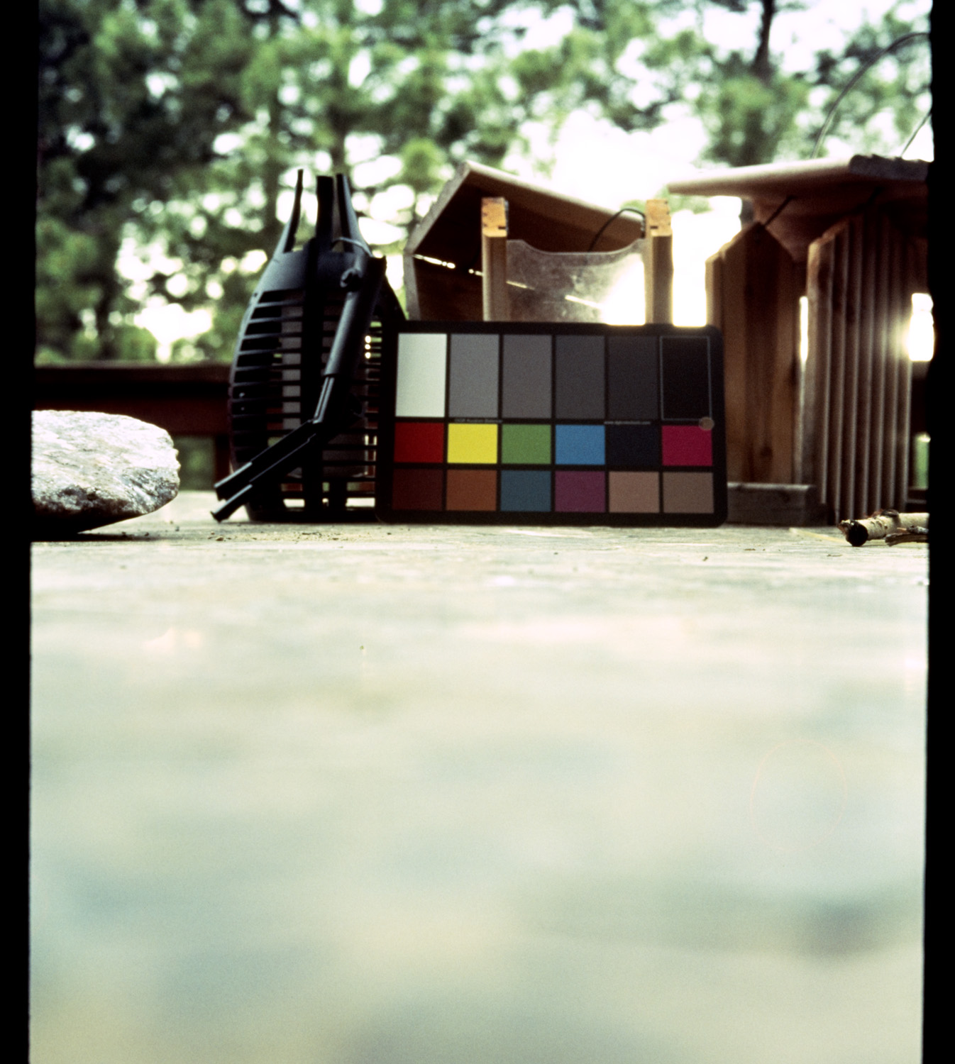

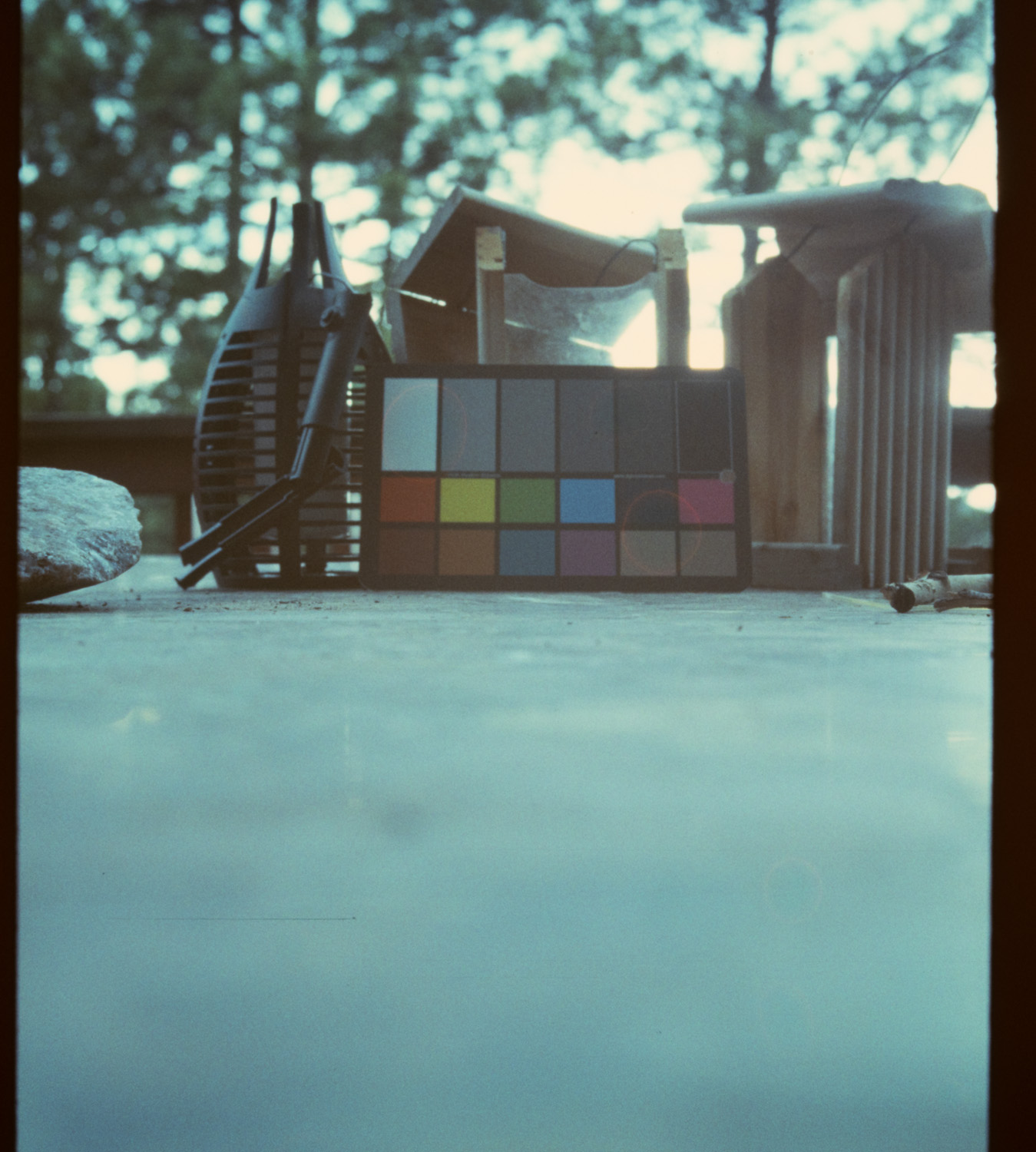

ISO 100:
ISO 50:

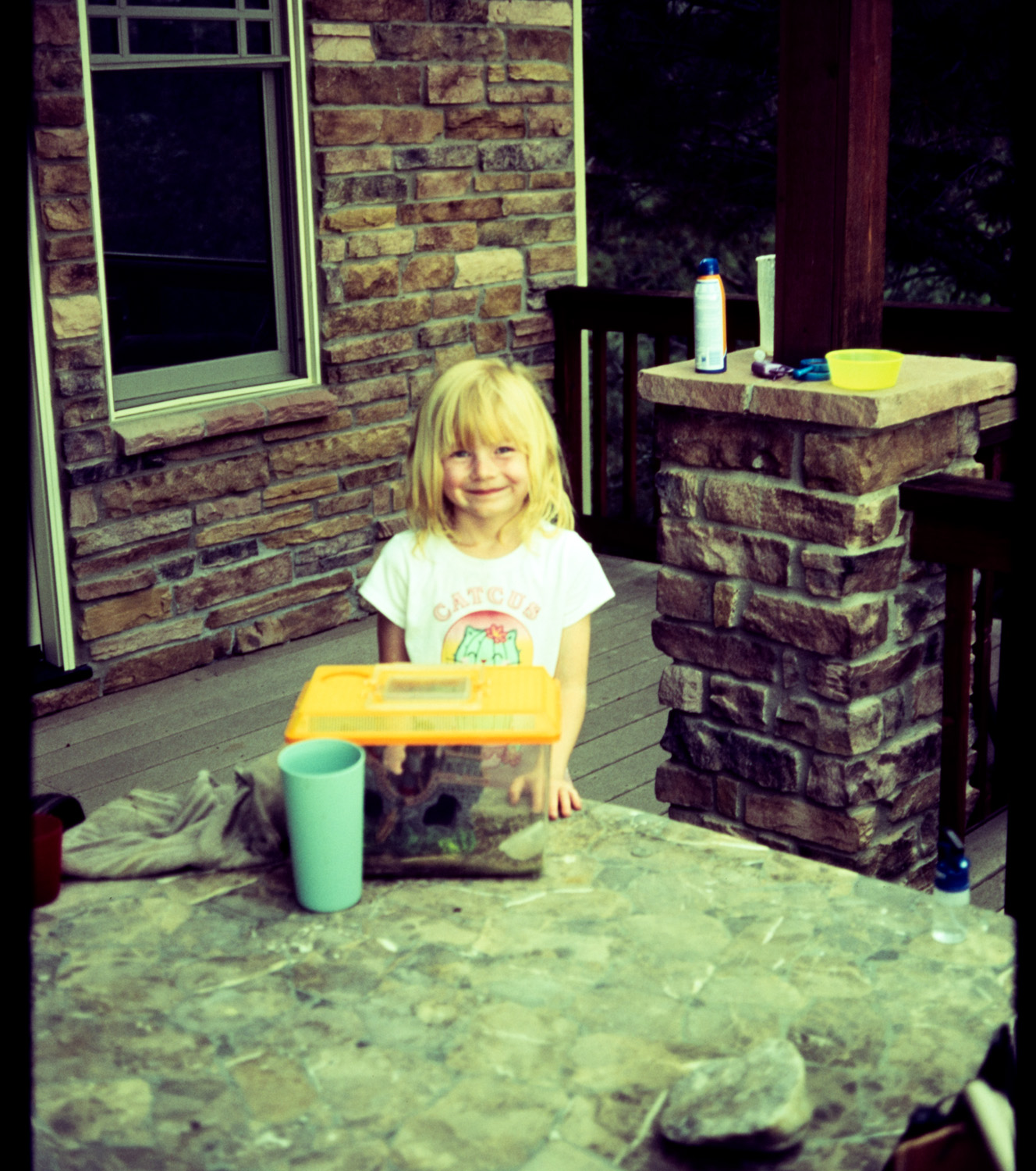

Random test picture:
colors are punchy and nice, with a slight greenish-blue cast with under exposure, (such as -2 stops)
Velvia 50:

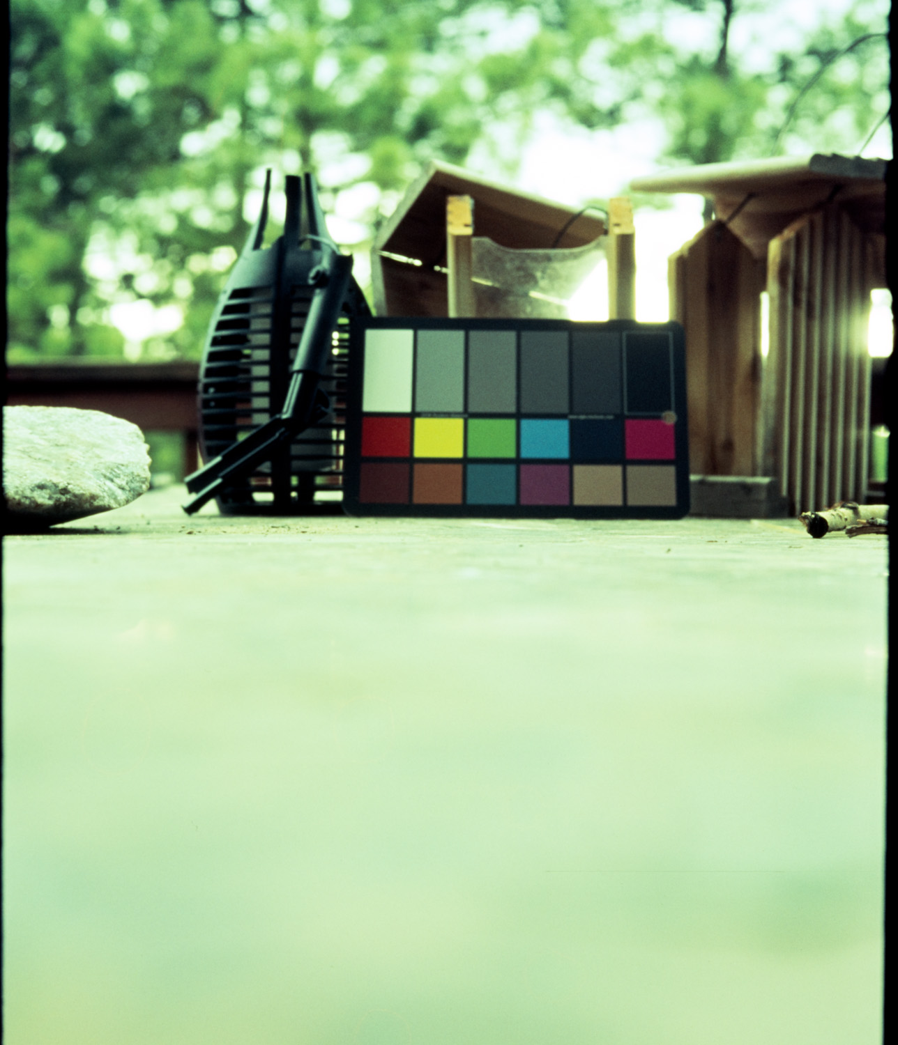

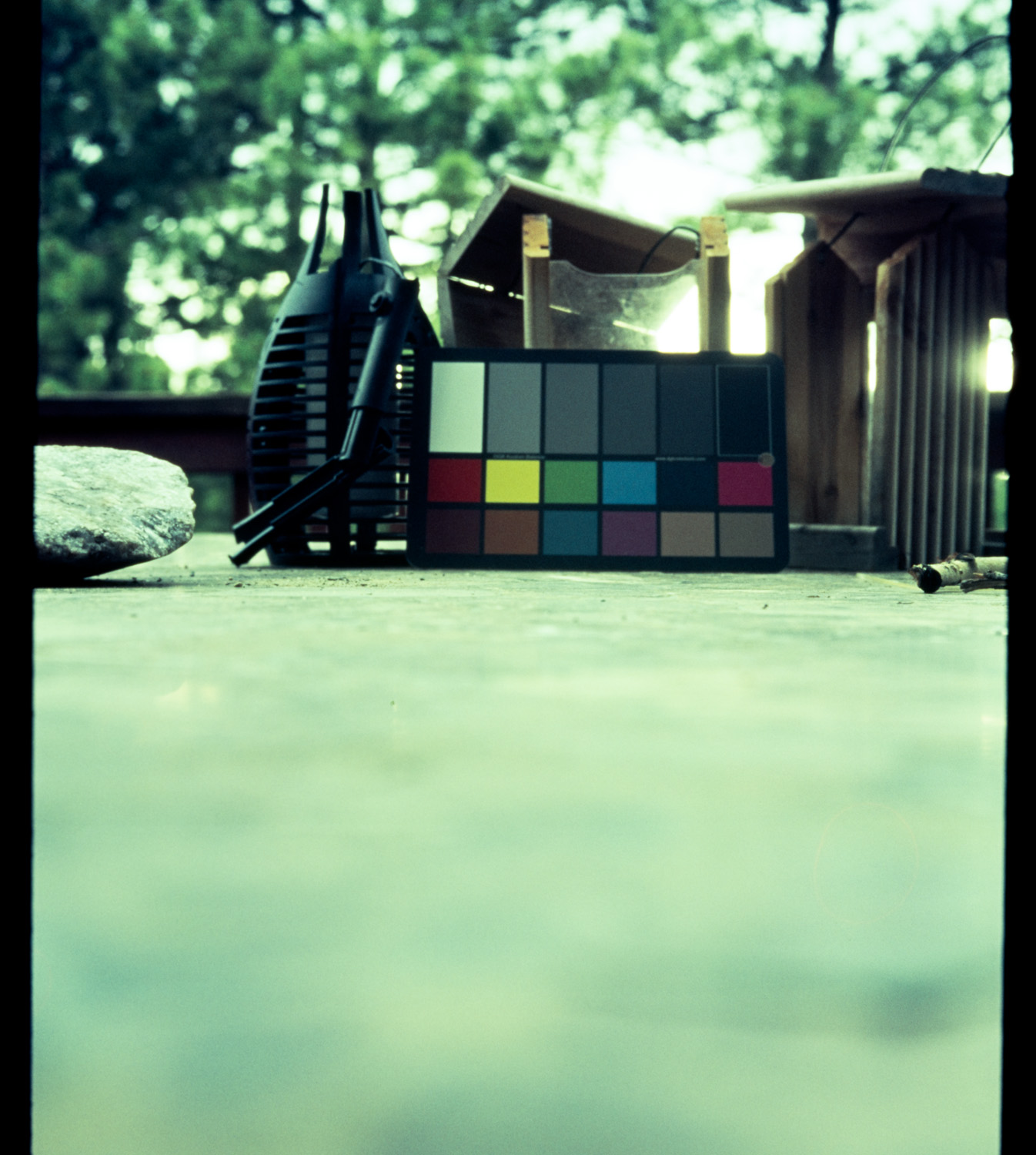

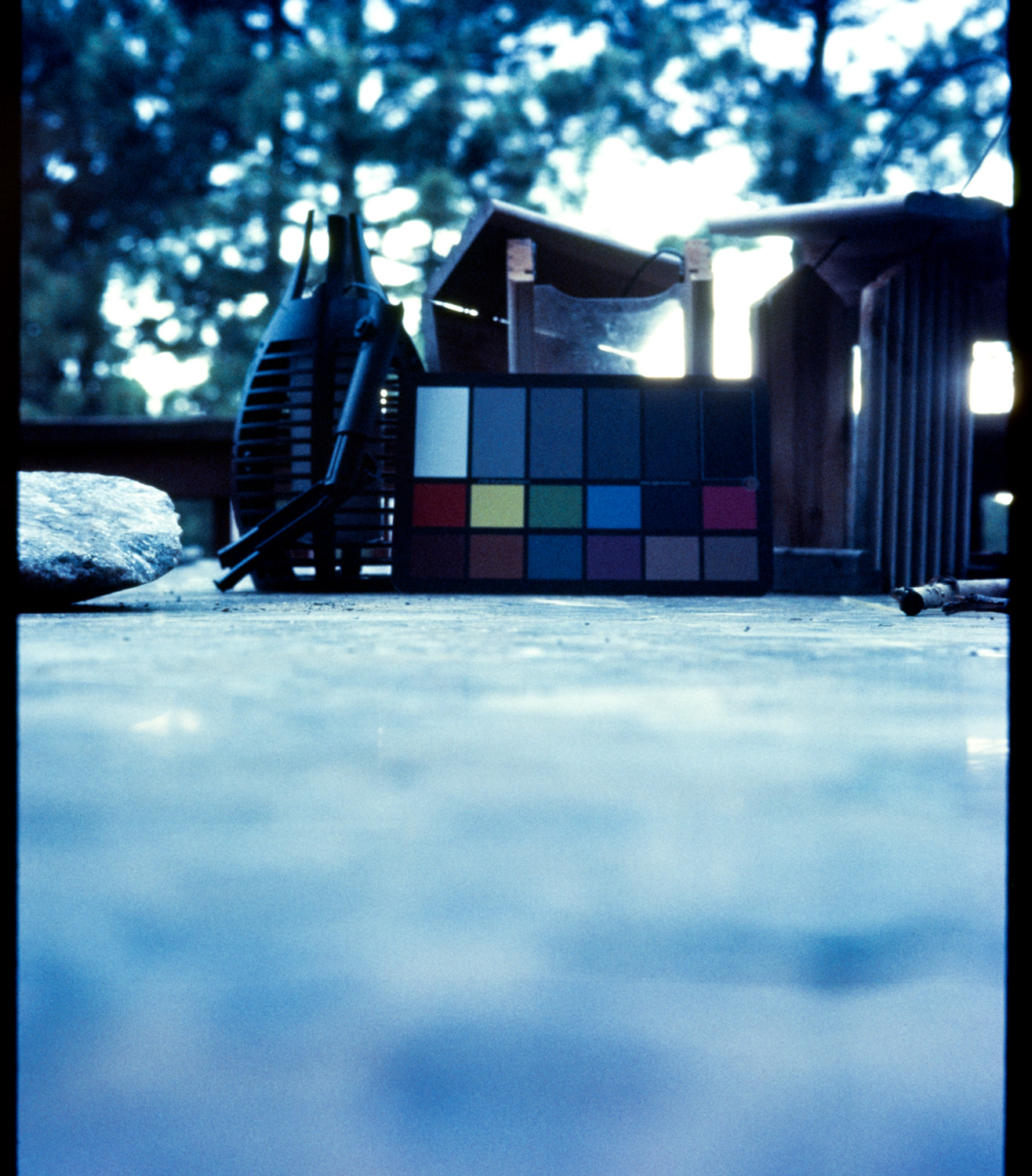

Velvia always seems to be the most tricky film with this x-pro reversal process. In HC-110 previously, it will have a thick magenta cast. Apparently with Dektol 1+1, it instead goes to green cast. The cast seems more workable than with HC-110. Colors are really saturated, with greens being especially deep, though also being corrected away due to the green cast. With under exposure it will go blue.
ISO 50:
ISO 25:
ISO 200:
"Best image" version of ISO 50:

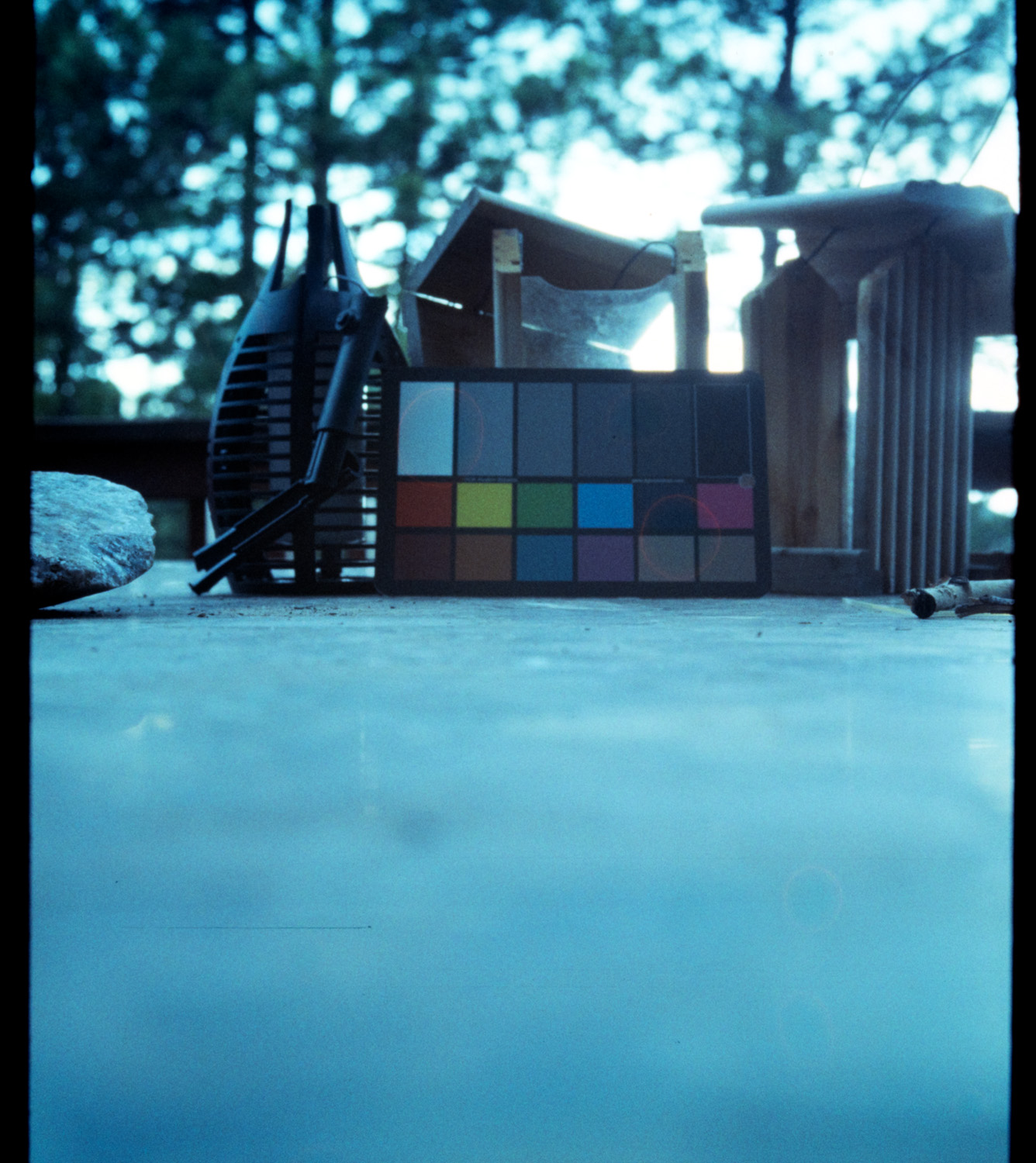

This ended up looking weird, well, more weird than C-41 films usually look in this. Really poor colors and density. I wasn't a fan. Also came out very pink, even with the insane whitepoint set on my DSLR when scanning
ISO 100:
ISO 400

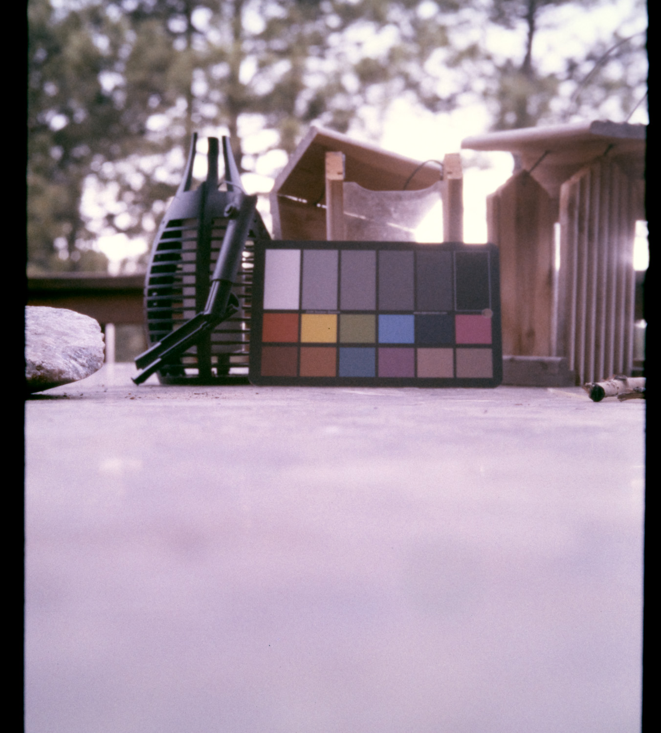

Fuji Pro 400H:
This one took my by surprise. I've never used this film before in this process, so wasn't sure what to expect. Colors are punchy to the raw eye, and with a raw scan. However, scanning while keeping these colors is quite difficult. The raw scans look better than white/black point processed.
ISO 400:
ISO 400 raw (no processing):
