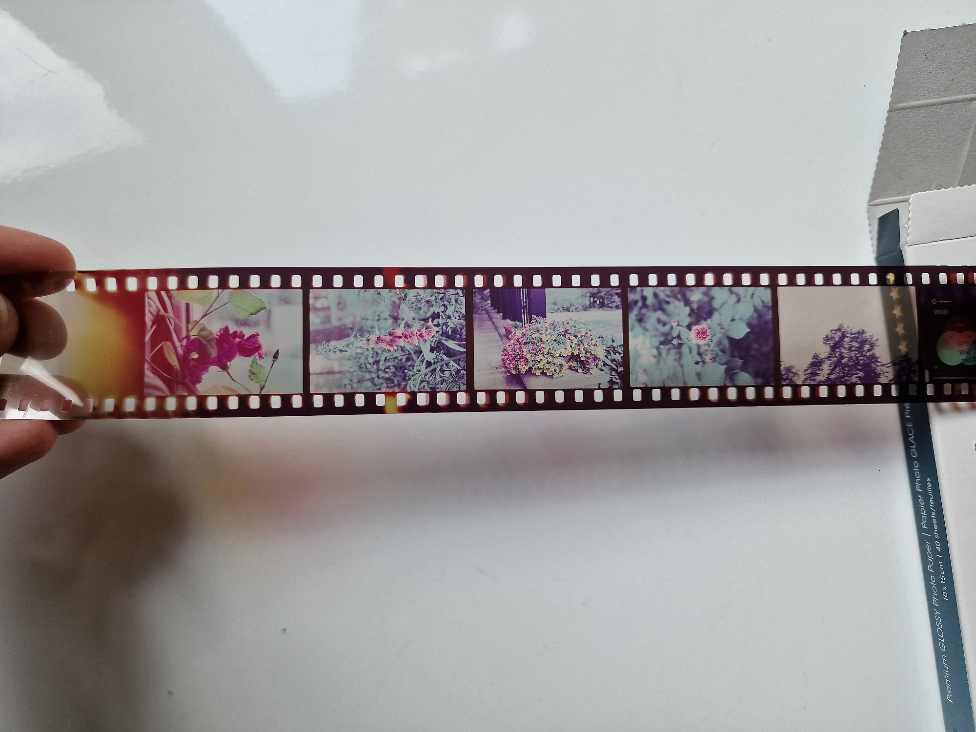

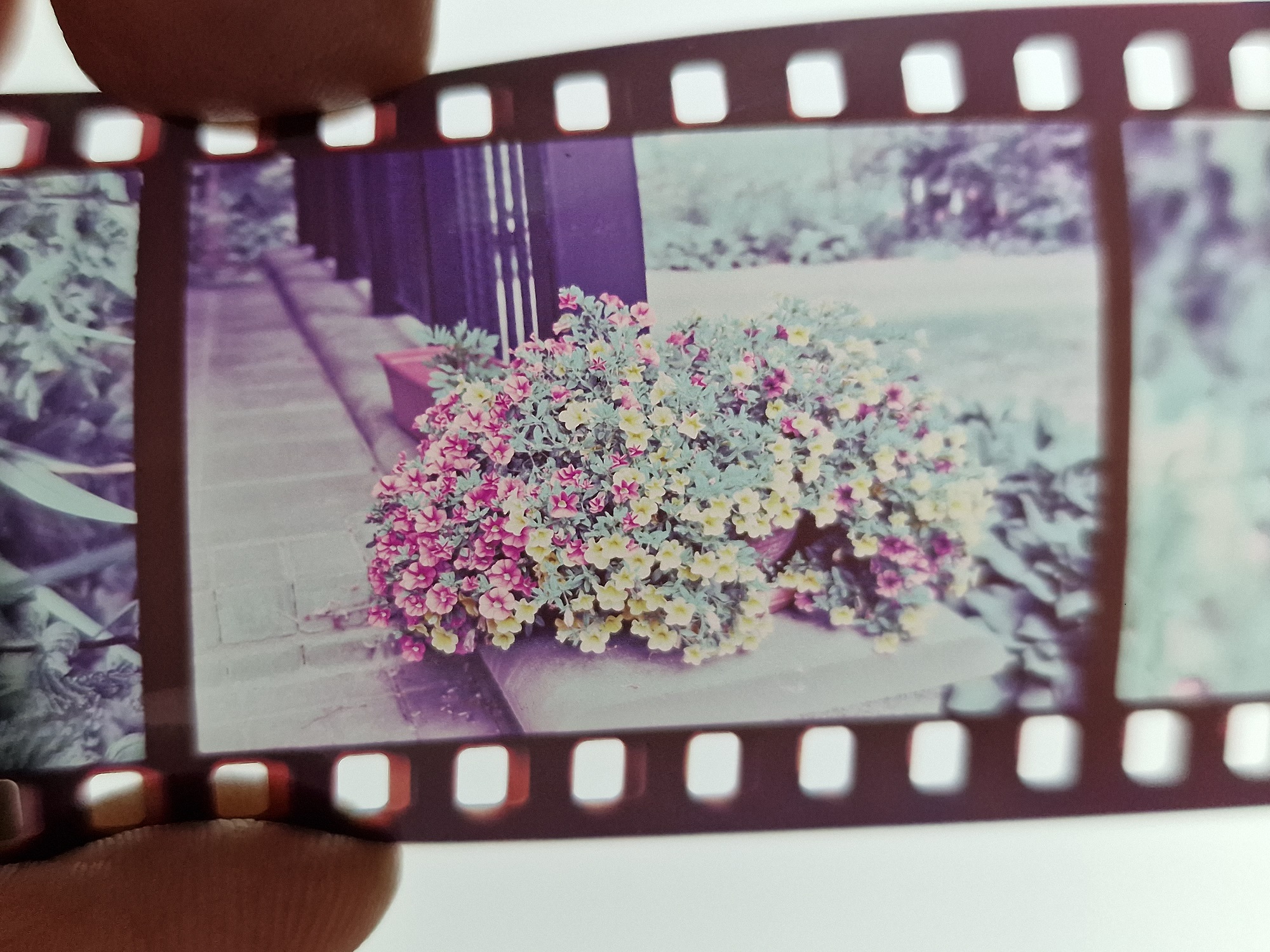

Just tried this with some kodak aerocolor. Rated it at EI 100, first developer adox atomal stock dillution at 39c for 12:30 agitating every 30 sec (seems like this may have been a bit too much first development). Got images that arent super dark like my first attempt at this process was (used 1:50 rodinal that time) but the colors and contrast are quite strange, as well as the unexposed parts of the film arent black but rather dark purplish magenta.

Hmmm interesting. The exposed leader doesnt seem to show any signs of premature color development occuring though. If anything, my first attempt at this process with Rodinal seemed to have more signs of premature color development than this. (cyan leader, partial inversion in the deepest parts of shadows causing the shadows to sort of "glow").

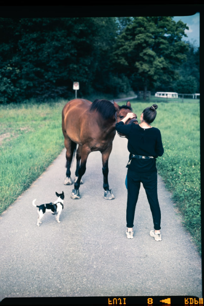

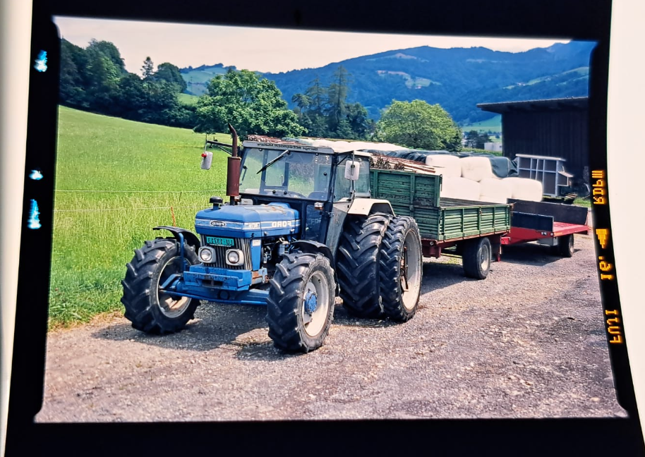

Gave this a shot yesterday with some 4x5 Ektachrome 100. Using HC-110A for the first developer and ECN-2 stuff for the rest (separate bleach and fix).
Pleasantly surprised at the results. I knew on paper that the CD-3 in ECN-2 was a better match for slide film than CD-4, but this honestly came out with no real noticeable color cast. The blue-ness, I think, is due to the film’s normal blue shadows, the time of morning I was shooting, and that I didn’t use my 81a because I wanted it cool. And I was largely taking a shot in the dark on development times.

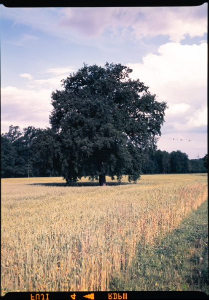

Hi folks,
my first post here.
Since I regularly shoot color negatives but only occasionally shoot slide film, I was looking for an alternative to the expensive and not long lasting E6 chemistry.
Back then I was successful with the use of Cinestill D6 as a first developer.
I wrote a short post about it on Reddit. (I hope a link is allowed)
I have done this process many times and it has given me very good results.
Since Cinestill D6 does not last long and is too expensive for just 1 film, I was looking for an alternative.
I was all the more interested when I read through this thread.
I then ordered my first bottle of HC110 and made my first attempt with the specified success formula of 1:9 and 6:30min.
Unfortunately, the results were not as good as with the films developed with D6. It seems that not all layers were developed evenly. I can't exactly classify the results.
It looks a bit like expired film, although it is fresh Provia 100.
Now my question to the community.
Is it, as I suspected, insufficient 1st development?
Could it be due to the new HC110 formula? (CAT 105 8692)
Should I try again with the same parameters (1:9, 6:30min)?
If I change the parameters, should I increase the concentration or extend the development time?
Thanks for your help!
philipp
Well, "insufficient" is perhaps simplifying it a bit too much. Let's call it "inappropriate", at least if you're after life-like colors. My guess is that the main problem is one of developer activity, which needs to be right on the mark to make all layers develop at the required rate. If you would treat this as 'insufficient' development and simply develop longer or at a higher temperature, you'll likely still run into severe color crossovers and aberrations.
A more promising route I believe would be to adjust the developer pH, so that the rate at which the developer penetrates the emulsion changes. Since you have a (severe) crossover problem in these slides, it's a bit of a guess which direction you need to adjust. Overall, the frames look too cyan, which suggests you'd have to adjust pH down a little. This may get you closer - but color problems will remain.
I don't think there's really a bulletproof way to replace a proper E6 first developer with something like HC110. There's too much going on about an E6 developer in terms of crossover behavior, toe-cutting and whatnot. Coaxing HC110 into working quite well would be analogous to just creating a new E6 developer from scratch.
If you're looking to cut costs while keeping somewhat acceptable color control, I'd be inclined to explore different routes, such as making the most out of a real E6 first developer through proper storage, saving film up and processing in batches so the developer doesn't sit around for too long between uses etc.

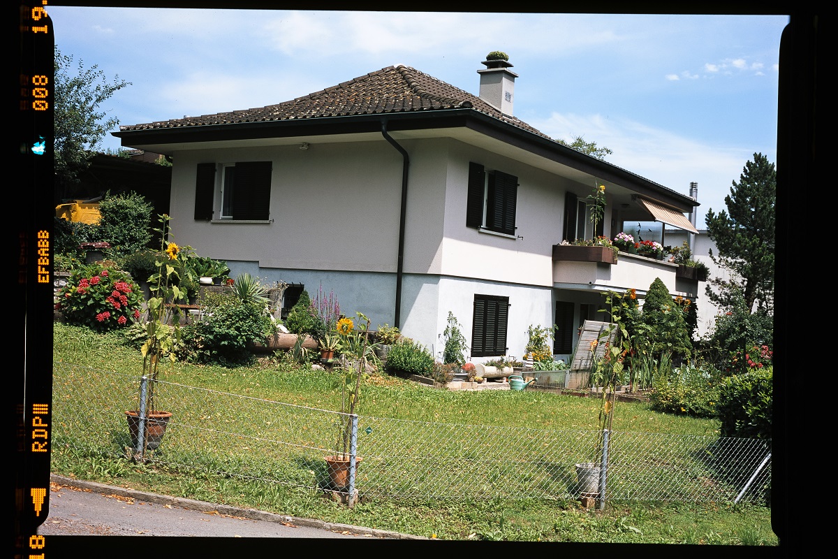

My curiosity got the better of me at the weekend and I gave it another try.

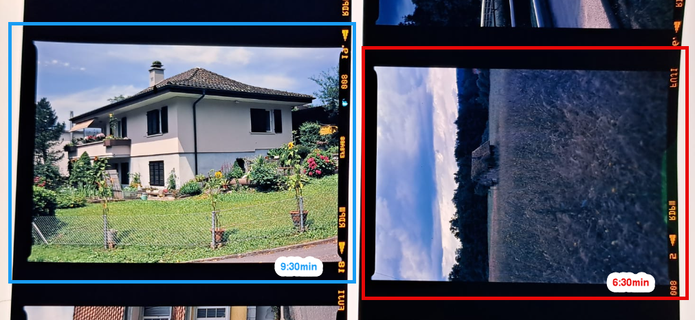

I developed a partial strip of Provia 100. I chose the same 1:9 dilution again but increased the time to 9:30min.
The slides turned out much better in my opinion, they look perfect on the lightpad.
As already mentioned, I have the HC110 in the new formulation (CAT 105 8692).
I would like to know if the successful attempts documented here were also made with the new HC110.
For me, the development time of 6:30min was clearly too short.
Other good samples with 9:30 in HC110 1:9
Yes, this looks a whole lot better indeed! I assume the orange cast in the 'other good samples' is due to a light balance issue when photographing the images on the light pad. In those further two images it does seem like contrast may have gone through the roof looking at how the skies render and especially the white plastic-wrapped bales behind the tractor.
these are just smartphone snapshots, which are probably difficult to judge. when i have time, i'll make proper scans.

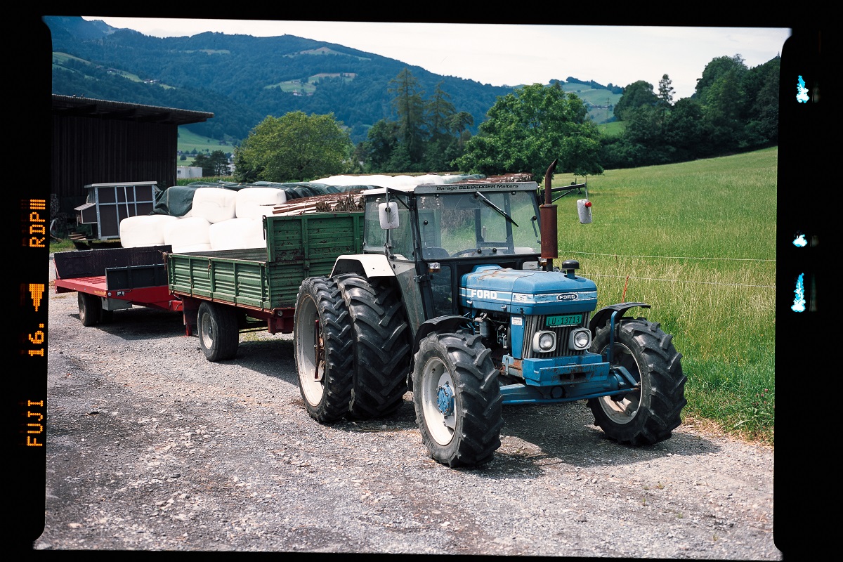

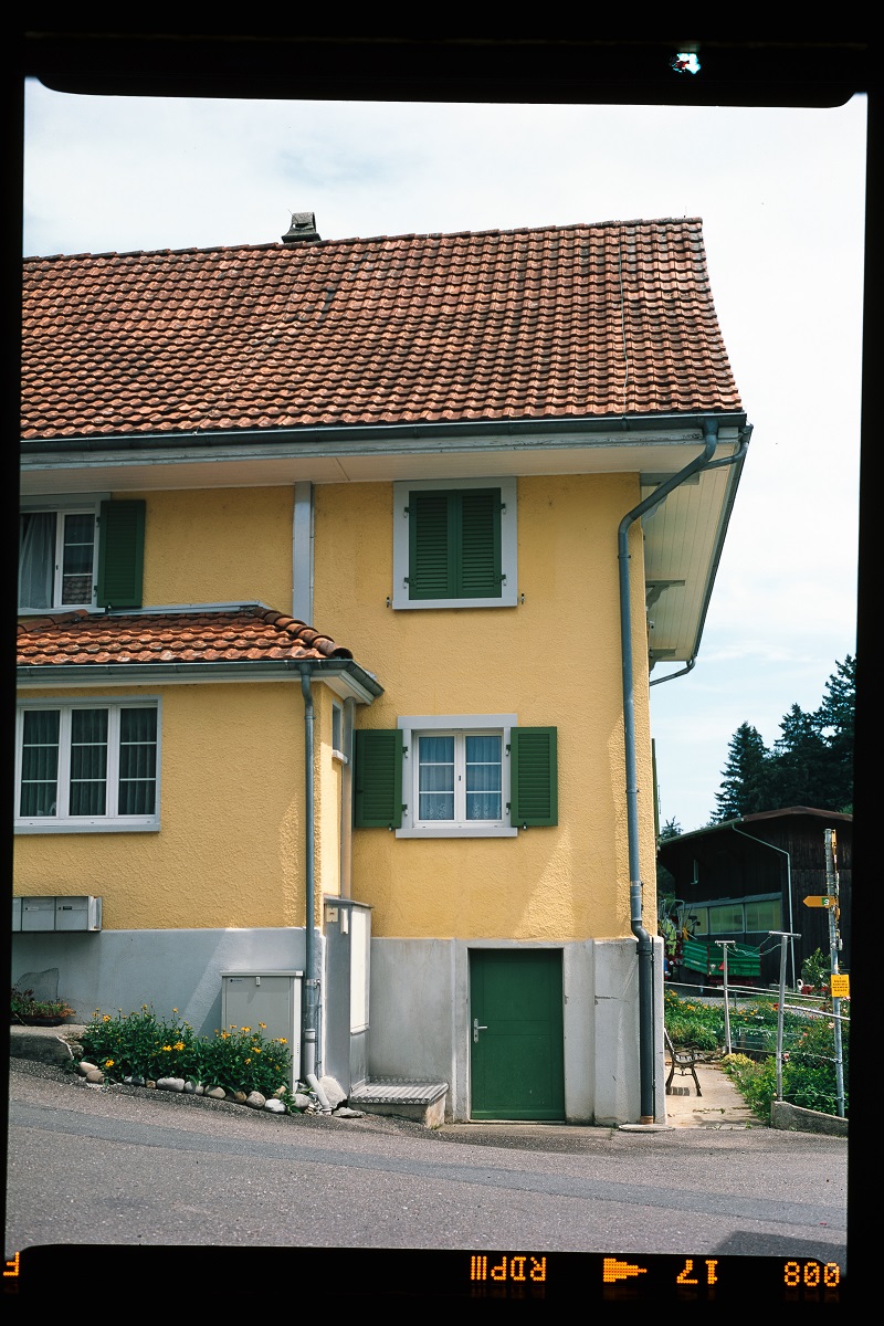

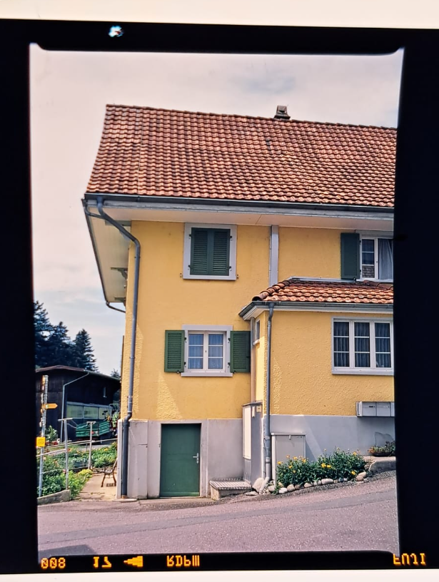

And here are the scans, digitalized with my Sony A7.
I am very pleased with the results!
The colors pop nicely! Do you observe some color difference between E-6 color developer and C-41 one? C-41 contains different color agent (CD-4) which reportedly gives more saturated colors.

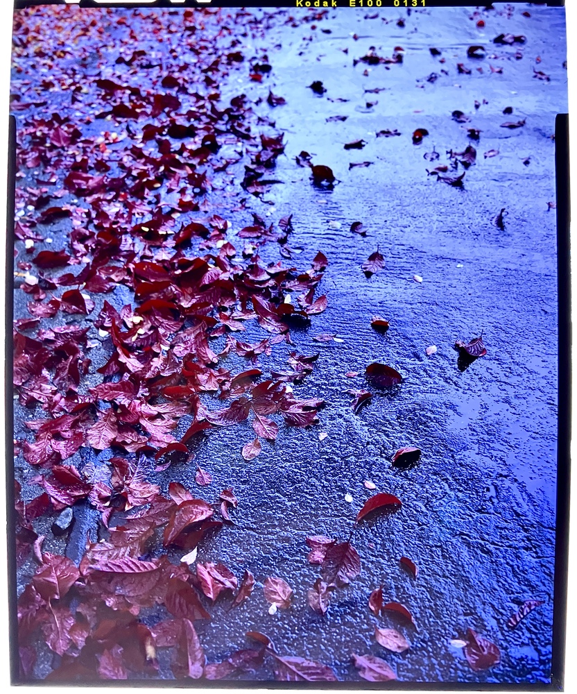

I am very happy with the results I'm getting with fresh E100 using HC-110 as my first developer and then ECN-2 color dev/bleach/fix after light fogging. Honestly I can't really tell it apart from rolls/sheets I've done in the past with the FPP's E6 kits.
