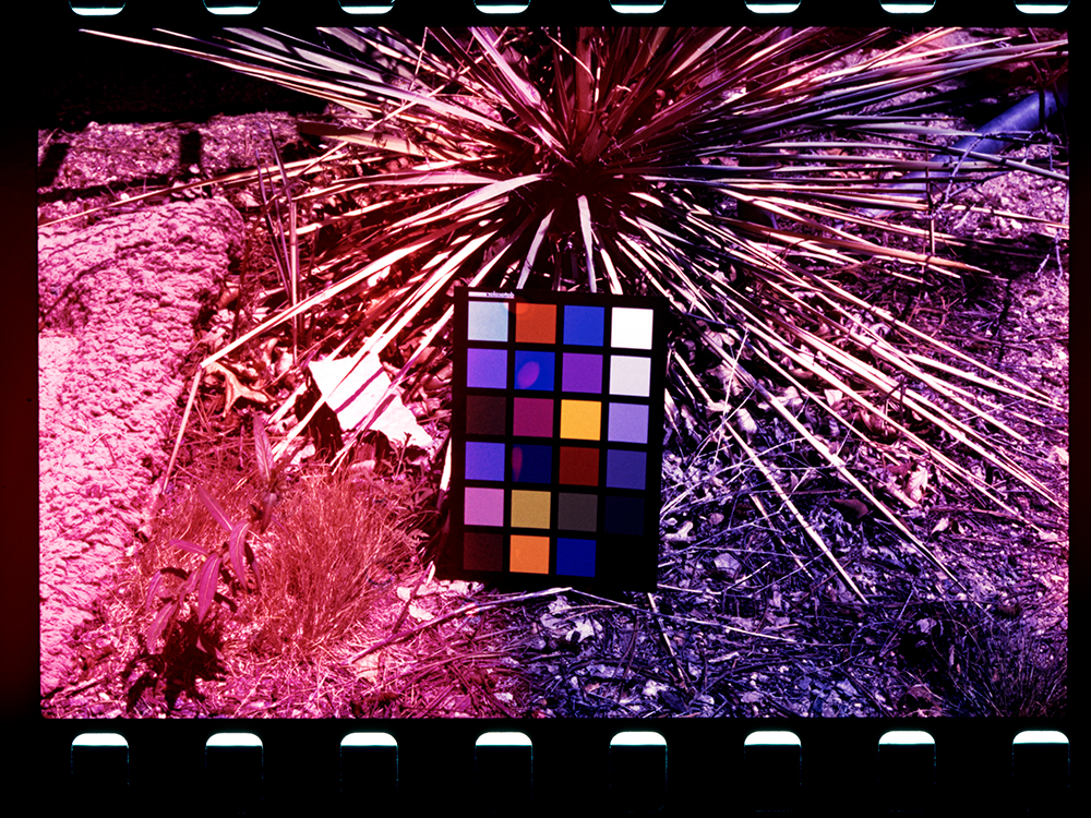

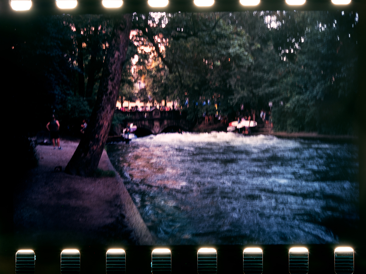

Maybe a new way of shooting expired film? Over expose to hell and pray for the best. I tried it with Kodak Gold 200 expired 2004 that was VERY badly stored (tons of base fog when processed normally). Color crossing is definitely present, but looks like it could make for some cool pictures. I have a freely acquired 10 pack of this stuff and figured I'd sacrifice a roll to see what the behavior was. Here is some brackets of 50, 100, and 200. Grain is significantly more controllable than standard negatives from this expired film, but I think this would've benefited from a push in first development, maybe extended development to 8 minutes or even 10
(All images color balanced by setting white point and black point. Using gray point gave weird results due to the color crossing. No further adjustments were made except for automatic exposure by my DSLR while scanning)
Also, for fun, here is what Portra 400 (not expired) looks like at ISO 100... Don't ever use Portra 400 or 160 with this process, there is something weird about the film that causes strange fog and bubble issues (despite other rolls having no problems in the same tank). Haven't tried Portra 800 yet.

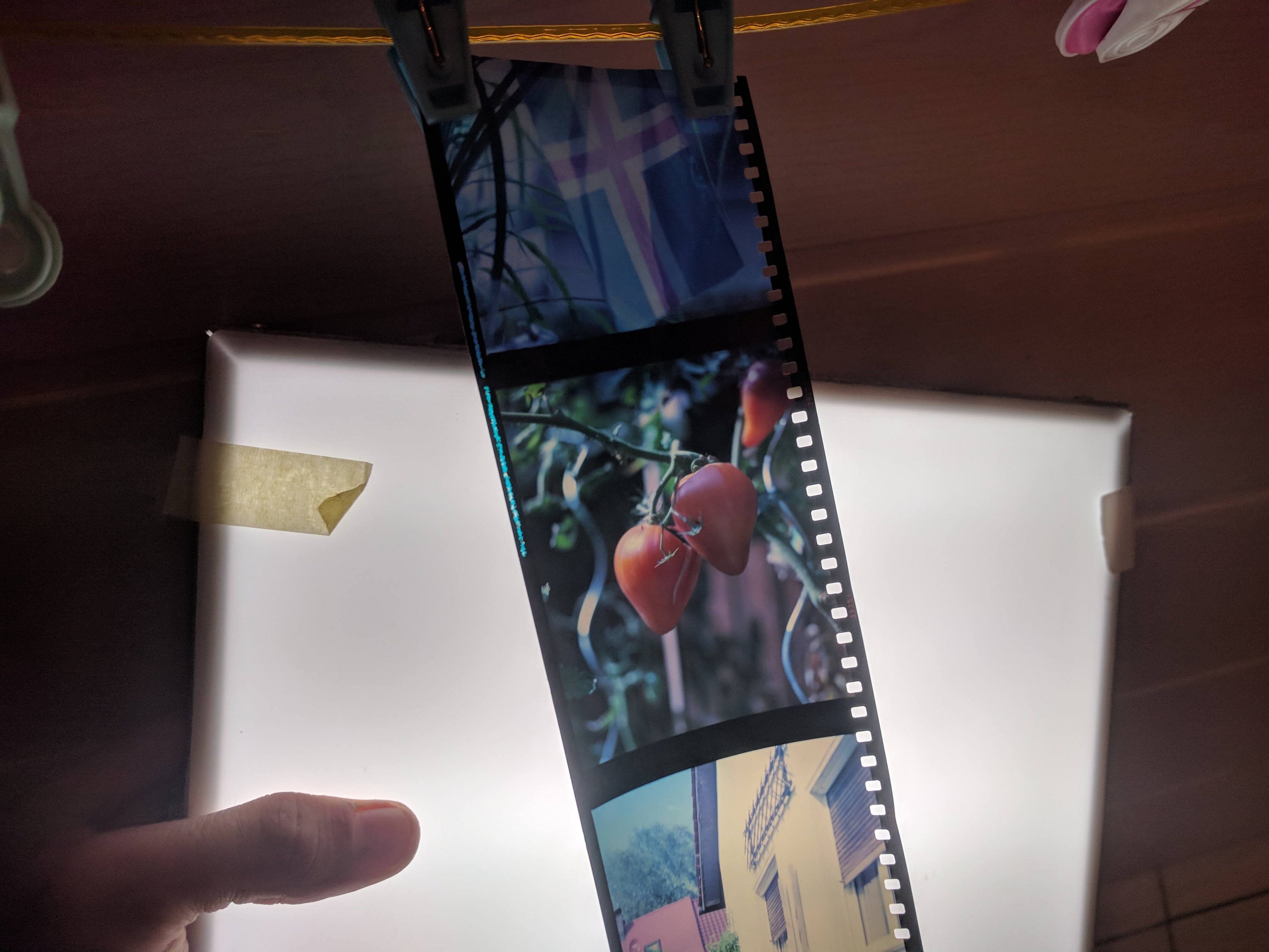

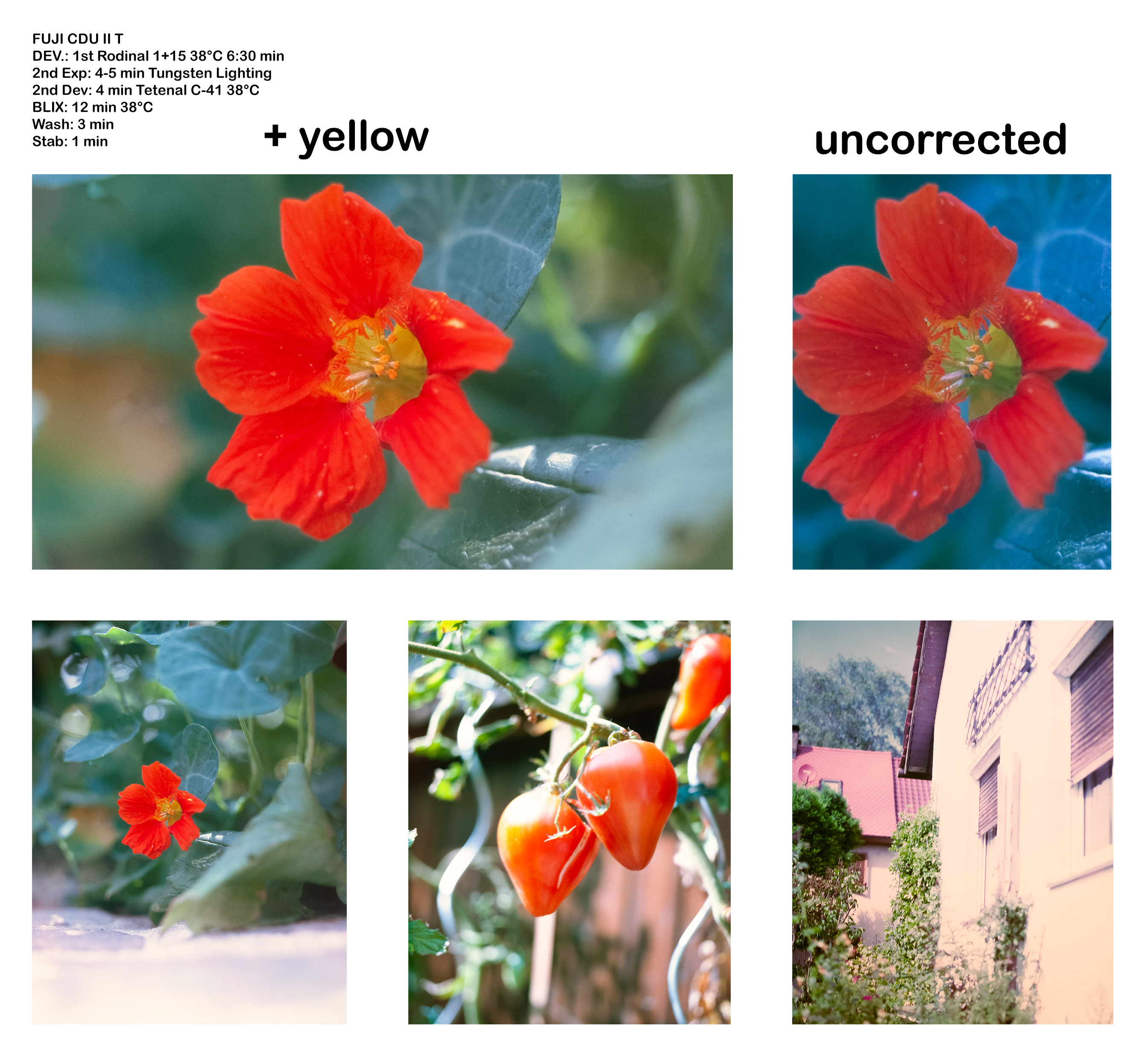

I couldn´t resist to try this. Everything done according to OP´s recipe, except I used Rodinal and a Tungsten Light source. Apparently Tungstenslidefilm (FUJI CDU2) shot in Daylight and reexposed with Tungsten creates a daylightish balance.
Nice! Looks great. What kind of recipe did you use for Rodinal? I've been especially curious to do stand development with this, but all of my experiments thus far either result in extreme amounts of fog, or massive under development.
I used the Rodinal in 1:15 dilution at 38°C/102°F for 6:30mins and agitated with rotation rather than Inversion for every 30 Seconds with 10sec initial rotation. The fog was quite intense but my 2nd exposure was about 3 minutes directly iver the lightsource ans about another 2-3 minutes in the dimly illuminated darkroom because I had trouble getting the Film Back Into the reel. If the First negative is too dense just expose longer, basically you can so almost No harm in this step, Maybe 2-3 more minutes are sufficient enough to compensate for too high neg density. After that everything was done according the Tetenal Manual +1stop of push and 2 x blixtime.

Was there any apparent color casts when you scanned it? It looks very slightly blue from the picture you posted, but that could be that you used tungsten balanced film for daylight. Also, I'd be curious to know in a more objective way if longer fogging times can help dense first-development negatives. Did you do any A/B testing on it to compare with extra fog vs without?
I didn't have time to scan ist properly yet. The Images you See are Just crappy Cellphone Pics. The light Blue Cast comes from the Film, but its usually much worse than this when its Shot in daylight. So i think the tungsten reexposure remedied that issue. I didn't do any objective testing yet, since this was the first slidefilm i developed with this process. But in my understanding of the process longer exposure should Help with a too dense negative. Maybe PE has an opinion about the issue.
Re-exposure does not change any color cast if done to completion, which is the aim of re-exposure. It also does not help with the density overall. It is merely a step to expose the remaining positive image which is left after the FD does its job. Then the CD takes over with that silver and creates the final color positive.

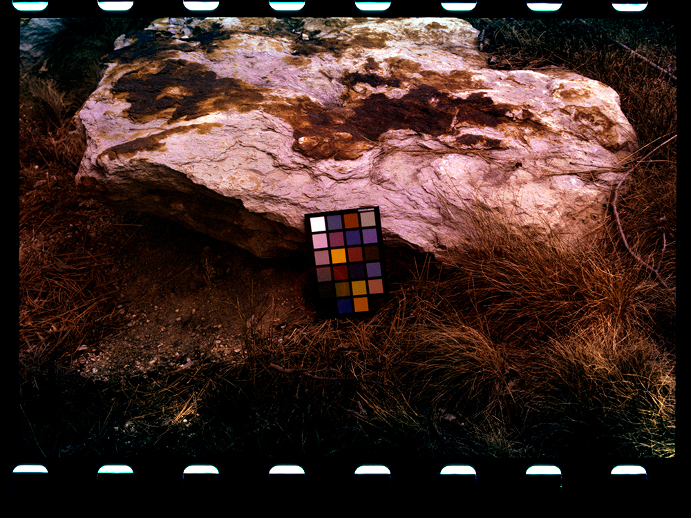

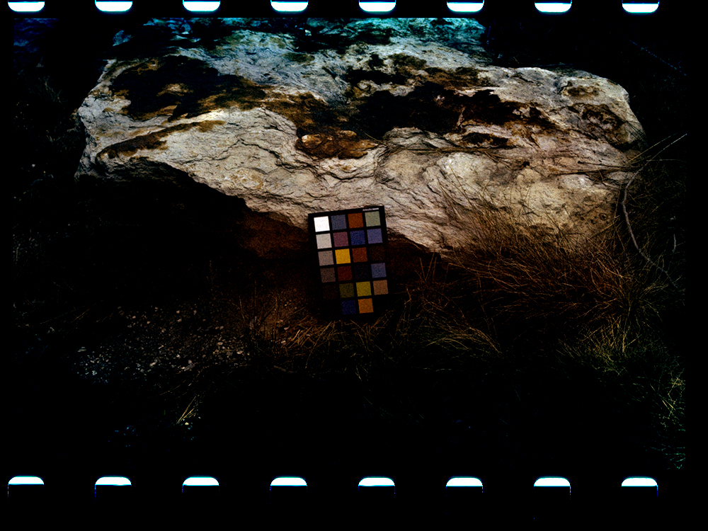

Well, today I learned it is possible to "skip fix" (rather than skip bleach) and end up with dense, but scannable images. Over a fairly bright lightpad, my DSLR scanned this at 3s and f/8, to give an idea of how dense this is. Also, only tried it with a single (apparently blurred) exposure since I wasn't sure what would happen, so sorry for a low quality example.. Also, no idea why anyone would want to do this, since it's clearly not capable of being projected, and a real pain to scan properly (a. Maybe for archiving, since the silver will keep longer than the dyes? Also, this really warmed up the image with a base red cast in the shadows; previous pictures in the same light/scene were on the cool side.

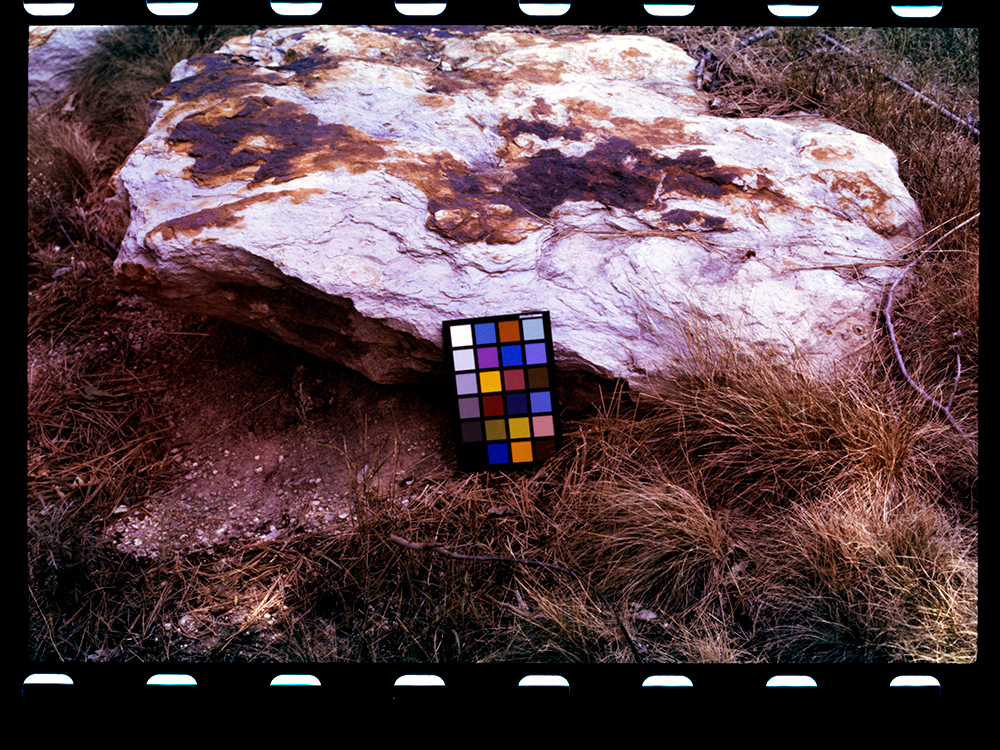

For people using this process for C-41 films, I have a project underway to experiment with the whole x-pro look. Seems like something the lomo crowd would be interested in as an alternative to standard X-Pro.
I've discovered that C-41 film needs around 7m30s in the first developer, otherwise it needs around 1.5 stops of over exposure to look best. This would be equivalent to around a 1 stop push with E-6 film, if you're wanting to develop these films at the same time. However, I also get better results with C-41 films using the exact C-41 times for everything in the color development etc, so it might just have to be recommended to process the two types of film separately. Sometime soon I'm going to try to trick a C-41 lab to process this and see if the results match my home development. In theory I should just need to do first development, fogging, and then stuff it into a canister. Unfortunately it's not reasonable to do this with E-6 film since it needs a longer bleach time. You might be able to convince a lab to work with you though by turning off the machine in the bleach step.
Right now I'm working on a project to test every C-41 film that is available in non-expired form in this process. I'll shoot a few color chart tests, and then real world usage to see how useful this is out in the field. I'll update here as I make progress and when I have it complete and written up
