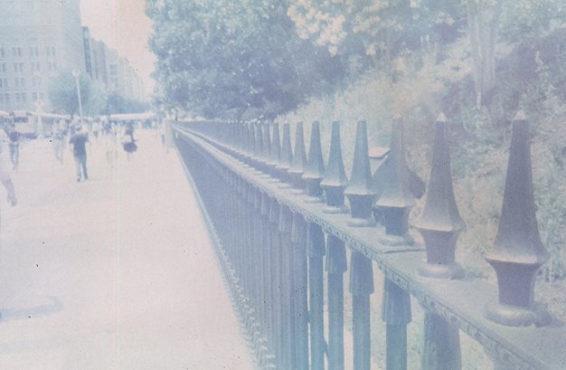

Looks to me like the C-41 color development wasn't long enough. But it could also be how old expired film behaves when done using reversal. Normally with negative processing, you build up a base fog on expired film. But in reversal, this basically turns into the opposite so that everything looks faded and highlights are more likely to go clear. It looks like there is plenty of detail on the images, so I think B/W development was good. However, to compensate for the base fog, you might try a shorter first development time, like maybe 5:30 or 5:00. I'm interested to see what kind of colors you got with the process though. You can't really tell from the grainy cell phone pic. I've not tried this with unpreserved expired film yet (my Ektachrome had been frozen)

I have used a potent LED flashlight for the reverse exposure. The light has 5 or 6 LEDs, left it on the Jobo reel gave it about 30 seconds on both sides, with flashlight in direct contact, moving randomly to fog the film. I was processing Provia F in 60 year old chemistry. Results look very similar. I never got to box speed because I didn't raise the temperature of the 1st Developer high enough.

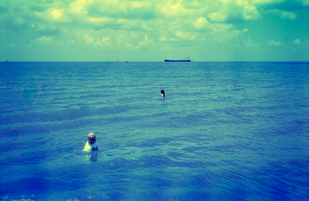

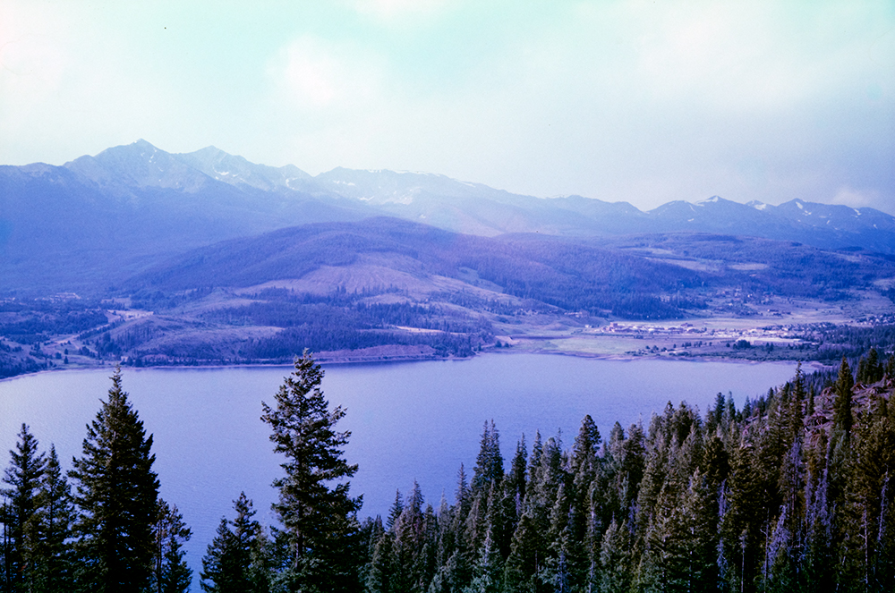

Here are scans of Superia 200 and Cinestill 50D:
Superia:
And Cinestill 50D:
Both films are pretty nice as far as grain, but with definite color crossing. The C200 color crossing looks somewhat nice, it adds an interesting palette like a lighter version of the Lomo Purple stuff. It looks awful when over exposed even a bit though. Better aim for under exposure on this one.

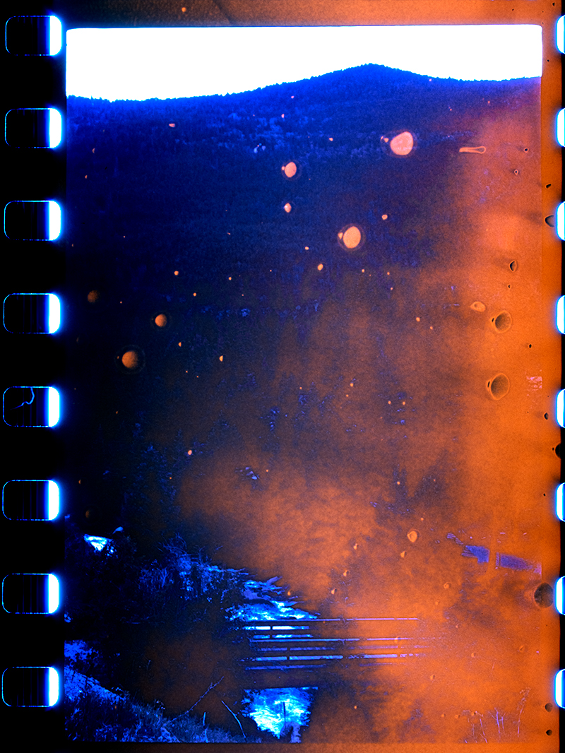

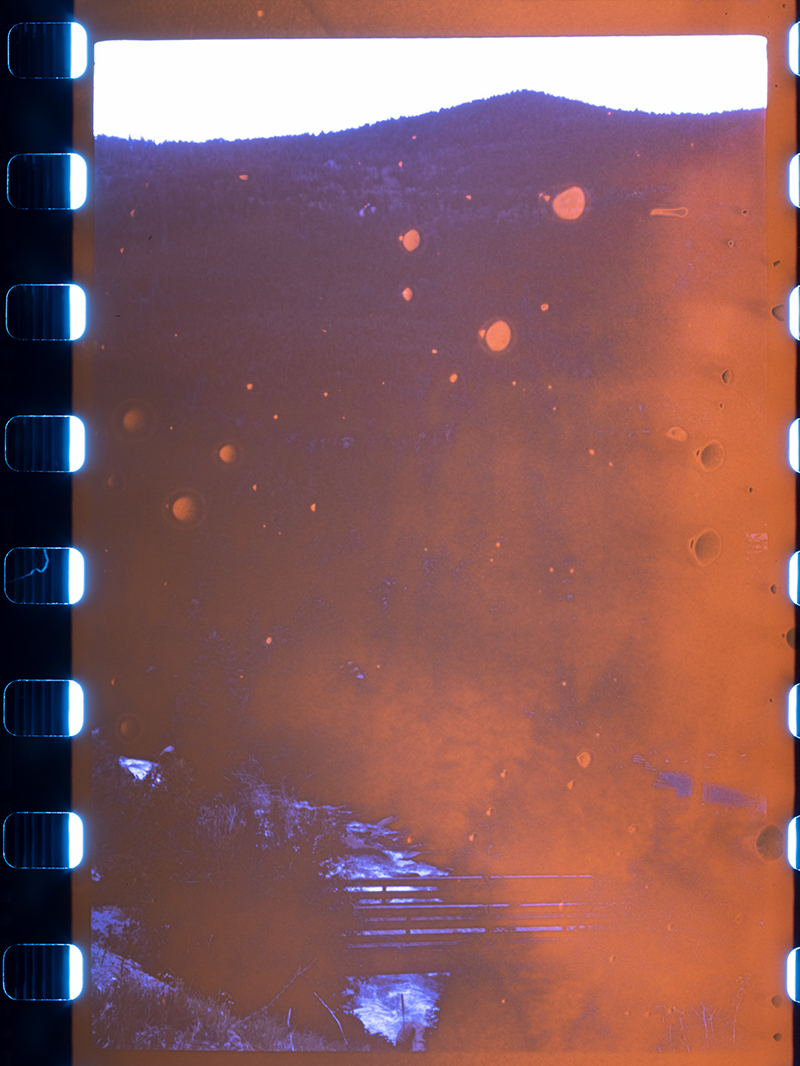

Scanned in my Portra 160 today that was developed in this process and got some really strange artifacts. It looks like not enough blix, but putting it back into blix didn't fix it. Anyone ever seen something like this? The little dots are not water stains either, it's on the emulsion itself.
With some color correction:
Raw scan:
Zooming in, it doesn't look more grainy like I'd expect under bleaching to look like, but it does stay in the shadows and leaves the highlights alone. Definitely some kind of developing error, but unsure what.
Insufficient first developer is definitely one of them.
This occurred only on one part of the roll. It seems maybe the film was touching on the reels. Other rolls in the same tank worked ok, though I think my color developer is ruined now
Now it makes sense. The film definitely touched something.
