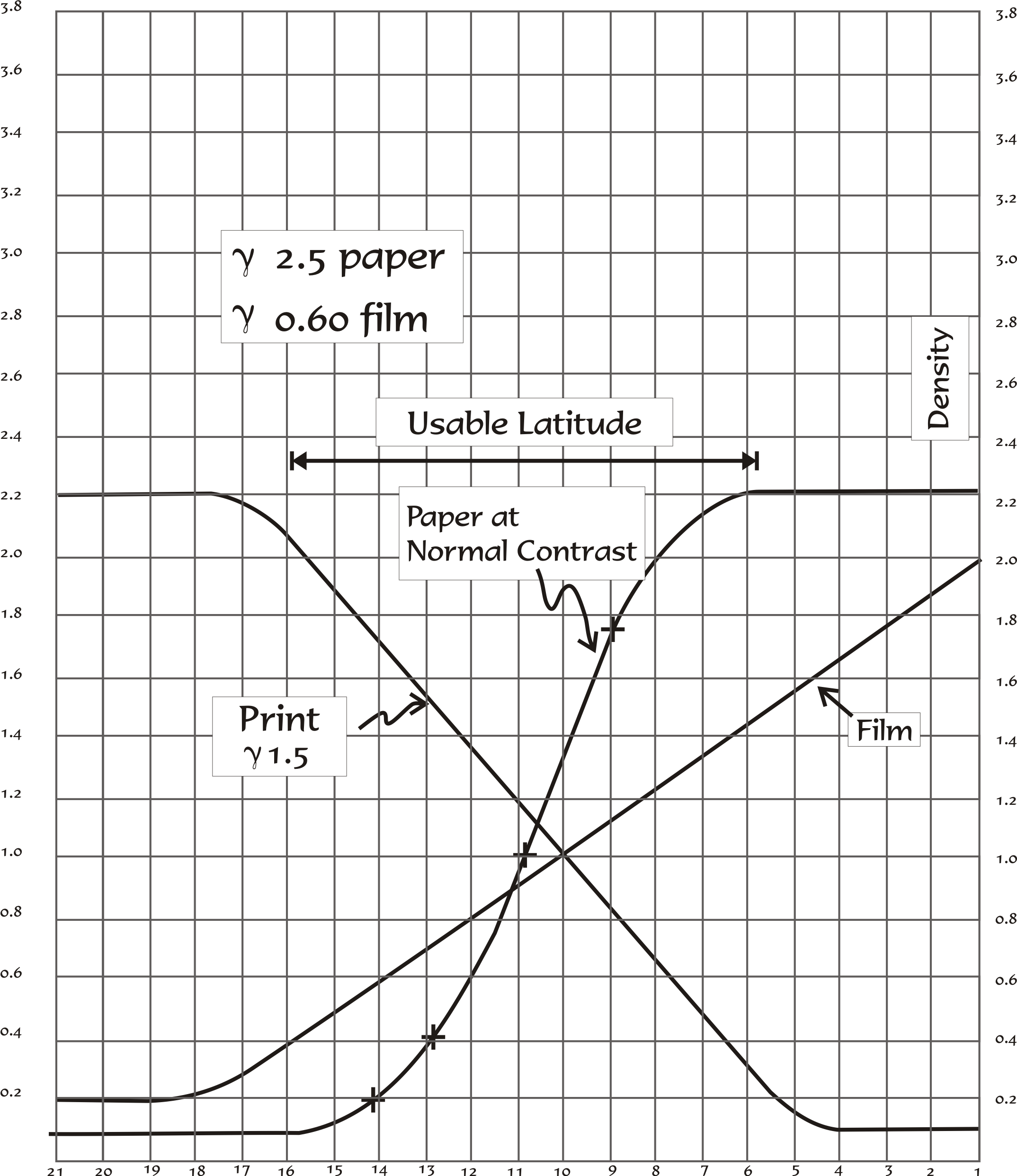

Ted, negative MP films are about gamma 0.55, professional still about 0.60 - 0.65 and amateur/consumer are about 0.75+ having been adjusted for the (assumed) higher flare of cheaper cameras.
Color paper is about 2.5 which gives 0.6 x 2.5 or about 1.5.
PE
