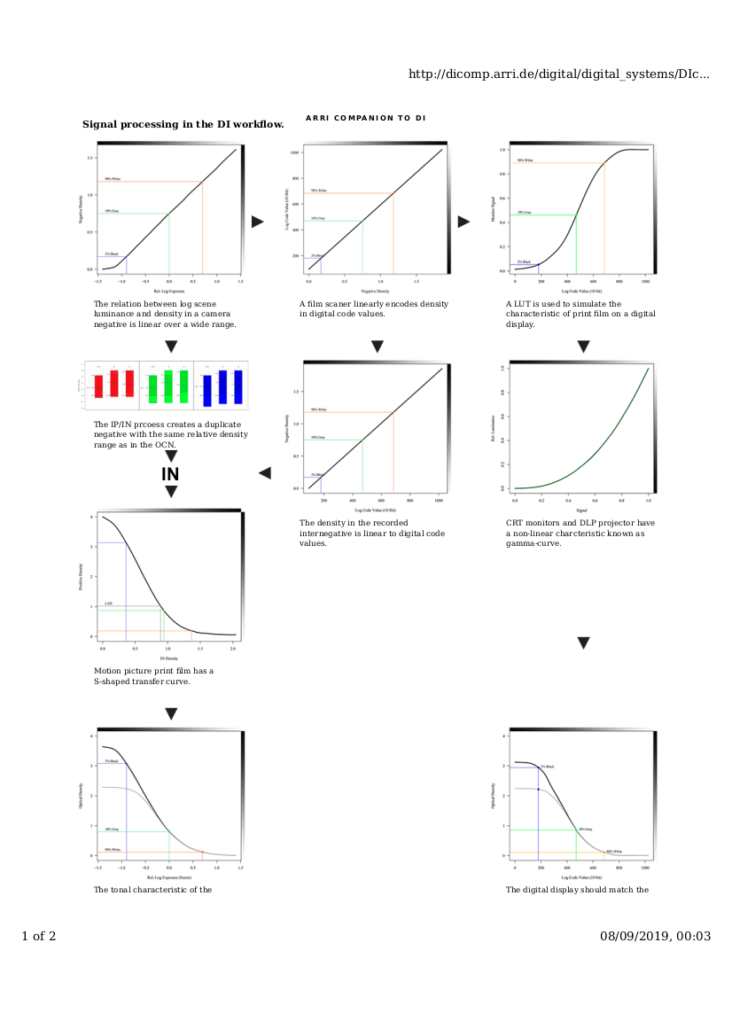

This technical document on the ARRI version of the Kodak Cineon system is well worth a read and should help your further your knowledge. Interesting in 2005 they profiled using 1728 patches in a simlar method as previously described i.e. 123 LUT but this is after all the other modelling.
http://dicomp.arri.de/digital/digital_systems/DIcompanion/index.html
and this diagram which describes one way of doing the signal processing:
I have not found anything from Noritsu or Fuji with any of this level of detail revealed. It is a pity that Kodak did not release more of there own stuff. I think the Pakon source code is lost for example, and PhotoCD is totally defunct... PhotoCD had something called film terms which is a proprietary way of storing LUTs which characterised all Kodak negative films of the day and many others as well... All of that is probably lost. I believe the aforementioned Giorianni invented PhotoCD.
