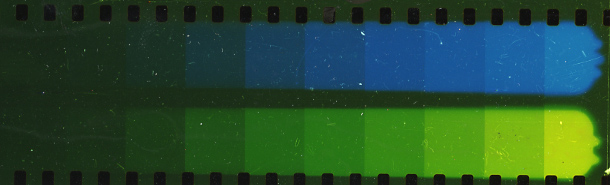

Ok, lets start. Using the film Red Dmin as zero, then the Green is about 0.8 and the Blue is about 1.2. Taking this to the paper, the Red speed is zero, the Green is +0.8 log E faster, and the Blue is +1.2 log E faster in this example. Add a 50R to this and the G is 1.3 faster and the B is 1.7 faster. Thus, when you print it with a tungsten bulb with a 50R, the image is "nominally" neutral and correctly balanced.
If you expose the film to R light and a step scale and to Neutral light and a step scale on 2 pieces of film, you get 2 different contrast values. This is due to the color correction of the mask and the DIR couplers among other things. The way to test the system is to make these on film and then print them onto paper and compare them to other coatings. Interestingly, if you expose to a macro step scale and a micro step scale, you also get 2 different contrasts and colors.

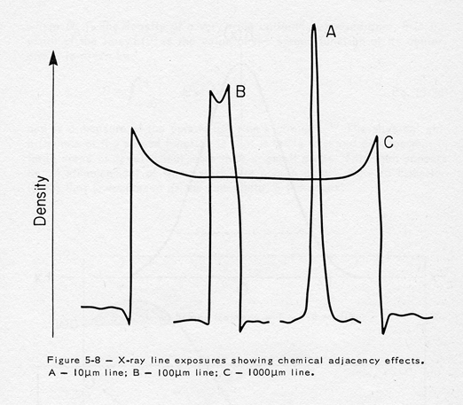

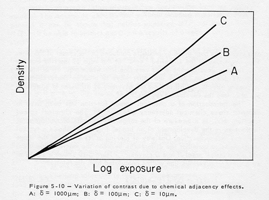

Two photos show examples of undercut exposures. There are actually about a dozen or more in a set. The next two illustrate the change in contrast between say a 4x5 image and a 35mm image of the same subject on the same film.
PE
