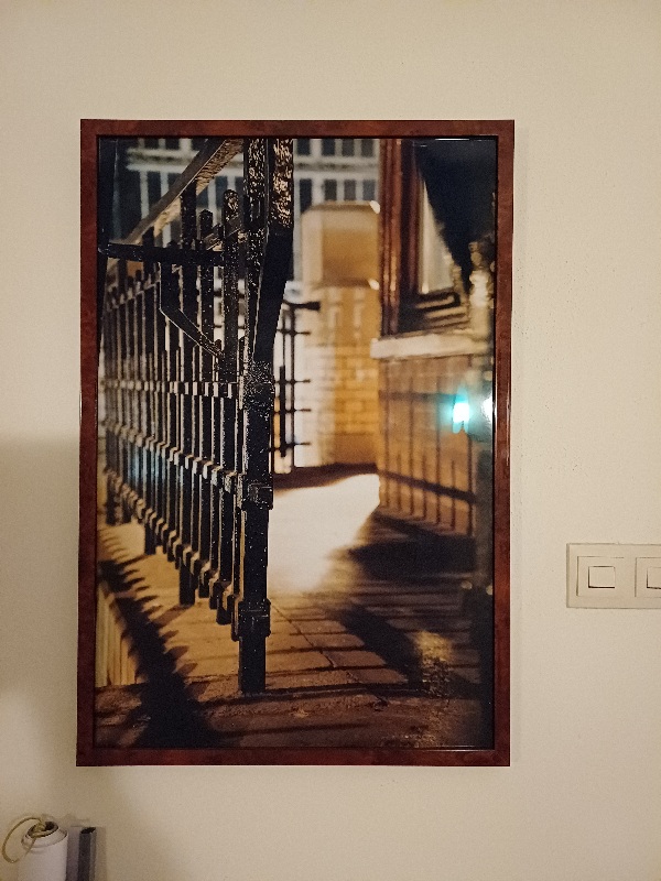

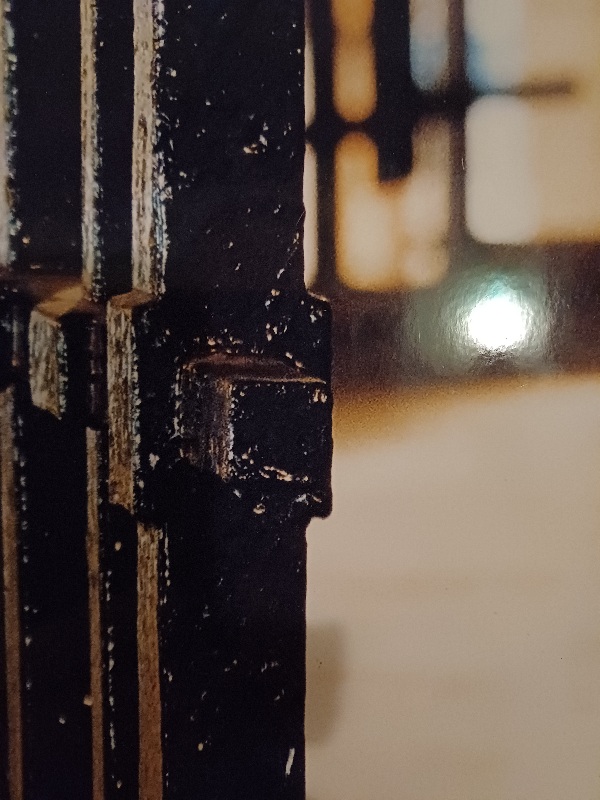

This image was shot on Kodak Gold 200 in 35mm format using a tripod, and I had it enlarged to 50x75 cm more than 20 years ago, and framed behind UV protecting museum glass.
As you can see from the second detail image, the grain is hardly noticable even at this size, still amazes me. Printed on analog photo paper.

That really doesn't tell much, Marco, except that Kodak Gold is relatively fine grained and that it was slightly out of focus when enlarged; otherwise the grain would be EASILY detectable, even if it had been printed from a medium format neg instead. Besides, grain and resolution are not the same thing. And being a soft contrast film, Gold has less noticeable edge effect, including grain-wise. But all that doesn't mean that evident grain is necessarily a bad thing. It all depends.
No, they are not "out of focus", the fence's ironwork is razer sharp where it should be. I think the lab technicians did a great job at these enlargements (I have a second complementary photo for this one). Both clearly show the film grain, or better said dye clouds, of the film, see the detail image. Its just so surprisingly fine, that even on close inspection, it is hardly noticable and certainly not disturbing for this type of high contrast subject of an architectural detail.
Well, yes, I can barely make out dye clouds on the closeup, although the web isn't an ideal mode for adjudicating such things. But Gold 200 isn't the very finest color neg film around, and anything enlarged that much from any kind of 35mm film is NOT sharp, and cannot be. Maybe if you back off far enough, and want to assess it in that manner.
I have a lot of experience enlarging what is their finest detail CN film, Ektar 100; and no matter how sharp you shoot it, the dye cloud structure starts becoming detectable before 10X. I've printed 35mm Gold 200 in the past, so know the comparison too. Gold does what it's engineered to do. And there's nothing wrong with shooting 35mm film. But if one realistically wants to retrieve more detail, it has to be there to begin with, and the only way to do that is to move up to bigger film.
