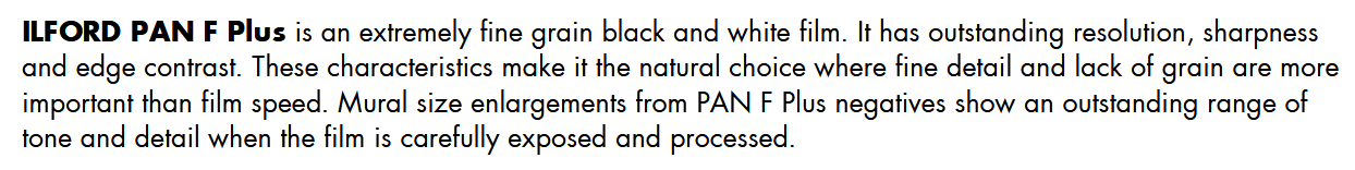

Ilford claims a 35mm PanF+ negative can be enlarged to mural size.
I suppose it depends on what Ilford consider to be mural size but I'd have thought at least 4ft x6ft. That's quite a claim for 35mm even for Pan F
Just out of interest where does it say this ?
Ilford says it in numerous places but is a bit vague about the format. Here they say,
And I recall somewhere or other taking that statement and turning it into a PanF 35mm negative can, with proper exposure and development, be enlarged to mural size. But I don't recall where I read that. It may have been a fantastical statement.
