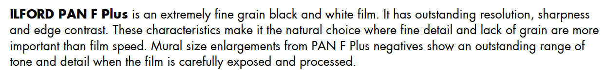

Ilford says it in numerous places but is a bit vague about the format. Here they say,
And I recall somewhere or other taking that statement and turning it into a PanF 35mm negative can, with proper exposure and development, be enlarged to mural size. But I don't recall where I read that. It may have been a fantastical statement.
Thanks for the reply
pentaxuser
35mm Pan F, "mural sized"? Read my lips : "Billboard", intended for viewing from a quarter mile away. Get real. You might squeeze a decent 16X20 inch print out of 6X7 cm Pan F, or with difficulty 645 format if you have a reading distance print in mind rather than a highway ad. Been there, done that, plenty of times, though I prefer still a little more usable real estate, namely 6x9 format, to get a reasonably crisp print worthy of serious attention rather than just a drive-by experience.

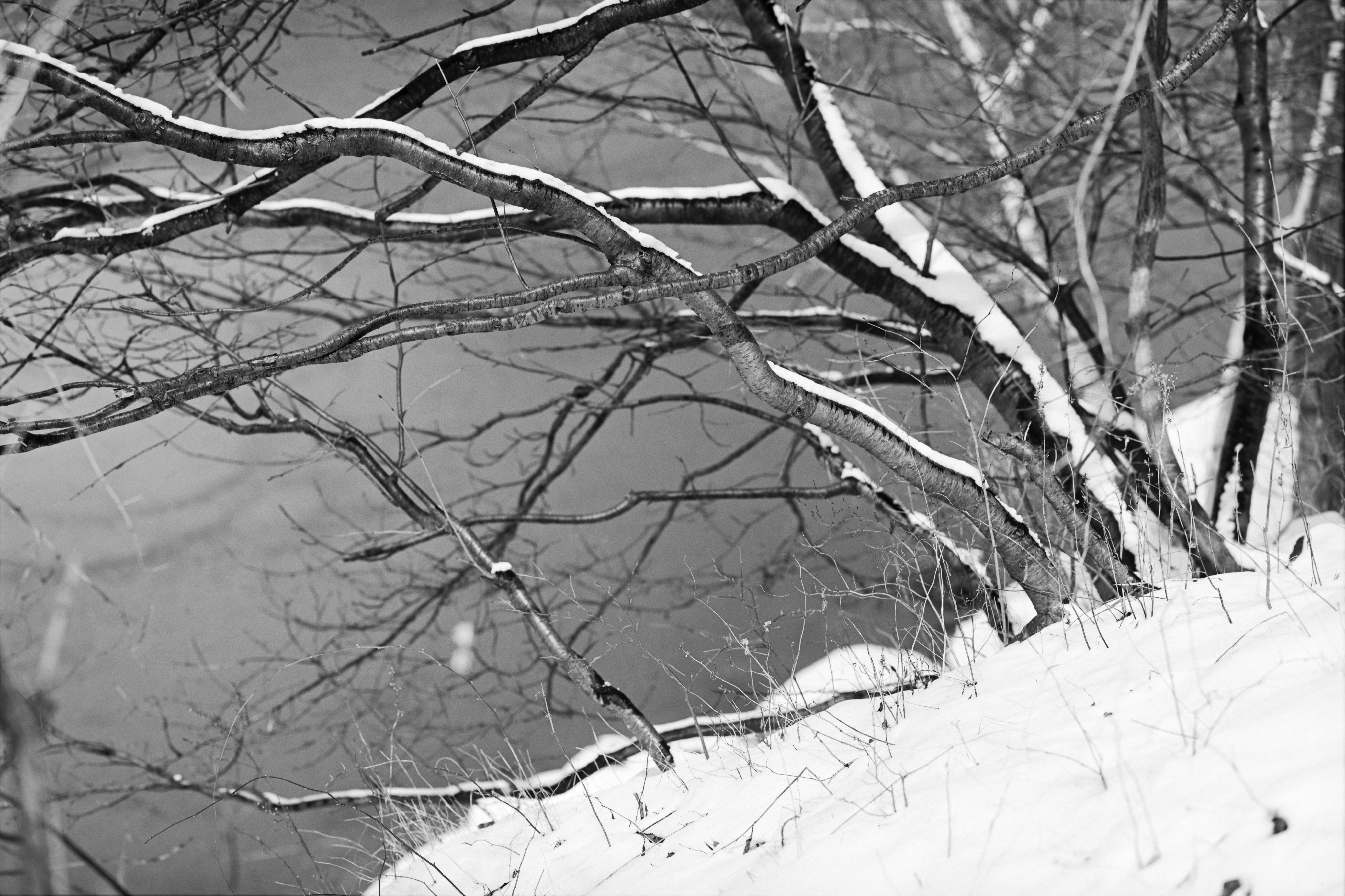

How large is this negative?
I'll be a bit technical here: I'll assume those were 30-sheet posters, viewed from street level at least 20 feet away. In the 90's, I was the art director for a couple of 30x40" posters that would be displayed where they could be seen at eye level and close distance. It was a studio shoot and I was shocked when the photographer told me he intended to use 35mm Kodachrome 64. I had expected at least medium format. But he was a well-know photographer and I respected his experience and opinion. The posters ended up winning awards.
I don't how many sheets were used, it was done a budget, the ad agency and printer were in San Francisco, the shoots were done in Sacramento, so the talent (DJS) did not need to travel. The agency sent an art director to supervise, my shots were done in a rental studio with a rented 4X5 with my set of lens for my Crown, the other guy shot his assignment with MF outdoors up by Lake Tahoe, that for the beer brewery.
@Pieter12 I meant the image that I posted.
