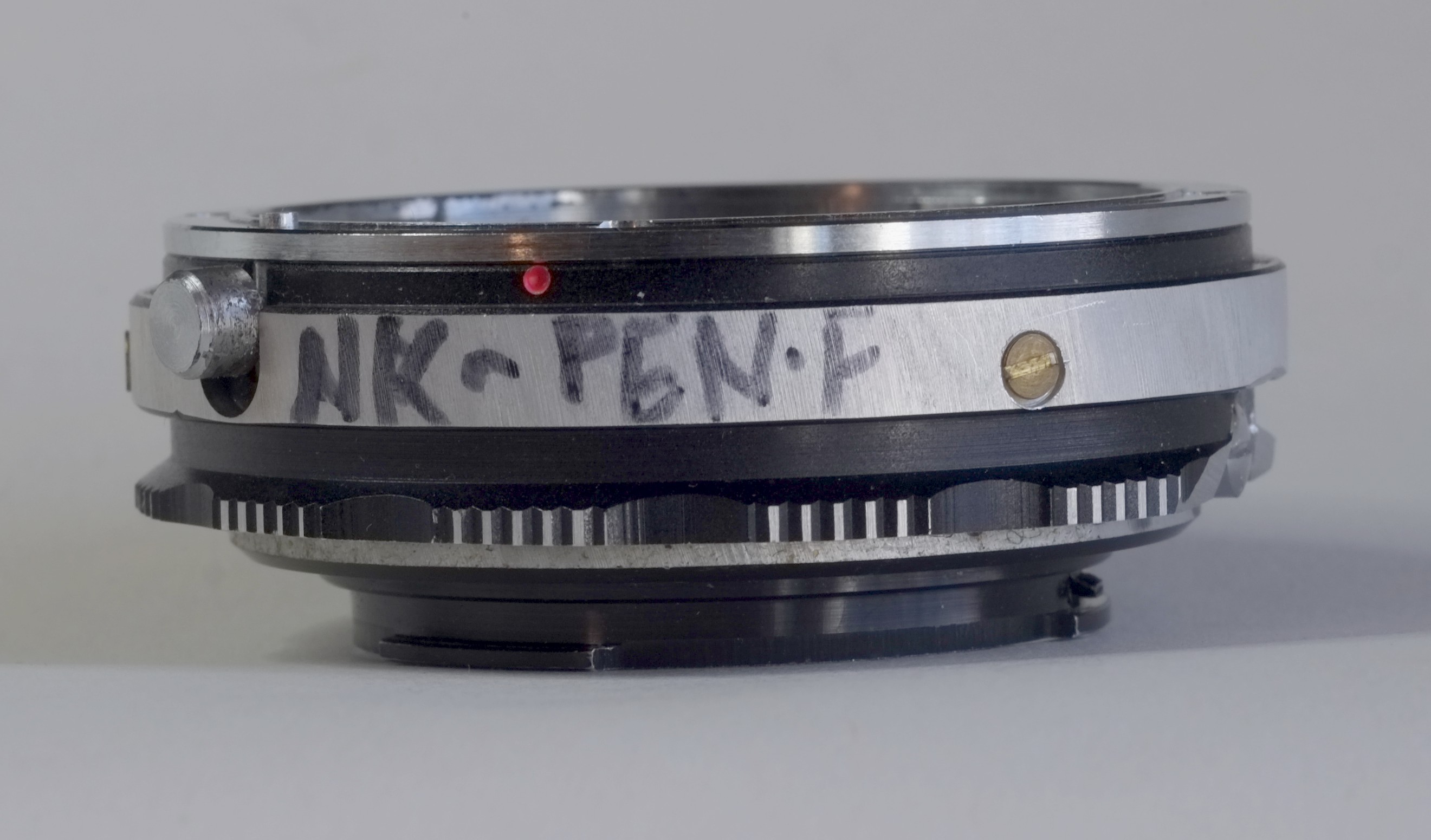

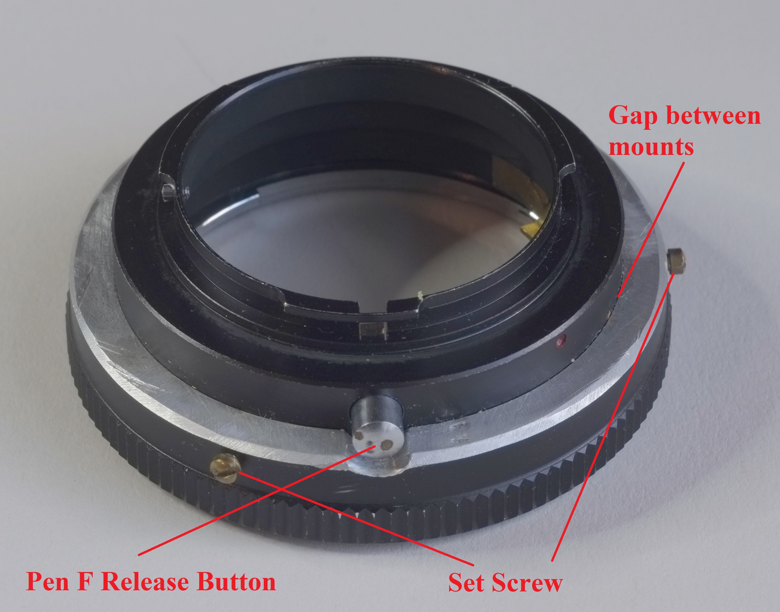

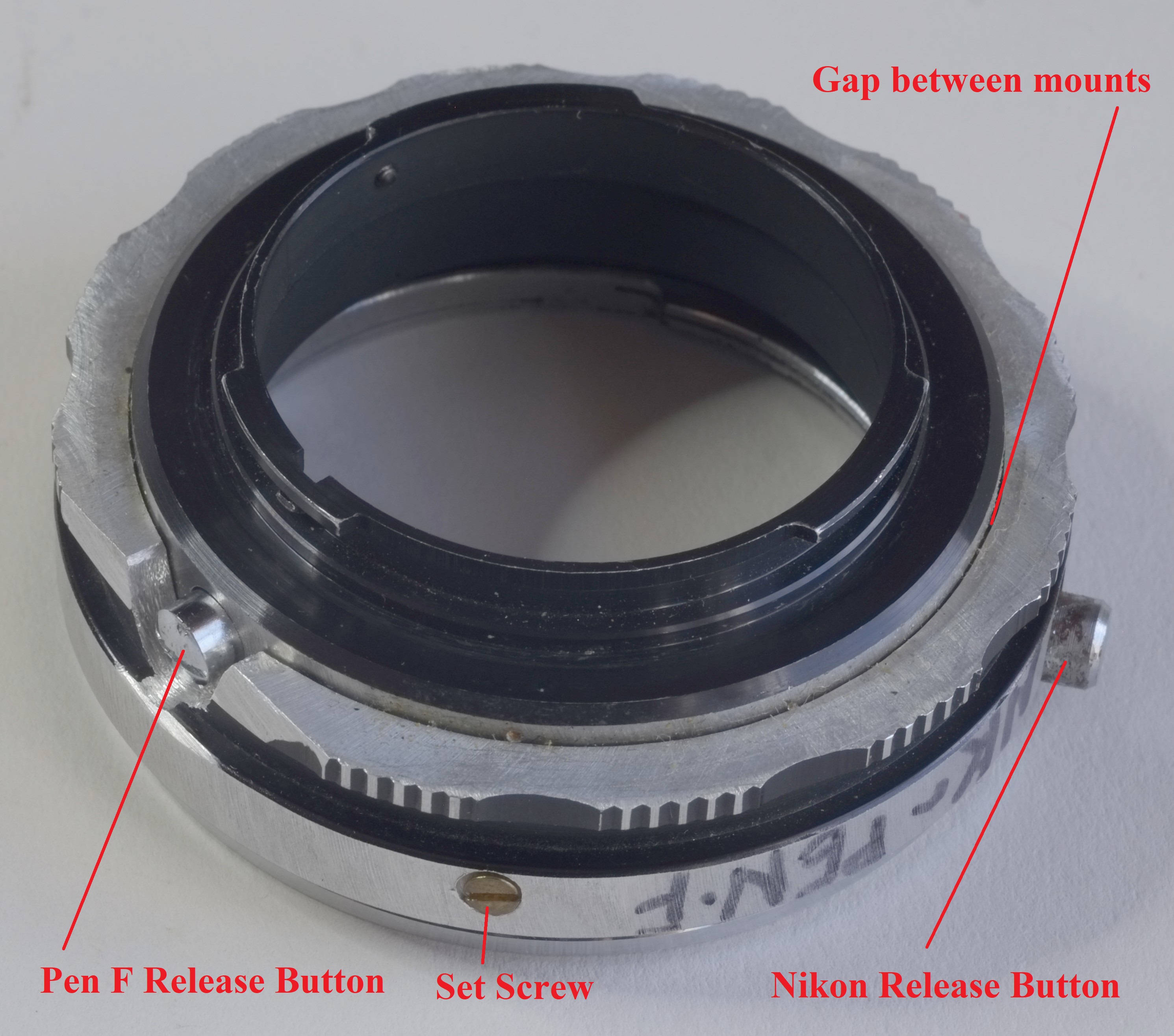

Here are pictures of my adapters:
OM-1 to Pen F:
The OM adapter needed a tab (sheet brass) to hold the diaphragm stopped down.
Nikon F to Pen F Adapter:
The explanation of the process at https://kyp.hauslendale.com/classics/penadapter.html is very good.
I do not have a machine shop or a milling machine (which would have been useful), only a drill press, belt sander and Dremel grinder, along with an old micrometer of my father's. I also have small jeweler's files and 1-72 and 0-80 drills and taps from my model railroad scratch-building days. I would say that I am mechanically apt, but I do not think the job was that difficult.
As explained in the kyp.hausendale site, you probably will need to either reduce the outer diameter of the Pen F tube or enlarge the inner diameter of the lens adapter tube. I drilled and tapped three holes in the lens adapter at 120 degrees apart for 1-72 set screws. After sliding the Pen tube into the lens tube, I loosely tightened the set screws and measured the flange-to-flange distance (e.g., 17.55mm for Nikon F lenses), adjusting it as needed before tightening the set screws.

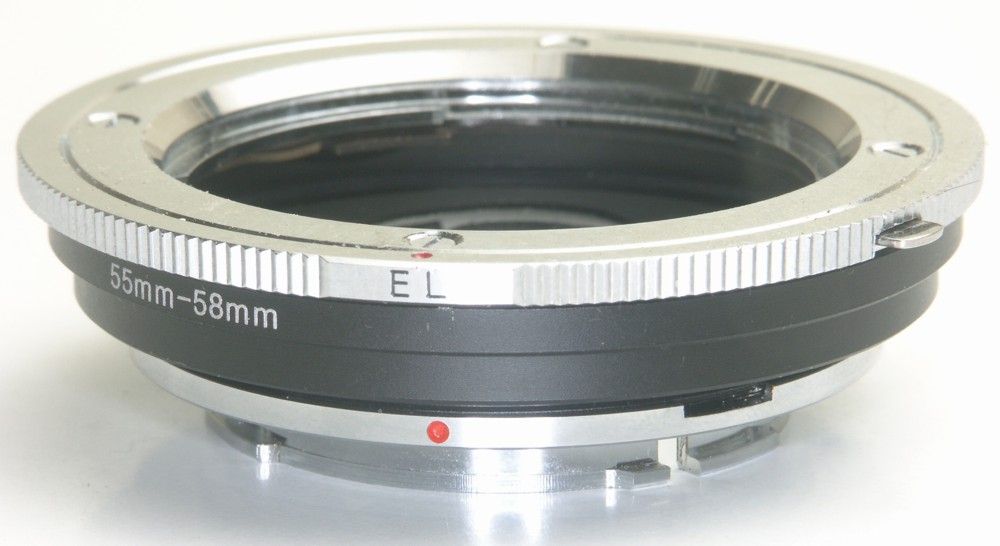

Here's my solution, and it might be helpful to others looking for an inexpensive, DIY Pen F adapter.
The "trick" that makes it easier is by using two (or more) step up rings. The step-up rings can be used because the Pen F lens mount is going to be smaller than any lens mount that you want to add to it.
I'm dealing with Minolta lenses, but the approach will be the same with other lenses -- although the distances and diameters will vary for Nikon, Canon, Pentax, etc.
I started out by getting a Pen F lens mount and a Minolta camera mount. There are lots of options here, and many have been mentioned above, such as old or broken extension tubes, lens adapters, lenses or cameras.
The Minolta camera mount that I chose is from the Minolta Extension Tube II set. You can get these for under $10, and they don't have to be in mint condition. The mount from this set is the thinnest mount that I could find that retains the lens release button. It's only TWO millimeters thick!!!
The same is true for the Olympus lens mount -- it can be in pretty bad shape -- and it might not need the lens release button. The one I found lacks the lens release button but fits perfectly -- without any fear of slipping off.
The front of the Olympus lens mount that I have is a perfect match for the rear of a 49mm step-up ring, and the rear of the Minolta camera mount that I have is a perfect match for the front of a 58mm step-up ring,
So all I did was combine a 49-55mm step up ring and a 55-58mm step-up ring in between the Olympus lens mount and the Minolta camera mount. A 49-52mm step up ring and a 52-58mm step-up ring would have worked just as well -- as would a 49-52mm step up ring and a 52-55mm step-up ring and a 55-58mm step-up ring, if more space is needed.
It's critical to get the distance right, of course.
The genuine Olympus Minolta to Pen F adapter that I have is 14.5mm thick -- so that was my goal. The Olympus lens mount and the Minolta camera mount that I found have a 3.5mm total width, so I need step-up rings that add 11mm total distance in between.
Step-up rings vary slightly in thickness, but one advantage of using TWO (or more, if needed) step-up rings is that they can be adjusted slightly to produce the correct amount of depth. A little epoxy will cement the depth, once it is established.
I was able to find two step-up rings that created the correct depth that I needed using a caliper. I then attached a 200mm lens (equivalent to a 300mm in half-frame) -- focused at infinity, to verify that the depth was correct for infinity focusing.
The last step before epoxying it all together was to make sure the Minolta lens index mark was on the top of the adapter (when attached to the Pen F camera).
The only thing I'll add is that you should check the adapter for light leaks. A little bit of black silicone sealant should do the trick. I had to plug three screw-holes in the Pen F lens mount -- but since they were inside the camera that was really not necessary.
The total cost will vary depending on what you already have. Mine cost me about $20 -- about 1/10th of the real McCoy.

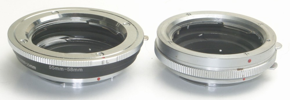

Here is a comparison of the Olympus-made Minolta adapter (right) and my DIY model (left). The front of the DIY model is wider, but that's of no consequence.

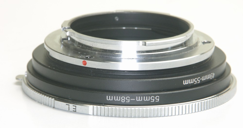

The DIY consists of four parts: Olympus lens mount, TWO step-up rings, Minolta camera mount: This shows how thin the Minolta camera mount is -- and the all-important lens release button.
This is the other side. The two step-up rings are not glued together. The other parts fit together fine -- with the help of a little epoxy.
There appears to be a "fly in the ointment". I only tested my DIY adapter with Minolta MC lenses. A problem arises when using MD lenses.
The MD tab sticks out about 2mm more than the MC tab on the lens. And as mentioned in my previous post, my DIY adapter is slightly wider than the original Olympus-to-Minolta adapter.
While this is not a problem on the original Olympus-to-Minolta adapter, on my DIY adapter, the MD tab presses against the Minolta camera mount, and the f-stop ring cannot be adjusted.
This problem might not afflict all MD lenses, but it's something to watch out for. It's only a 0.X mm difference -- so the MD lenses will fit on the adapter fine, but the f-stop ring might not turn.
Many MD lenses might work correctly, but some -- like the one I tested -- might get stuck.
Solutions?
#1 -- use a Minolta camera mount that is slimmer (smaller diameter) -- if you can find one -- to avoid the problem. Minolta exactly addressed this problem when they came out with their MD AUTO Extension tube set -- replacing the MC AUTO Extension Tube set.
#2 file down the MD tab on your MD lenses by 0.5mm. Maybe you are like me and don't have any cameras that actually use the MD tab -- (XD-series, X-700) -- problem solved.

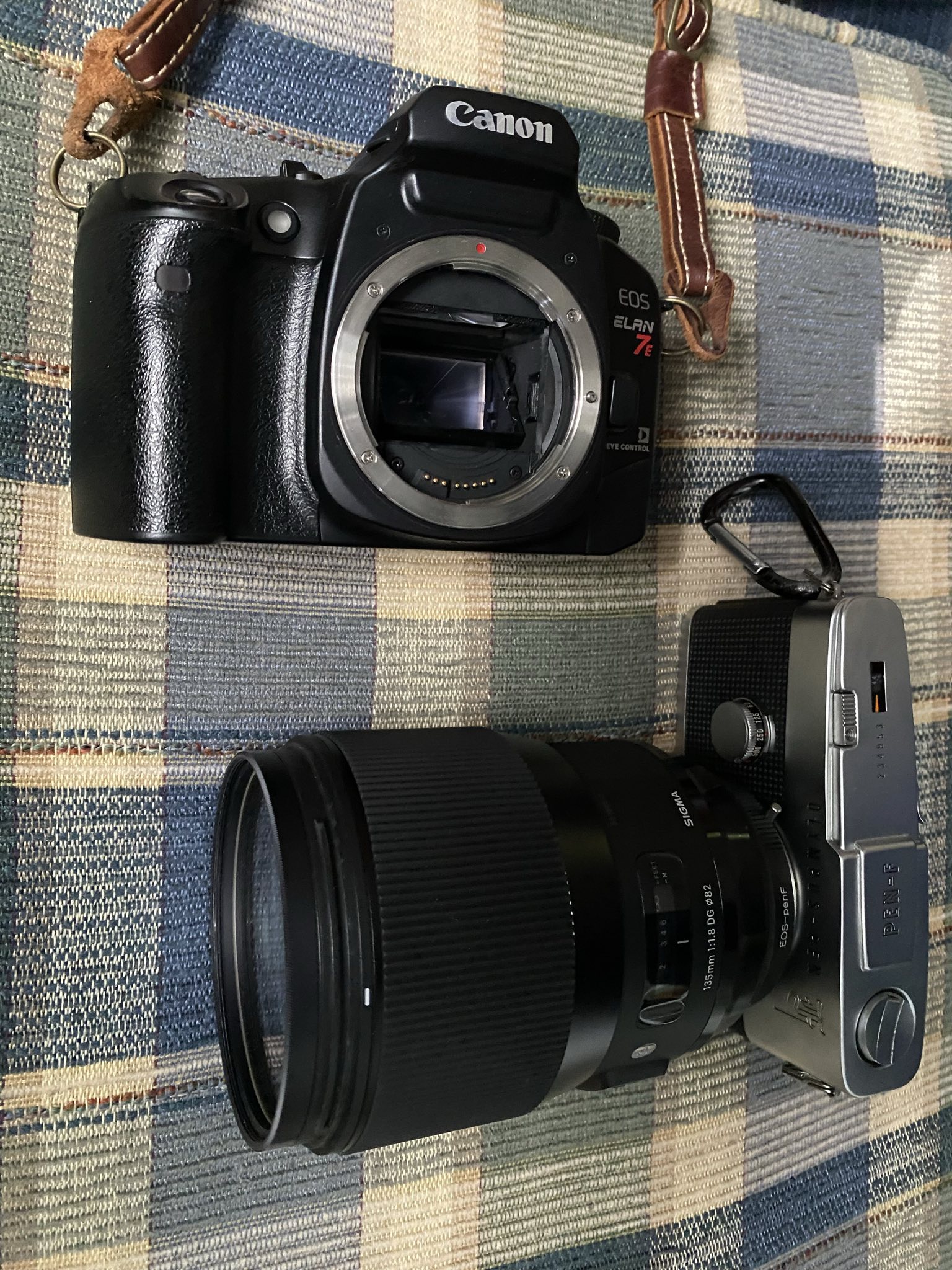

Not a homemade adapter, but I confirmed that a Sigma 135mm f/1.8 DG HSM ART lens can be adapted to a Pen via the EOS-Pen F adapter. Focusing works. You have to preset the aperture by stopping it down on your EOS camera while you dismount the lens from it, so you're stuck with the same aperture after you mount it on the Pen, unless you carry an EOS body around with you.
This lens should be able to out-resolve almost any film so it's great for the small format. It's equivalent to just about 200mm when mounted to the Pen. You do end up holding the lens rather than the camera in use!
What would be really cool is if there was a way to supply an electric connection to the EOS lenses that would enable image stabilization. I don't think it would be very complicated to engineer - on a half-press, a signal gets sent to the lens to engage IS, when the half-press is disengaged, IS is off. It would need a button on the adapter along with a battery.
