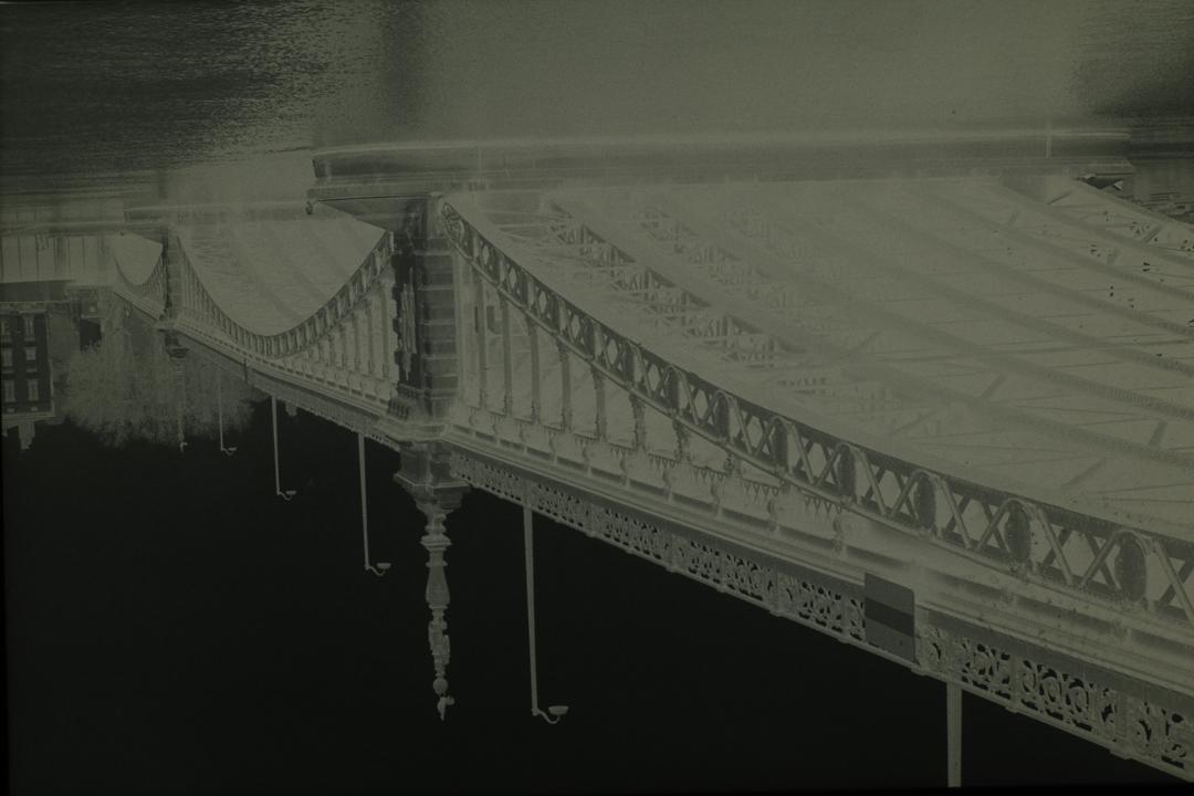

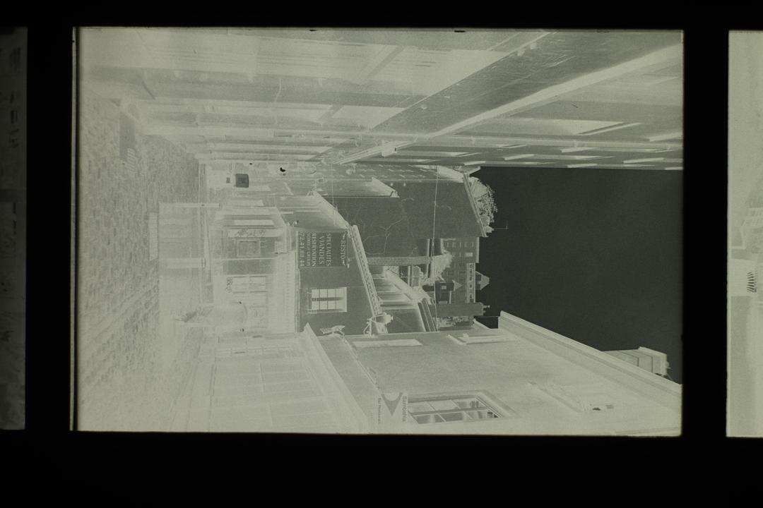

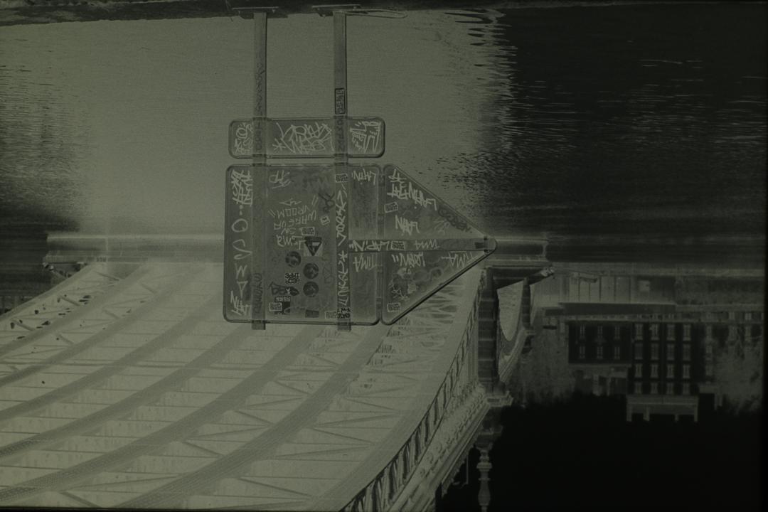

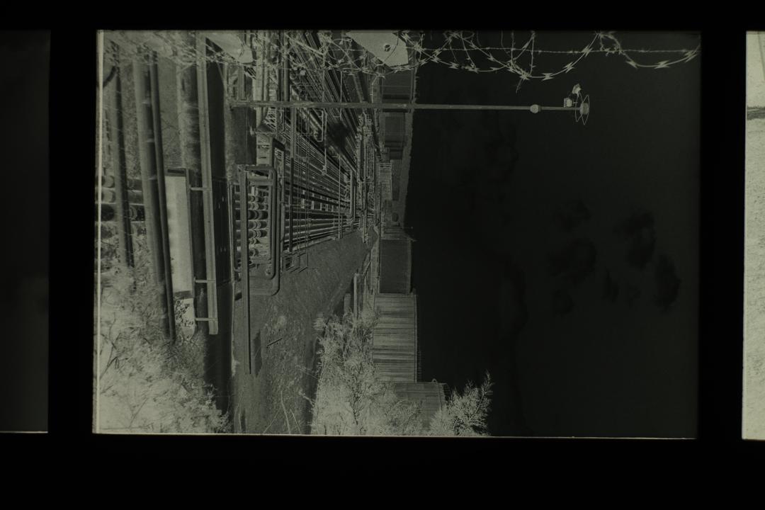

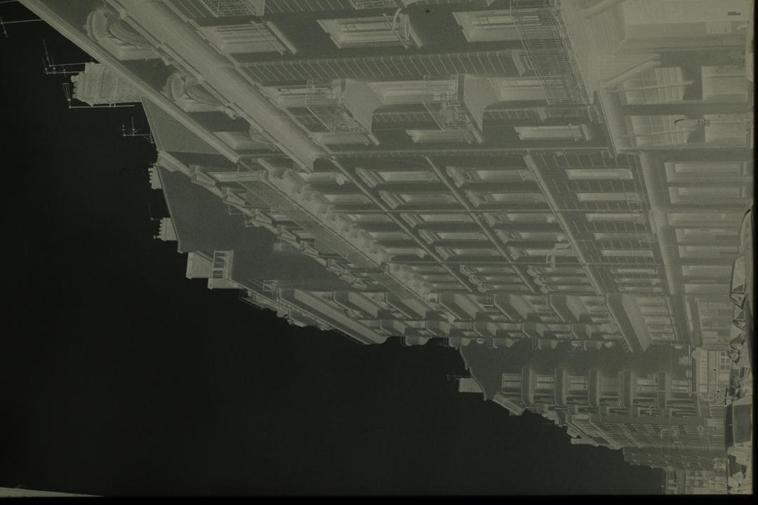

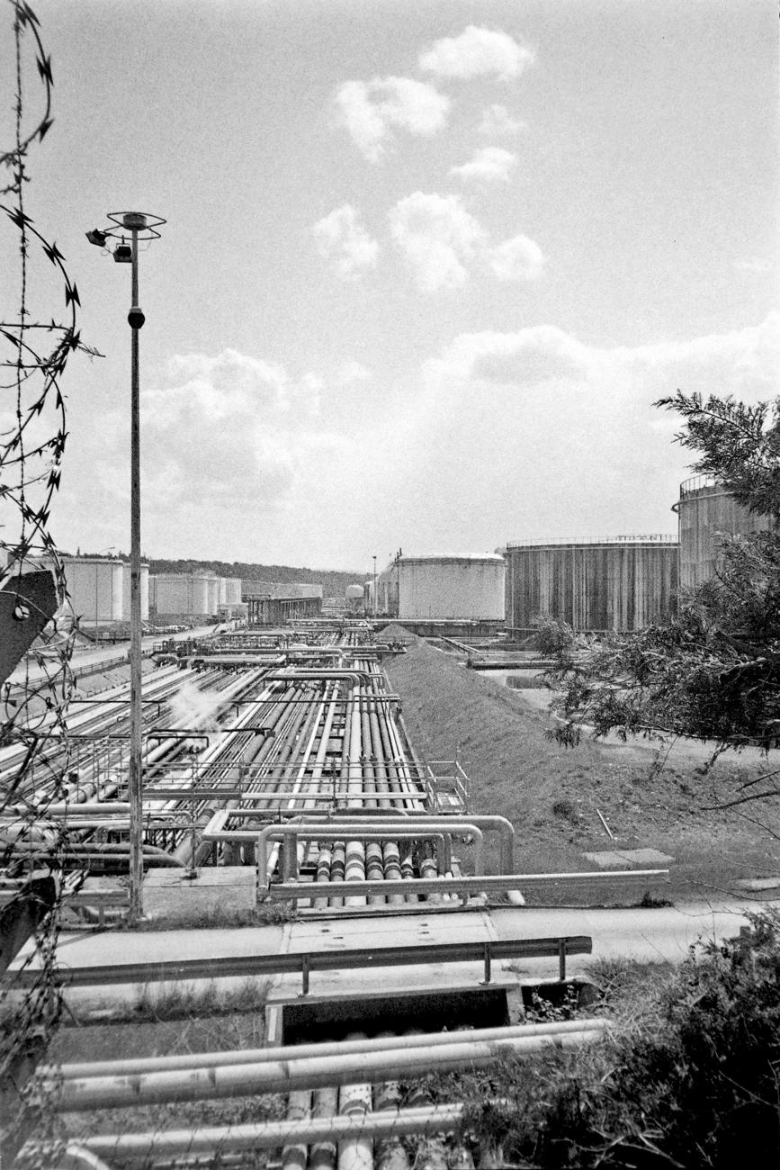

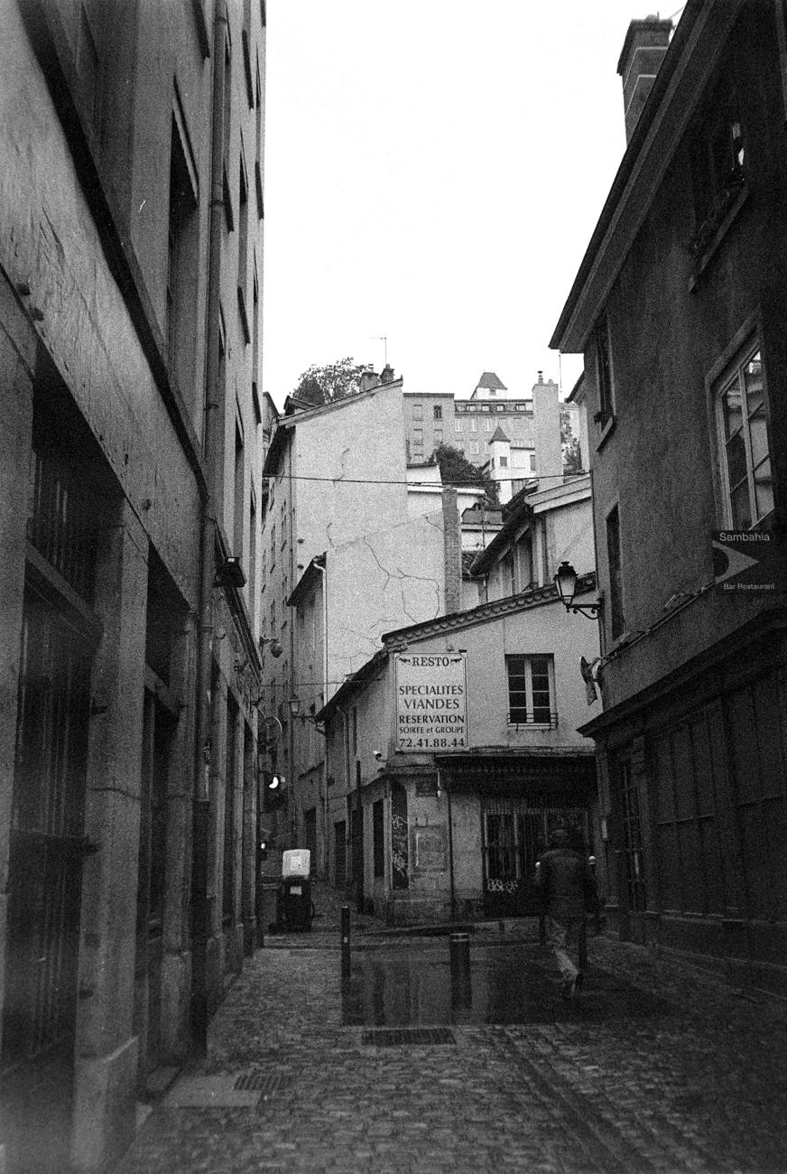

I mentioned earlier how I developed the end of a Fomapan 400 in Caffenol CH (15min), but with 3g dried thyme instead of coffee (500ml : 27g sodium carbonate, 8g ascorbic acid, 5g iodized salt, 3g of dried thyme in infusion). I couldn't post pictures then, but here they are.
The "scan" was done with a mirroless camera, an extension tube on a M42 Helios 44-2 58mm lense, a plastic negative holder and a phone as the light source.
IG_IMG_6650.JPG IG_IMG_6651.JPG IG_IMG_6655.JPG IG_IMG_6650.JPG IG_IMG_6651.JPG IG_IMG_6655.JPG

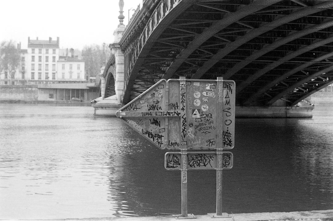

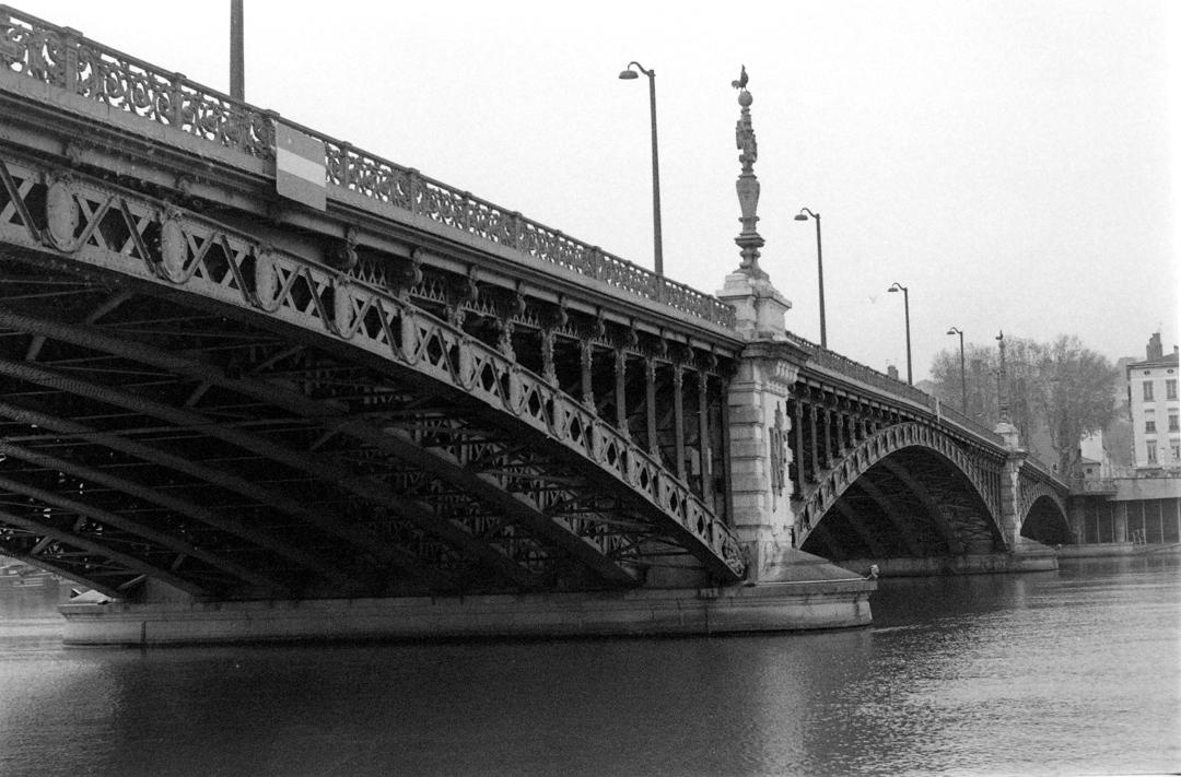

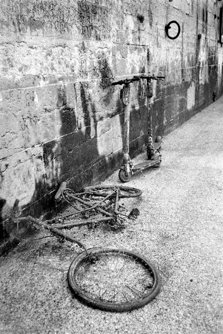

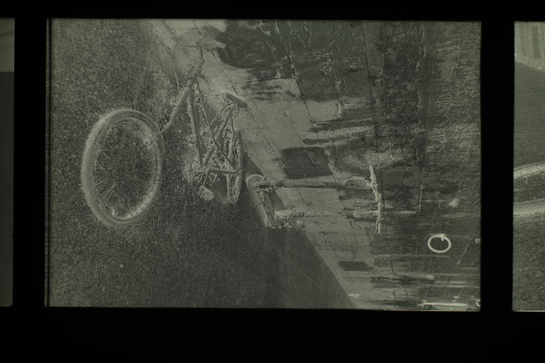

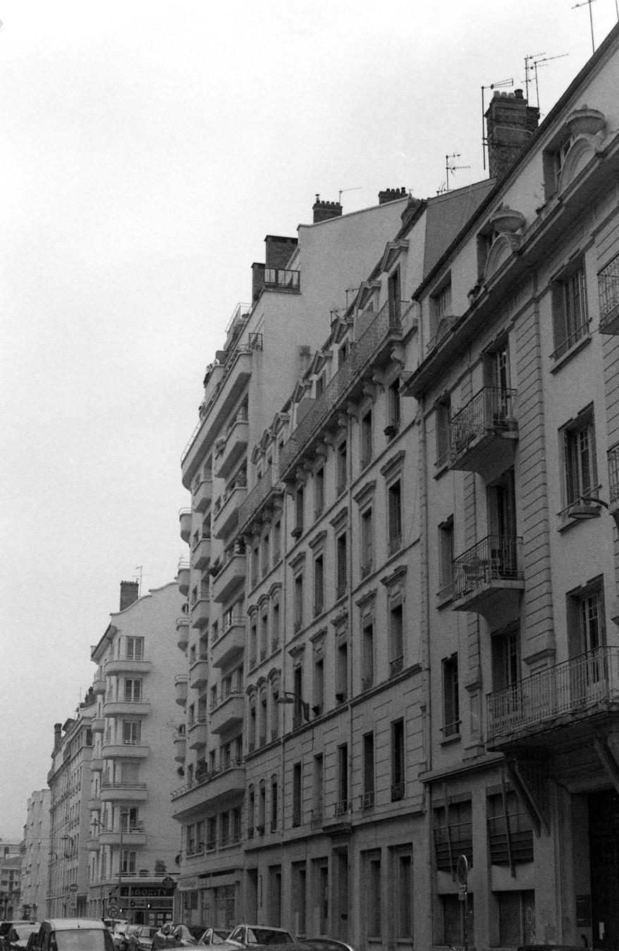

For comparison, here is Fomapan 400 in regular caffenol CH. The same vitamin C, washing soda and salt were used, as well as the same scanning rig, but not the same camera (a very cheap point & shoot with plastic lens, while the pictures above were taken with a SLR and a decent 50mm lens). Of course this is in no way a proper "scientific" comparison, as it never was the intention here (there's 7 months between them).
IG_IMG_3455.JPG IG_IMG_3455_neg.JPG IG_IMG_3469.JPG IG_IMG_3469_neg.JPG IG_IMG_3482.JPG IG_IMG_3482_neg.JPG

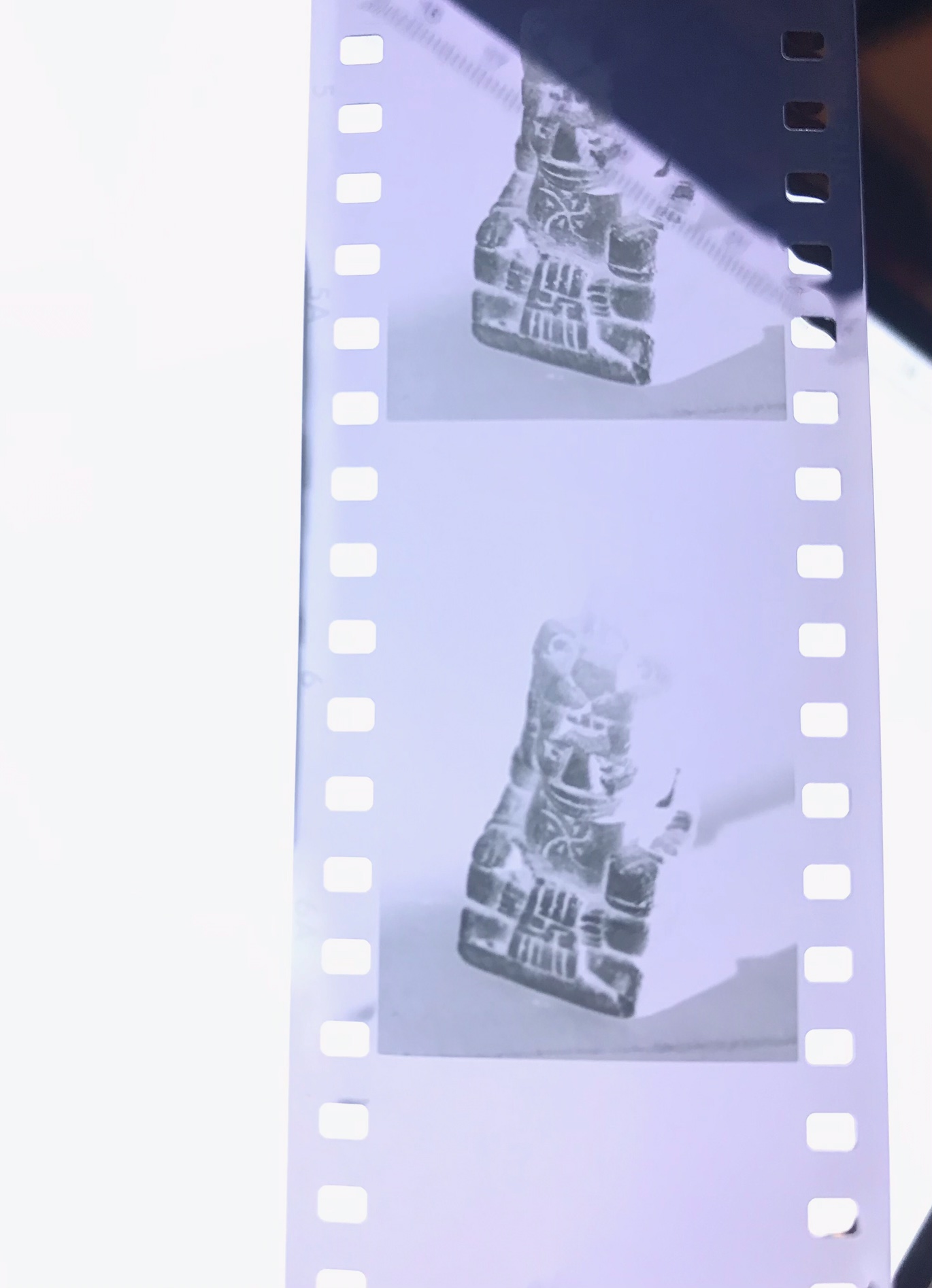

So I just mixed up exactly the above without the thyme. However, I don't have any Fomapan and had to use HP5+.
The negatives are thin. Not impossibly thin but still thinner than I'd want to use. This was a picture of a little statue in full sunlight.
The negatives would not have been so thin if the salt had been omitted. Also, they likely would have had more density if the amount of sodium carbonate had been increased. Perhaps a thyme infusion is alkaline (I have no idea).
