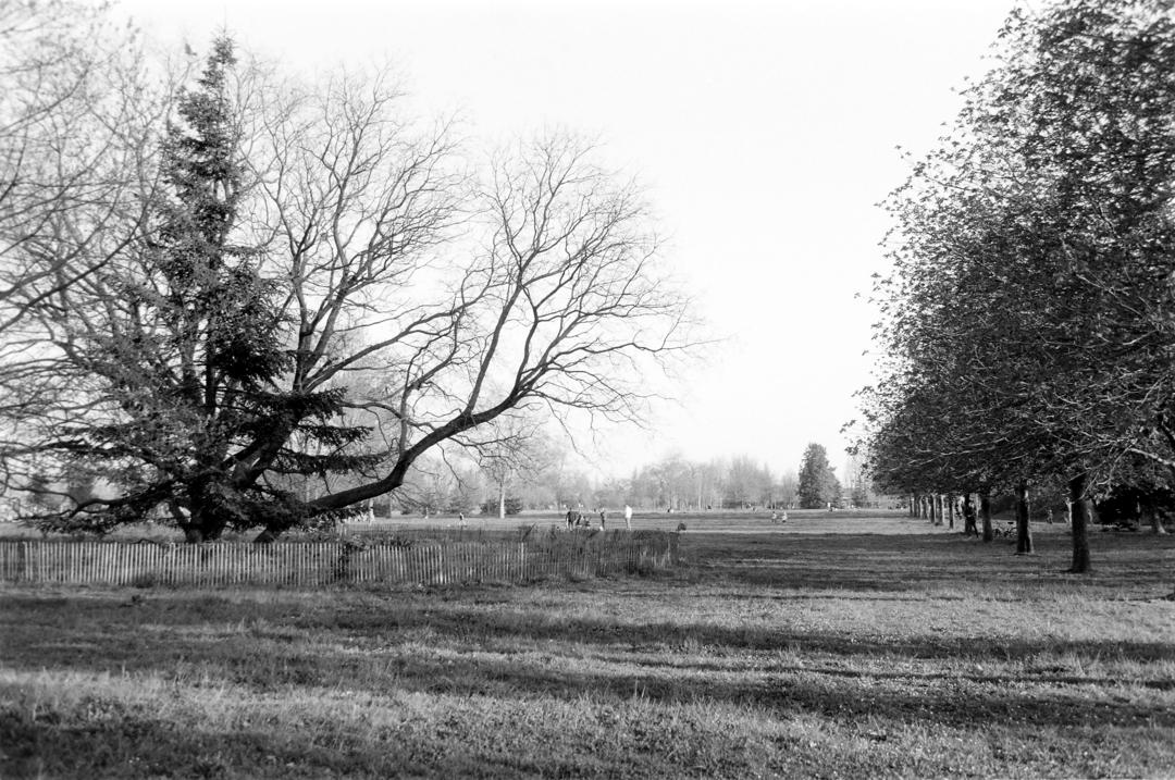

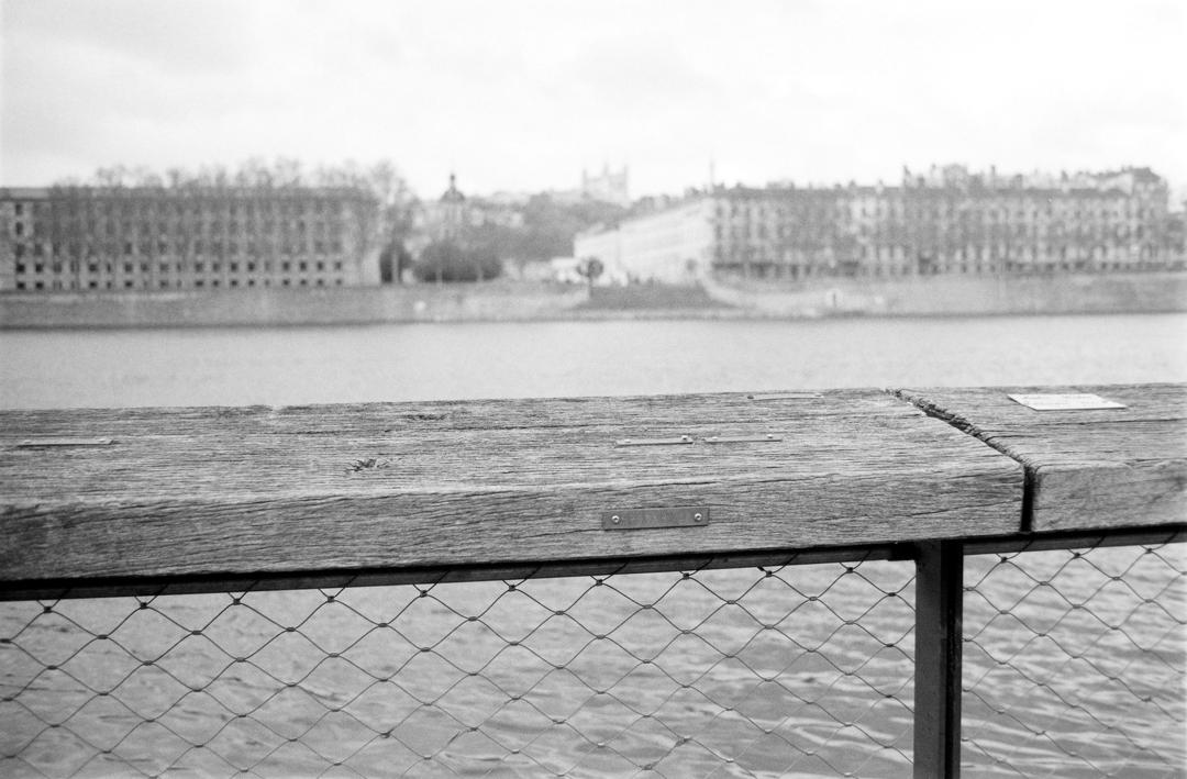

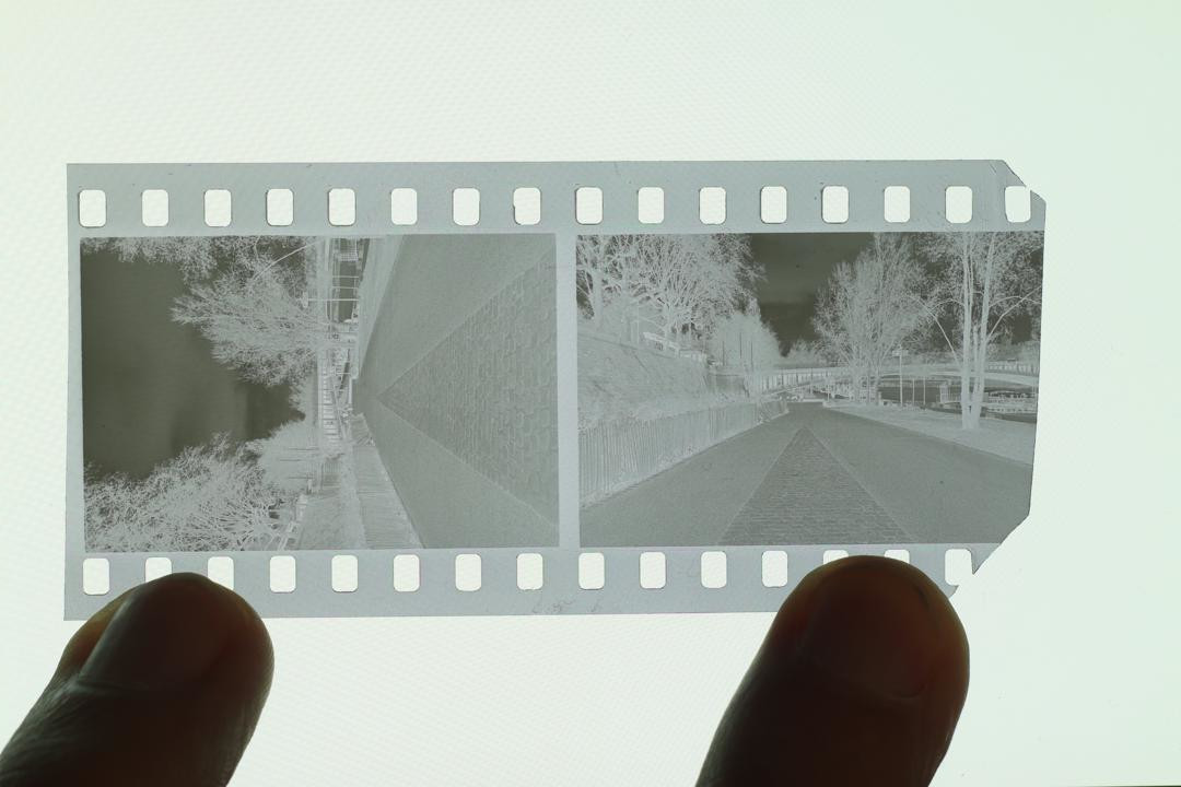

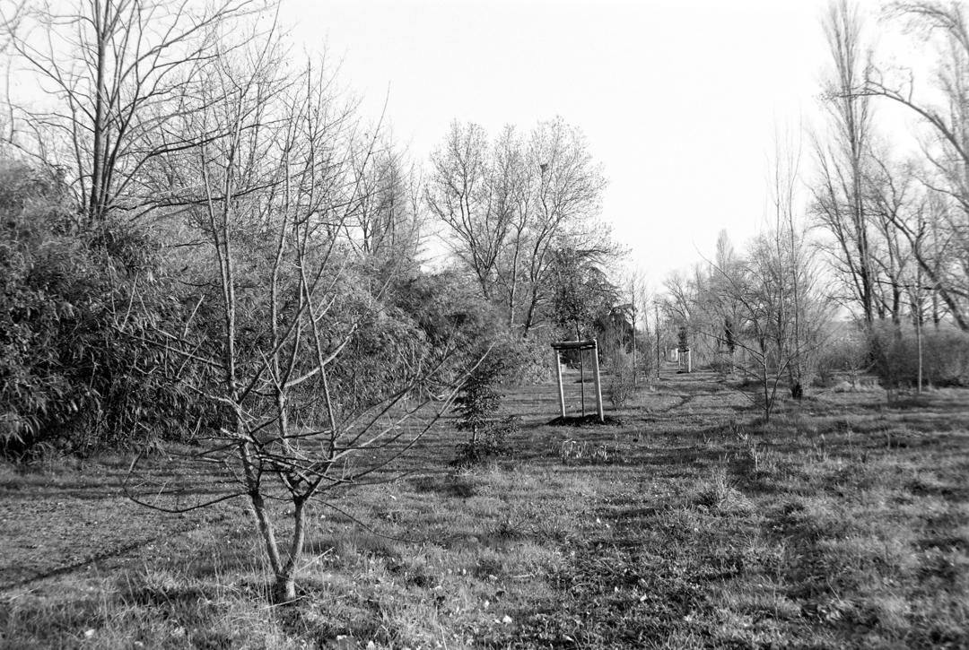

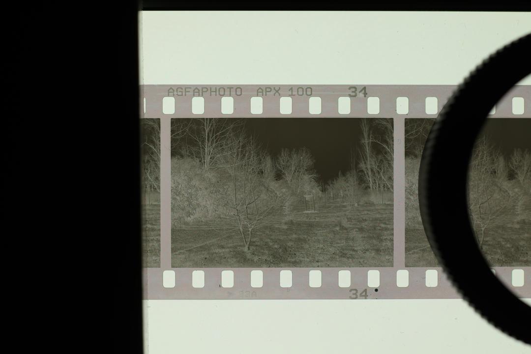

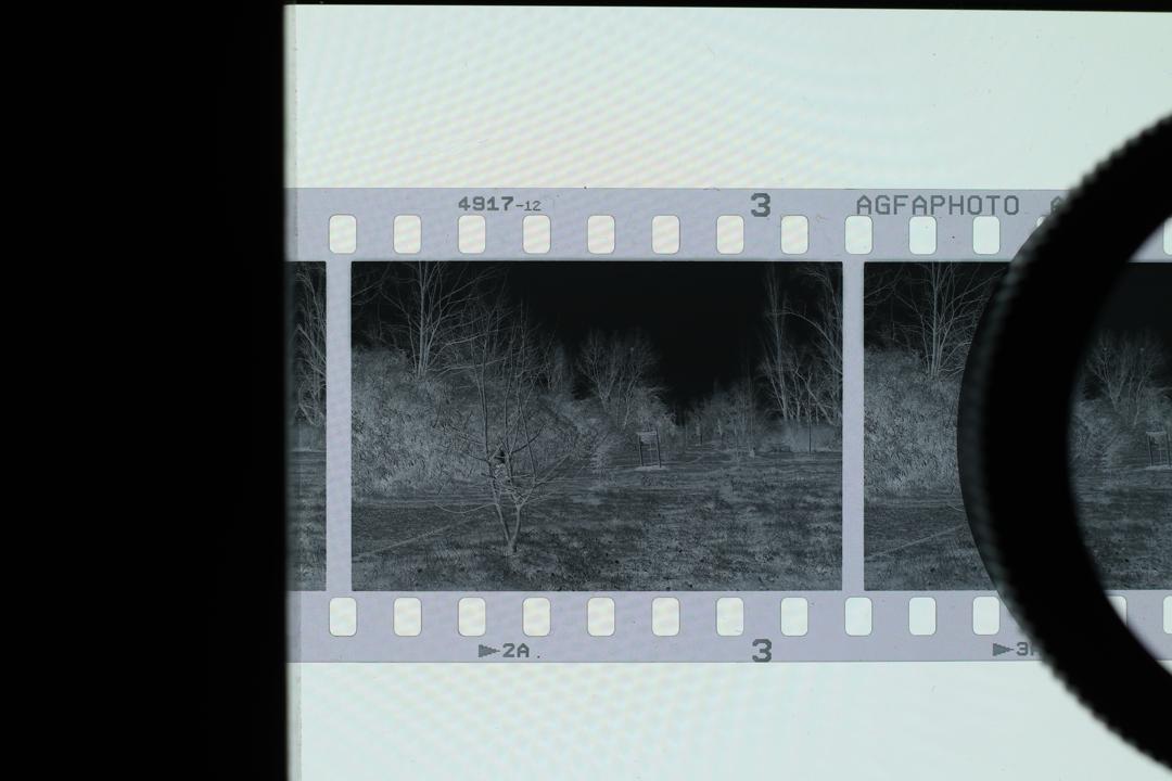

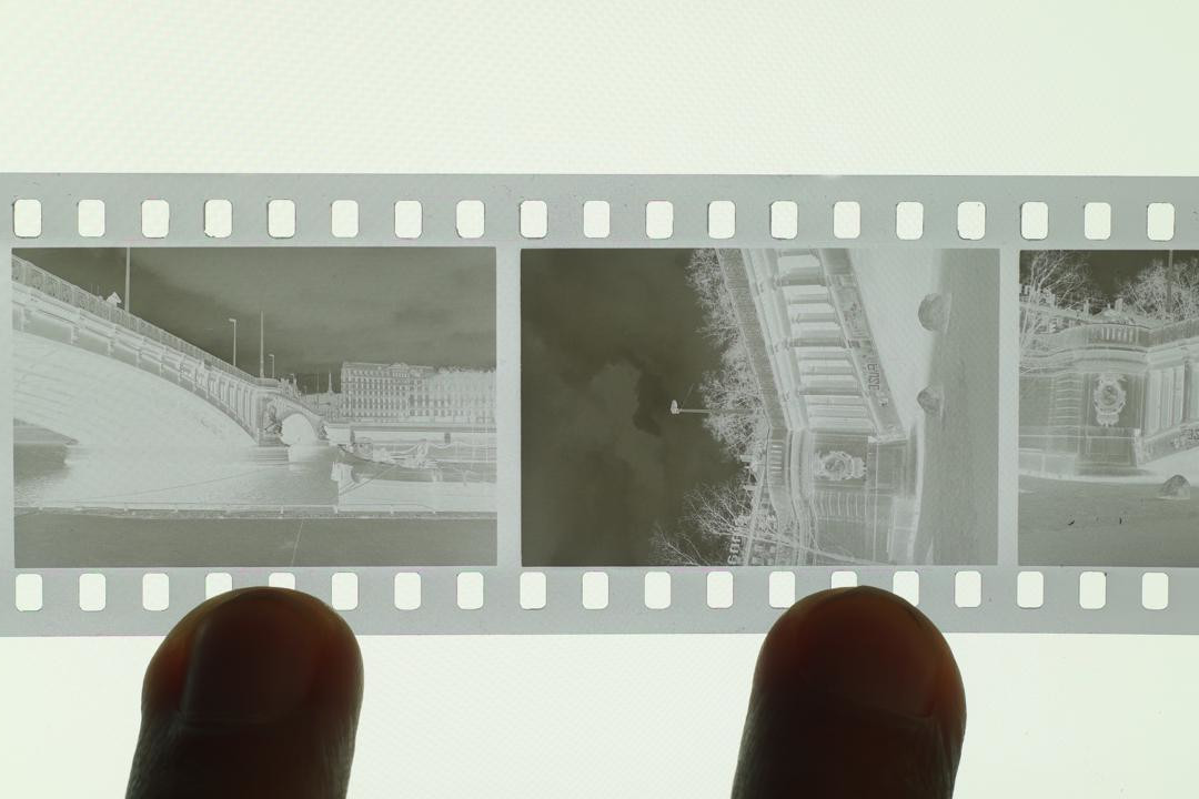

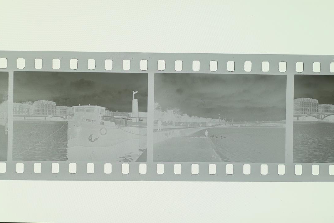

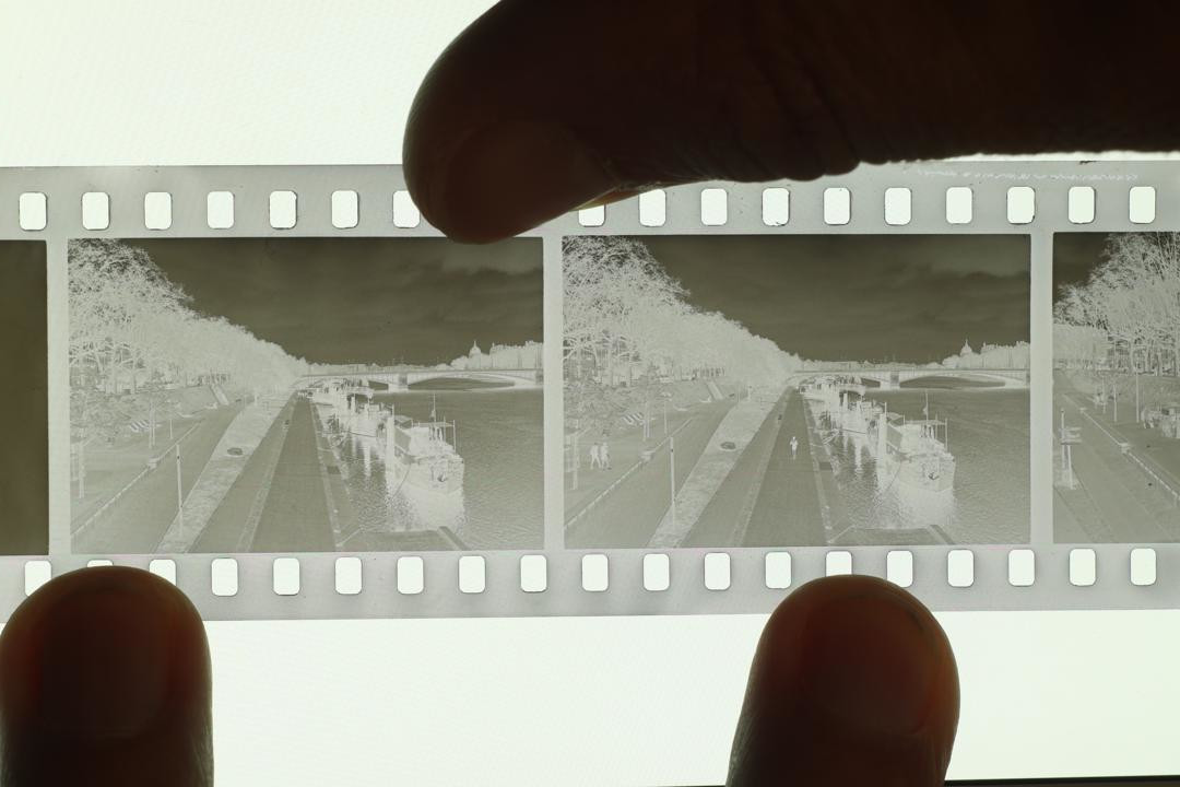

So, I shot several exposures of the same scene, with the same light, at the same time, and did some development tests.

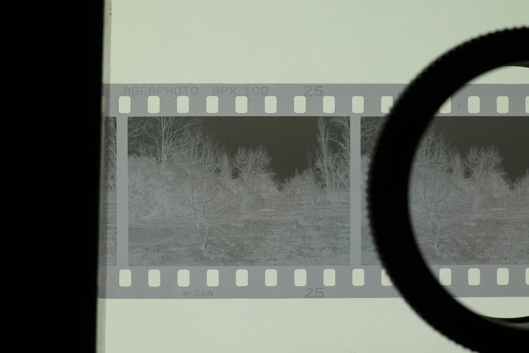

The film was 35mm AgfaPhoto "new emulsion" APX 100, fresh. My camera (Mamiya NC 1000s) was set at ISO 80. It has a shutter speed priority mode, so I moved the speed until the TTL reflective metering chose an aperture of f/16. Lens : mamiya-sekor f1.7 50mm, no filter.
The following was kept constant :
  • No prewash
  • Temperature : 20°c
  • Agitation method : continuous for the first 30s, then 10s at the start of every minutes
  • Water stop bath
  • PH measurement : paper test strips, 0.5 precision according to the box. It's not ideal, but I didn't want to invest in a PH meter. The biggest issue was reading the result with the caffenol solutions, because of the brown stain.
  • Pictures of the negative : APS-C Canon EOS M100 mirroless camera, 50mm M42 fujinon f/1.8, no filter. Without and with extension tube for the close up shot. ISO 100, f/11, aperture priority mode. Light source was a phone. No edit on the first picture except rotation. The positive was done with the following method : 1) jpeg opened in GIMP 2) rotation/crop 3) colors->invert 4) colors->levels->auto 5) mode->grayscale 6) export.
Note : I couldn't upload the full resolution images, theses are resized to 1080 px. if anyone's interested, I can see how to share them in full size.

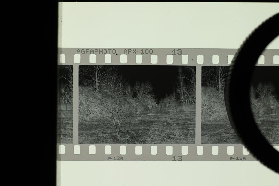

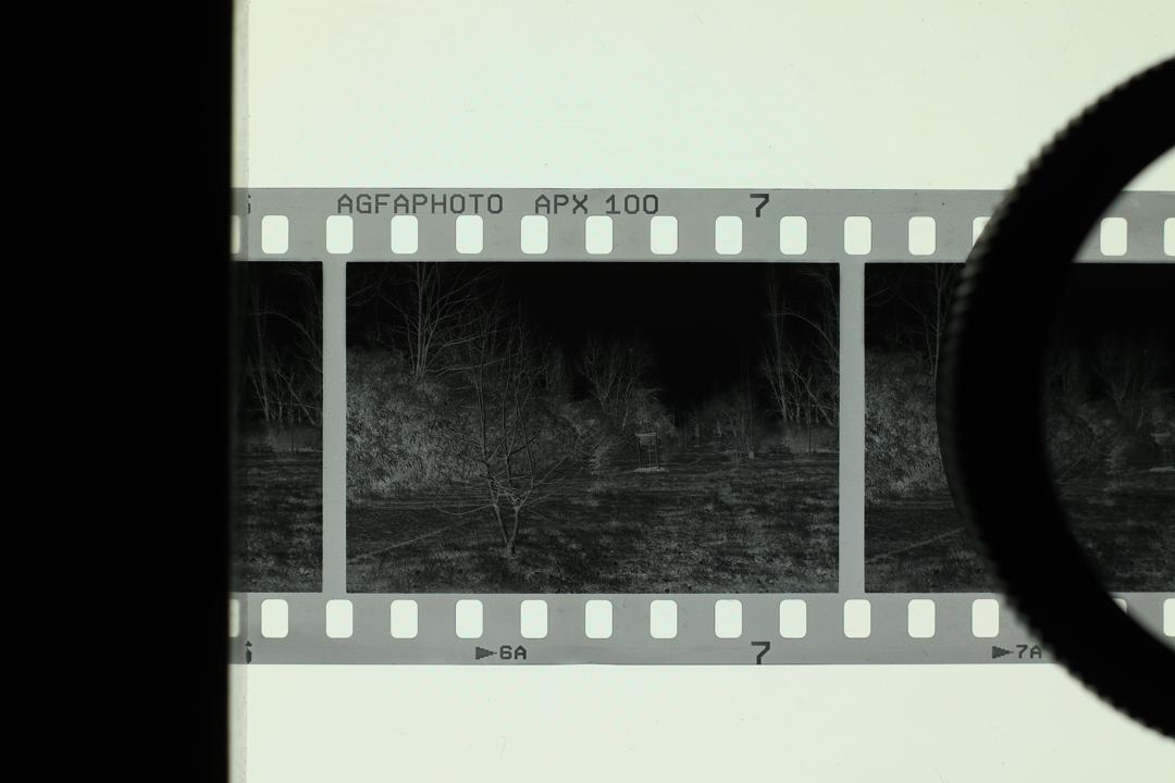

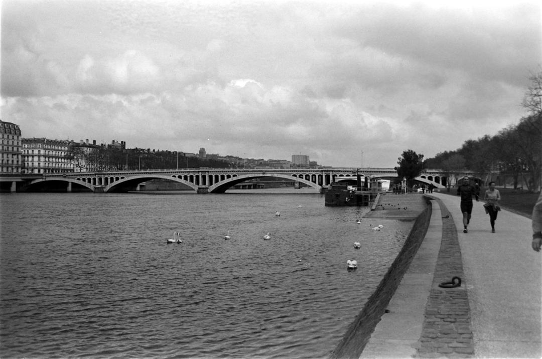

1. "Rodinal 1:50 control strip" : 500ml, 10ml rodinal (Adox Adonal). PH : n/a. Dev time: 10min
Just a control strip with a regular commercial developer, following the manufacturer times, to compare to the others.

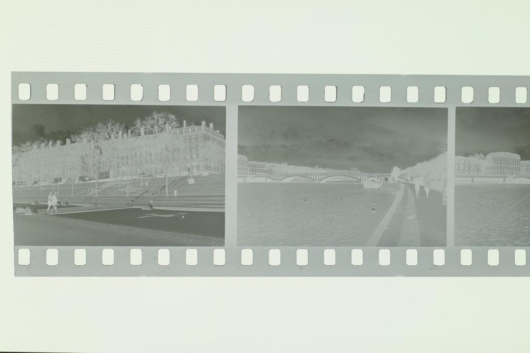

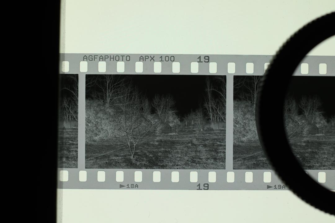

=> As APX 100 is my main film and i've done rodinal 1:50 10min @ 80 several times, both for scan and prints, I'm confident that the dense highlight is the result of the metering and not overdevelopment.

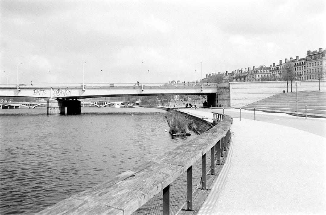

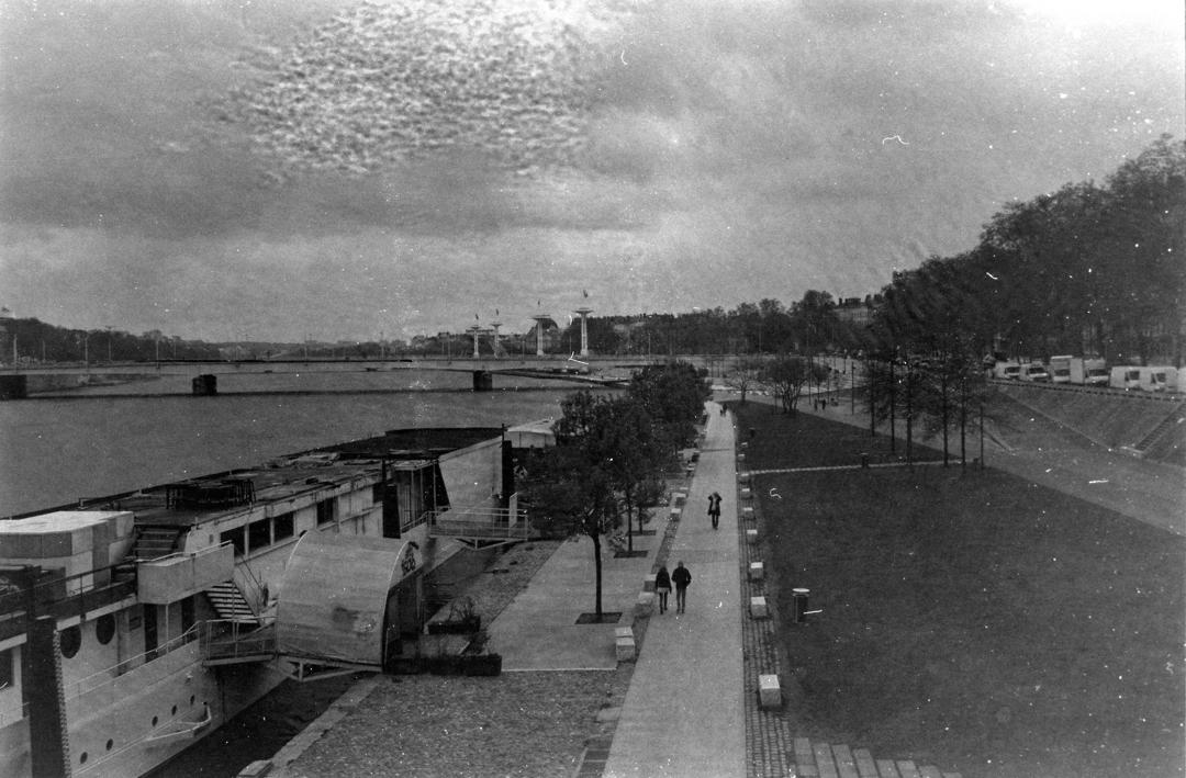

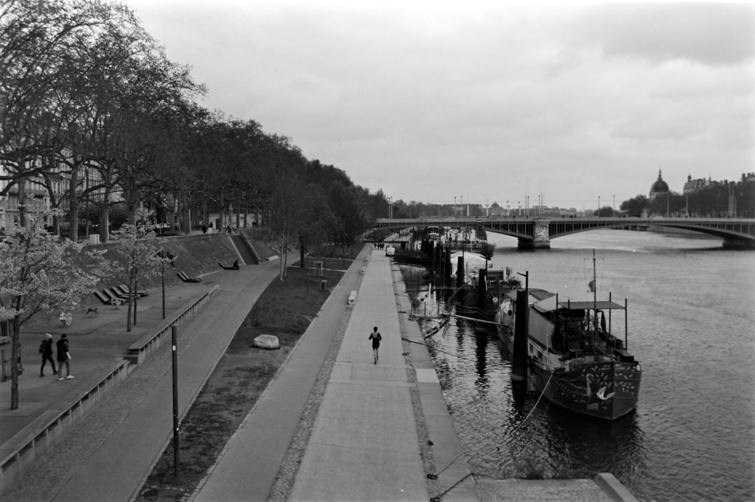

2. "Caffenol CM" : 500ml, 27g sodium carbonate, 8g ascorbic acid, 20g instant coffee. PH : ~9.5. Dev time : 12min
Regular CCM Recipe.
=> Quite dense ... I was excepting less development : the recipe starting point is 15min so I thought 12min would be OK. Either this film need less time in CCM, or I screwed up somewhere (I think it's the second option .. most likely the temperature).

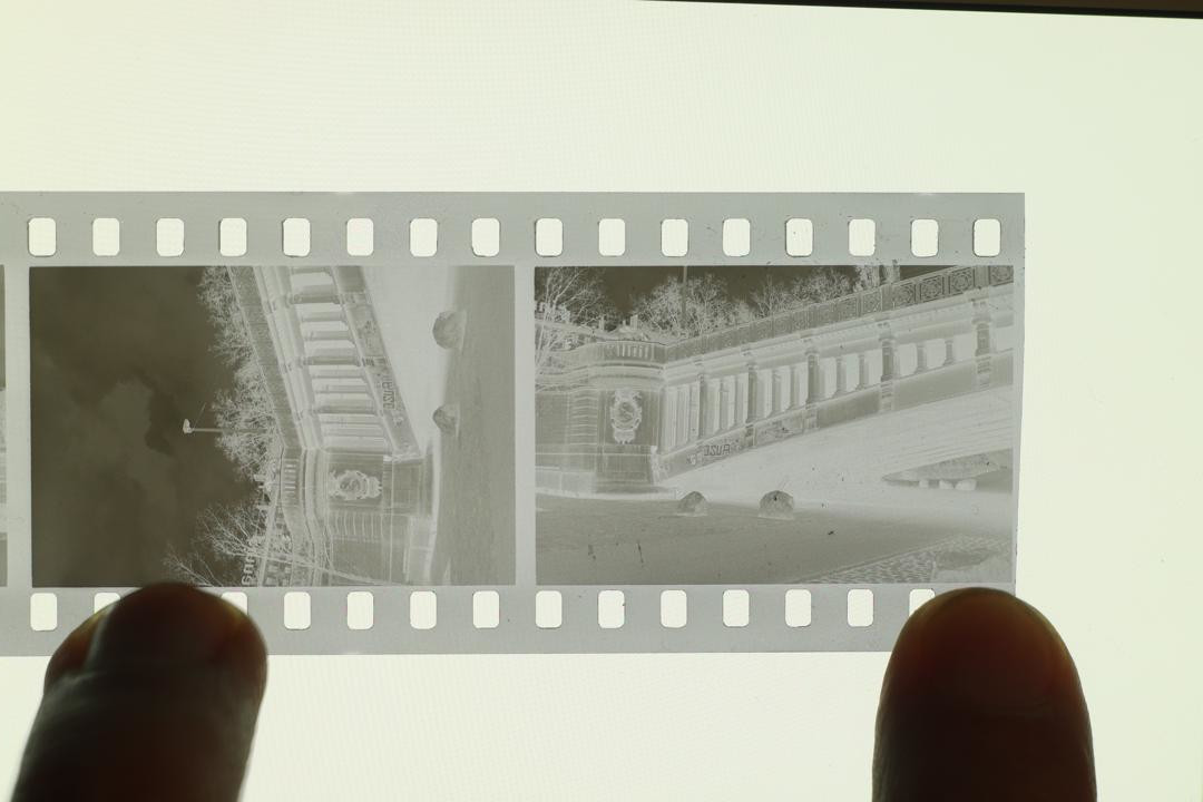

3. "Caffenol CM but with thyme" : 500ml, 27g sodium carbonate, 8g ascorbic acid, 3g dried thyme. PH : n/a. Dev time : 12min
Still the regular CCM recipe, but with 3g dried thyme instead of instant coffee. The thyme was boiled for 15min. I forgot to test the PH ..
=> I think it's OK. Less development happened.

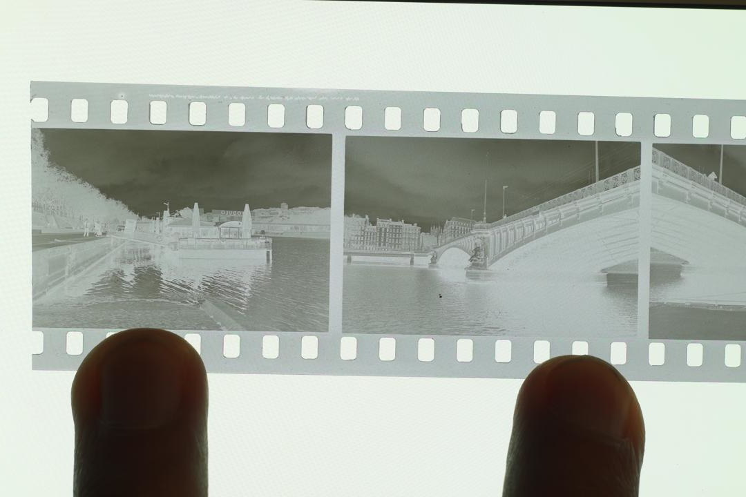

4. "Vitamin C and washing soda only : round 1" : 500ml, 10g sodium carbonate, 8g ascorbic acid. PH : ~9.5/10. Dev time : 12min
So, do we really need coffee, or thyme, or whatever ? I diluted the 8g of ascorbic acid of the CCM recipe, and got a PH of 2. Then, 10g of sodium carbonate put it close to the CCM value. Same dev time, same agitation method :
=> thin, underdeveloped negative.

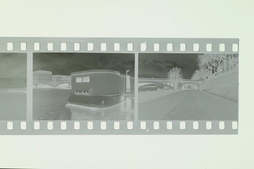

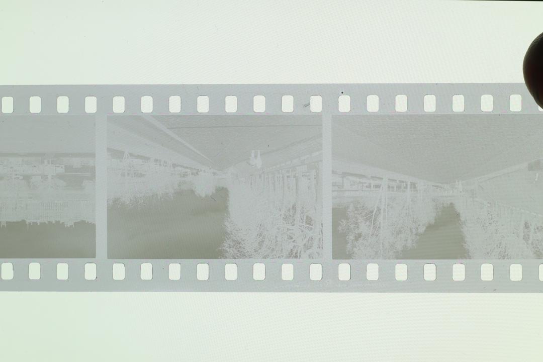

5. "Vitamin C and washing soda only : round 2" : 500ml, 27g sodium carbonate, 20g ascorbic acid. PH : ~10. Dev time : 12min
How much more vitamin C do we need to get a "good" negative ? for no particular reason, I chose 20g of ascorbic acid and 27g of sodium carbonate. Same dev time, same agitation method :
=> It's ... not bad at all, I think ? slightly more contrast than the rodinal strip.

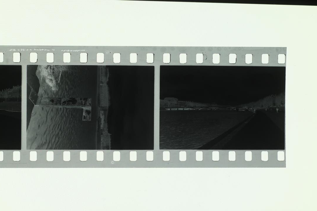

6. "Raw caffenol" : 500ml, 12g sodium carbonate, 10g iodised salt, 18g coffee. PH : ~ 10/11. Dev time : 30min
Apologies to Donal Qualls, I didn't used the recipe he kindly provided because I found this one. It was easier for my european brain as it was already in grams, and the fp4+ was closer to the APX 100.
=> development did happen, but not enough. I don't know if it needs more coffee and/or less restrainer (and I'm of course interested in advices). PH was higher than CCM, might be a factor ?
7. "Raw caffenol but with thyme" : 400ml, 10.8g sodium carbonate, 9g iodised salt, 4g thyme. PH : ~ 11. Dev time : 30min
Same thing but with 4g of dried thyme boiled for 15min instead of coffee. I used a second single reel tank, that's why the solution is 400ml.

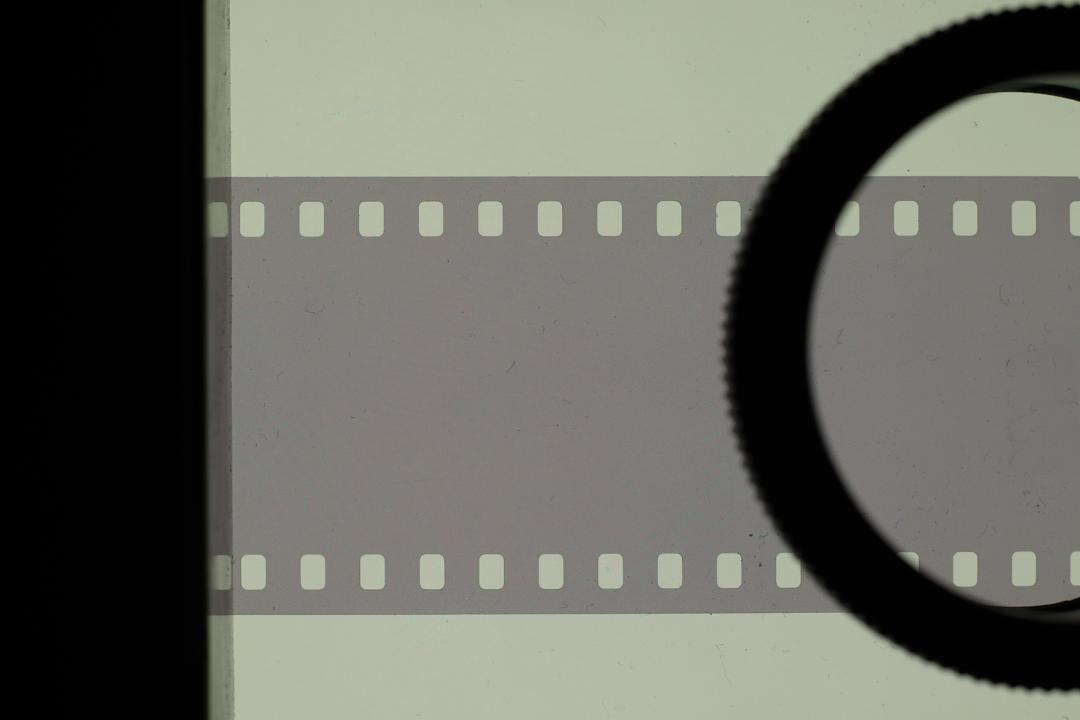

=> nothing. Nothing at all.

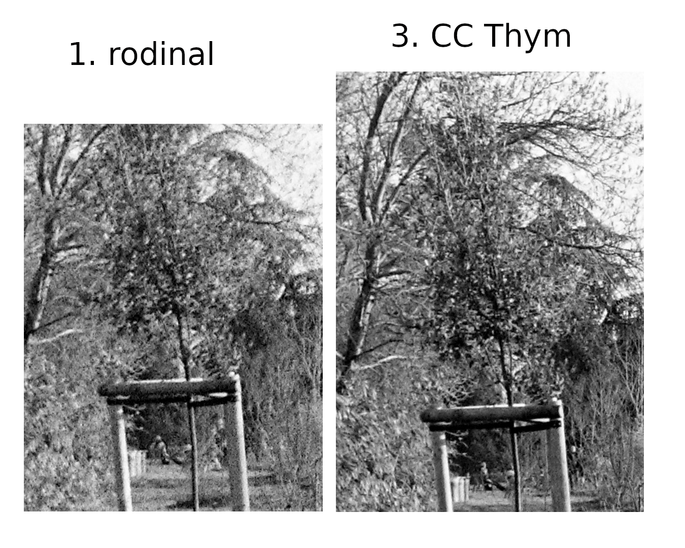

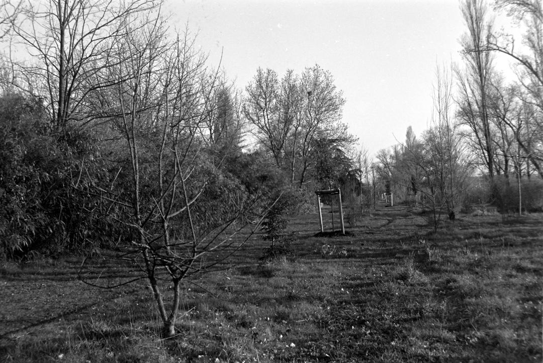

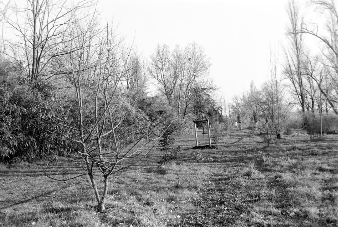

Grain / sharpness comparaison : rodinal and Caffenol CM with thyme
My personnal interpretation, which of course you may or may not agree with : I havent't discovered anything, but merely confirmed what I read in several articles and forum posts. Caffenol is nice because the development time and each composants are kept low by using two developing agent : vitamin C and coffee. At least thyme can be that second developing agent instead of coffee, but peoples have been reporting success with a wide variety of other plants. Coffee alone can develop film, but thyme cannot. Vitamin C alone can develop film, but you need a lot more than what is used in the caffenol C* recipes. My preference would be toward a home-made developer that don't cost much and use everyday products that you can find in your garden or at the next store, but to each their own .. some won't mind the cost of ascorbic acid, and I'm sure great result can be achieved with vitamin C and washing soda only.
Sorry for the long post and approximate English. Thank you for your advices and i'd be happy to discuss the results.

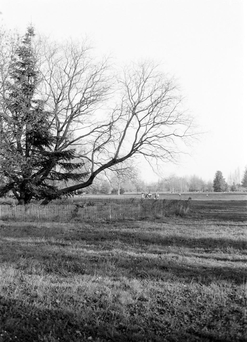

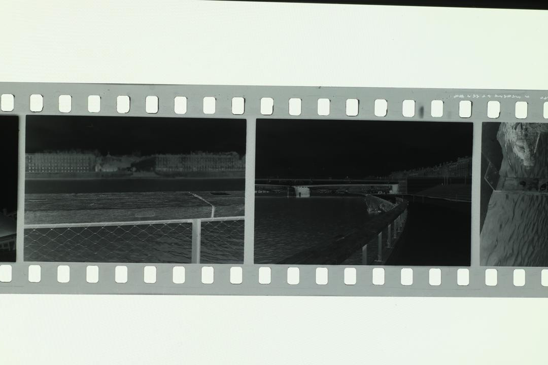

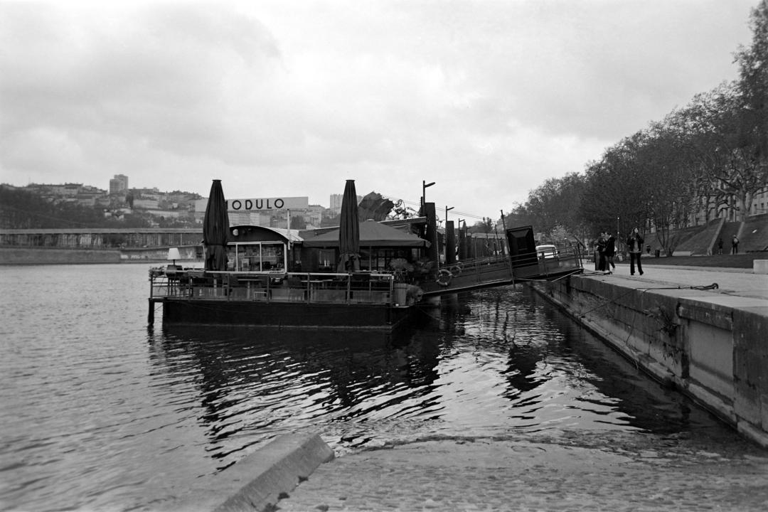

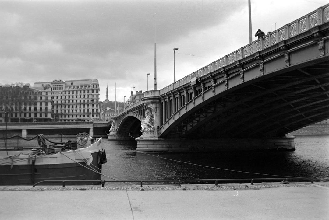

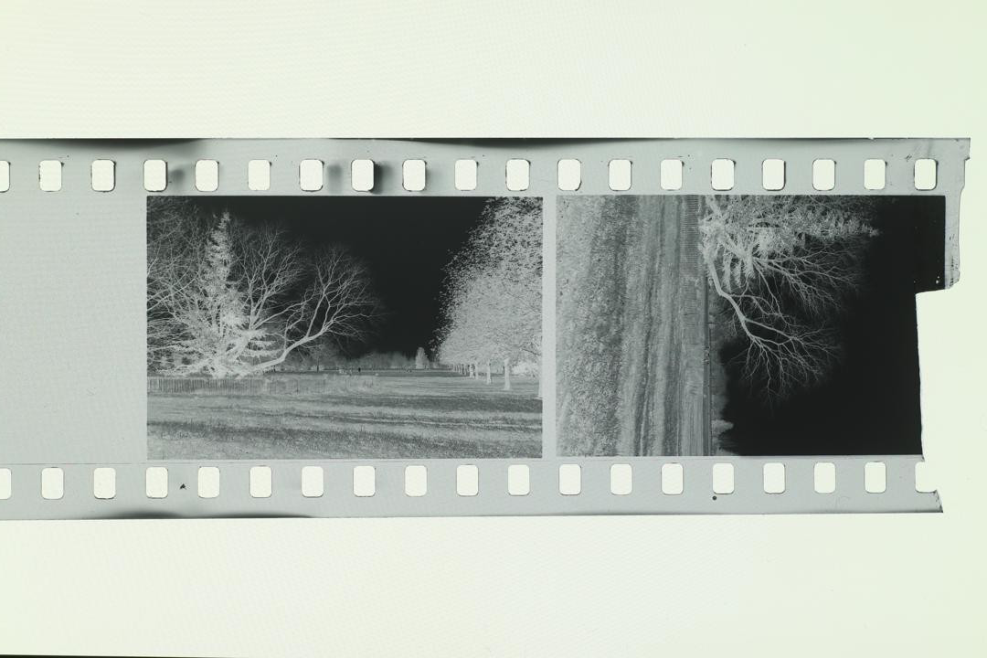

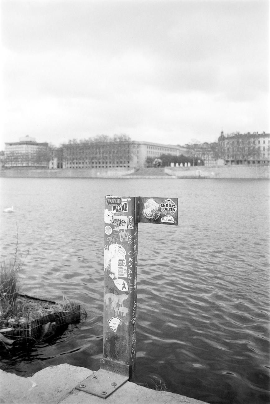

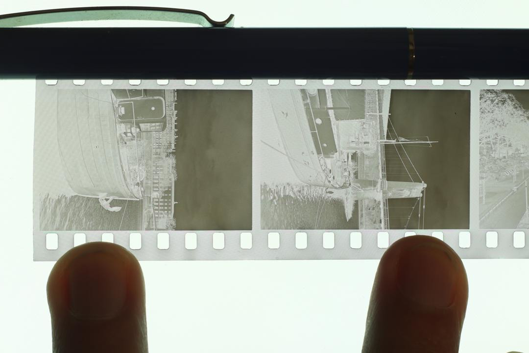

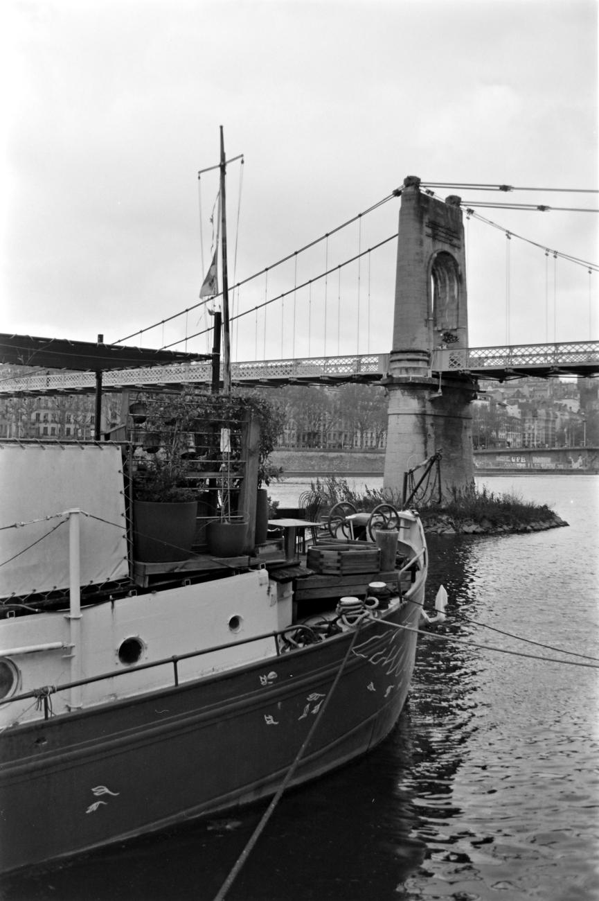

I tried dried mint (#3) and a few other things. My method was the same as my earlier post (https://www.photrio.com/forum/threads/herb-developer.188968/page-4#post-2526887), apart from :
* film : Fomapan 100 shot at EI 80
* Agitation : still continuous for the first 30s then 10s agitation at the start of every minutes, but with the twirling stick which came with my paterson tank. The reason is that it's starting to leak, and I got tired of spilling chemicals on my hands...
Part 1/2 (upload limit)

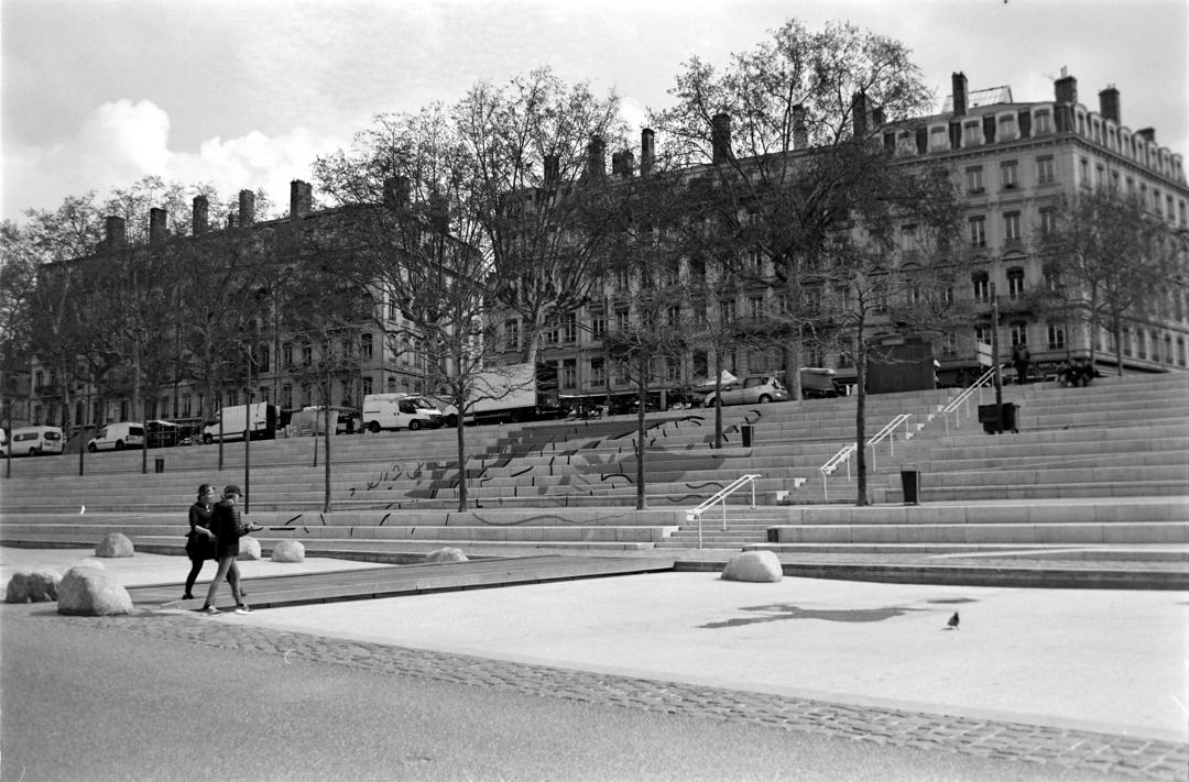

1. HC-110 (h) 1:63, 500ml, 8.5min
=> theses first frames were taken on a bright sunny day, the rest was the same overcast afternoon.
2. Caffenol CM, 500ml, 27g sodium carbonate, 8g ascorbic acid, 20g instant coffee, 12min
IG_IMG_7573.JPG IG_IMG_7574.JPG IG_IMG_7509.JPG IG_IMG_7510.JPG IG_IMG_7511.JPG IG_IMG_7512.JPG
=> (very) dense and punchy, like the AgfaPhoto APX 100.

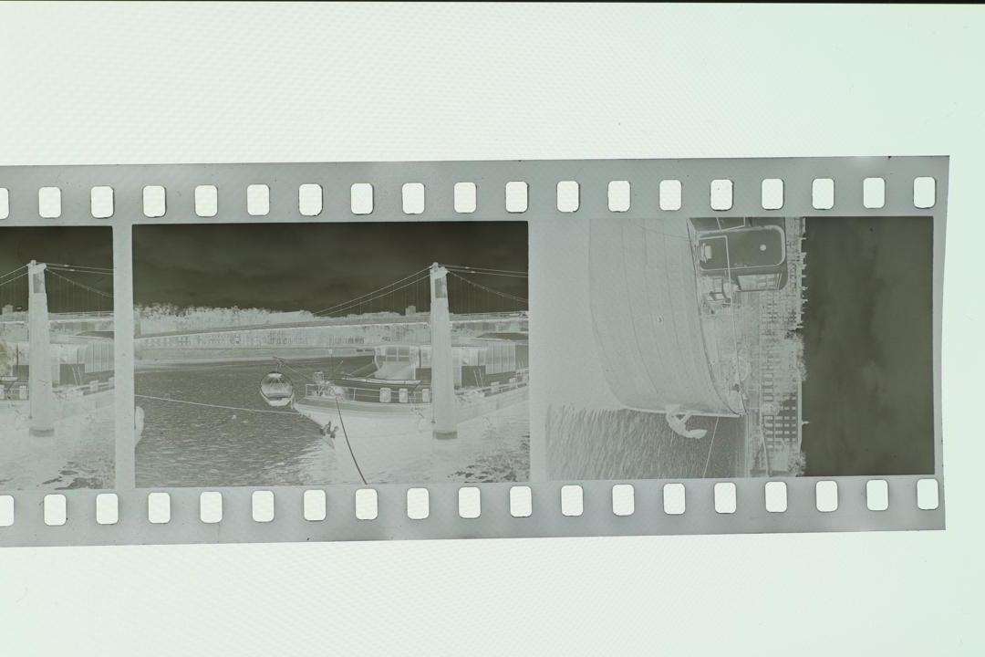

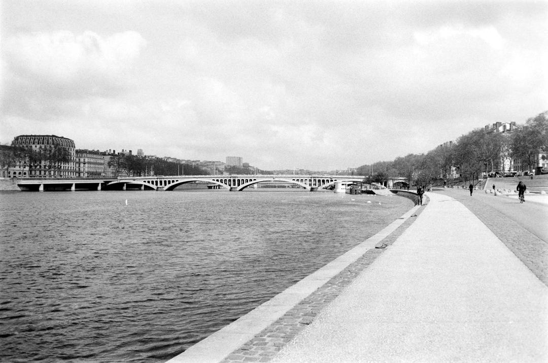

3. Caffenol CM with dried mint, 500m, 27g sodium carbonate, 8g ascorbic acid, 2.5g dried mint, 12min
15min decoction like I did with thyme.
IG_IMG_7578.JPG IG_IMG_7579.JPG IG_IMG_7580.JPG IG_IMG_7538.JPG IG_IMG_7539.JPG IG_IMG_7540.JPG
=> quite the opposite with thin negatives.
Part 2/2
4. Caffenol CM with sodium carbonate and vitamin C only, 500ml, 27g sodium carbonate, 8g ascorbic acid, 12min
I already did this last time, but lowered the sodium carbonate to get roughly the same PH as caffenol CM. This test is Caffenol CM with coffee removed
=> severe underdevelopment, but i'm always amazed at how you can still get at least something :D
5. Vitamin C and sodium carbonate only, standard development, 500ml, 23g sodium carbonate, 25g ascorbic acid, 12min, PH ~ 9.5 (I think, didn't write it down but it was close)
IG_IMG_7586.JPG IG_IMG_7587.JPG IG_IMG_7588.JPG IG_IMG_7589.JPG IG_IMG_7551.JPG IG_IMG_7553.JPG IG_IMG_7557.JPG
=> close to my previous experiment, i wanted to see what would be the result with casual photos. It's still in the thin side, a little better than caffenol with dried mint
6. Vitamin C and sodium carbonate only, semi stand-developement, 500ml, 15g sodium carbonate, 15g ascorbic acid, 0.5g iodized salt, 60min semi stand-development, PH 9.5
What the hell let's try this. Continuous agitation for the first 30s then two gentle twirls at the 30min mark
IG_IMG_7591.JPG IG_IMG_7593.JPG IG_IMG_7595.JPG IG_IMG_7560.JPG IG_IMG_7561.JPG IG_IMG_7563.JPG
=> density is better than #5, but it's easier to see it with the actual negatives side by side. I expected nothing, It's not good, but not that bad either.
I like the idea of herbs developers. You can get most of the ingredients easily, it's relatively environmentally friendly, and you remove the coffee which is frankly a pain in the ass : the smell, the mess, the brown stain on everything ...
2.5g/3g of dried thyme or mint with a 12min dev wasn't enough. I'll try to stick to thyme (cheaper than mint) and increasing theses two factors to see if I can get negatives I like with fomapan 100 or APX 100.
I'm sure you can get good result using vitamin C and sodium carbonate only, it was fun to try that, but you need quite a lot of ascorbic acid, which is not that cheap nor easily found in your next store. I took note of Don Heisz's advice to use metol, might try that in the future, thanks !:smile:
