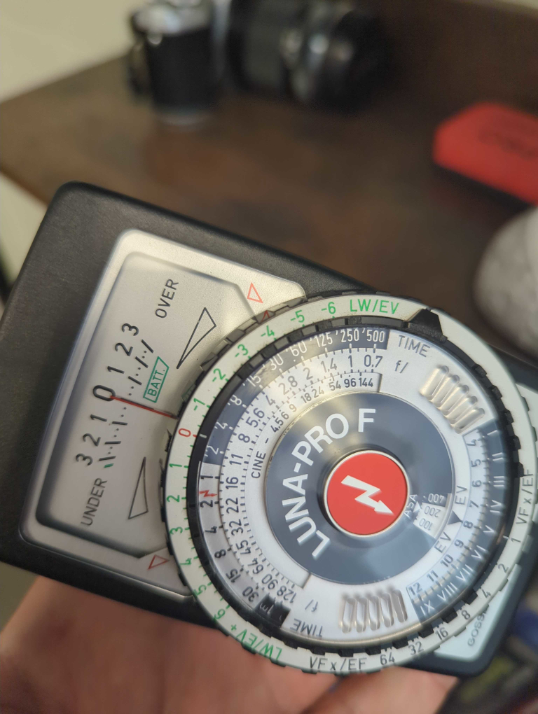

Help me figure out what's wrong with my light meter?

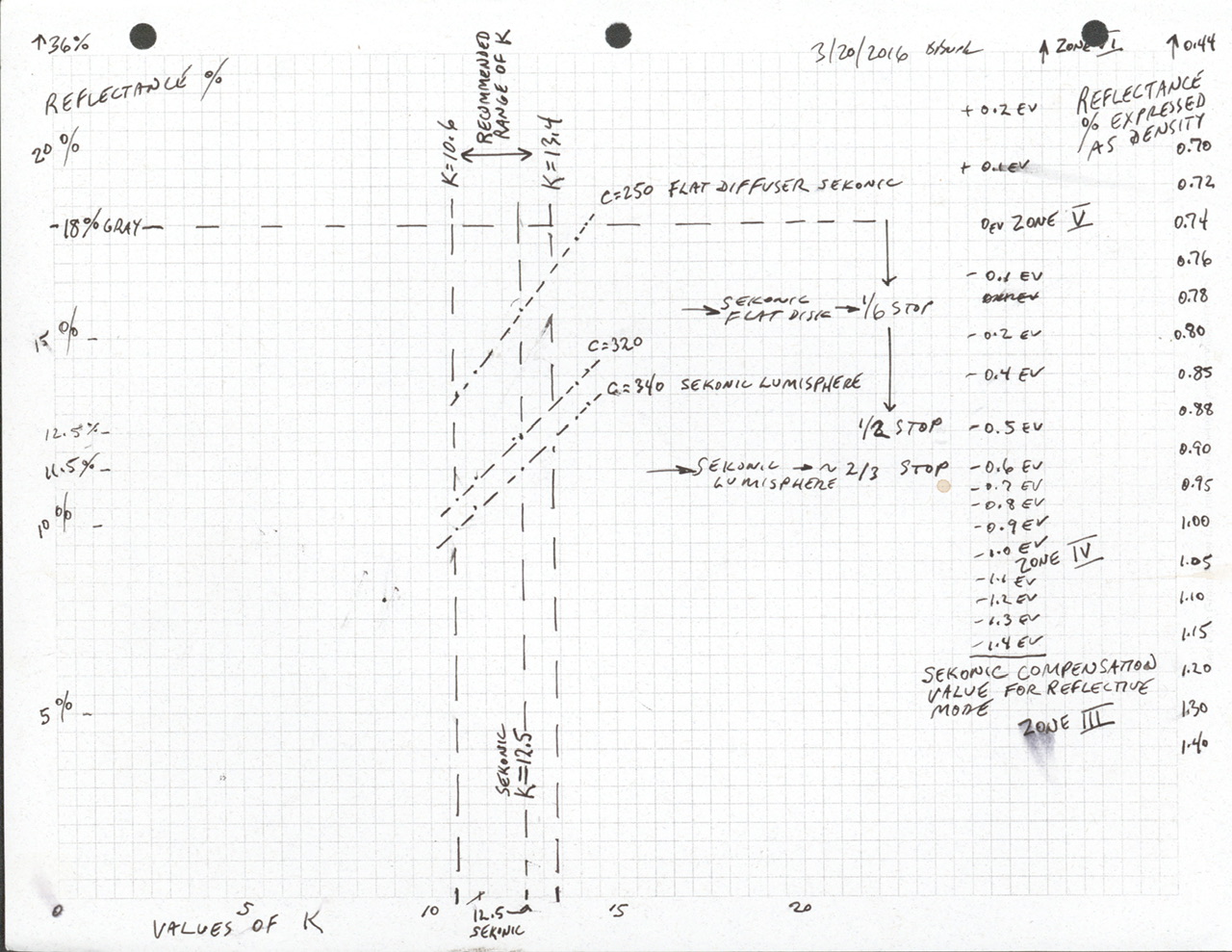

Here’s a sketch I made for myself about the relationship between C and K and percent gray.

As I recalled, Sekonic/Canon/Nikon meters, K is typically 12.5; Minolta/Pentax is 14 (Correct me if I'm wrong)|
Taken from Wikipedia (for convenience)
ISO 2720:1974 recommends a range for K
{\displaystyle K}
of 10.6 to 13.4 with luminance in cd/m2. Two values for K
{\displaystyle K}
are in common use: 12.5 (Canon, Nikon, and Sekonic[15]) and 14 (Minolta,[16] Kenko,[16] and Pentax); the difference between the two values is approximately 1⁄6 EV.​
Each manufacturer choses its own standard value for both K and for C, which is why one brand's readings might not exactly match a different brand's readings...but they should be within 1⁄6 EV!

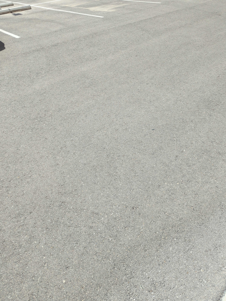

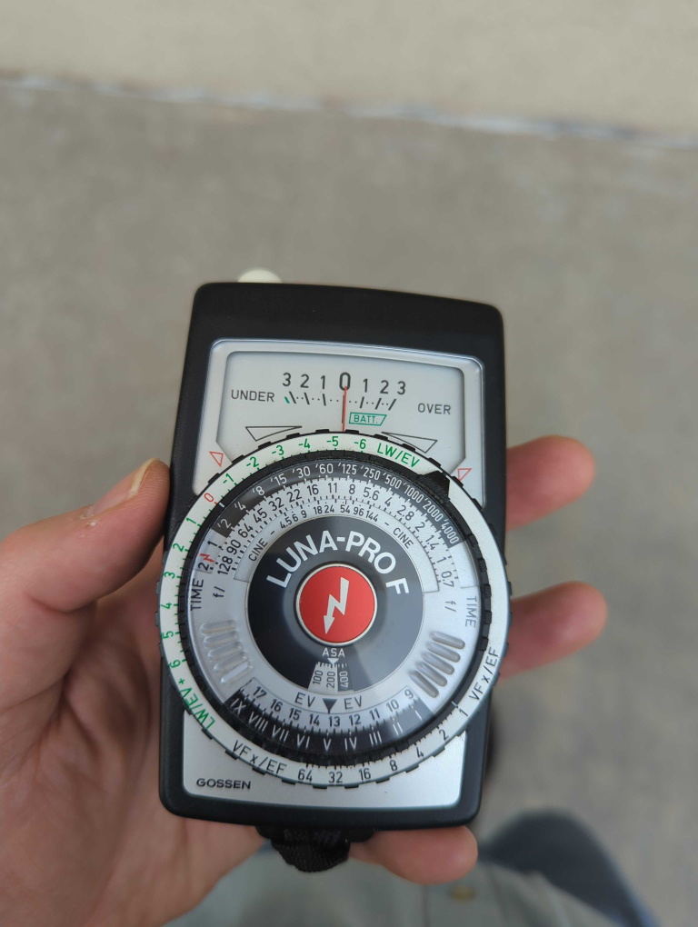

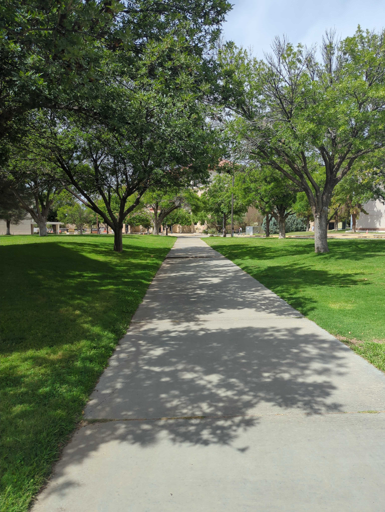

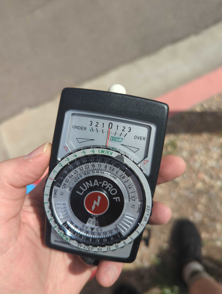

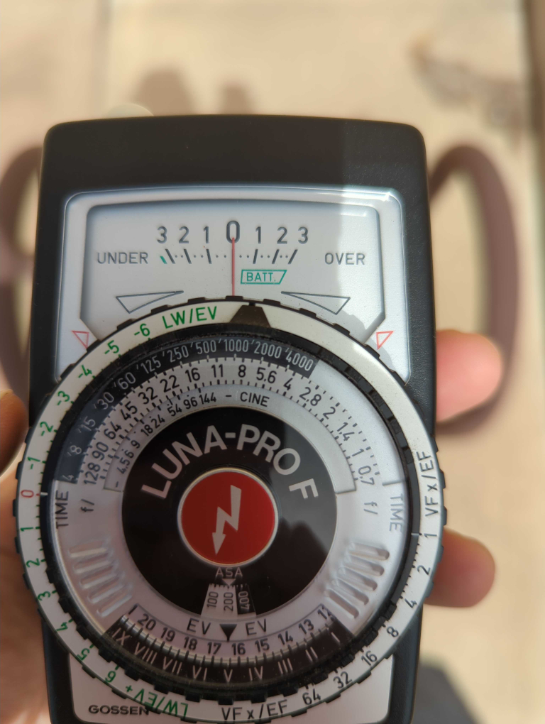

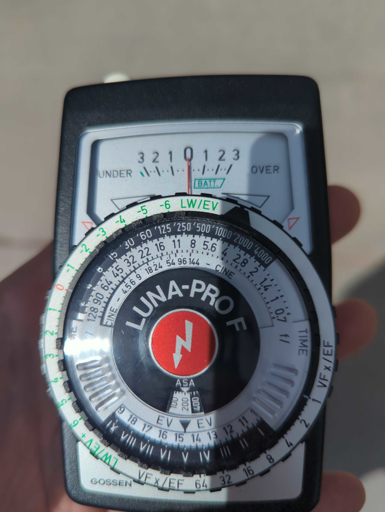

New Light Meter Test:
Today I did a new test using my Olympus OMD mirrorless camera as the reference light meter. This time I was also careful to point at subjects that look gray-ish, as opposed to the very white sidewalk that might have introduced an additional source of error. With these changes, the Luna Pro F light meter seems to line up with the Olympus one quite well --- better than I expected.
Today the conditions were not quite ideal. It was a bright sunny day, but the uneven cloud cover caused the lighting to vary visibly. I made an effort to take the meter reading and the digital camera shot at the same time, but looking back, I could've done a better job at that.
I am not able to get the images from the digital camera because I'm a dummy and forgot to bring my SD card adapter. I went back and took photos with my phone so at least you can see more or less what the scenes looked like, but it won't be exact.
The Olympus OMD's meter was set to "center-weighted".
The Luna Pro F's meter was set to "reflected light".
Test 1: Pavement.
Olympus ---> 1/125" F16 ISO 200
Luna Pro ---> 1/125" F16 ISO 200 (same!)

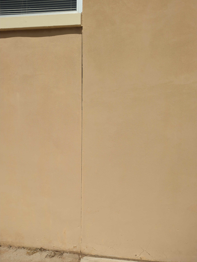

Test 2: Sun-Lit Beige Wall.
The light was changing rapidly. I ended up taking two measurements with each device.
Olympus ---> 1/400" or 1/500" F16 ISO 200
Luna Pro ---> 1/300" or 1/400" F16 ISO 200
Test 3: Shaded Wall.
At this point my finger must've slipped and changed the OMD's aperture to F14. I will report the value in the EXIF data and the equivalent at F16.
Olympus ---> 1/60" F14 = 1/46" F16 ISO 200
Luna Pro ---> 1/38" F16 ISO 200
Test 4: Normal Scene.
OMD still set to F14...
Olympus ---> 1/80" F14 = 1/61" F16 ISO 200
Luna Pro ---> 1/86" F16 ISO 200

Well that looks promising…
Perhaps there was some user “error” in the earlier measures where the Luna Pro showed “bad” readings. It really would be nice if there’s no problem as it may be big but it’s a fast and versatile meter to use.
(Im still not convinced that light meter app cannot be trusted since it was giving quite credible readings in your initial comparison. But that’s neither here nor there.)

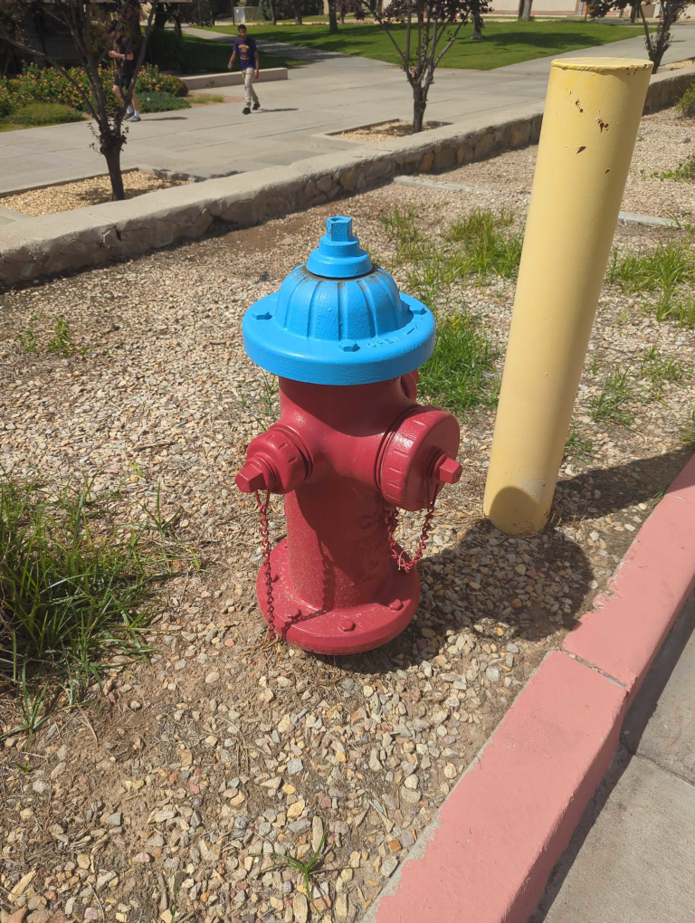

I can do that!

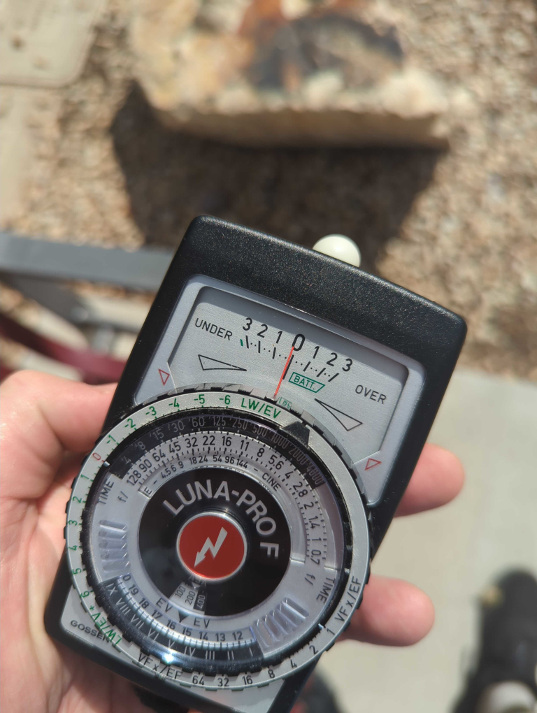

Light Meter Test:
Olympus OMD metering set to "Digital ESP Metering".
Luna Pro metering set to "incident" mode.
I chose smaller human-scale subjects so I could walk up to the subject and hold the Luna Pro right at the subject (dome pointed in the direction from where I took the shot with the camera, away from the subject).

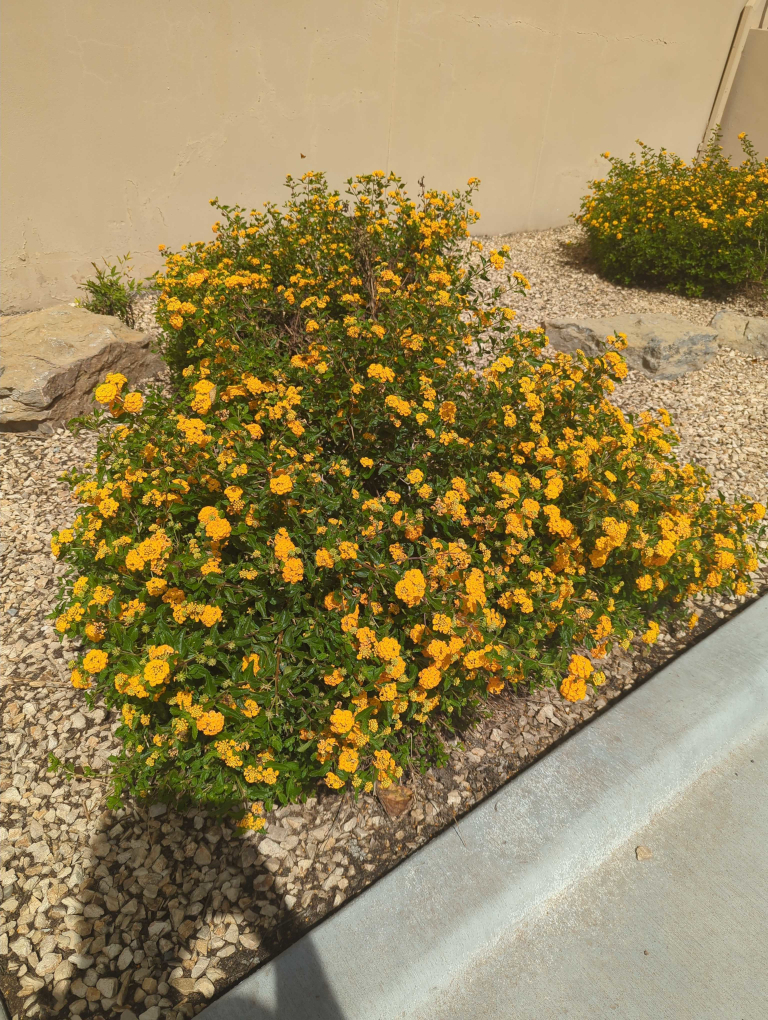

Scene 1: Flowers --- Direct sunlight
Olympus ---> 1/160" F16 ISO 200
Luna Pro ---> 1/177" F16 ISO 200
Scene 2: Fire Hydrant --- Direct sunlight

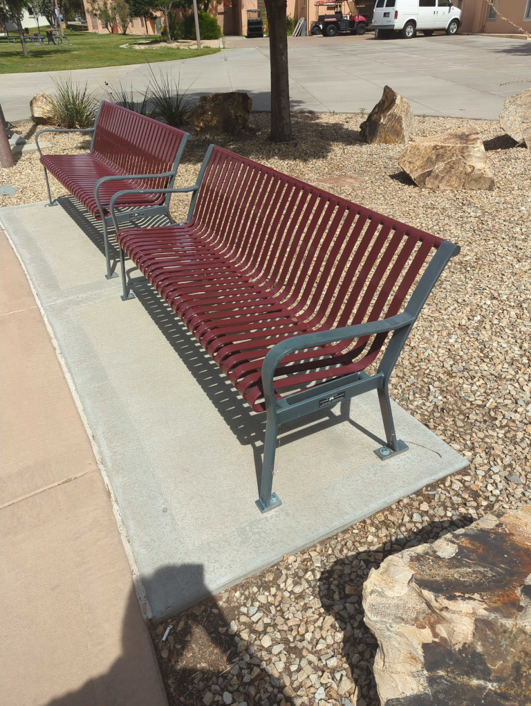

Scene 3: Bench --- Direct sunlight
Olympus ---> 1/200" F16 ISO 200
Luna Pro ---> 1/226" F16 ISO 200

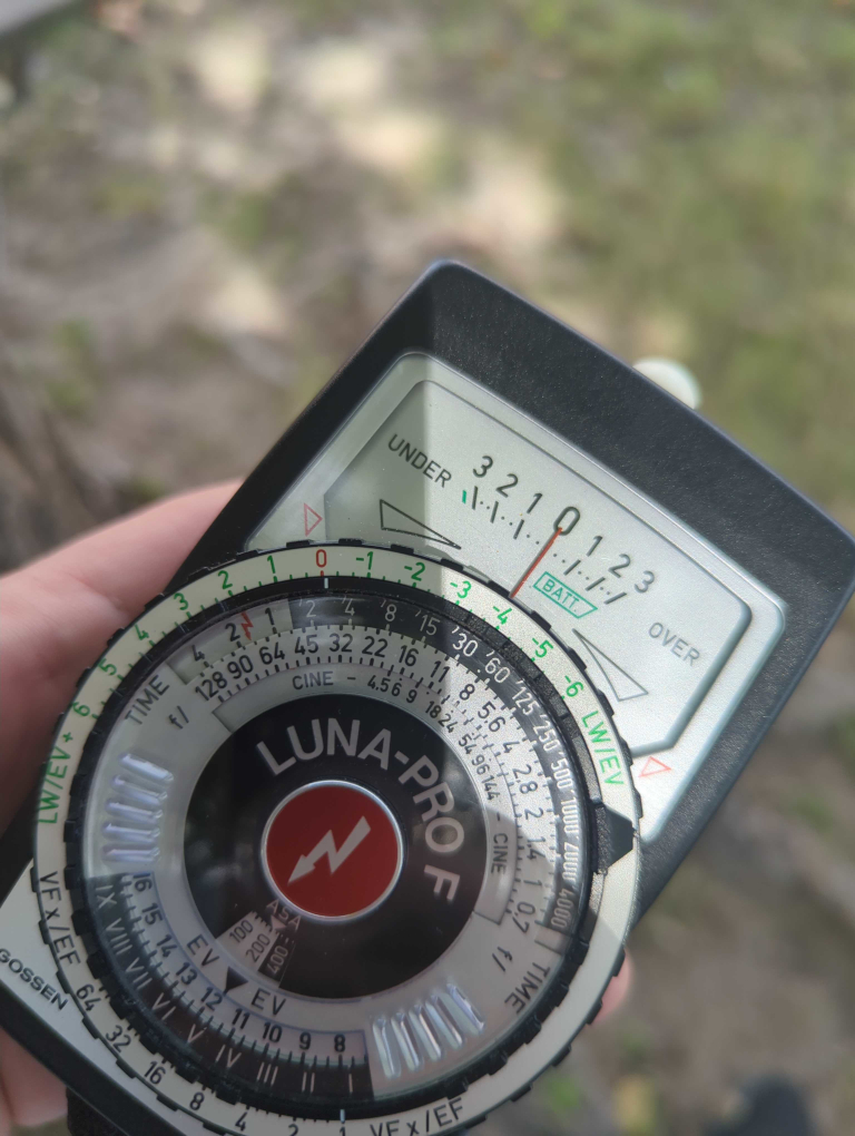

Seeing how well the Luna Pro was performing under ideal conditions, I decided to give it a more tricky scene.
Scene 4: Bench --- Tree in the shade, with a brighter background.
Olympus ---> 1/40" F16 ISO 200
Luna Pro ---> 1/14" F16 ISO 200 --- I think this just shows it was indeed a tricky scene.
Then finally...
Scene 5: Shelf --- Indoors.
Olympus ---> 1.3" F16 ISO 200
Luna Pro ---> 1.1" F16 ISO 200
Not bad.

That's great, lots of 1/6 stop difference in readings! I'd say Luna-Pro F is good.
+1
And as for the discussion about K and the like, that sort of analysis is much more likely to resemble @dcy 's day job than he probably ever wants to get into when out with a camera. :smile:
If you like to learn how the metering sausage is made - and I'm recommending that you do or suggesting you don't - the posts of several Photrio members like @Bill Burk and in particular @Stephen Benskin are recommended.
Yay! Thanks for the help! Really appreciate it.
