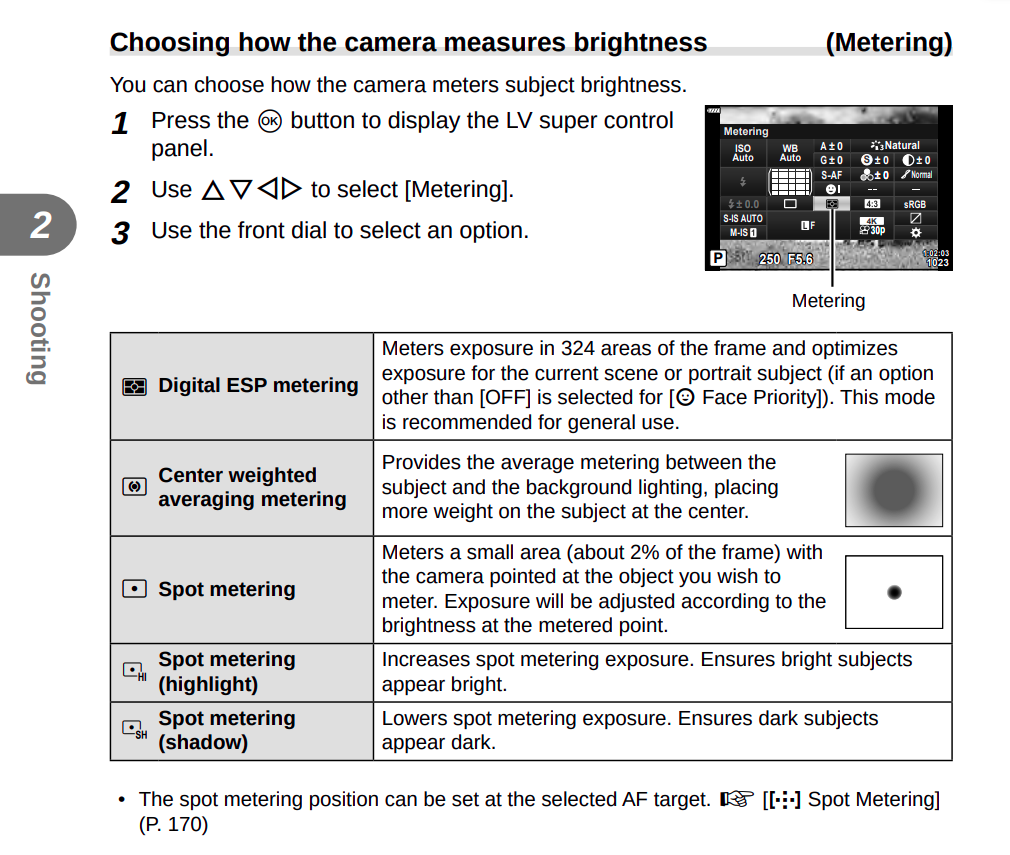

P/s: Personally, I don't trust any light meter result output from phone. I would use digital camera with iso 100 and average metering mode to compare with handheld light meter.
Yeah. I didn't think of grabbing my digital camera.
Here is a screenshot of the metering modes available to me. The default setting sounds sounds like a bit of auto-magic, so I guess maybe I'll choose the center-weighted option.
Apr 15, 2025
15
Vietnam
Ah, so you have an Olympus digital camera. I also own a OM-D EM10 (1st version) and found that my ISO 100 is not ISO 100. I accidental know this when I was calibrating one of my friend sekonic l-238 lightmeter, so I have to use my reliable sony a7c and pentax digital spotmeter to compare.
